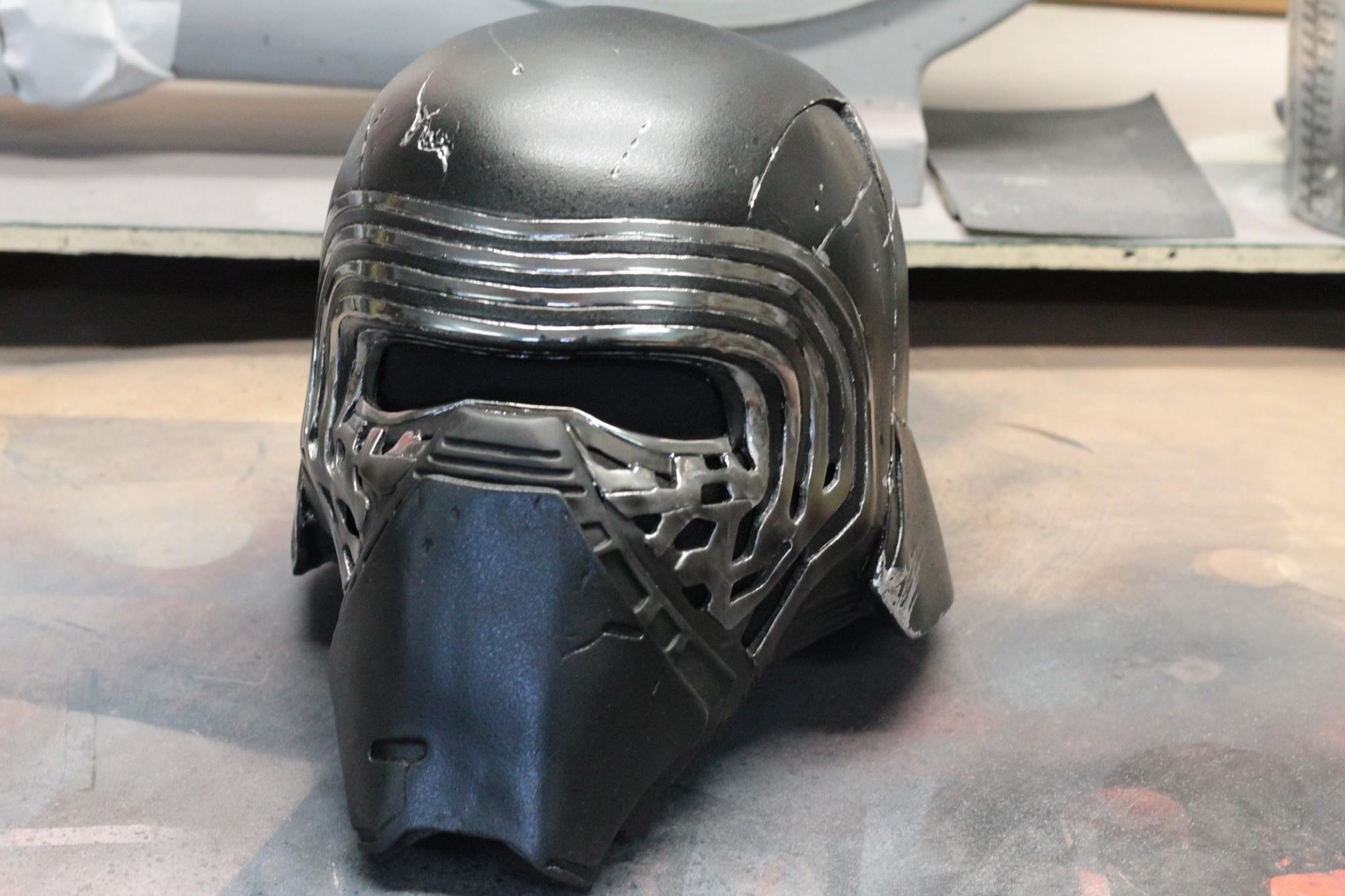

For sealing? You can go waterbased with Future or Aquagloss.. A trick I've found that helps keep dulling to a minimum with water based clears is adding the tiniest drop of violet pigment to the clear. It should tint the liquid just enough for the eye to perceive the shift, but go on clear. This Kylo Ren helmet I painted had the Alumaluster lightly sealed using Aquagloss and it retained a very nice shine. (The upper bands, the cheeks are supposed to be more dull and scorched.)
