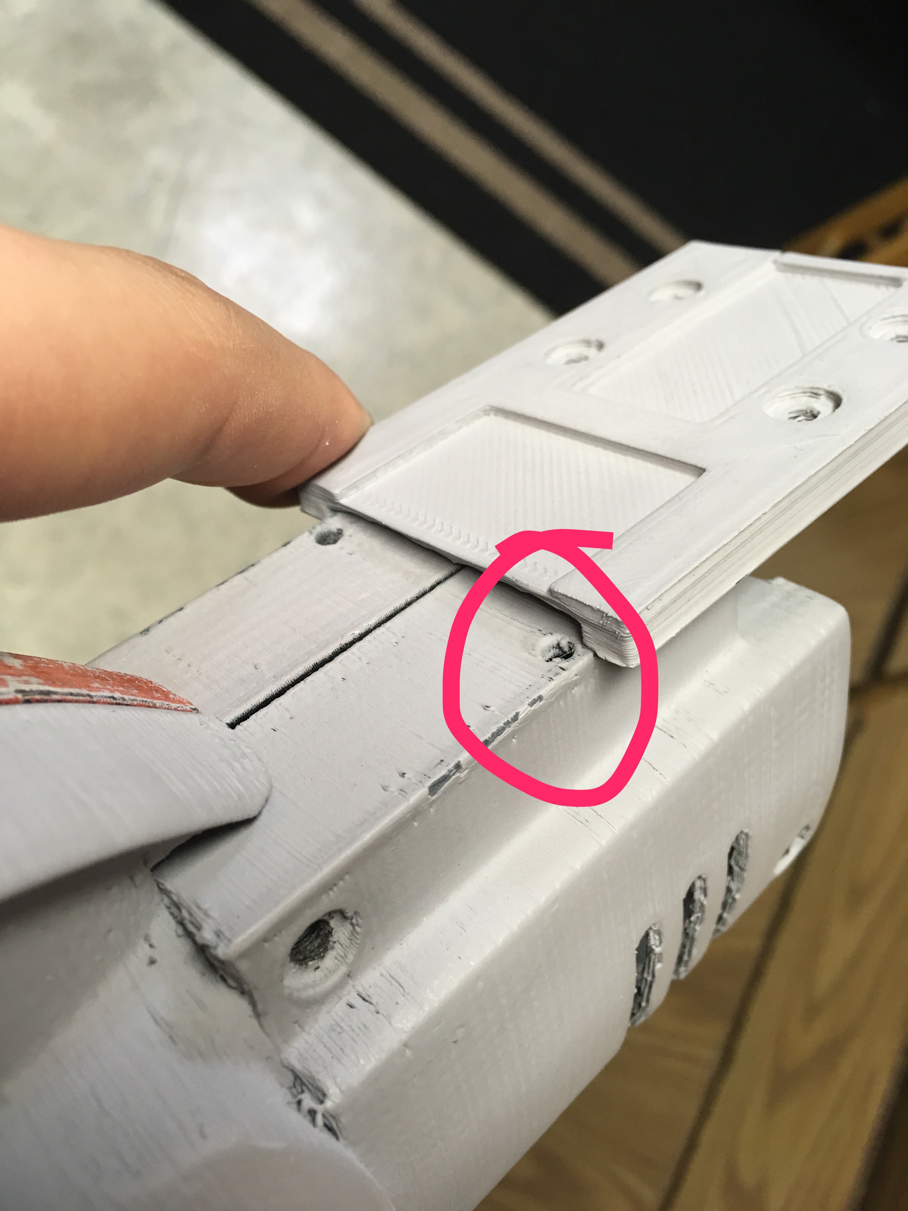

Well, here's an example of one of the parts that didn't fit. This flat piece is supposed to fit over the two main halves of the gun and slide underneath a little part on the back. The piece was printed in ABS so if the gun did shrink in size (which was also ABS) wouldn't the piece be able to fit? It was hard to hold the part and the gun while taking a picture but I circled where the part is supposed to reach over the edge. I actually also didn't receive three parts that I ordered and two of them were useless altogether. The rest will be okay if I do some work to it but good lord not what I was expecting at all. You are right though, I should have just kept it all in resin and skipped the ABS.

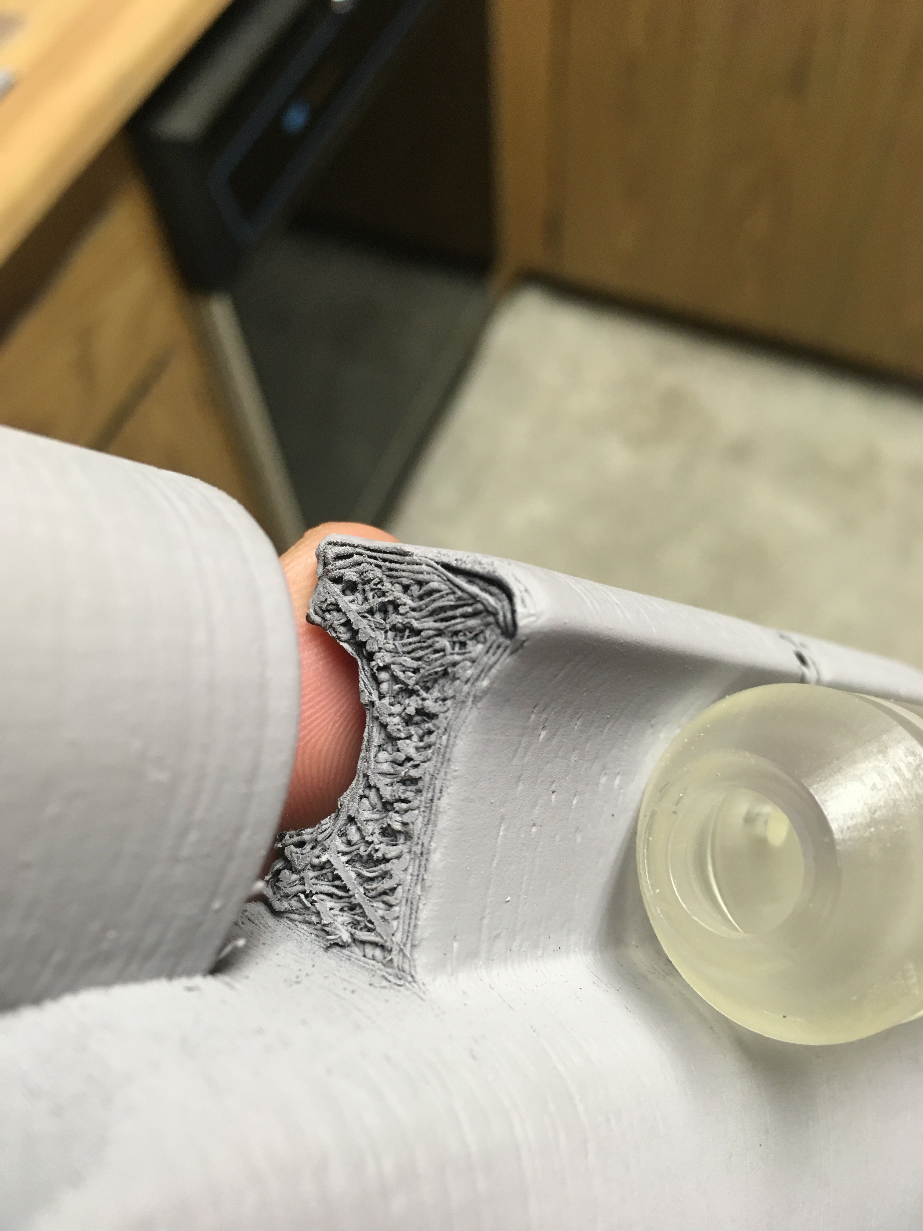

As to the layer height I'm not sure, they never talked about that to me more so chatted about the materials. But had I known how much of a mess the ABS would have been I would have paid the $150 extra for the resin halves. Here's a corner on the gun that I've got to fix:
I'd never seen ABS in person before so I wasn't expecting it to look like that in various places, especially since I'd paid them extra to cleanup the model before shipping it. I suppose that I thought it would be similar to Shapeways prints but this is far from it.

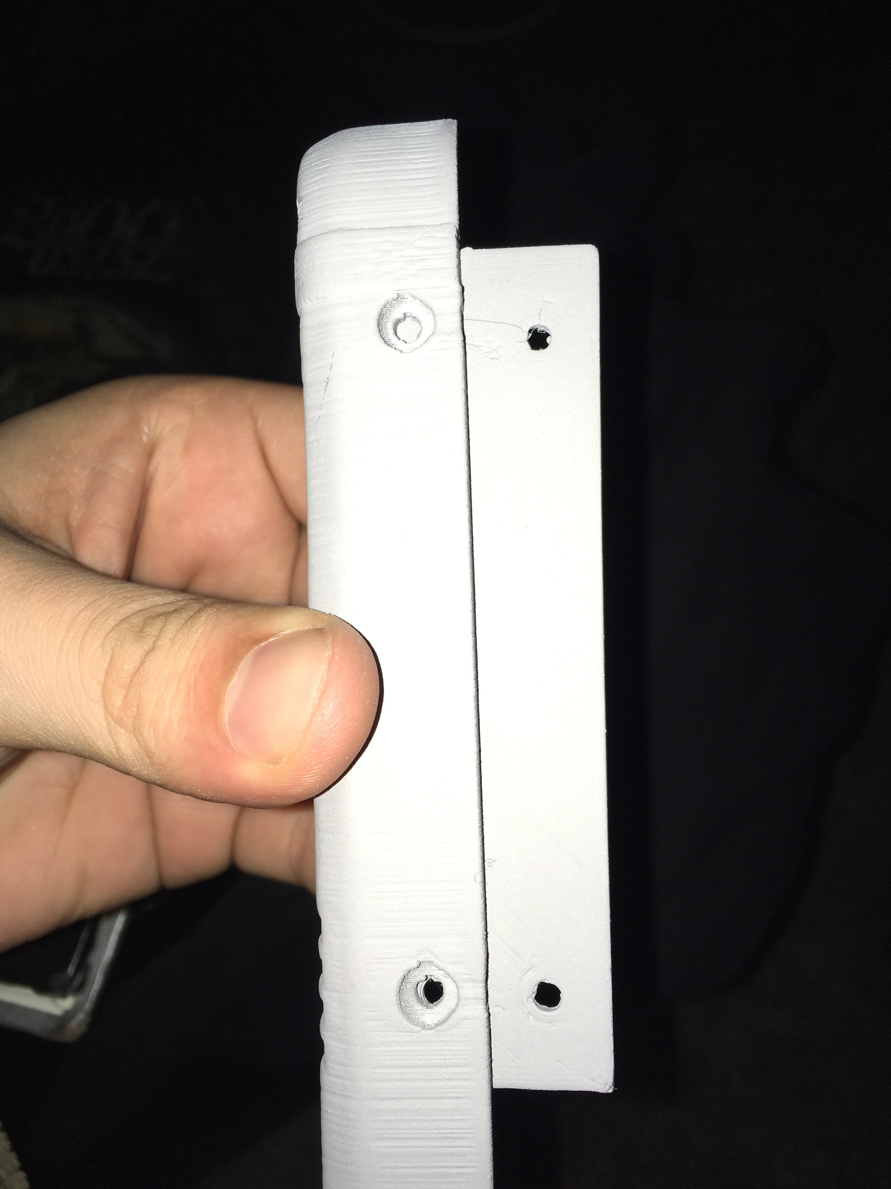

Any here's a photo of the way the pump grip lines up with the slide. You can see that the top hole is way off from where it's supposed to screw together.

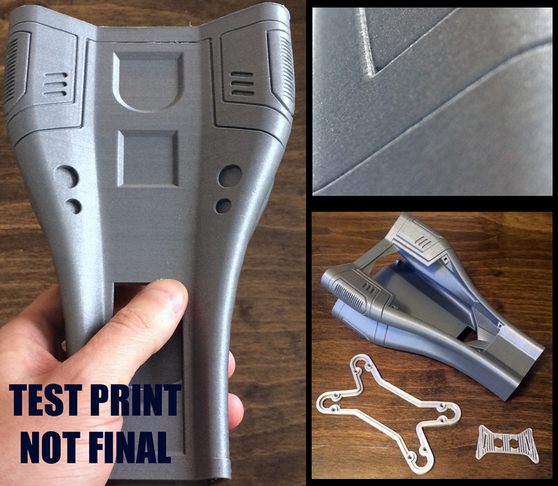

It's crucial to understand the model and material you are working with, to avoid misaligned parts. (One reason I never use ABS is the high risk of warping and shrinkage, another is the health hazard of the fumes.) The roughness of the prints seems to indicate they were either done on a very low-end machine or that the machine needs serious tuning. It also looks like the parts may have been printed at 200, or 250 microns. (I almost never print over 100 microns if the surface is going to take paint.)
Here's a 100 micron print done on a properly tuned machine.
Sometimes it's impossible to avoid small patches of roughness in some areas to benefit the overall quality of the model (like when you must print an extreme overhang). The center panel line in the image above for example is a little rough (as are the side vents but you can't really see it), due to it being printed in mid-air, but fixing that little roughness in post is preferable to splitting the model up more.

Thanks. :) The print is PLA, pretty standard plastic if you're not using ABS. I like it because it's stable, non-toxic and easy to glue with plexiglass cement. I've seen OK results with ABS too, I just don't like it personally. I also sometimes print in a "safe" kind of polyester... depends on the prop. Resolution is one factor, speed is another. Higher speed=more vibration=crappy surface, not to mention that you can have trouble with a more uneven flow of plastic. I suspect the MiB print is a combination of several factors. (The clear resin parts look good though!)

I did the 3d modeling for this Deatomizer, the hole missed align was because of the slider inner has a stopper point features. It's done by my mistake to update as the first scale of the whole gun long at 18" from the beginning setup and we changed it to 22" long during completion of the 3d modeling. I made changes to screw holes size on overall gun but just missed to update the slider inner features as well as causing the alignment issue, apologizes to Patrick really :(
