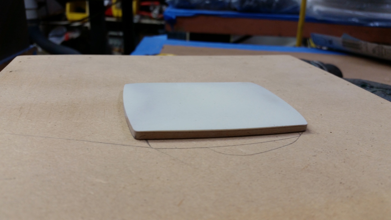

So I decided to make my own! I didn’t want to shove a flat piece of acrylic in there, because the Pip-Boy is supposed to have a CRT screen, so there’s a curve to it. I made a vacuum buck out of MDF and smoothed it with a layer of urethane. Then I sanded it down just a hair under the size of the opening to allow of thickness of the plastic.

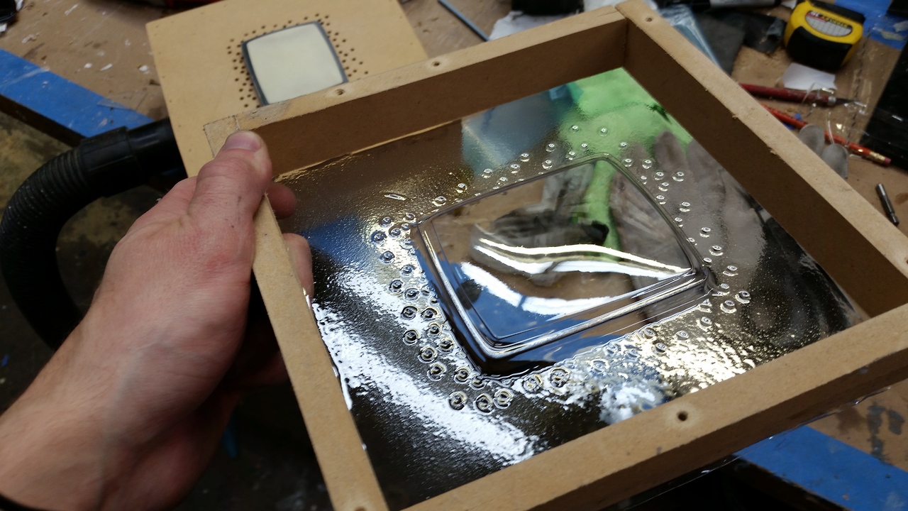

The shop I work at doesn’t have a vacuum former, but the part was small enough that I was able to build a vacuum box and heat the acrylic it the shop’s toaster oven. (Not the one we eat out of!)
After it was formed, I back painted it with some black, and cut it to size. I do want to be able to remove the screen, just in case I ever want to put my phone it for some reason, so I used some double stick foam tape to secure it in place. The corner of the screen, between the lip and the short side wall, has just a little more roundness than I would like, so the lip doesn't sit perfectly flat against the screen's frame, but the foam tape easily filled the gap! I could've got it sharper by drilling more small holes in the corner, and doing another pull, but this screen looked so nice otherwise, it seemed like a waste.

This is really neat and I'd love to have one of these for my Pip-Boy! Sorry for reviving an older thread but if a noob like me wanted to produce one of these what would I want to do? I see that I'd have to make a vacuum form box but I'm not so sure how you got that curve when the buck was flat? (I don't know much about vacuum forming)
