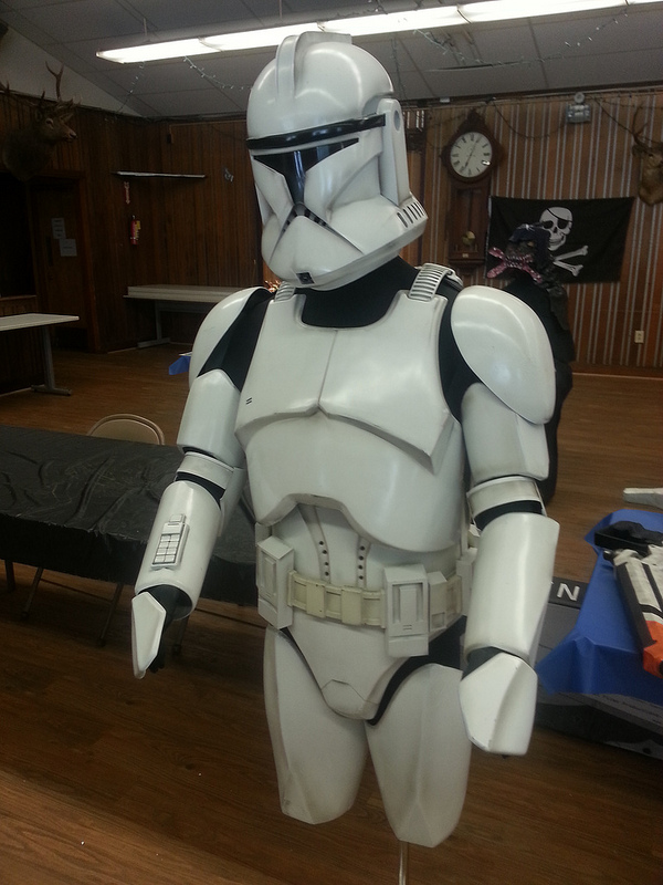

A few years back I had the pleasure of meeting clonesix at the NorCal prop party along with a bunch of other RPF members. I had brought along a truckload of nifty stuff and had such a great time chatting with folks and checking out their stuff that I completely neglected to take any photos. One of the very few that I did take was this beauty:
That's one of clonesix's gorgeous Phase I clones. At the time, I was neck deep in my Ironman build which ended up looking like so:

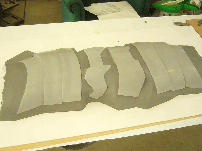

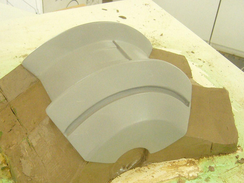

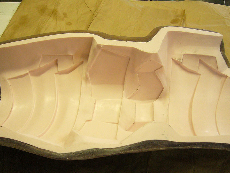

Thank you for the encouragement. While I haven't had much time on my end to devote to this project, clonesix has been doing an awesome job on the moldmaking end of things. A while back he sent me this pic of the waist pieces and outer shoulder strip all clayed up and ready to mold:

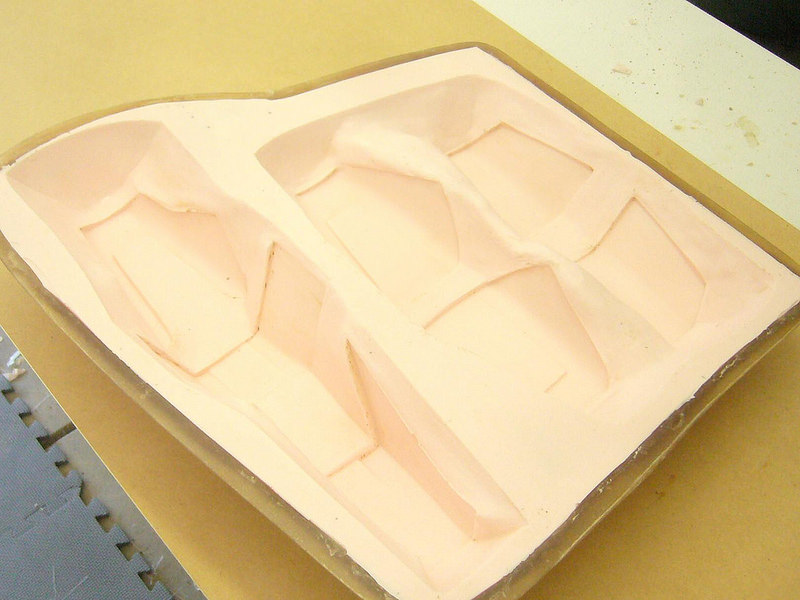

Here's the finished mold:
I really need to talk him into getting more "during" photos of his processes. I always love to learn the nuances of other people's molding techniques.

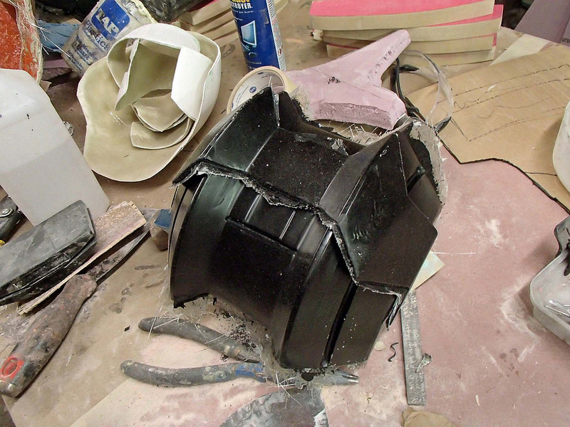

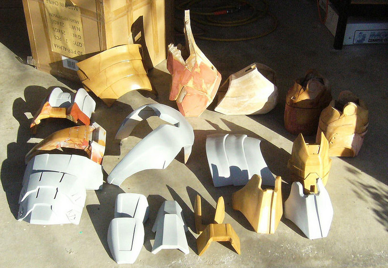

These are the first of the parts out of the molds. There is right shin, shoulder bell, and corset section with spinal pieces. Sure, this is a small number of pieces, but it took me 6 months to get this far. Back in January, everything looked like this:
I ran some quick cast thru the mold to give it a test run, as I wasn't about to start fiberglassing this late into the weekend. The bicep pieces came out very clean and will look just as nice in fiberglass.
