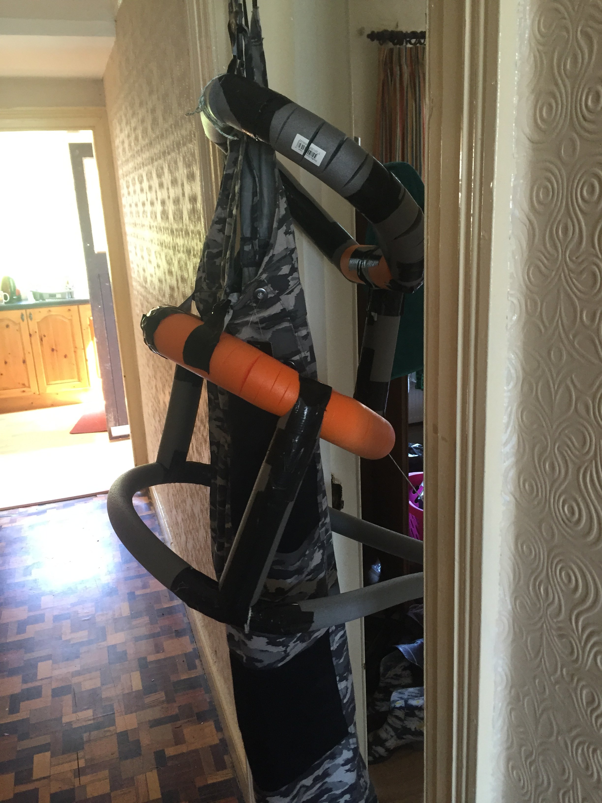

After some quick sketches (long lost i'm afraid) i began putting together a rough skeleton for sully's body. The general plan involved breaking up the costume into five major components:
-Head
-Arms
-Back/shoulders
-Torso
-Legs & Feet
I started with the Torso.

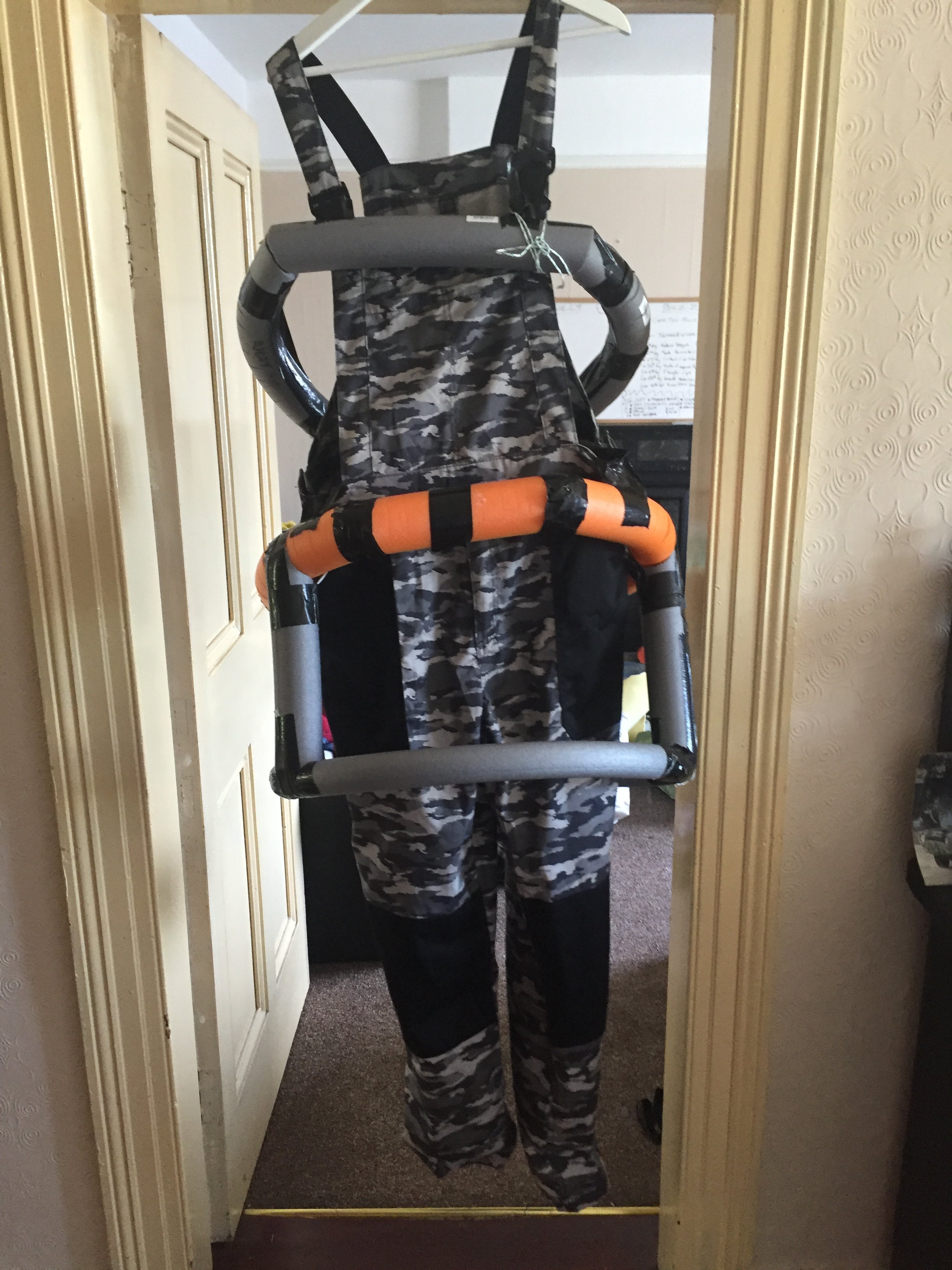

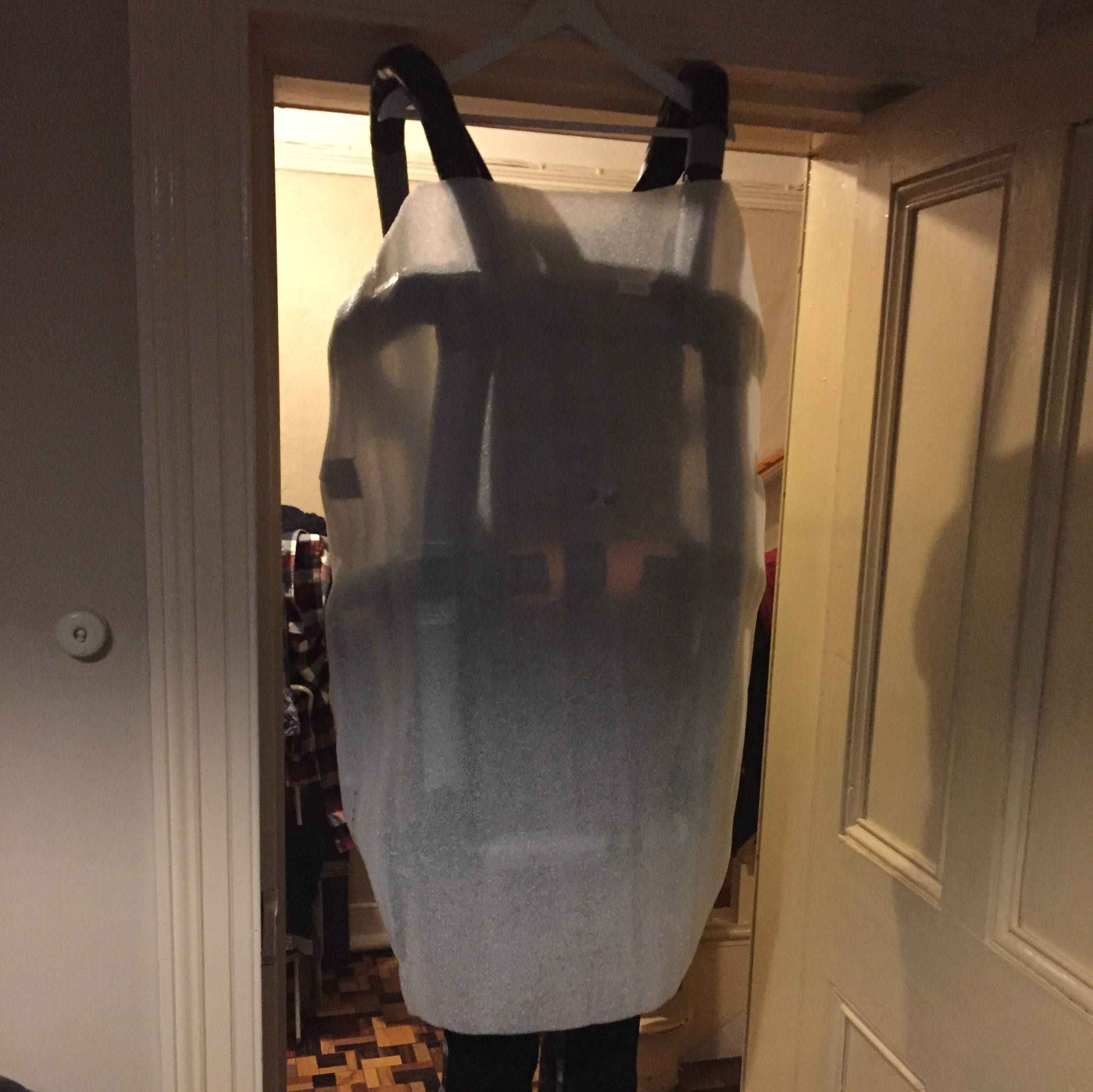

I used a cheap pair of dungarees/overalls as a basis and to help keep a sense of scale. Having looked at a lot of other sully costumes i was keen to avoid the "walking puppet" look that you can get with some larger costumes. I hoped that using foam insulation and pool noodles would allow for a certain amount of flex and give a more natural appearance.
I used a series of cuts to the foam to get the curvature of these right. All of this was to be hidden in the final product so it was a pretty rough and ready piece of work. There was a lot of duct tape and hot glue used to join the sections and prevent the foam from tearing. There was a certain amount of experimentation at this point as i was keen to capture some of Sully's major proportions.
(apologies for the landscape photos)

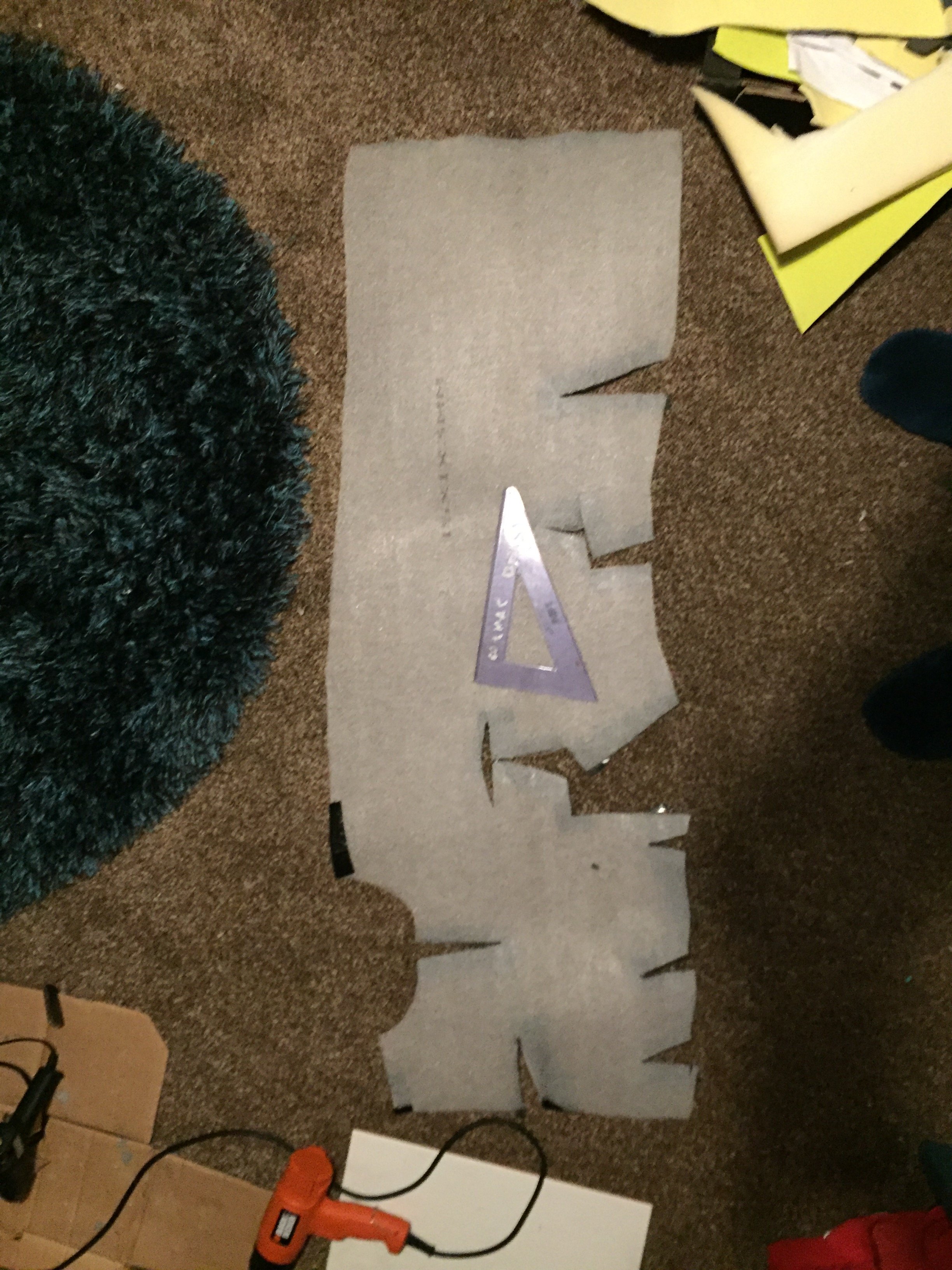

Once i was happy with the "bones" of the torso I took some thin foam sheeting i had available and began to mock up the patterns for the upholstery foam skin. Again this was just a mock up so there was lots of cutting and taping involved.
Once i was happy with the rough form i had i removed this foam and flattened it out, making cuts as necessary, to create something that resembled a pepakura template.

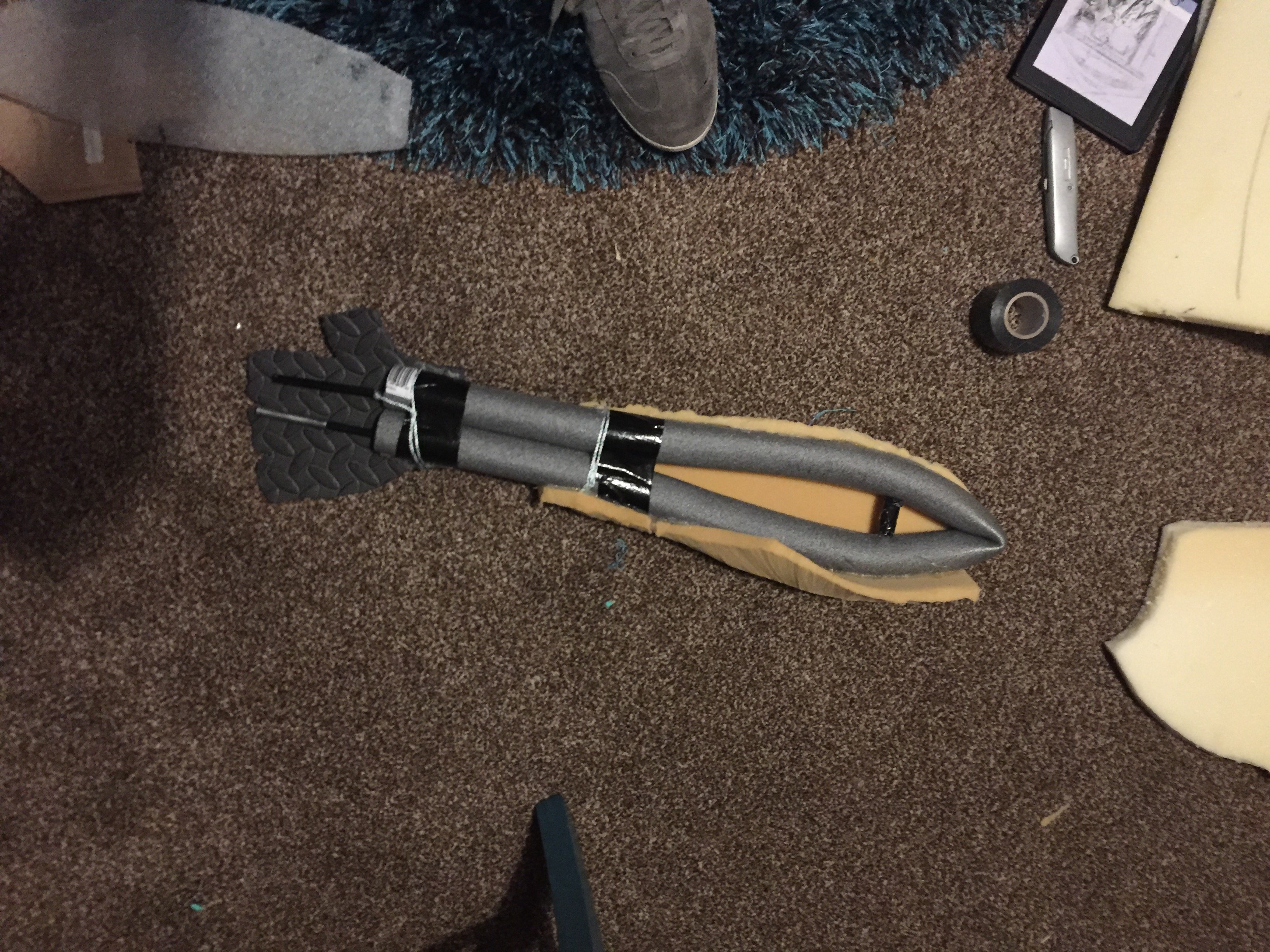

These were done in a similar way. More pool cutting and taping of pipe insulation until i had something that gave the overall proportion i was going for. The main thing i wanted to achieve here was the width of his shoulders and the hunched back.
I haven't got any pictures of this with the skin attached unfortunately. once it was removed and unfolded i was able to make it into a pattern which i split into two halves.

So once i was happy with the patterns I had created I began to work with the upholstery foam. I transferred the patterns to the foam using a sharpie, then cut them out using a large ceramic kitchen knife. In my experience the best way to get a decent cut through the foam is to use a long blade.
These were then folded and glued. I burned through a lot of glue sticks at this stage. It also took longer than expected. The foam insulates the glue so it takes a long time for each seam to set. This means a lot of time is spent holding the seams in place.

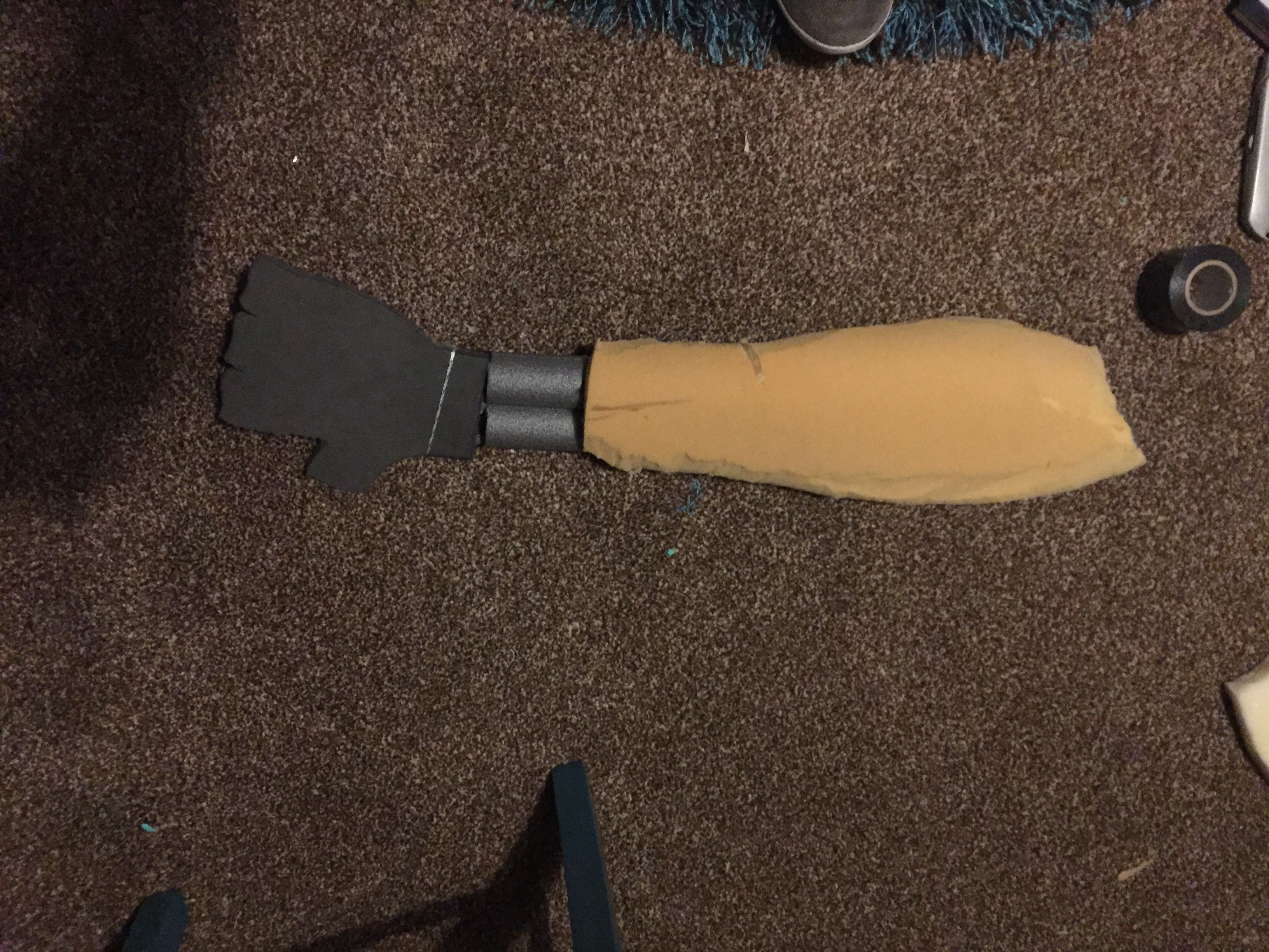

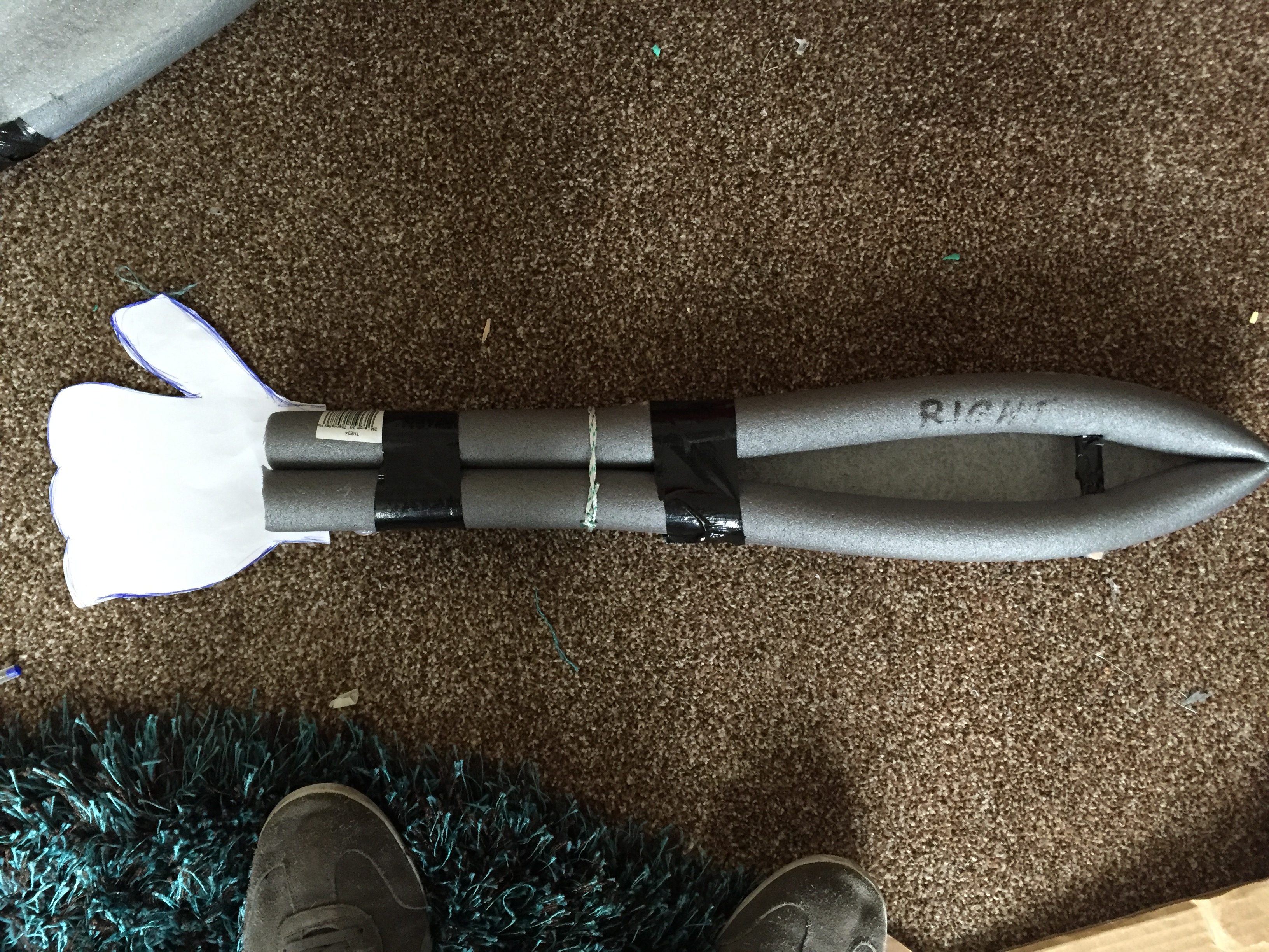

While still trying to source the right fur I began to work on other elements. In particular, the arms. Sully's arms hang quite low, almost to his knees, so it was clear that i would have to extend my own. Pipe insulation & some upholstery foam was used to create the forearm structure.
In the above photo the hand (without fingers) was mocked up in paper for scale. This was transferred to some EVA foam and upholstery foam was used to build the shape of the outer arm.
(I'm really sorry about the appalling photos in this post. I was figuring this out as i went so i didn't know what would make the final cut)
I decided not to include any structural material in the upper arm. This would allow a greater range of motion. A nylon strap was attached at the elbows and used to hang the arms from the shoulders. I included a buckle on each so that they could be easily separated for transport/storage and to make it easier to suit up.

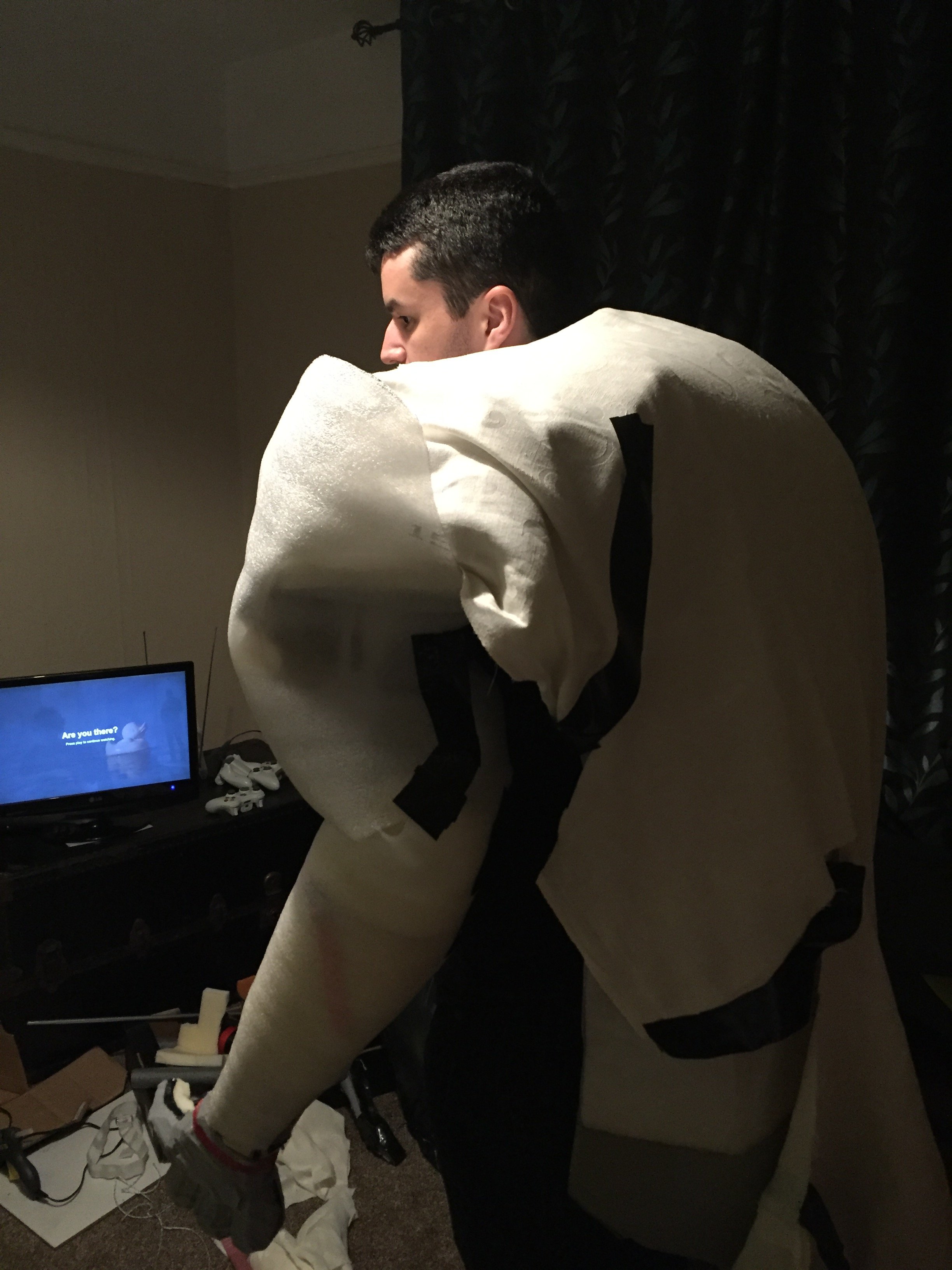

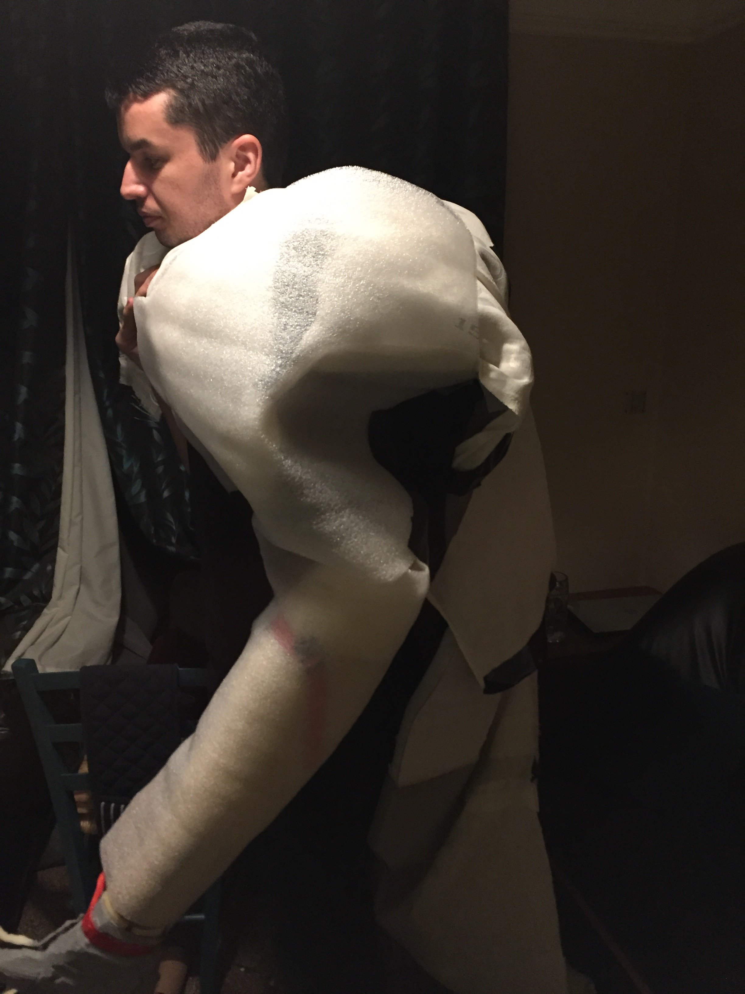

Using some scrap fabric/underlay i mocked up the fur sleeve which was to go over the arms and attached it to the Back/Shoulders section.
Sadly i didn't take many photos at this point so i'll quickly run through the next few steps.

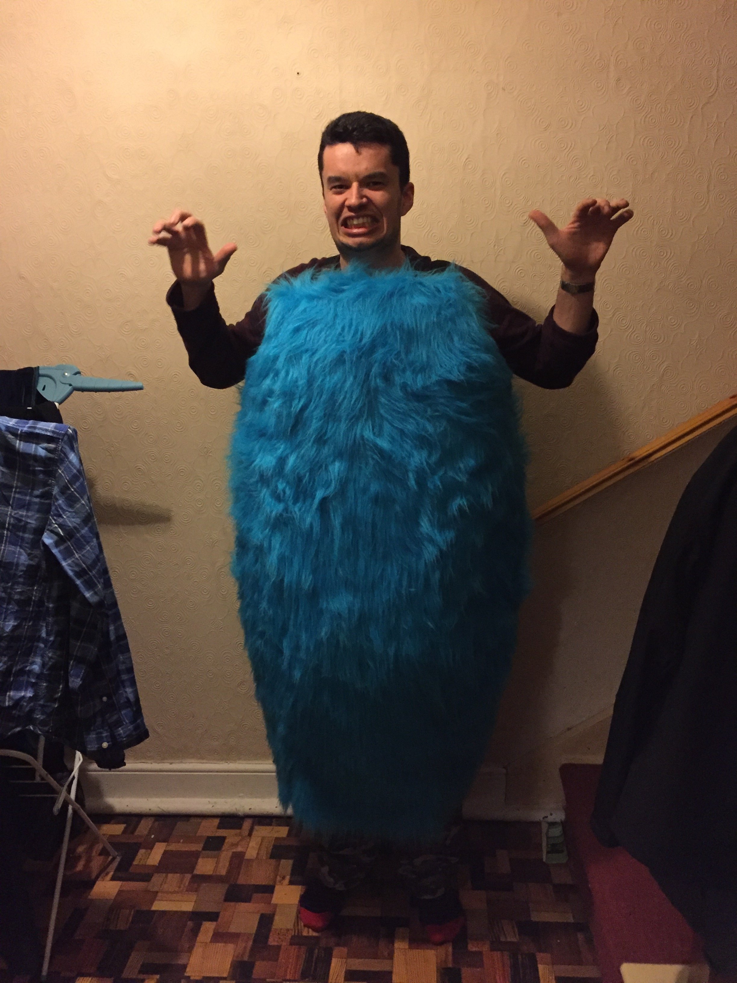

-I attached (using glue and a number of cable ties) the foam skin to the skeleton i had previously made.
-I used the same templates as used for the Upholstery foam and cut out a pattern from some scrap fabric. in this case i used some old curtains. Since this had to go over the foam I allowed a couple of extra inches all around. This was pinned to the foam skin and trimmed/patched/adjusted until i had a decent fit over the body.
- This final pattern was transferred to the fur, cut out and attached to the torso.
I finally had something that looked more like part of a costume than the contents of a bin.
The sense of the scale of this project started to set in while wearing this. It began to feel pretty unwieldy and i could feel my knees hitting the lowest piece of the inner frame. I realised adjustments would need to be made later. However for the time being I decided to leave it as it was. the frame was awkward but it helped to support the shape and made it easier to work on.

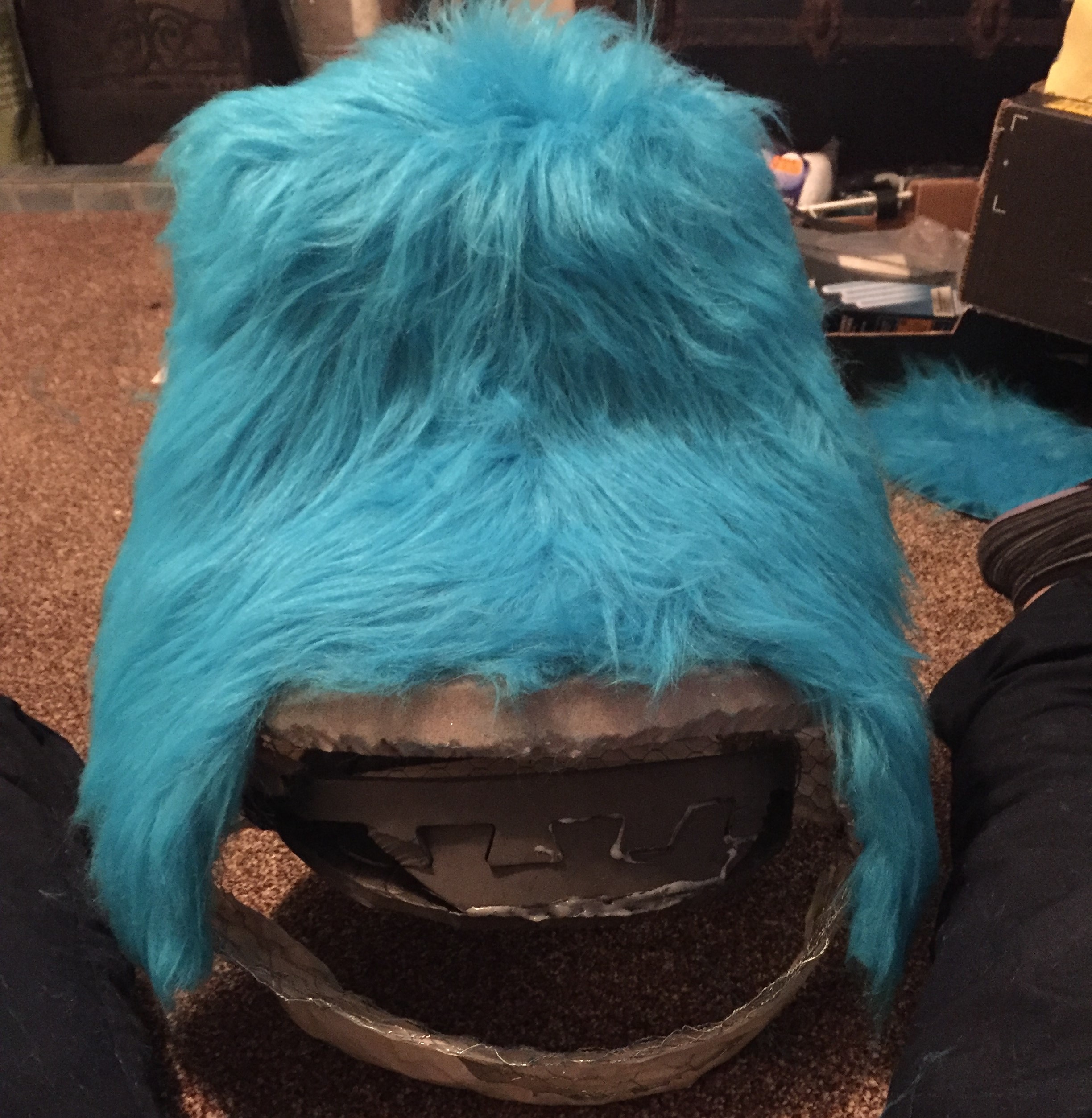

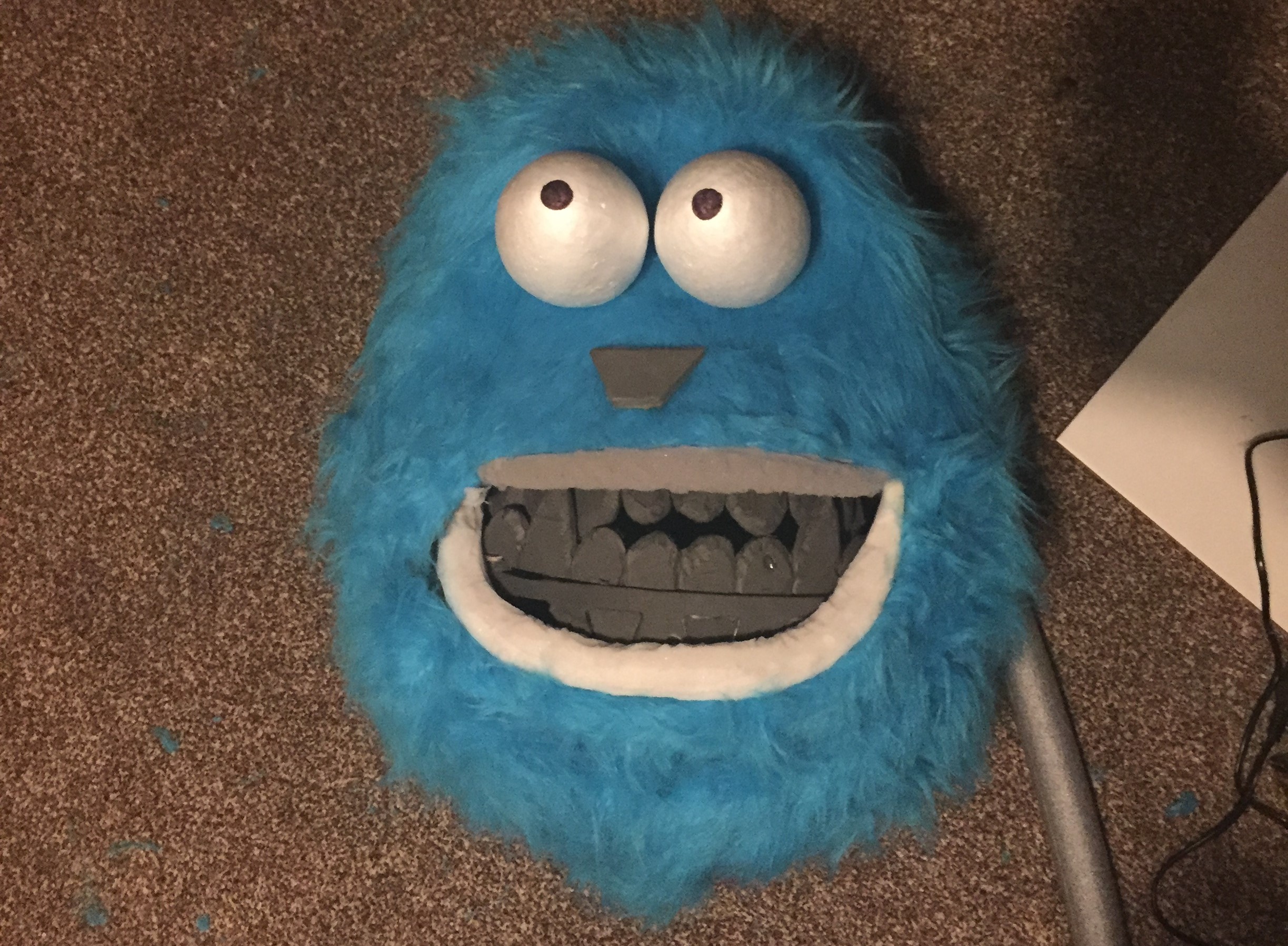

I began by creating a rough cardboard frame to get an idea of some of the proportions. Wire-mesh and then masking tape were wrapped around this to create the 3D structure.
A quick sketch was then used to help figure out the placement of the main features. I had a plan in mind for making the lower jaw movable. You can see below that I attached a strip of foam where the upper lip was to be. Then I cut out an over-sized space for the mouth.
(Honestly! I promise you this turns out pretty well in the end)
Getting the pattern for the took a little while but thankfully the pile is quite deep and it hides a lot of imperfections. You can see the inner jaw in the above photo. It was made from a few spare pieces of EVA foam and hung from the inside of the wire mesh. a few pieces of elastic were attached so that it would spring shut.
IMG_4749.JPG(every time i see this photo i wonder how i didn't give up there and then)
I created a bottom lip from upholstery foam. I used this to determine the shape of the mouth. The fur and the lit were attached to the inner jaw in the centre with the sides left free.. This created the most natural looking movement.
After that some nice big teeth were cut from EVA foam and fitted to the inner Jaw.
This made sully happy.

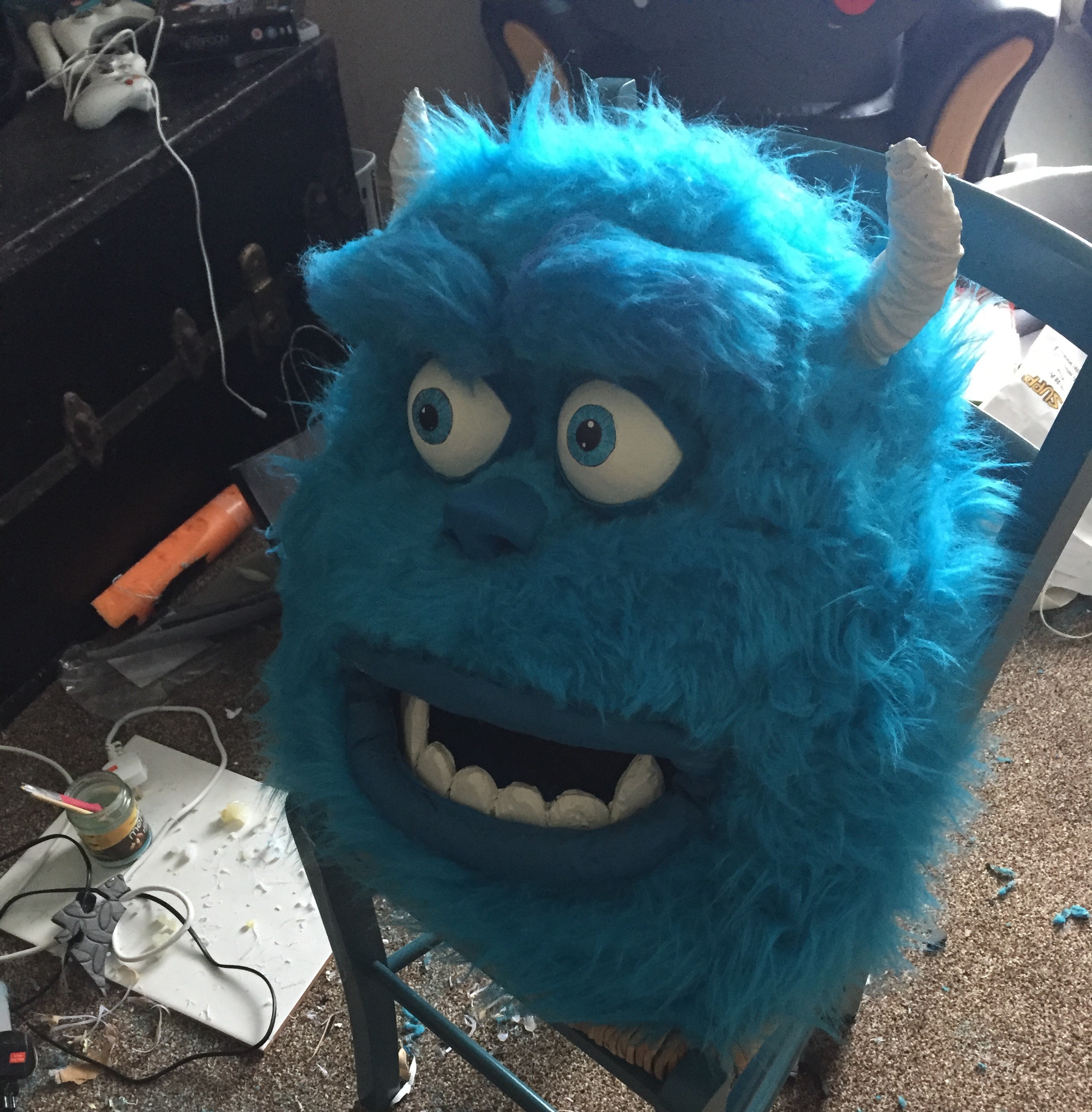

When the eyes went in the face really began to come alive. This along with painting the teeth and lips made a huge difference.
The horns were made from foam and wrapped in fabric in a rough spiral. The same fabric was used to make the eyelids before both were coated with liquid latex and acrylic paint.
The eyebrows are made from short sections of foam wrapped in fur and stitched in place and I made a nose from a piece of high density polyurethane foam i had lying around.
As I promised above, this piece of the costume looked pretty rough for a long time. I have to admit I had my doubts that it would work out but thankfully it came together in the end. I'm pretty happy with the results.

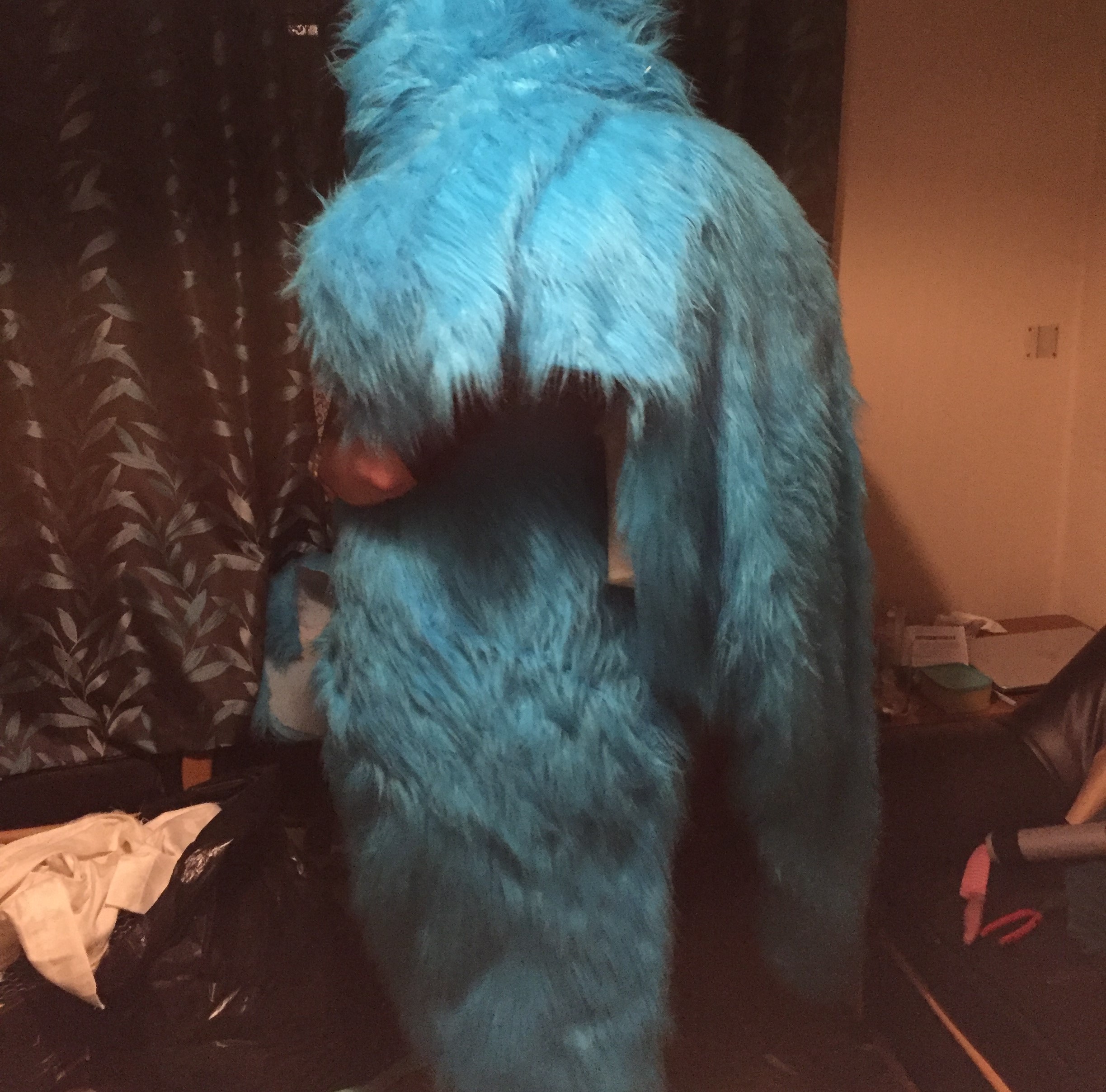

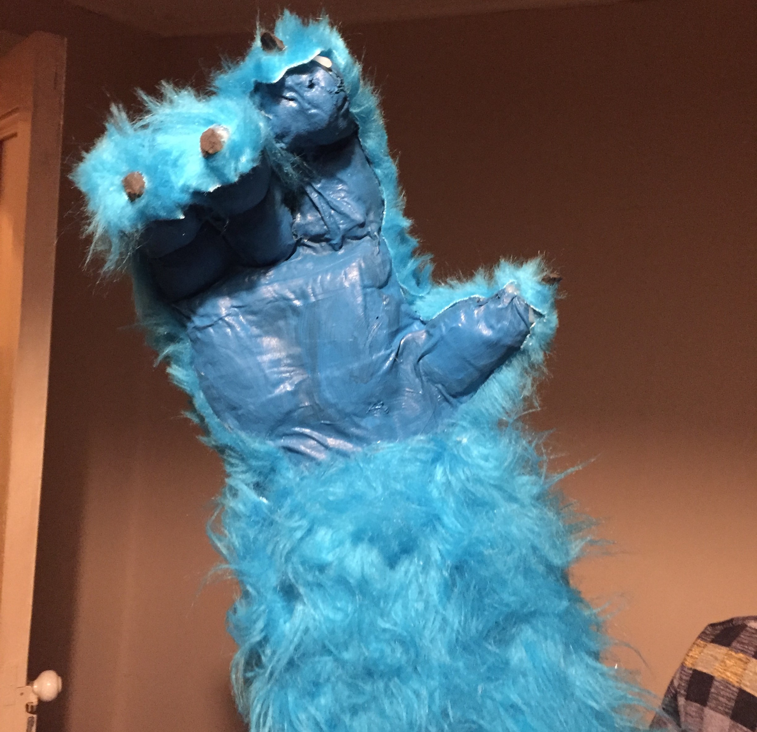

I continued by taking the patterns u had created for the arms and transferring these to the fur. From that I was able to create a sleeve to go over the forearms i had built. Tney also cover up as far as my shoulder. Upper arm was left loose. Later I would use velcro to attach it to the shoulders of the costume. The sleeves were created with an angle at the elbow. I kept these patterns as it meant i could use them to create the letter jacket later.
The palms of the hands were covered in fabric. This was then painted with a liquid latex and acrylic paint mix. The claws were cut and shaped from EVA foam and attached with hot glue before the back of the hand was covered in fur. Again the depth of the fur helped to hide some of the rougher edges.

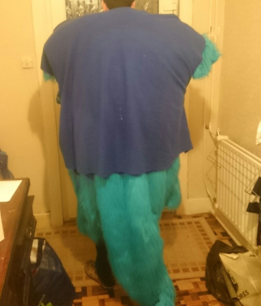

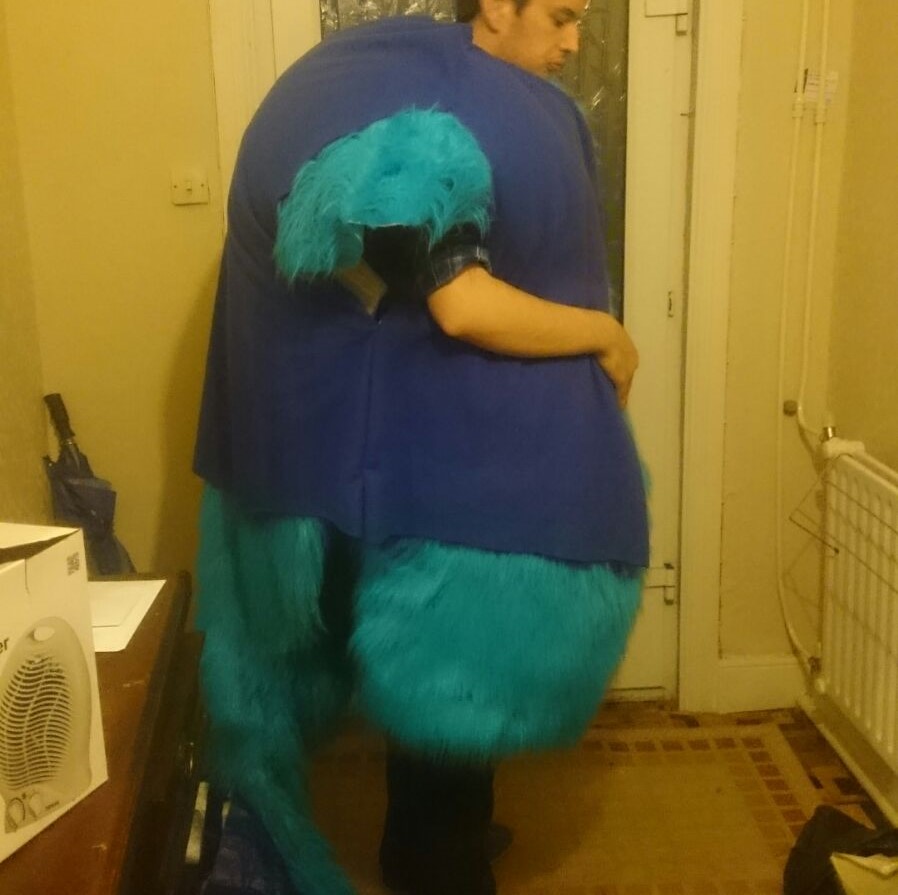

As i began to assemble more and more of this costume i realised that I had gone overboard with the initial frame. Had i continued as planned the suit would have been far too large and rigid. It would have been impossible to go out in public. The tail in particular was completely impractical.
I began to cut away the frame. The upholstery foam skin gave a lot more rigidity than i had imagined. As a result i only left a few structural pieces around the waste and across the shoulders. I also made the decision to remove the lower portion of the back and the entire tail. The lower back would instead be made from only fur There was definitely a trade off between the overall look and usability here but given that this was to be a halloween costume and needed to be worn in public i don't think i had much of a choice.
The fur was attached to the foam using a spray adhesive. I left the areas at each shoulder unattached. under these flaps i fixed some large sections of velcro. I used the "hook" side on this and the "loop" side was glued to the upper sleeves. Between these and the plastic buckles i could attach and detatch the sleeves as necessary. They would also hang in the correct position even when my arm wasn't in the sleeves.

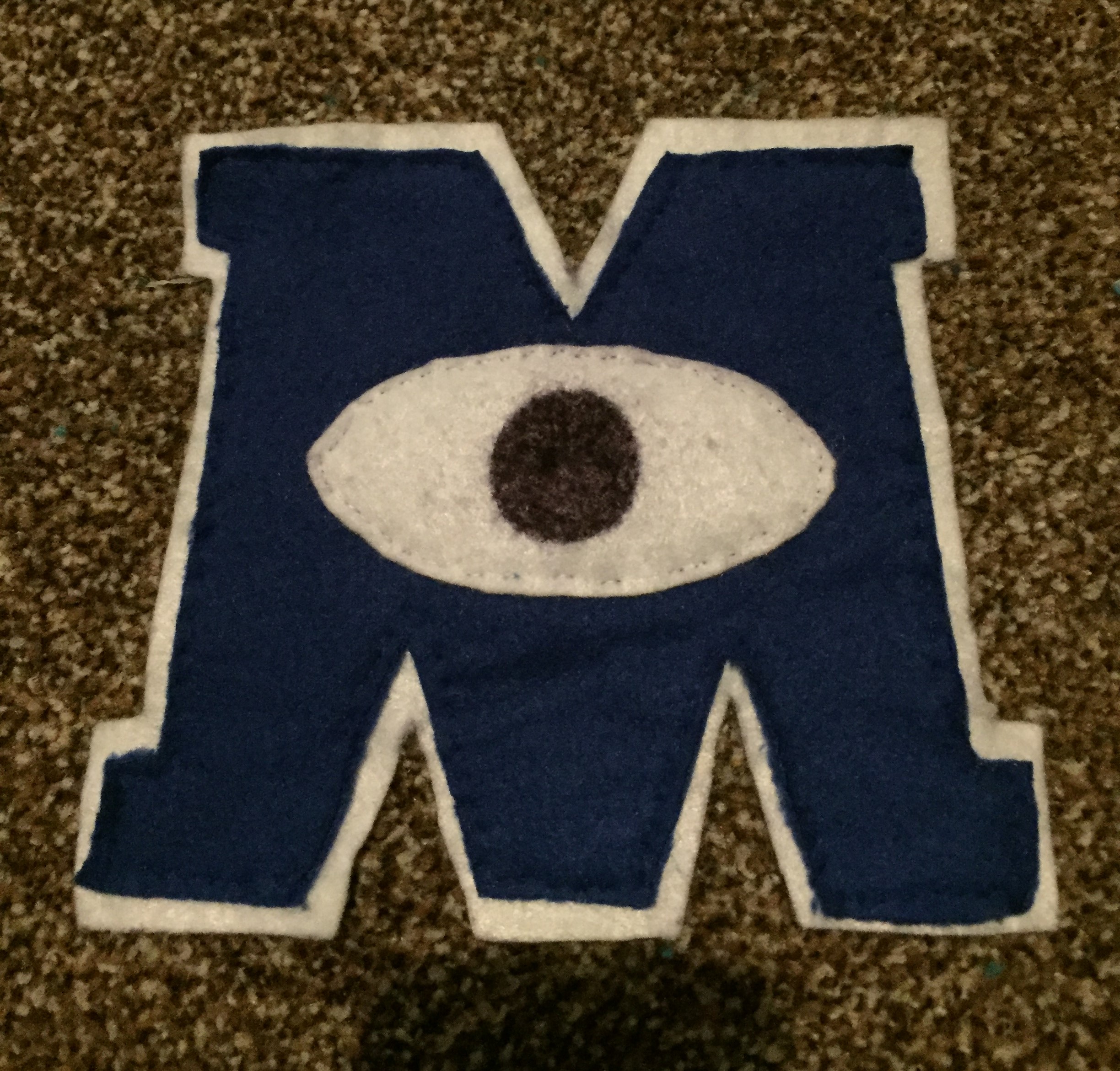

The logo is just three pieces of felt with the black dot drawn in with sharpie.
