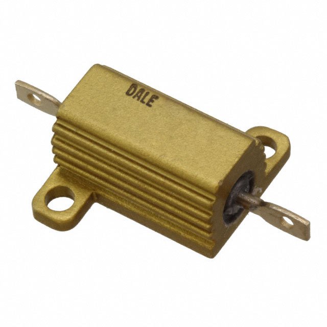

Second, anyone have any ideas what the yellow and blue thumb switch is?

The "thumb switch" very much appears to be a WIREWOUND RESISTOR made by DALE ( now Vishay ), or at least its outer shell. Probably the RH or RER series. Not all will have the same exact size face though, the face (or top) of that one is fairly wide. The shape would change depending on the specs. I have some in stock right now that are longer with a more narrow face/top. It looks like they have the inside of it pulled out somehow or maybe they used something else. They scratched the writing out but you can see what looks like 0003 in the bottom right of that part, that is the date code. Here is a stock photo I found on Digikey and a link to some on ebay that appear fairly close in size, although you can find others on there too that may work better:

I believe @CLWTUSKEN is on the right track in identifying the part. From @Soulinertia photo I read the middle line as EDIT Better eyes prevail CHANGE MY ORIGINAL 4 Omega or 4 Ohms TO 1 Omega or 1 OHM and 3% which indicates a 3 percent tolerance on the value, an indication of precision and quality. These wire wound resisitors have an aluminum shell to help dissipate heat.
EDIT the line above ends in 25W for 25 Watts, a power rating.
Great close up! So this time it's obvious. As I mentioned before the outer piece is a RH series resistor made by Dale. In this case it is specifically a RH-25 25W 1 OHM 3%. The 8003 on the bottom is the date code. You wouldnt NEED to get a 3% to get the same look. Someone on Ebay has the 1% version, its the same thing:
http://www.ebay.com/itm/VISHAY-DALE...765465?hash=item3f38326159:g:ThAAAOSw7ThUmTRl
Regarding the round knurled piece attached to the side, I have no idea. Could be a knob, a lid, a wheel, a gear? I dont know how they would have pulled the inside of the resistor out, and I dont think it looks like that if they did. They probably cut the terminal off that side and glued that round thing in place. The other piece attached to it looks alot like a toggle bolt/butterfly anchor, except the end in front of his thumb is weird.

The new global part # for that item would be RH251R000 followed by a letter to designate tolerance. But they dont make a 3% anymore. The letters/tolerances are:
D = 0.5 %F = 1 %G = 2 %J = 5 %
An example part # could then be RH251R000JS03 (the S03 just calls out 10 per package) A general rule is the lower/tighter the tolerance the higher the price. I just looked around and Avnet Europe is the only disty with stock on them. They run about $7.11 each and they have 20 pieces. I dont see any availability on the other part #'s at all, these are all NCNR items now so noone is really stocking them. I do see some availability (but it's in France) if you just call it out the old way = RH25 25W 1OHM 3%. There are also some companies in California with stock on the 1% version which should be the same size. If you can get the Ebay ones cheap enough that will be your best bet.

To be clear, I was just asking about the knob attached to the resistor, not the resistor itself. I already have a couple of those on order. Picked 'em up for about $2/ea. :thumbsup
One possibility for the cylindrical portion of the part might be a brass knurled nut. These come is several diameters and lengths so until I have a resistor in hand I am not sure what size would work.
