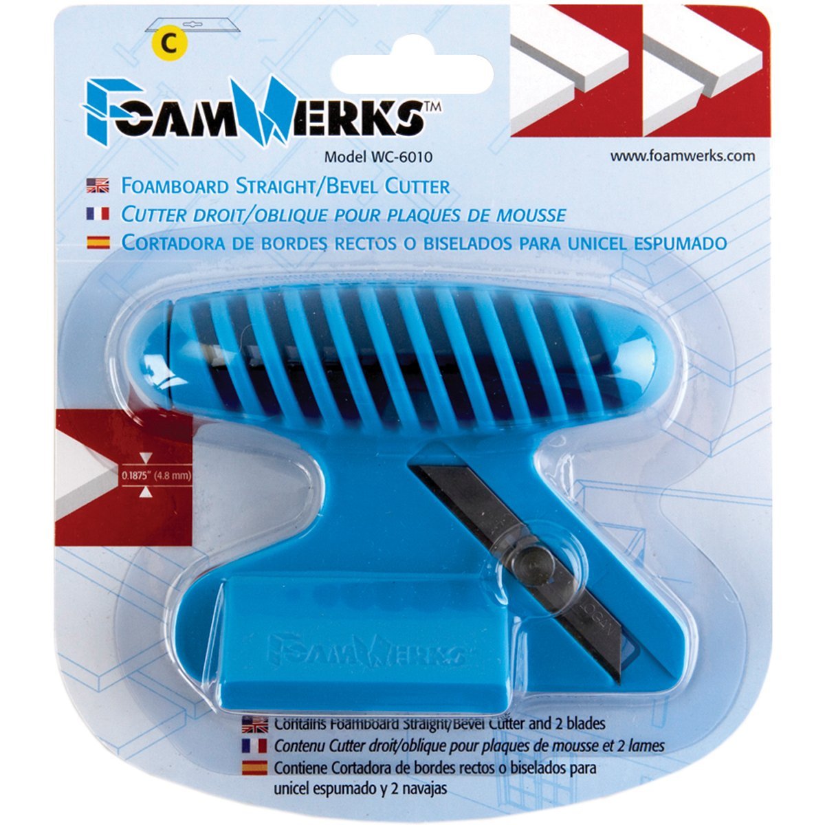

I am going out on a limb, here, but I will add this little tid bit to the party:
This is a cutter for Foam Core Board and it has a 90 deg cut, and a bevel cut and a handle for control. I, personally, have never used it on EVA, but I would love to hear from someone who tries this.
