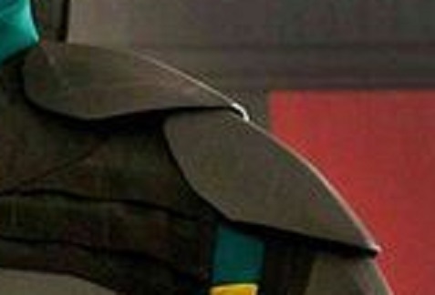

This is how it's supposed to look...

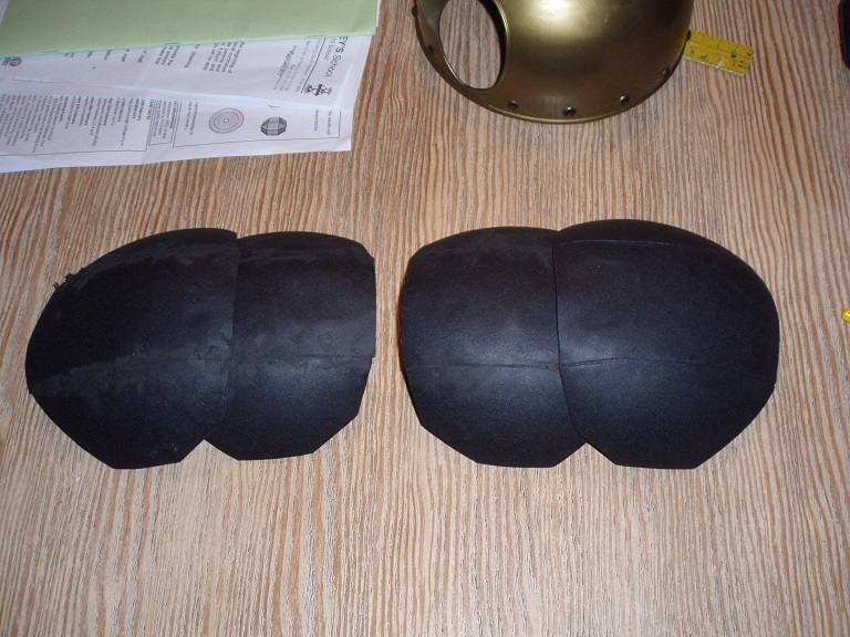

You just can't get the bend on Rubber Maid - especially as it needs to be in two directions.
So, I decided to try Worbla thermoplastic.

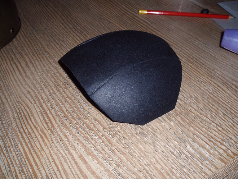

My first attempt was a disaster, but here was my second...

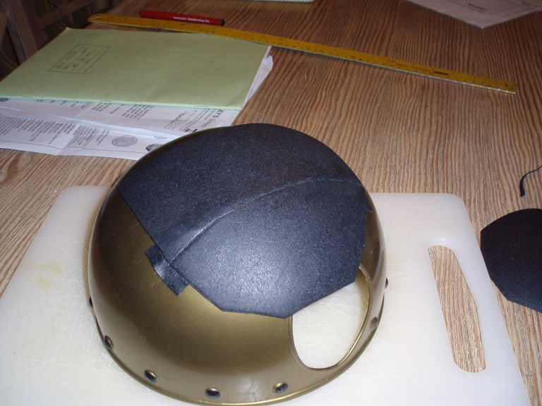

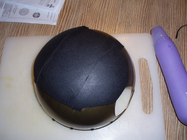

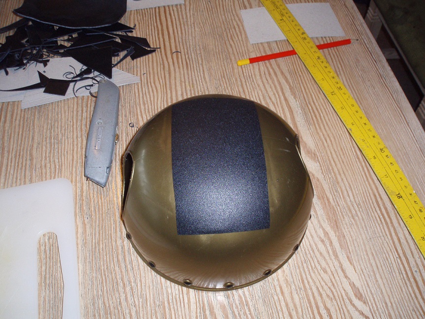

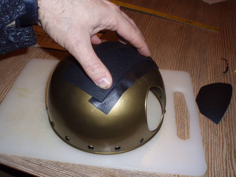

I'm using a crappy old Viking helmet as a mold - it was all I could find that had the right sort of curve on it.
I'm using double thickness of Worbla (each layer is about 1mm) for strength. A single layer seems quite flimsy and all the YouTube tutorials seemed to suggest double thickness.

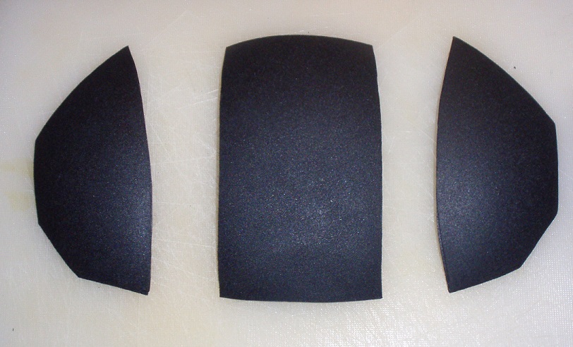

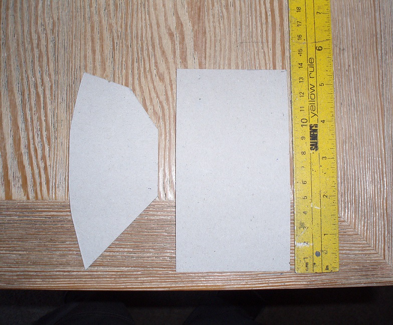

In my first (disastrous) attempt I tried to do the whole shoulder piece in one. For my second attempt I decided to do it in three sections and melt them together. Here's the cardboard templates I used...

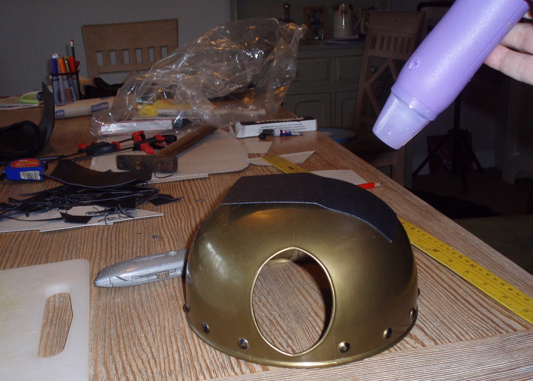

It's dead easy to mold Worbla together with just a heat gun.
Here are the three sections (double thickness) cut and shaped...

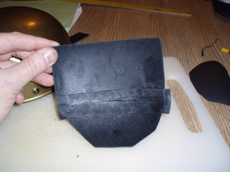

I just used two strips of Worbla (1 inch wide) to stick them together...
Just heat them until they are really floppy and sticky,
It doesn't look too pretty on the underside, but hey...
Here's the three sections together whilst cooling and then off the mold...

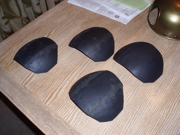

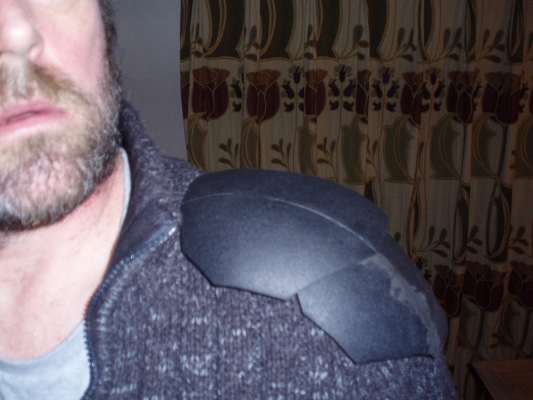

All four done (some have a bit of Miliput to full any gaps on the joins)...

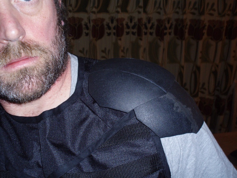

And here's what they look like when paired together..

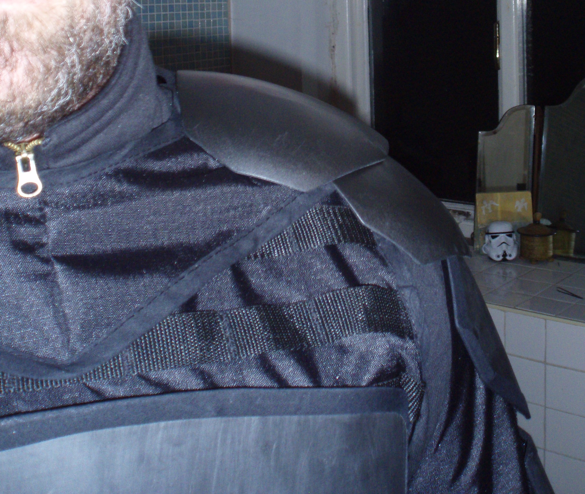

And on the shoulder..
It looks like I've got really narrow shoulders in these photos - I don't! I've actually got very broad shoulders.
Did all this in one day. Tomorrow I'll sand them and give them a coat of PVA before spay painting them with matt black.
I think they look really cool.

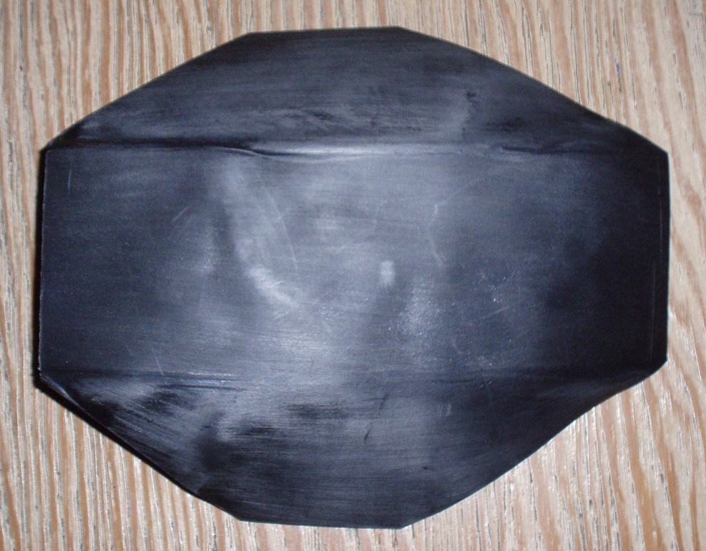

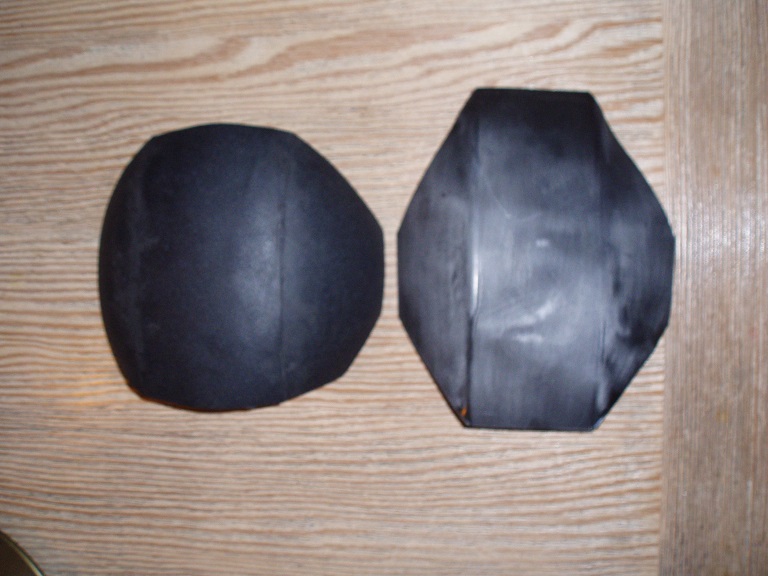

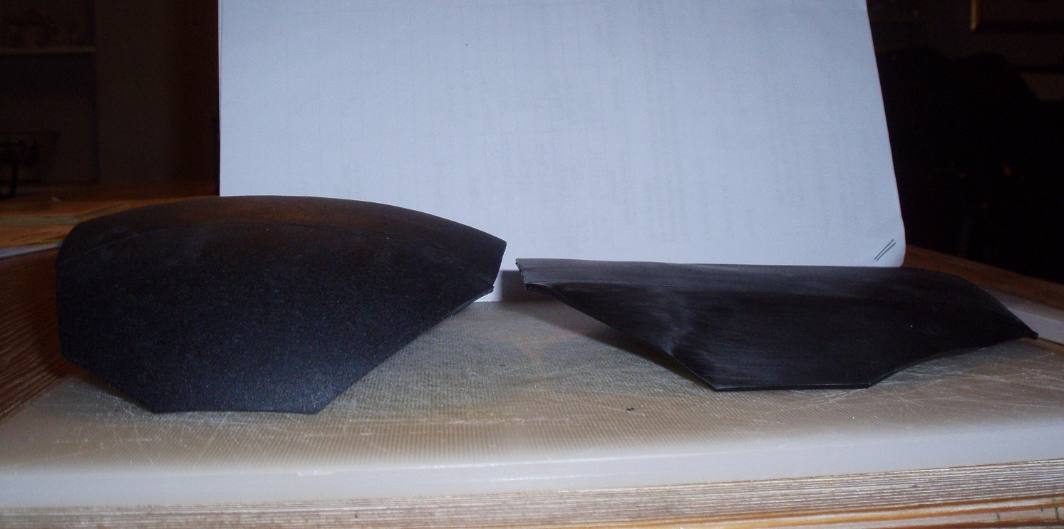

Just to finish for tonight, here's a comparison of Worbla with Rubber Maid...

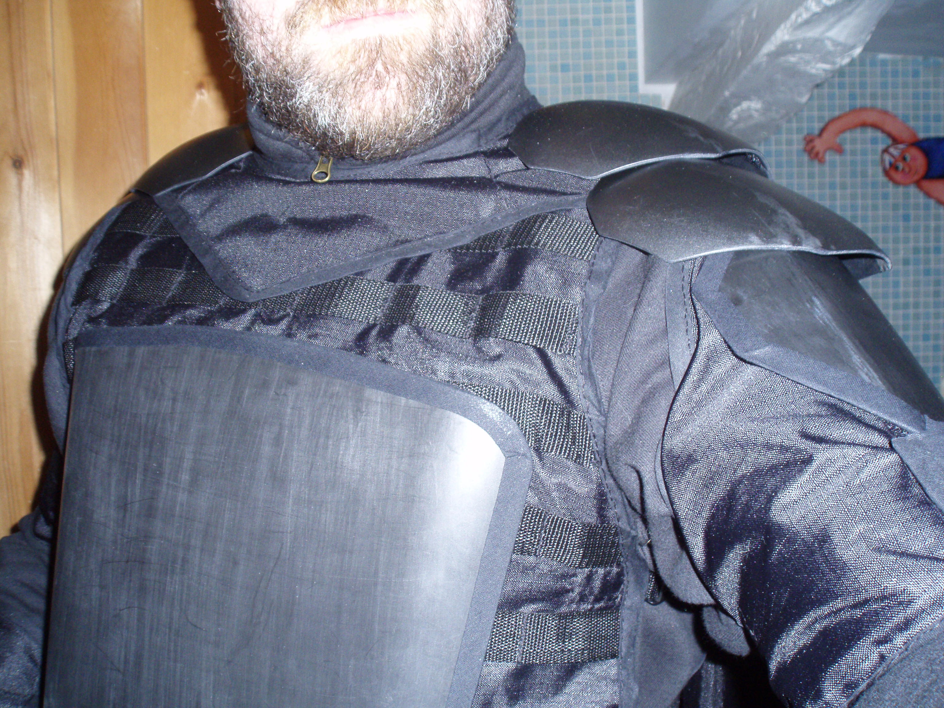

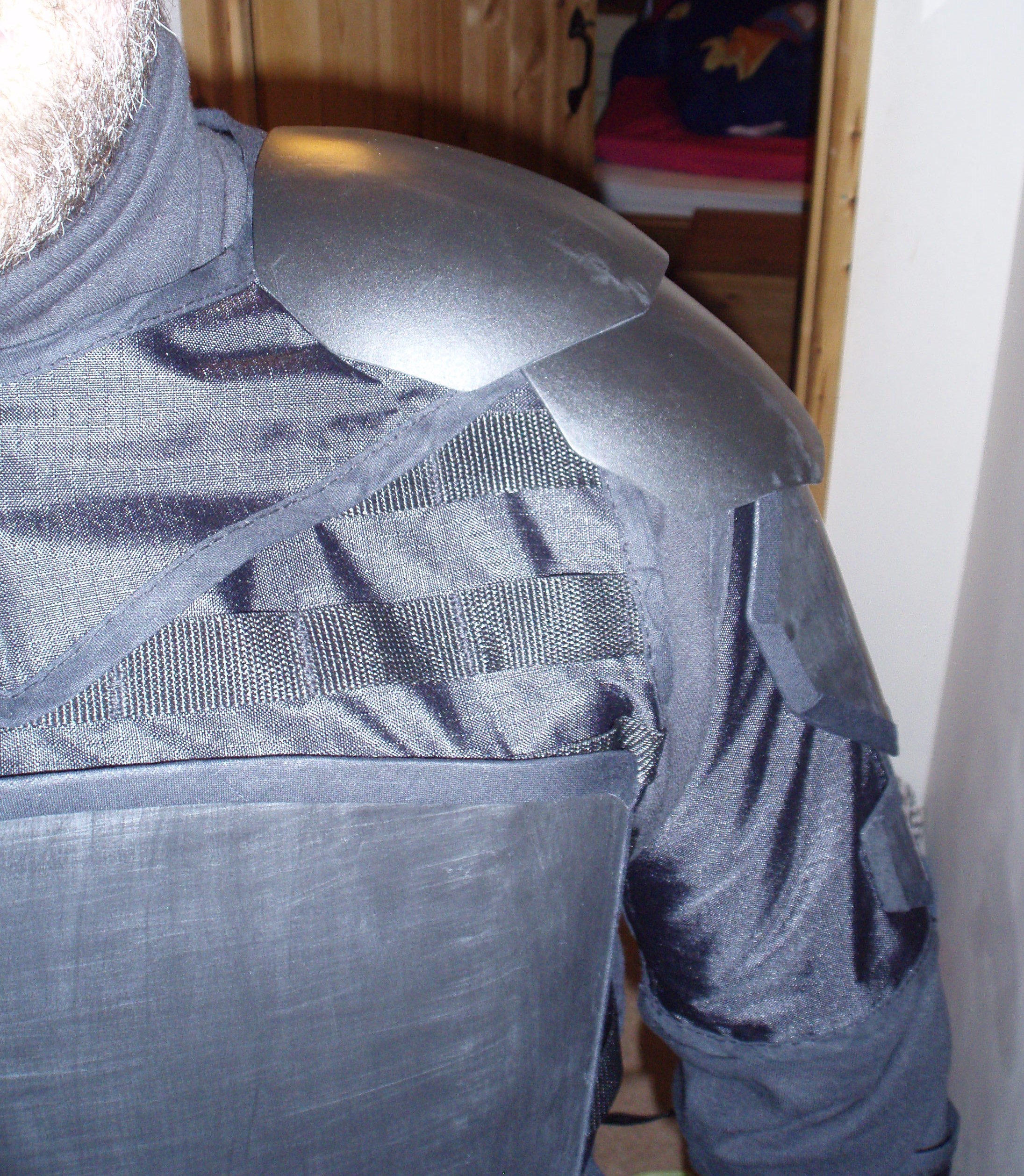

Here's what they look like on the costume.
Sorry about the photo quality - it's very hard to take a good photo of your own shoulder!

I've trimmed the chest plates so they're more screen-accurate..

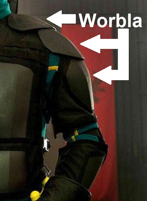

The only bits I've used Worbla on are these..
