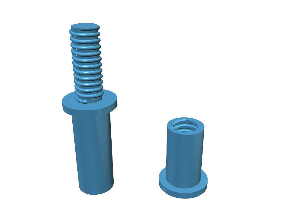

I am in the process of making a staff. I need it to be able to come apart, preferably three parts. The staff pole will be made of PVC pipe, with attached 3D printed parts.

Use a small PVC pipe and put it inside the bigger one - However I want something more secure.
Use pipe fittings - This is my preferred solution but I can't find straight join fittings.
I tried modelling my own for printing however I'm 60% sure that regardless of what it is printed in, it will snap.

I'm also thinking of revisiting my model, Removing the threaded screw and opening that bit up to fit a thread rod that will be locked into place by two nuts on the top and bottom of that piece. Then doing something similar on the other piece to allow the nuts to sit in place.
Could remodel your printed part with a hole down the middle to accept a steel rod for reinforcement.
Yeah that was the plan then I switched to using a wooden dowel instead. However I changed my model to accept a threaded rod regardless so I will have that for any future builds. So basically a nut is embedded in the top and bottom of the model to secure the thread rod and then on the other side it's the same. I think in theory it should work, I'll test it someday.
