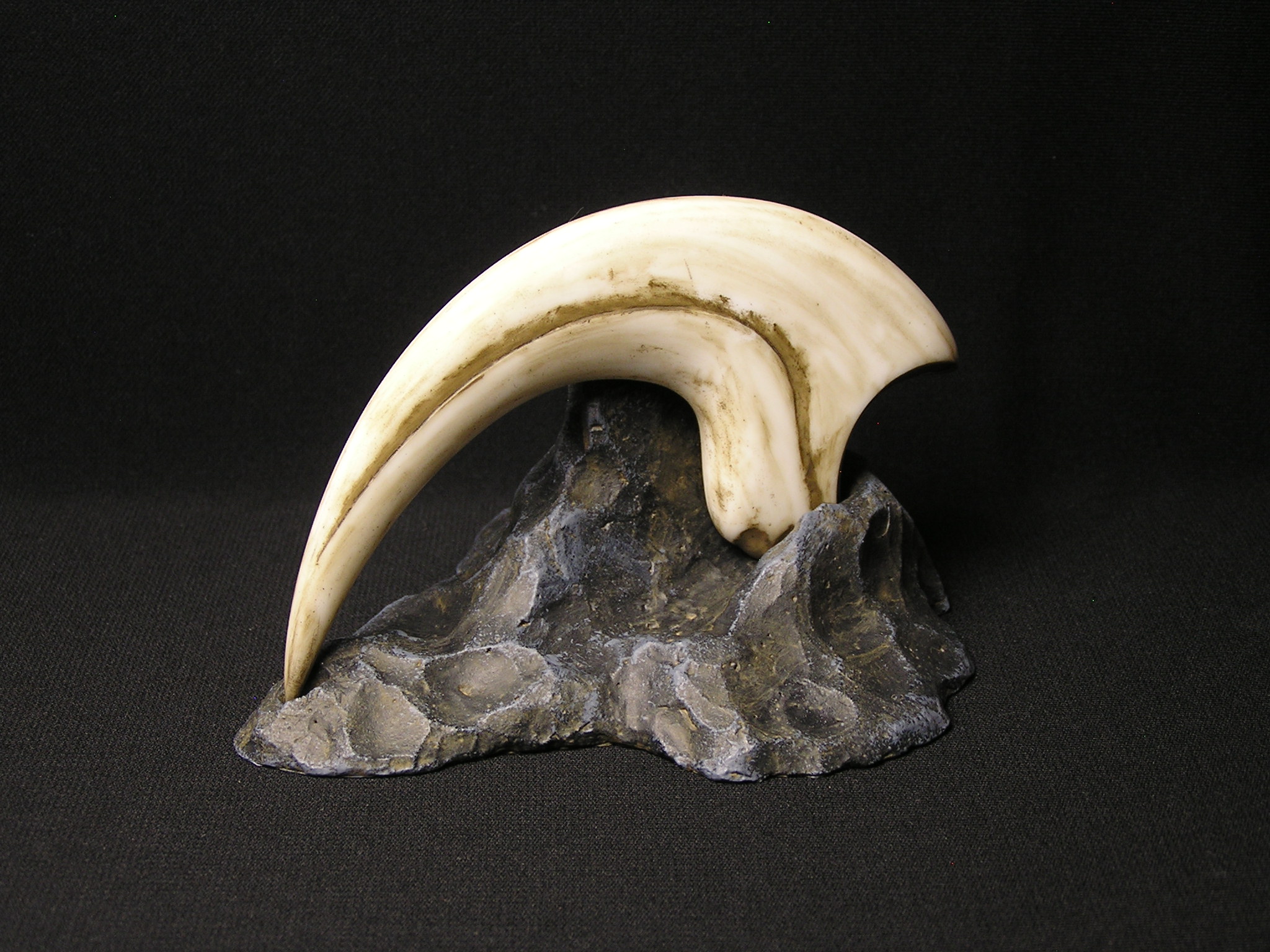

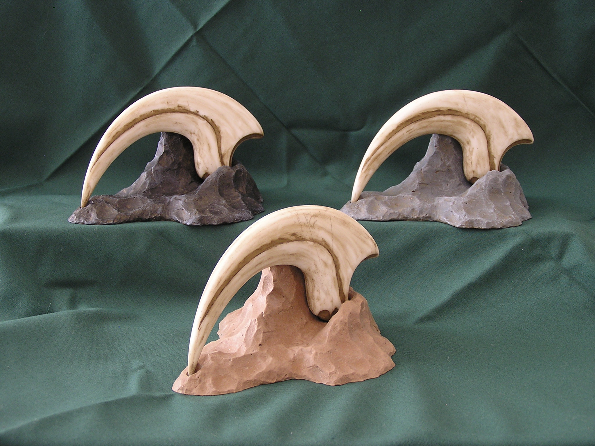

Painted up various ways

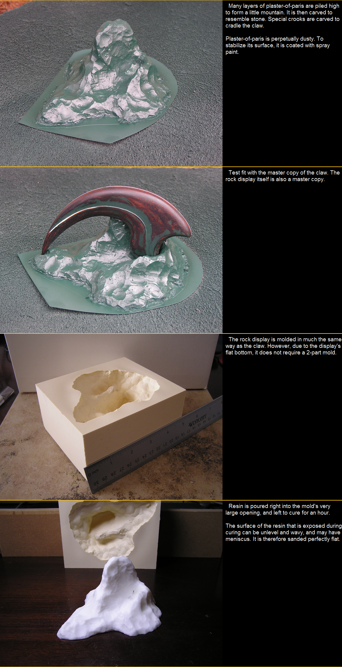

I filled the claw mold with plaster-of-paris. The plaster shrinks a tiny bit, causing visible damage, which I will have to find a way to correct without further ruining the plaster. What I learned from making the rock display base is that when new plaster makes contact with cured plaster, it solidifies instantaneously. It's extremely weird. It doesn't solidify to a rock-like hardness like fully cured plaster; but it solidifies to the consistency of a cookie. The only way to stifle this reaction is to add extra water to the new mix of plaster before introducing it to the cured plaster. Another idea I might try is to apply plaster powder to the claw's blemishes, and then spray water onto that. The recommended mix ratio (2 parts plaster, to 1 part water) will be thrown way off, but it's worth a try. Anyway, the plaster casting only needs minor corrections.

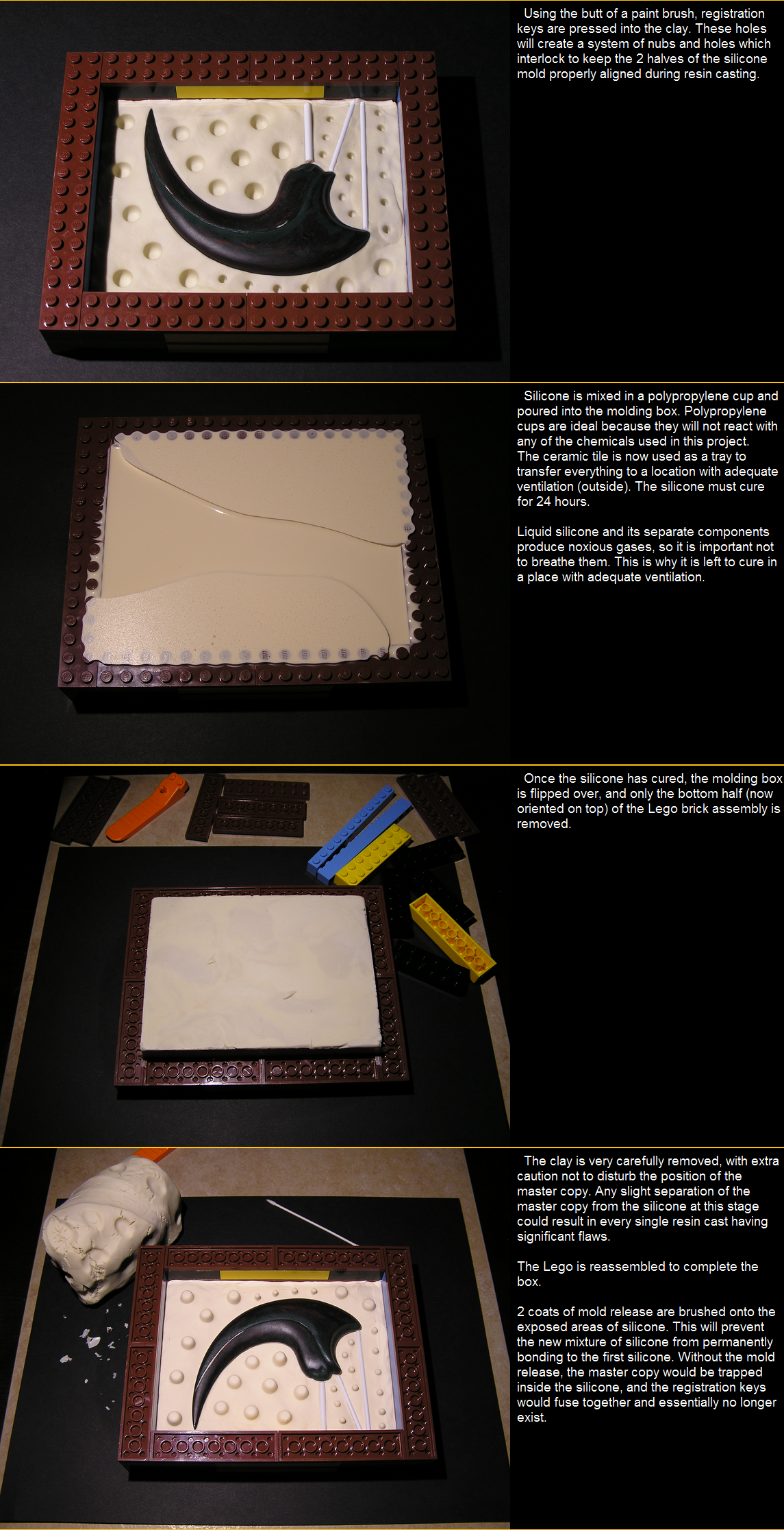

I'm now molding the fossilized claw. I did something different with the clay to make it easier to embed the claw. I used a needle to trace the silhouette of the claw into the clay. Then I carved out a shallow cavity in the shape of the claw. This allowed me to simply place the claw into the clay, instead of pressing it in like before. If I had pressed the plaster claw into the clay, it would have broken apart. Then I carefully pushed the clay towards the edges of the claw to create a seal.
The clay I'm using is apparently low quality. It doesn't affect the molding process, but: As I was taking the clay out of the tupperware I store it in, I noticed a lot of beads of yellow liquid had built up under the surface of the clay. It seems to have been nothing more than the clay's oil, because I was able to knead the liquid back into the clay. Some of the oil got on my fingers, and dabbing it with chunks of clay cleaned it up very easily. I've never seen clay do any of this before.
The only reason I painted the plaster was to seal it. The paint is the seal.
