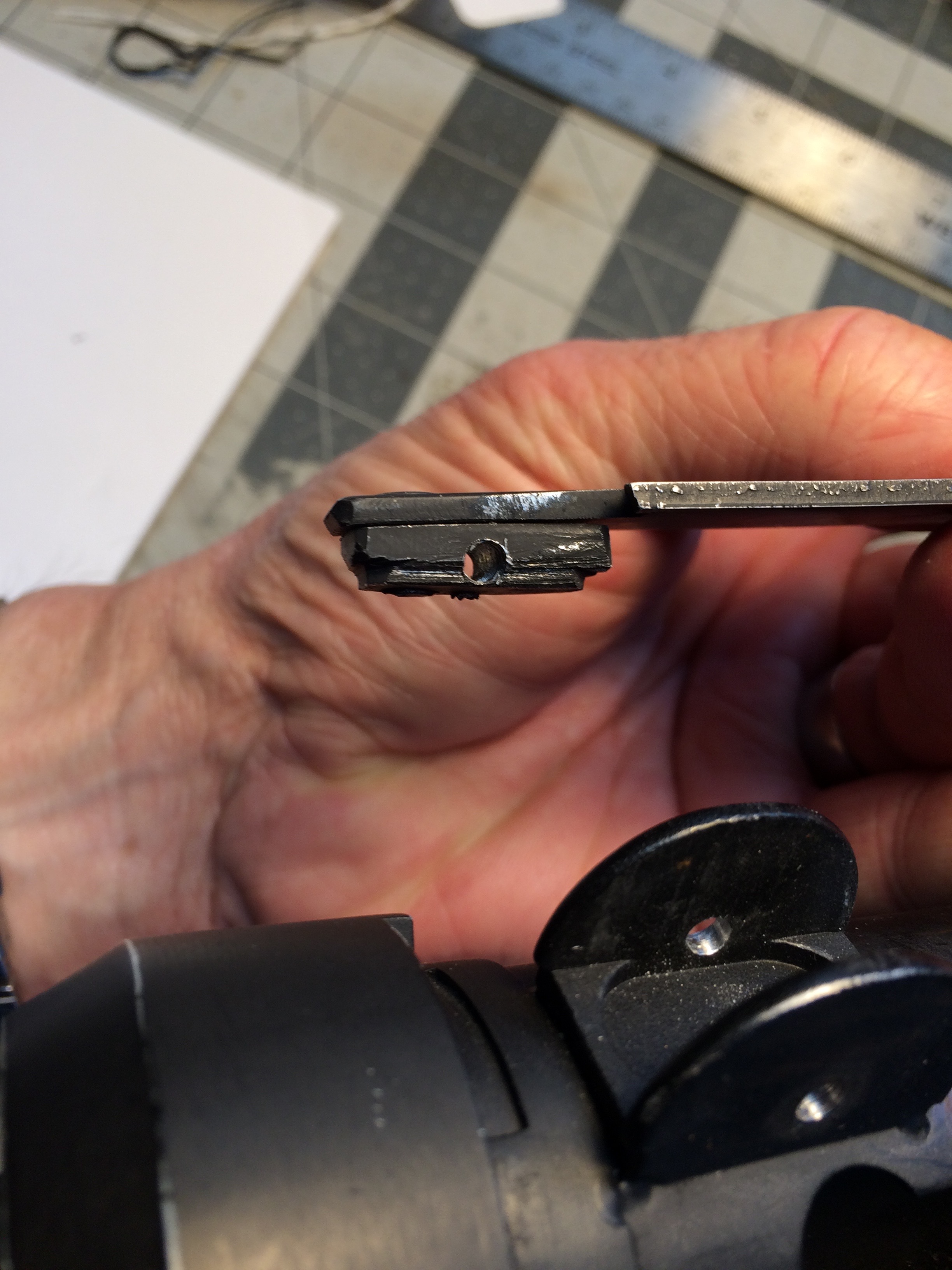

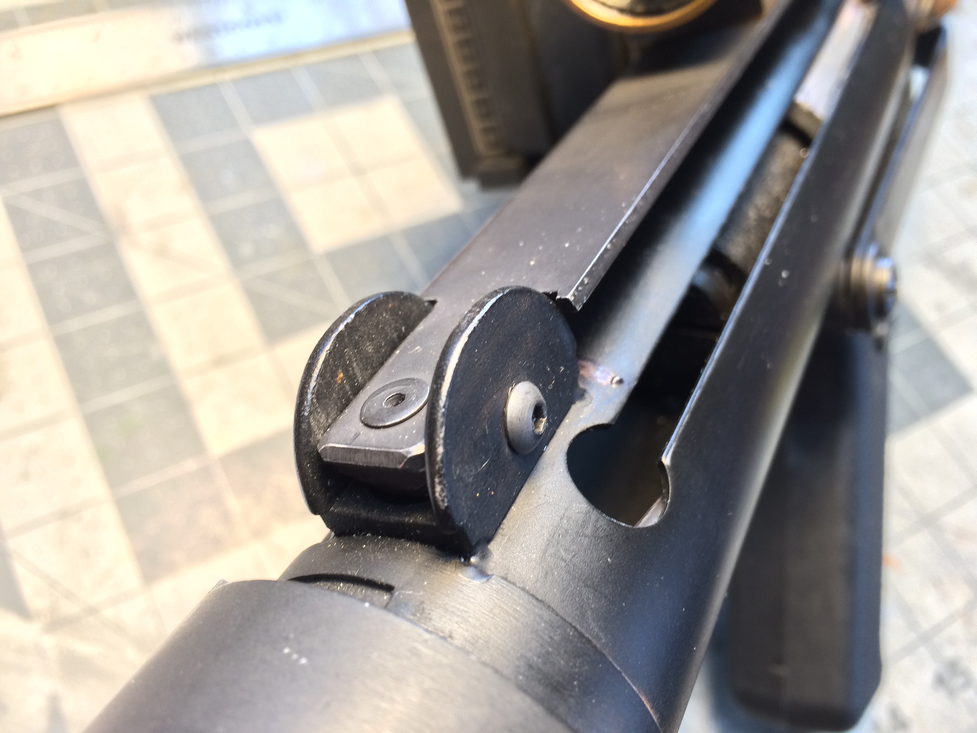

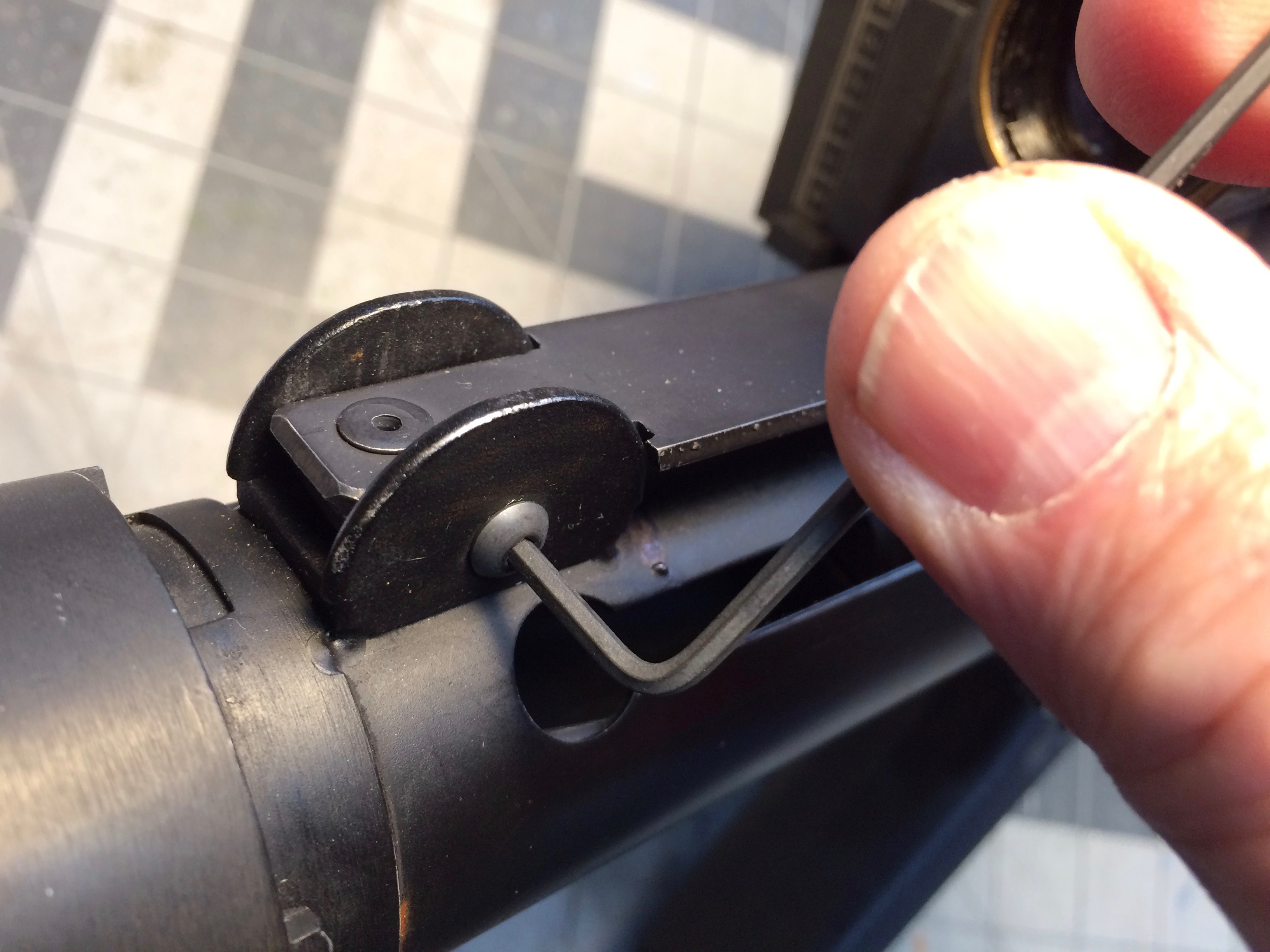

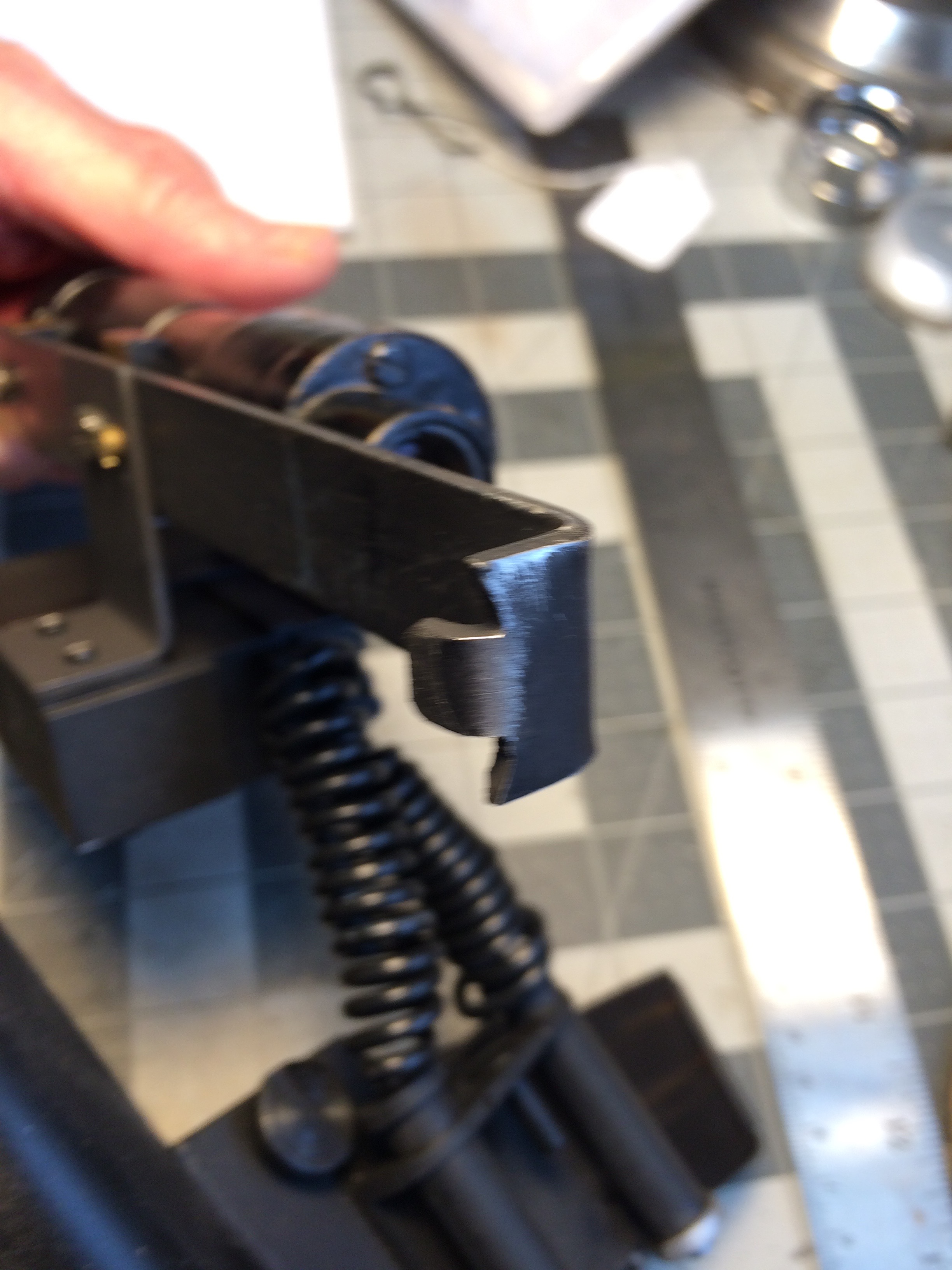

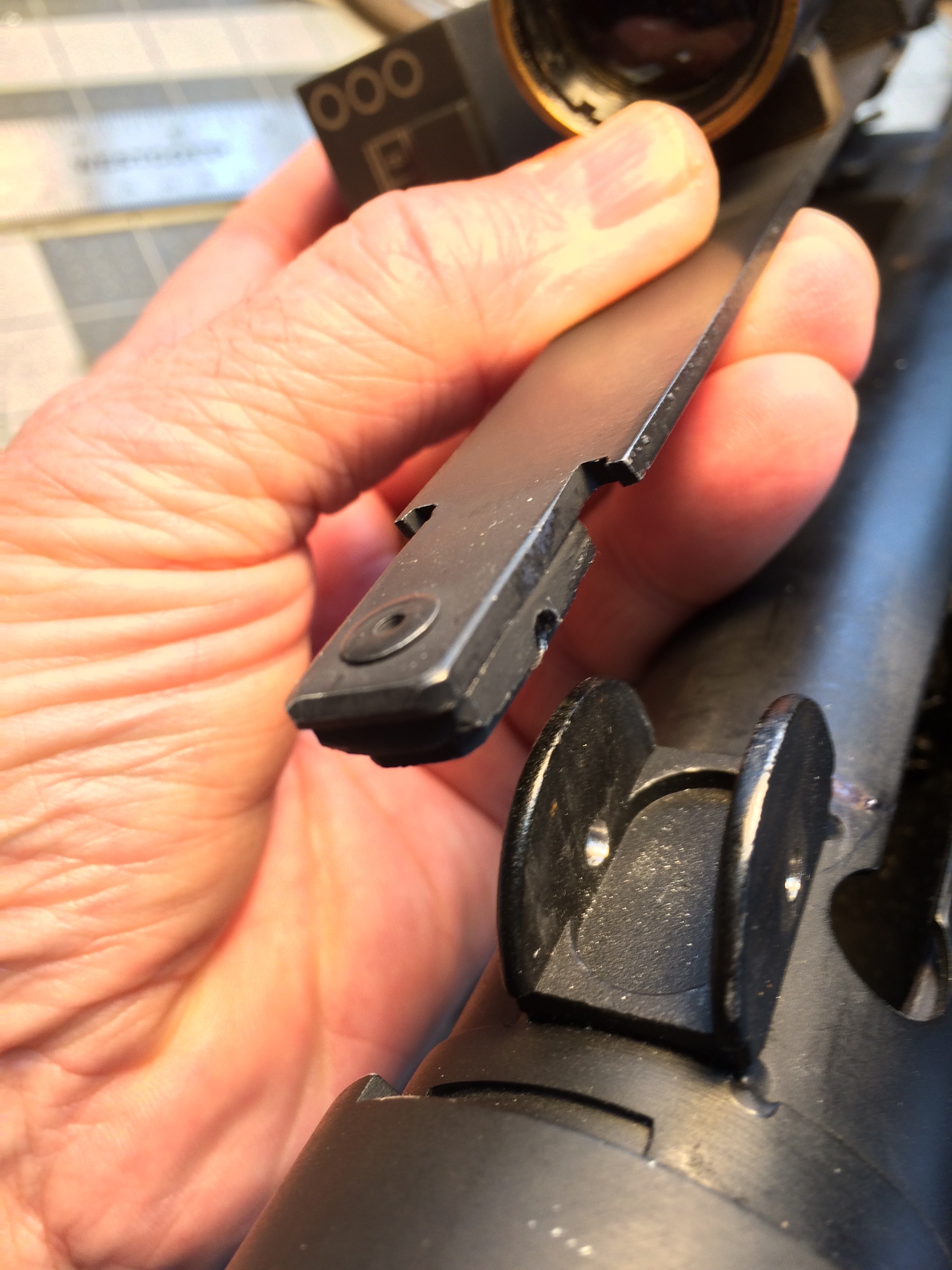

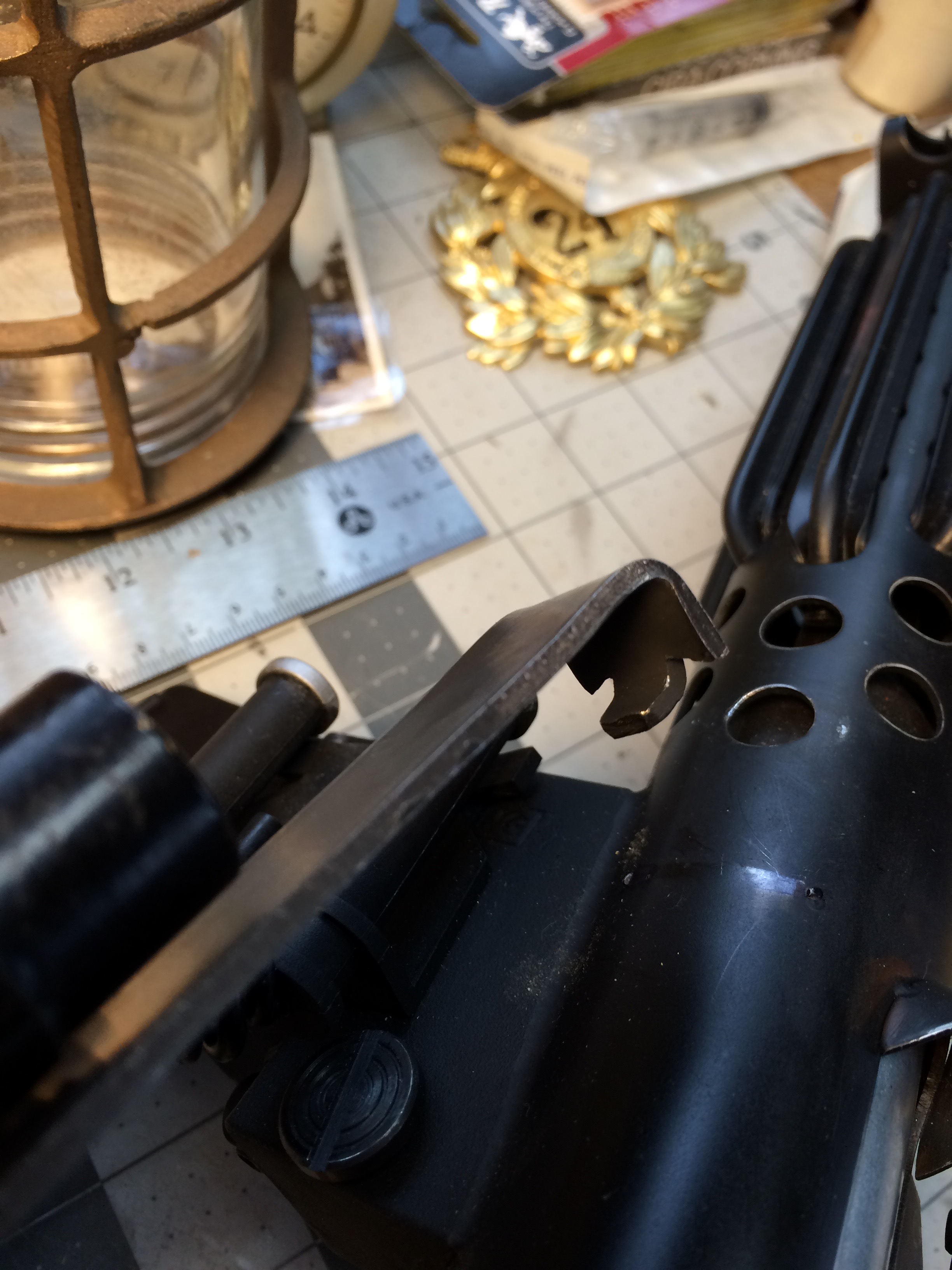

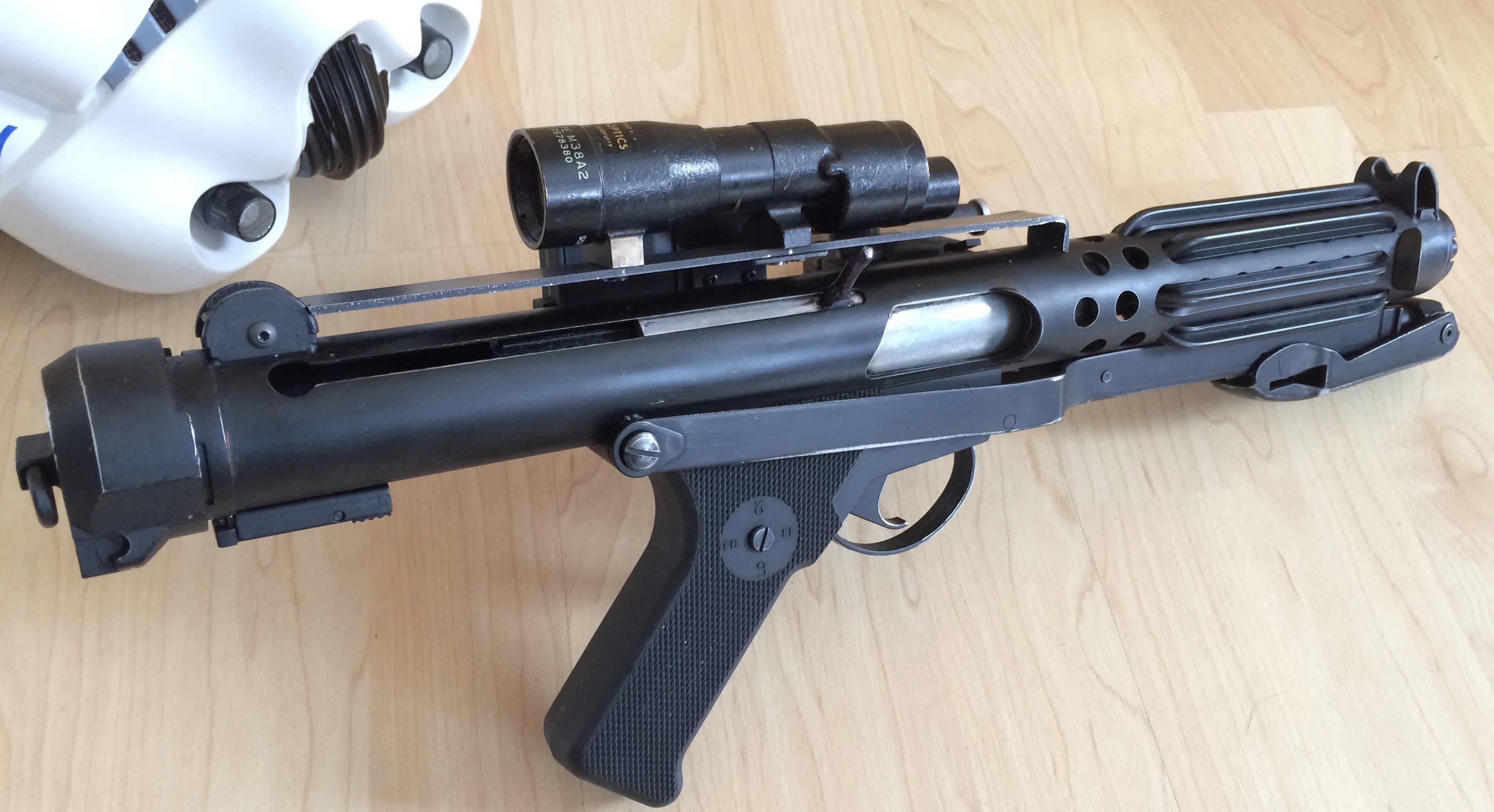

Picked up the new airsoft E-11 and have been having fun modding it some. I made a new scope rail and put an M38 A2 scope on it. I am waiting on a real Hengstler counter that I found. I took it into a local airsoft shop to get a battery that would fit and they went ga-ga over it. IMG_2666.jpgIMG_2664.jpgIMG_2692.jpgIMG_2693.jpgIMG_2694.jpg
Awesome. I'm in the process of doing the same for mine. Ordered some proper T track, a counter, and a scope.
Can you go into more detail on replacing the rail? And what battery did you end up with?
I bought a piece of 3/4in by 3 feet 12 gauge steel from my local big box home improvement store (Menards). I popped off the short rail that was tack welded and came off easily. I used a hacksaw (use a new blade) and cut the front end to have a tab to go into the vent hole. Filed...filed and filed some more. Then cold bent it in my vise. Cut the back to fit into the rear sight. Removed the flipping sight piece and milled a small piece of aluminum to sit down in the little oval impression in the sight. Pop riveted the rear of the bar to the aluminum and drilled and tapped the hole in the sight to hold everything neatly in place.
The battery is: Valken Energy 1600mAh 7.4 volts 20C Li-Po. No numbers on it!? It is: 8cm x 3.2cm x 1.2cm. Airsoft Station in Oakdale, MN. (Airsoftstation.com). $23.IMG_2703.jpgIMG_2701.jpgIMG_2702.jpgIMG_2697.jpgIMG_2700.jpgIMG_2696.jpg
The battery is: Valken Energy 1600mAh 7.4 volts 20C Li-Po. No numbers on it!? It is: 8cm x 3.2cm x 1.2cm. Airsoft Station in Oakdale, MN. (Airsoftstation.com). $23.View attachment 712026View attachment 712027View attachment 712028View attachment 712029View attachment 712030View attachment 712031
Awesome! Thank you so much for that information!
