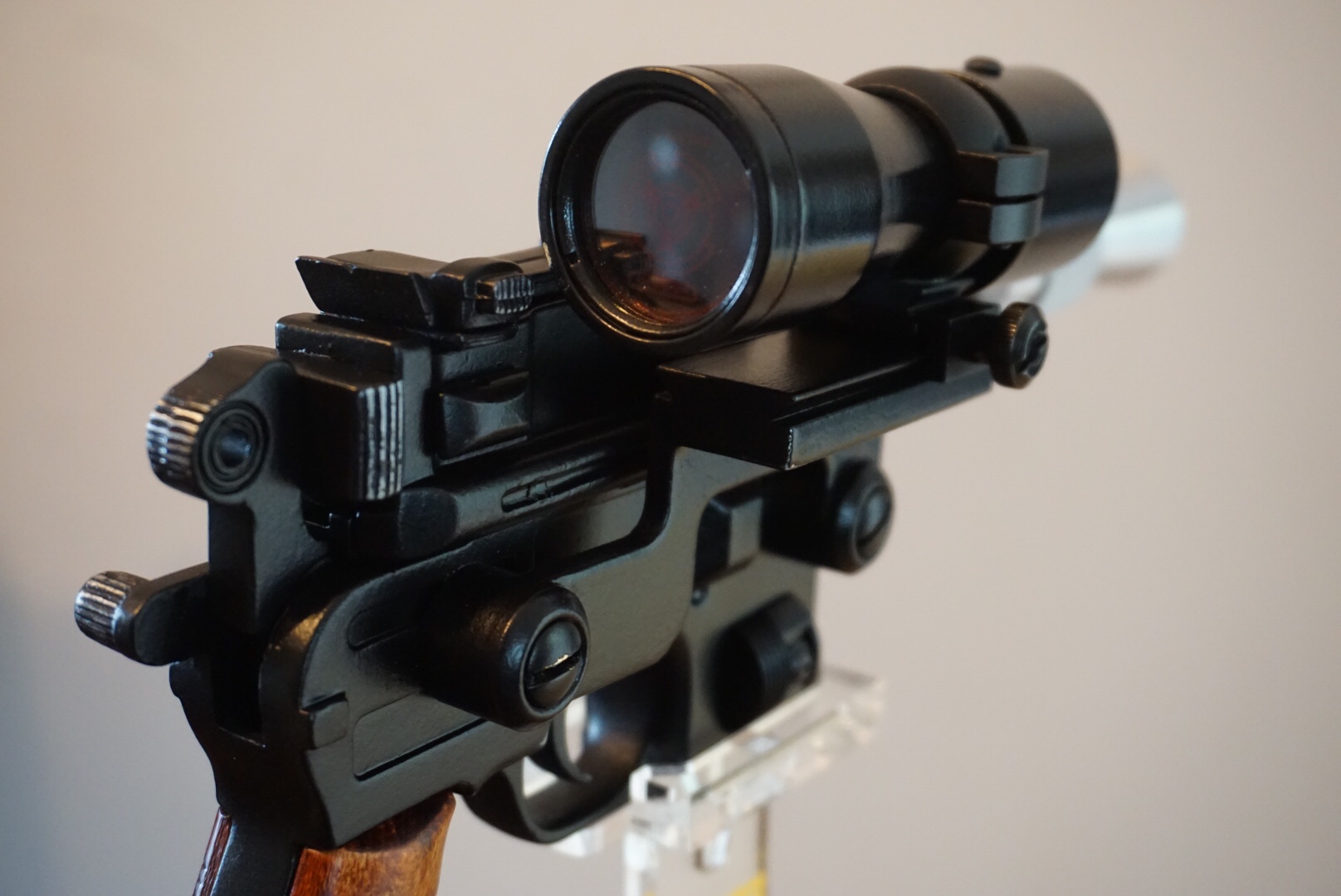

Again while waiting for my TFA parts to arrive here is a finished m19 scope build I just completed for Han's Bespin blaster.
It's getting close to being finished. The parts are almost completed. Just a couple more quick mods and it's [emoji817]. It's taken me a while to get here but I'm extreme happy with the designs and the progress.
I've recently updated my m19 scope design. So it can be constructed with as much metal as possible and extremely detailed as well.
