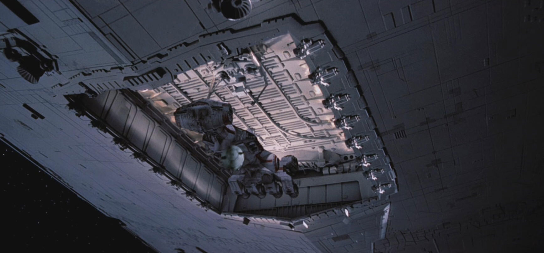

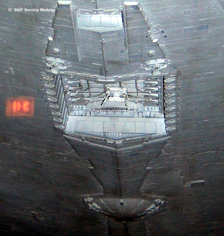

Do you have images for comparison?
Yes sir. Hope I'm not violating any rules, these are pics from members here, sorry I can't recall the sources names.
This is the ANH version with the "pistons" along the edge. There are actually 8 of these as you can see in the pic that INVAR posted.
You can see how much plainer the ESB hangar edge is. Just doesn't have the visual interest as the original.
I think I prefer the one from ANH as well. The edge is what most people visualise I think since it was so prominent in the opening scene. So I'll do that but with only 7 instead of 8.
