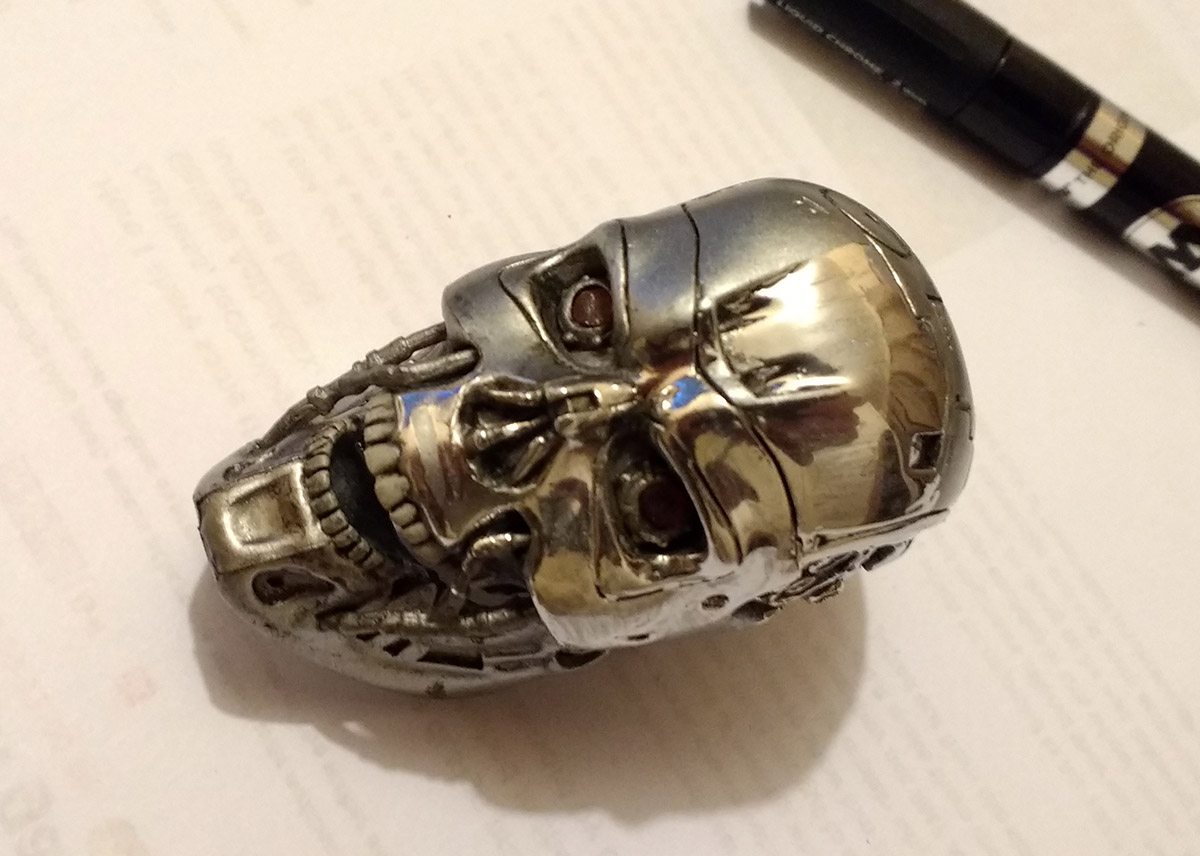

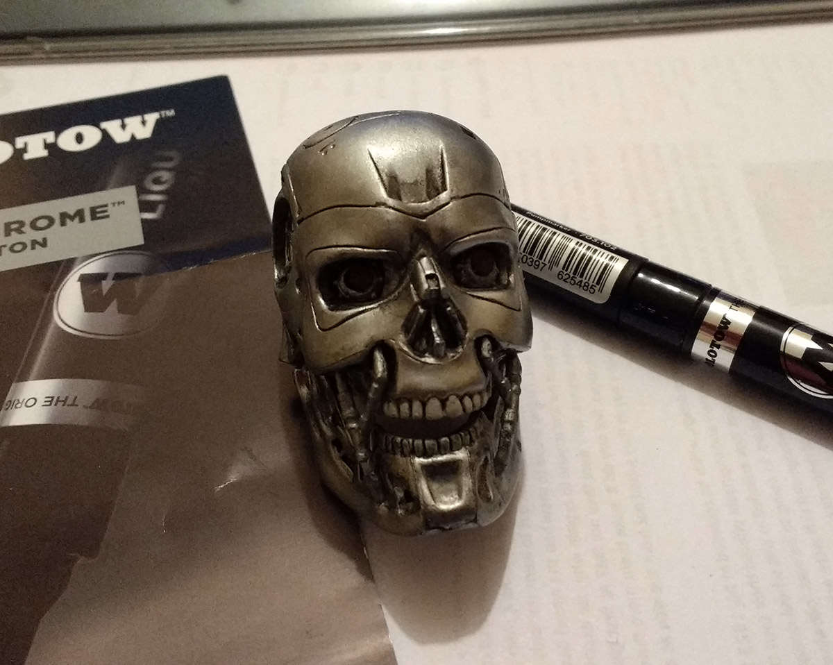

Well I thought 'why not' and ordered a 2mm pen from Amazon. I had my eye on chroming my NECA Endo.
Holy hell, this stuff is amazing. The only drawback I can foresee is drying time. I find I need to put enough on to 'puddle' properly but some of it's taking a while to dry.

I am going to start working on one of my Endos with these. MUCH easier than ALCLAD, Because I am a lazy *******.

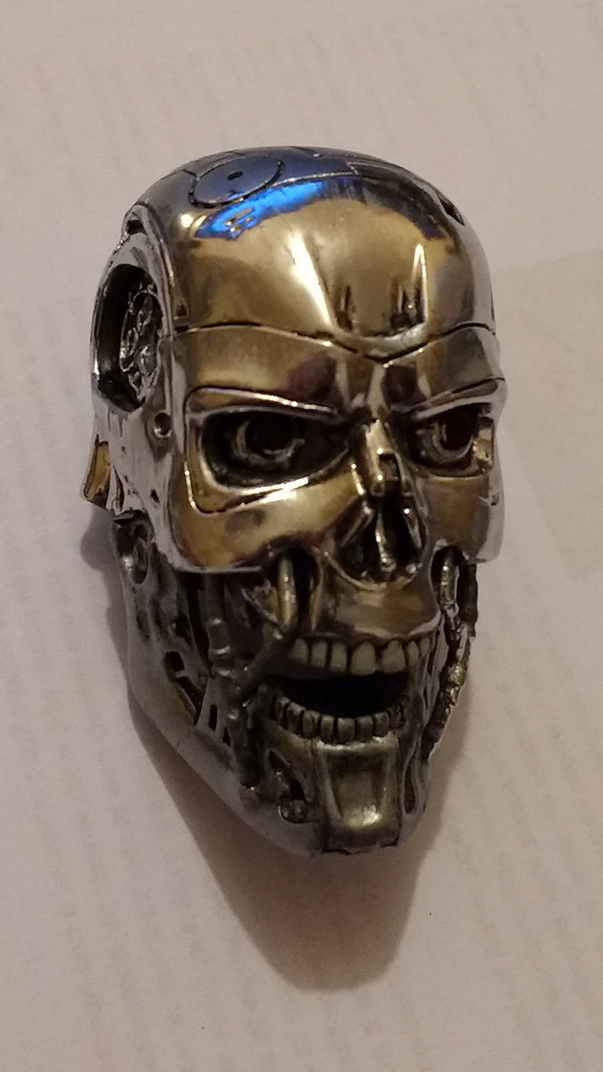

...aaand here is the completely covered article. Dried just fine in the end. Bear in mind this is a 2" tall plastic NECA endo skull!
I suspect it won't deal that well with finger grease unless you clearcote over the top of it* but, man, what a finish.
Can't wait to strip down the rest and give it the treatment. I've ordered some base guitar strings to replace the body cables too.
*As already discussed earlier in this thread - given enough drying time and provided this is the last step in your paint process, it's fine. Plenty durable.
Sorry to keep posting but it looks like 1 x 2mm pen will do ALMOST an entire NECA 1/4 endo. lol
Lower legs and some pistons and ancillary pieces are yet to be painted (drawn, coloured, scribbled?)
You can see some streaking on the lower chest panel but overall I'm blown away with the ease of use and quality of this stuff.

Great_Bizarro: I read a post earlier in this thread that clear-coat does kill the shine. I'm not really prepping my pieces at all, just giving them a rub with Isopropyl and buff with a cloth. Best results are if the paint goes on thick and 'puddles'. It then takes about 12 hours to cure properly.
Once the paint is dry, it won't show fingerprint impressions, but if you purposely rub your finger across it a few times the finish does haze (so I'd assume normal handling will do so over time as well).
From quick tests, Future is the least bad clear coat option, but does affect the finish (my test was brushed-on; maybe airbrushed will be better?). Krylon clear will dull the finish more, but it still has a somewhat convincing un-polished aluminum look and reflectivity. Dupli-color (auto) lacquer clear eats it up a bit more and is not a good choice.
I would add as a caveat that it is not a durable coating. This is not a tough two-pack lacquer - it's a marker pen.
It is fairly fragile - even when cured, and will scratch off easily with a nail. BUT, for those of us who can't afford (or can't get hold of) more specialist coatings - it's fab. Once you get the hang of application you get an almost mirror finish without having to sand and prime for hours first.
