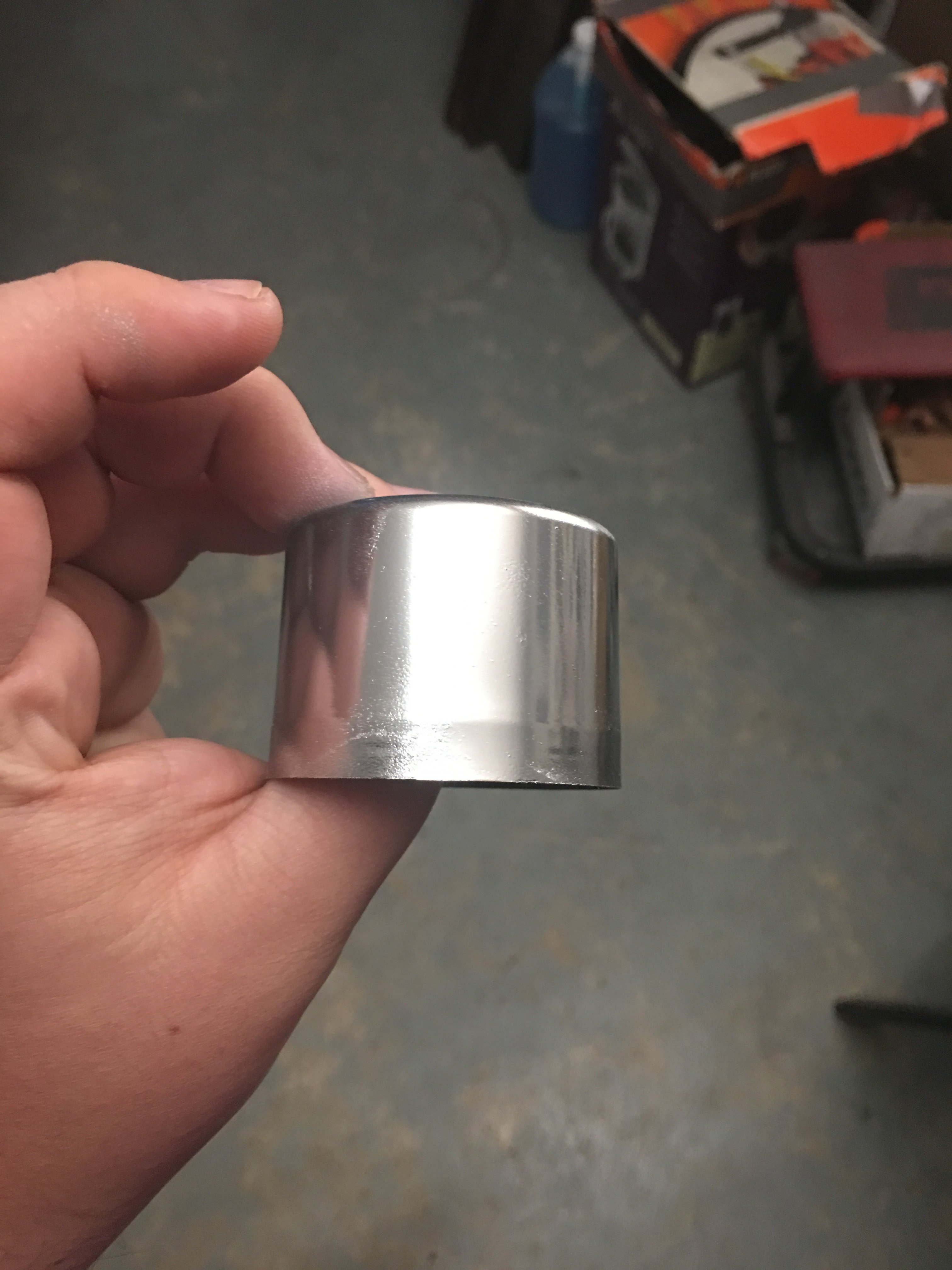

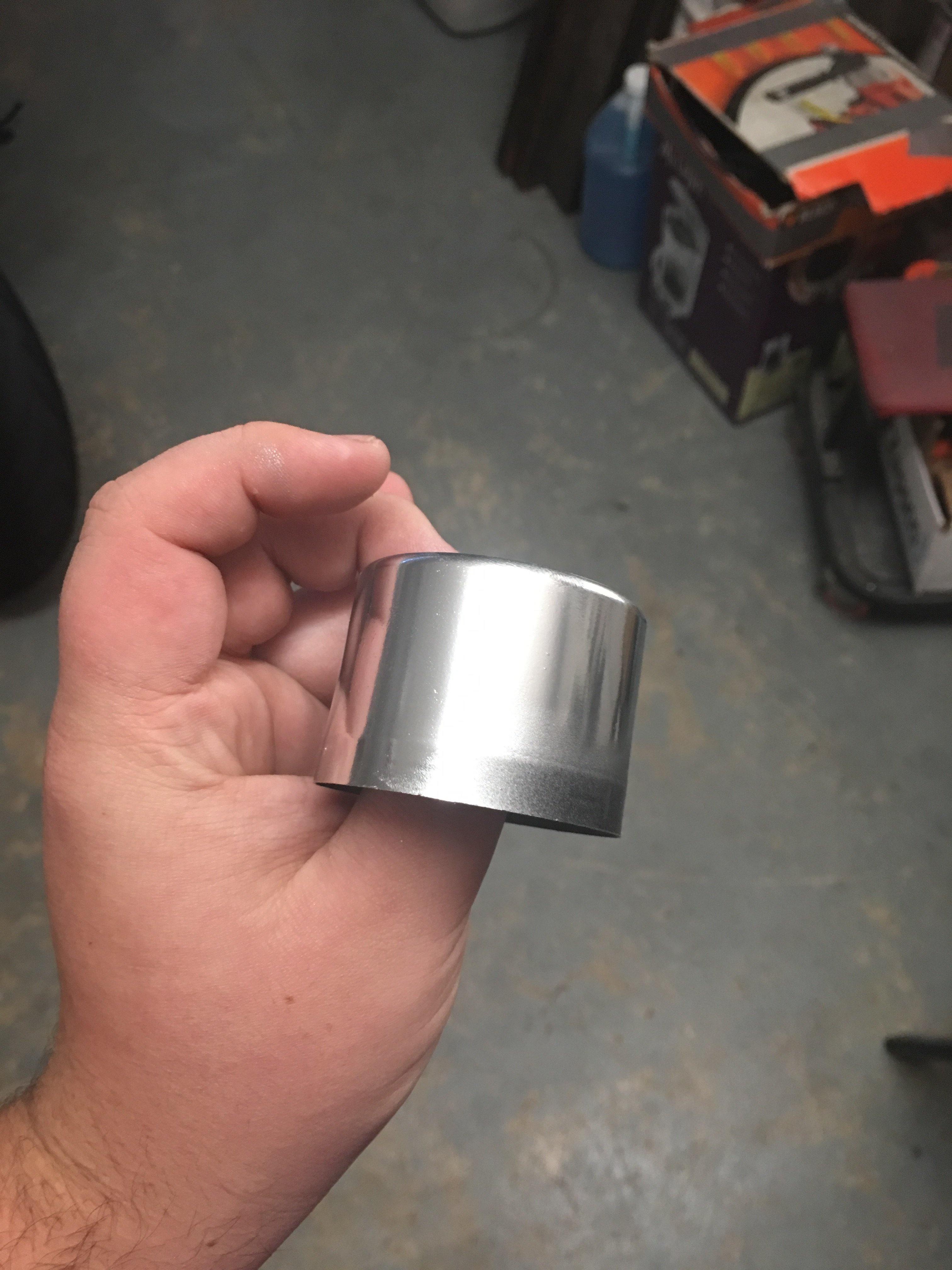

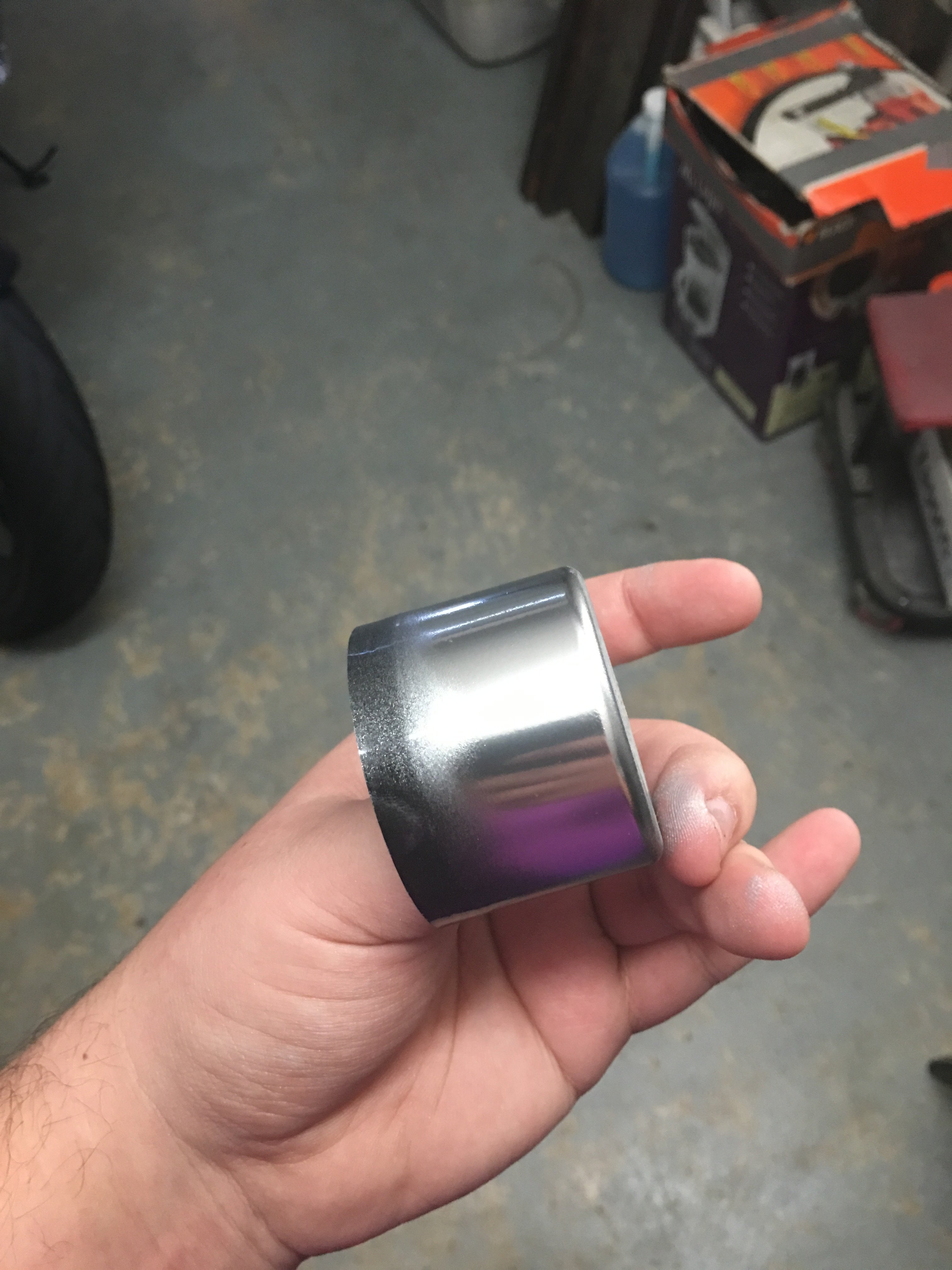

Yes. Yes it can. These photos really don't do it justice. I am looking at it right now and it's comparable to a vac metalized piece.
I will wait a day or so and then do some clear coat tests.
E williams
Were the pen strokes quite evident in the final finish?
It looks like it has good coverage.
The pen strokes self-leveled and disappeared for the most part, because it was applied in a wet coat. The cap is rather small, though. I'll need to do a test of a larger area.
Im thinking if this was decanted through an airbrush, a larger nozzle and wet coat would be better.
Something like an iwata rg-3.
I think if this was sprayed quite dry it would not give the refective surface needed.

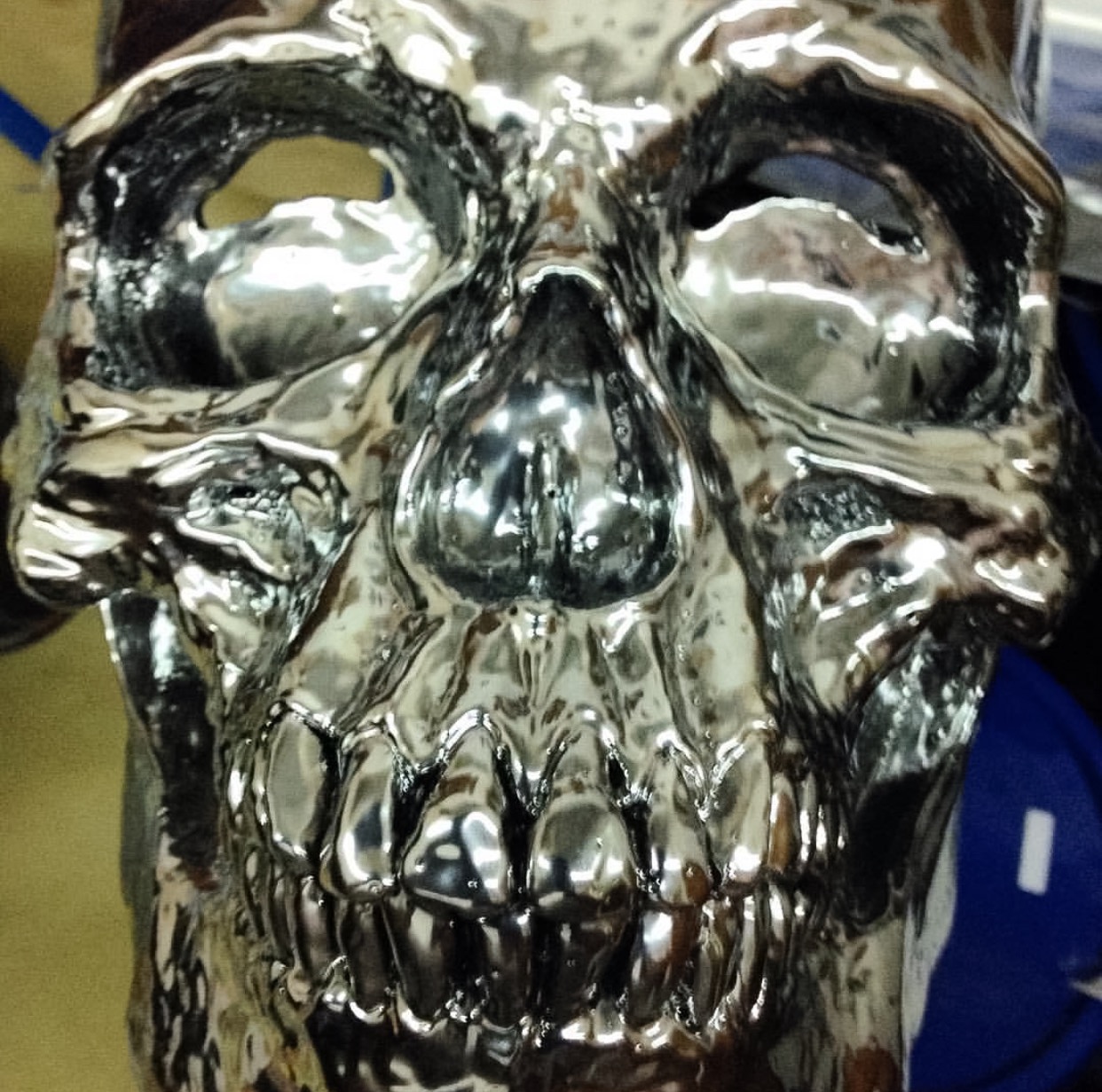

As far as that alumaluster stuff goes, anyone have examples using it? The website pics always look better than real life.
When I sprayed the Liquid Chrome I definitely needed to do one wet coat. You can't apply it how you do normal chrome paints, building up slowly. When I said it wouldn't replace Alumaluster on larger areas, that was BEFORE I cracked one open and airbrushed it. As far as I'm concerned? I found my new favorite chrome. I feel like it is all around better than Alumaluster out of an airbrush and that is something I NEVER thought I'd say!
However.. since you asked for examples..

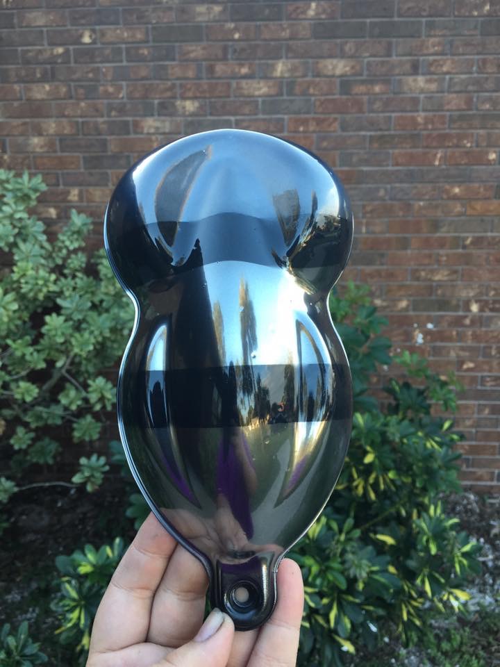

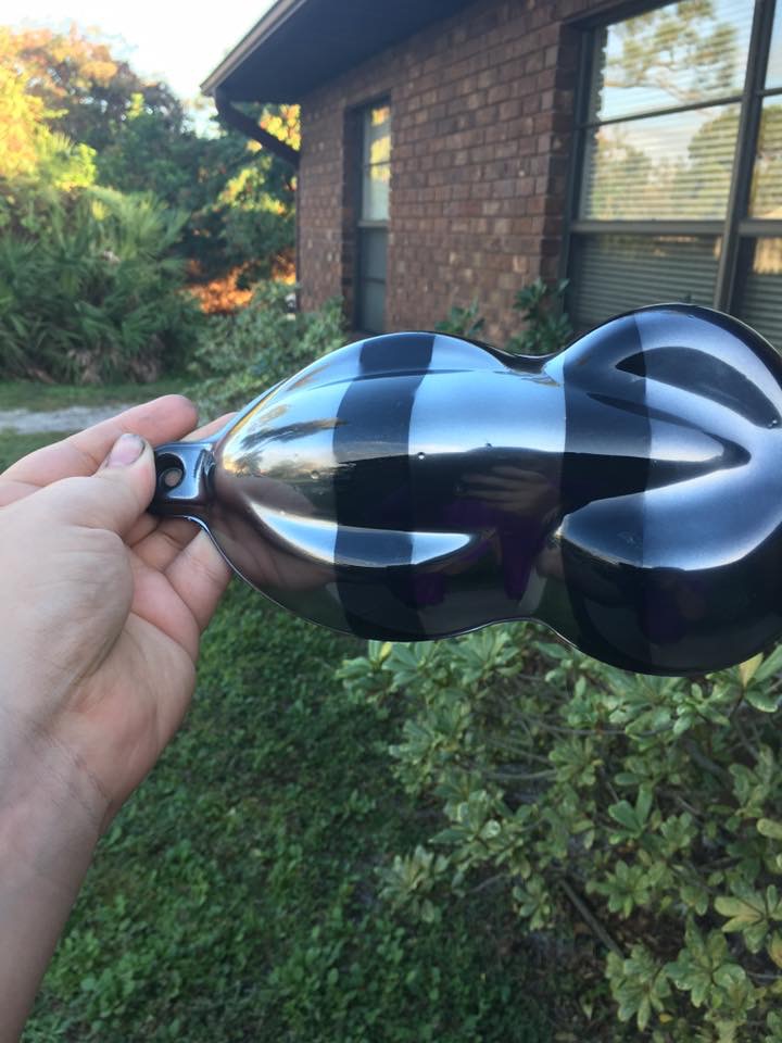

The one one closest to my hand is Alumaluster on my tests here, trying out a few various chromes.

Right out of the pen, no thinning at all. :)
It comes out looking like mercury. I've never ever seen a chrome paint like it.

Is the skull alumaluster or molotow?

The skull is Alumaluster. The other chromes on my test piece are Spaz Stix in the middle, and Shrapnel at the end, while the Alumaluster is closest to my hand.

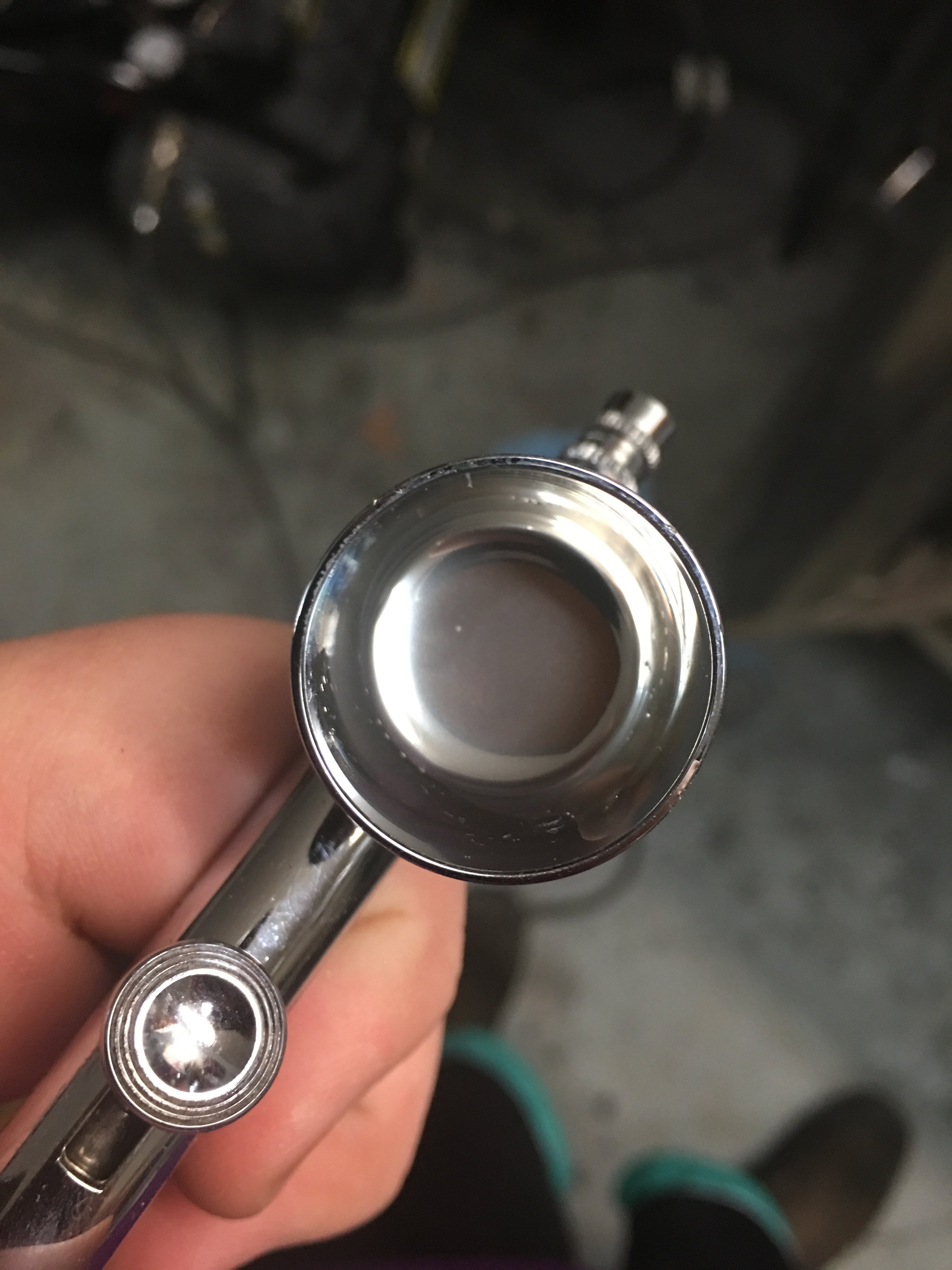

On the first page my post with the spray cap? That is the Molotow sprayed. Pictures seriously don't do it justice. I have attached a short clip of the spray cap.. keep in mind, that was just a dirty spray cap I grabbed for testing. Over a properly prepared and glossed base? This stuff will be wicked.

You have any pics of the molotow sprayed?

Im not expecting 100% chrome mirror reflection (it would be nice but aint gonna happen) but from what you have showed it seems good enough for me.
