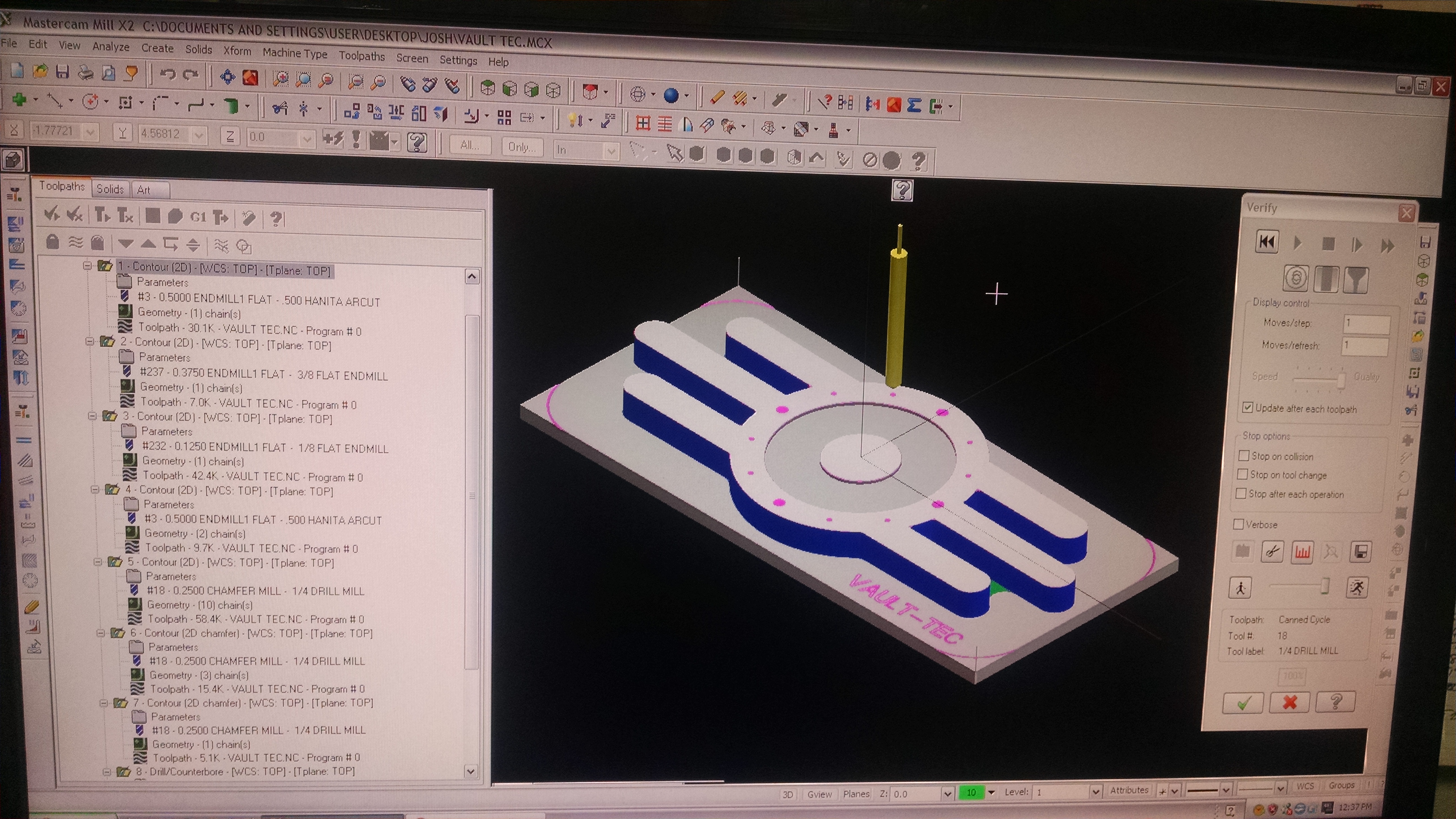

I started with some scrap 3/4" aluminum plate from work and drew up my design in Autodesk Autocad. After I got the logo drawn, I imported it into Mastercam to generate a program for the CNC milling machine to whittle away at it. There are two programs: one for cutting the back relief for the clock motion and the outer profile, then another for cutting the face details. Shown is the second program for cutting the face side.

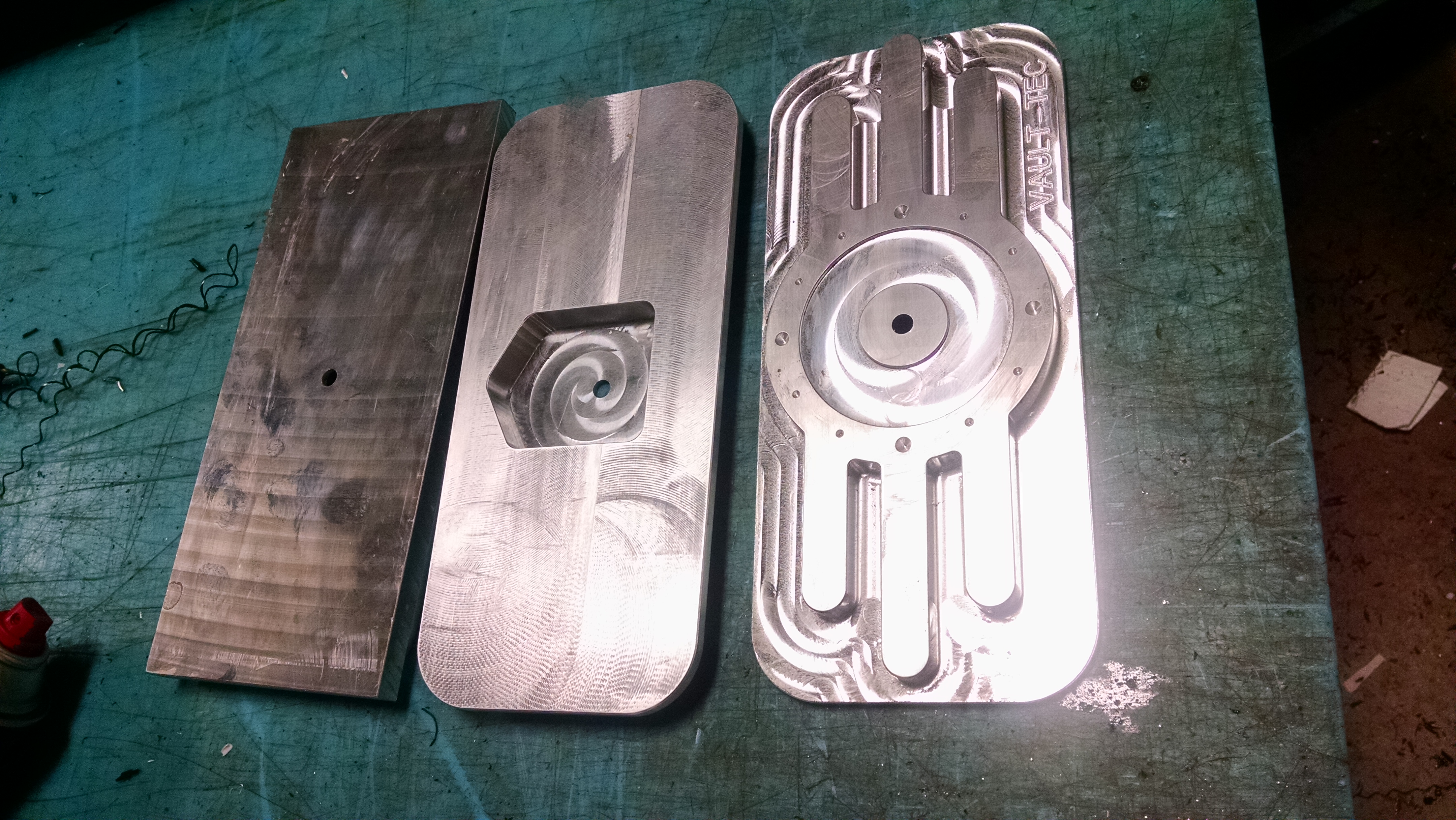

Here is the progression from a piece of raw material through the first operation, then through the second op.

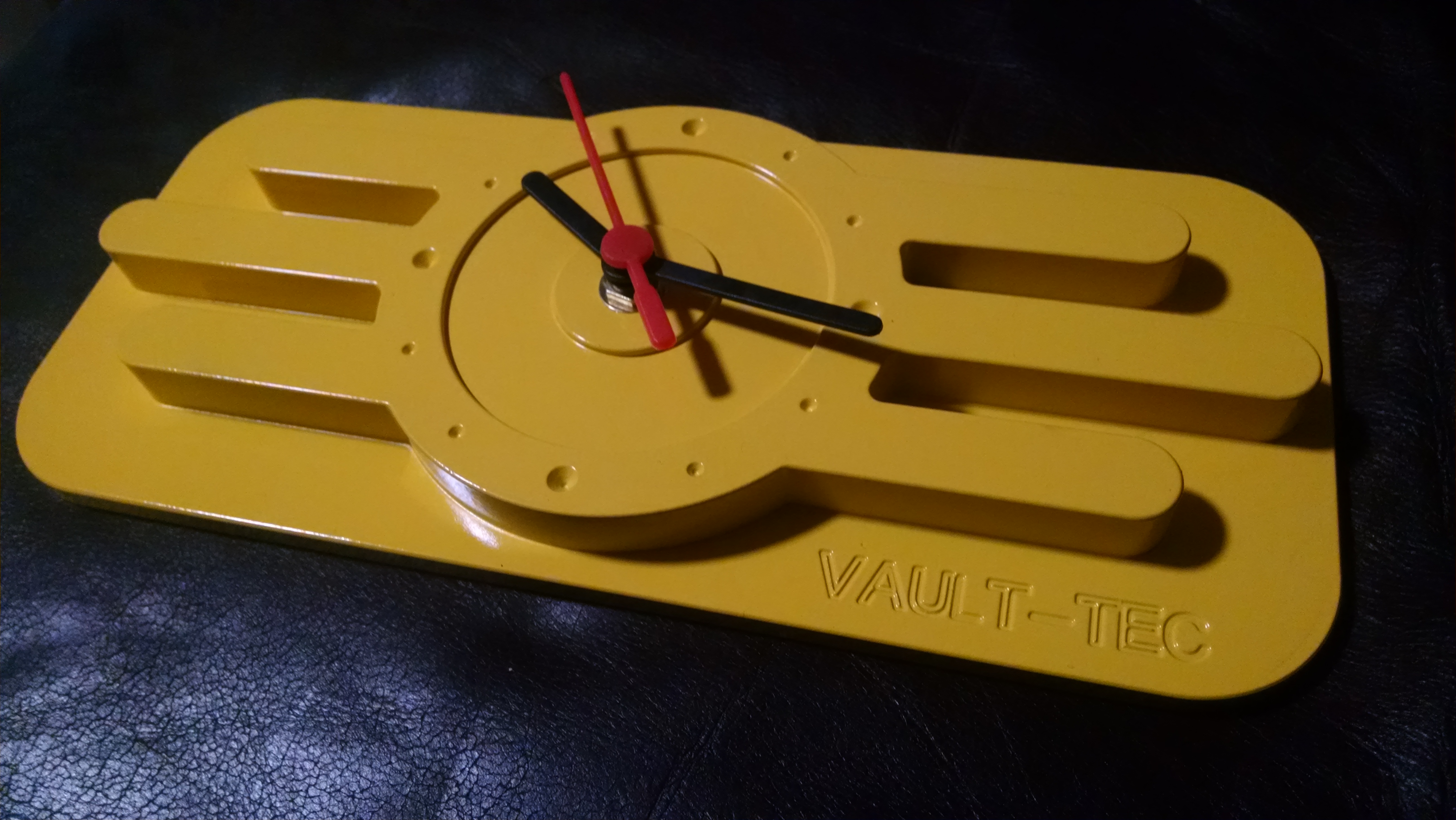

This was the final product, coated in an appropriate Vault-Tec safety yellow paint. I might try weathering the one I saved for myself, but we'll see where it goes. I'm also toying around with the idea of making a back plate for mine to cover the motion as well as making some glow in the dark features on the dial graduations. Maybe you guys can provide some suggestions. :)
I love it, your friends got some cool presents! I think it would look good with the flat back portion of the clock being a sky blue color going with the Vault-Tec color scheme....and grubby and weathered, hehe.
If you wanted to go all out you could have glow in the dark, dim leds, or even tritium inserts in the hour marks (that would be spendy).
Thanks! I'll have to see what kind of LED clearance I have in in there. A green ring with a sort of "humming"/ flickering effect would be perfect since everything seems to be nuclear powered in 2077. If there's not enough room, I may just make some dowel pins with glowing ends that'll press into each graduation.
