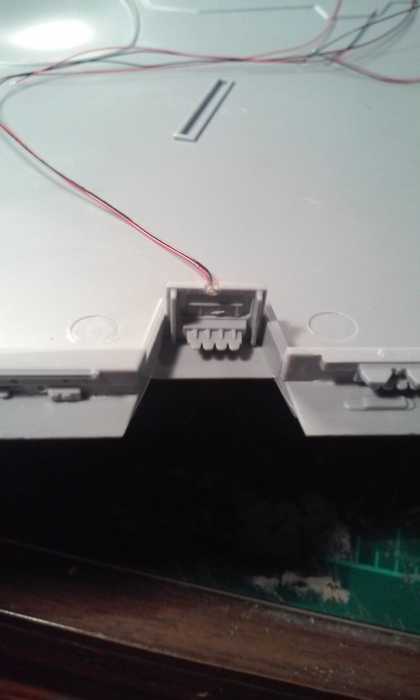

Small update. Worked more on the lights this morning. I tied in the superstructure LEDs with the those in the lower hull. I also tied in the three flood lights on each side of the trench to the main lighting grid. I also started on the main support rod for the stand. Tonight, I'll start working on the bridge lighting. My plan is to mount four forward facing LEDs and just use little nubs of fiber sticking in. Not enough room to "run fiber" to the LEDs. I'll add some more pics tonight.
Might be a good idea to paint the inside of the bridge as bright of a white as you can manage to even out the light distribution. LED's and optical fiber are pretty directional.
Really? I did ran FO to the bridge. Had to cut some plastic from the interior of the tower but my tests show it can be done. I divided the whole bunch of fibers into two smaller ones. If the cables to the LEDs become a hassle I have some Magnetowire (very thin cables that can be easily run upwards.
Looks great! About the flood lights, what you used? Ive seen images with them and without....what is the official look or is it more of a personal preference? In the initial scene for ANH I think they were not present? Good job man!
The ANH ship had no lighting other than the engines. That was added to the 8 footer. For mine I used pre wired Picco LEDs from eBay.

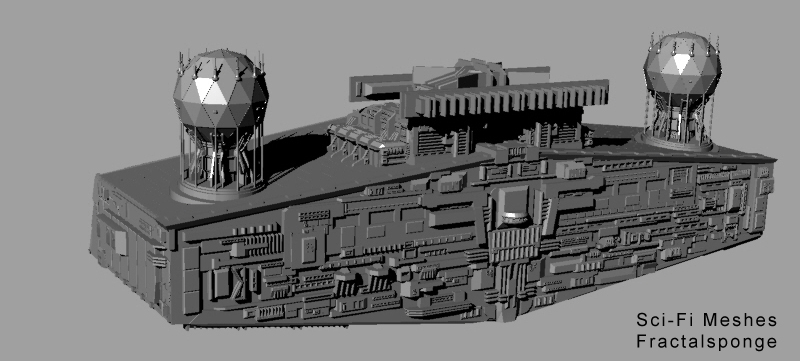

Now, here is the real reason I did it this way instead of running fibers down the neck. I have hopes that we will soon see a 3D printed bridge face with the familiar slanted FX on its face. By doing it this way I can easily remove the temporarily attached kit face and replace it later on with an upgrade face and not worry about the fiber run.
This is the mesh from Sci-Fi 3D by Fractal Sponge, extracted from the .3DS file in Rhino 3D. Is this what you're hoping for, Robiwon?
I've been poking 308bits for a new bridge face. He is waiting on his kit to arrive.
WarpeD, I'm hoping for one that replicates the SF on the bridge. This is the one as used on the Anigrand, not what I'm looking for.
That's pretty much what I would have to do if I were to take the SFM resource and convert it so a solid. Lotta work! The critical thing would be sizing it to fit the ZSD. The evil temptation would be to print up a bunch more stuff from the same mesh. My only concern is the banding one gets from 3D printing, since there's no way one could properly sand this bridge face after printing. It's print, assemble, paint, period. Has 3D printing advanced far enough in your experience to just print a bridge face and use it?
There really is no "S" on the original bridge, it just looks like an "S" when the shadows are right. The detail is actually more like the mesh above. Zvezda has it almost right, but the details are too shallow to produce the proper shadow.
