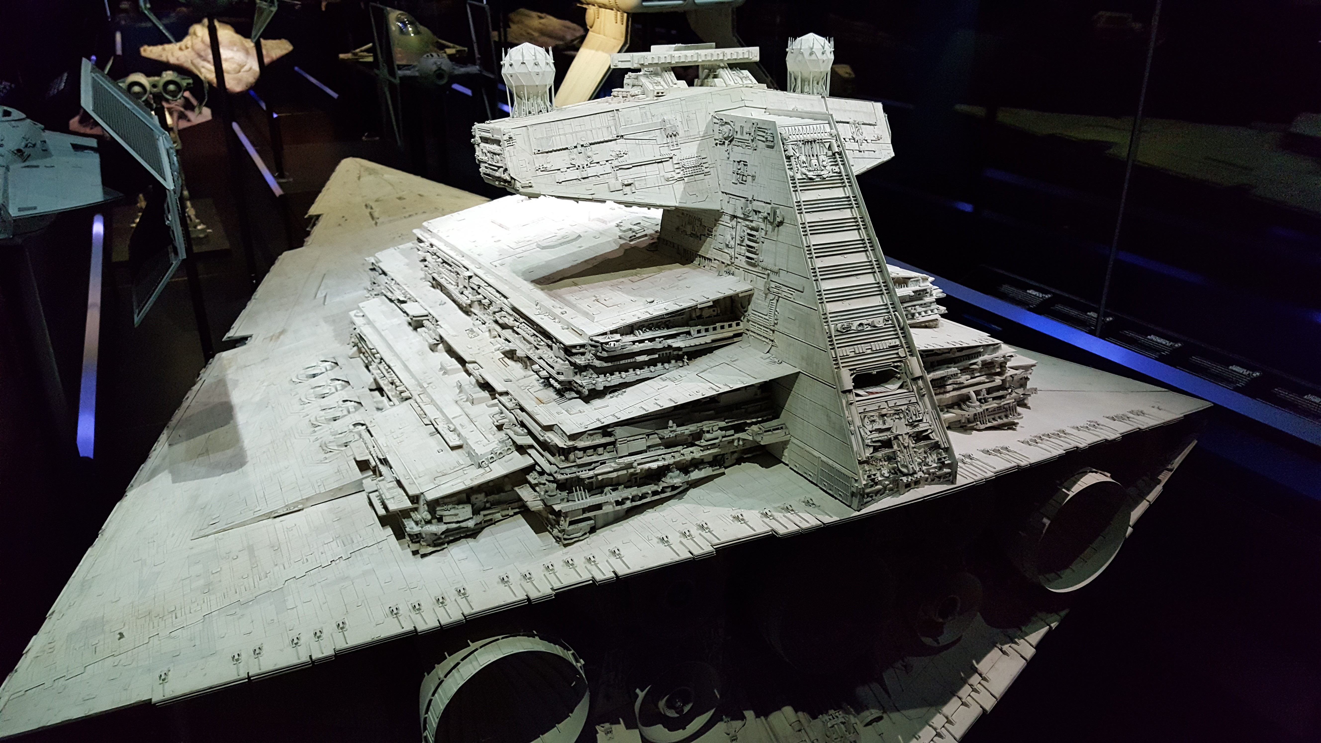

Granted the lighting at Identities is pretty terrible, but you can see in comparison to Vader's TIE Advanced blue/grey. On the first picture you can just about see the panelling and occasional darker patches, but it's very subtle.

I realize that a photo is not seeing it in person, but the photo above makes me comfortable painting mine with insignia white. And I notice a lot more of the panel variations than I realized, albeit very subtle apparently.
