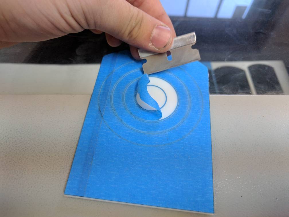

Size and translucency test.
If I'm going to make it from this plastic, this is the amount of light that shines through. You can see my finger but it's not too clear... Only like 5-10% translucent. The width here is 2.5" which I originally thought was right but after holding it, it feels a tad too small.

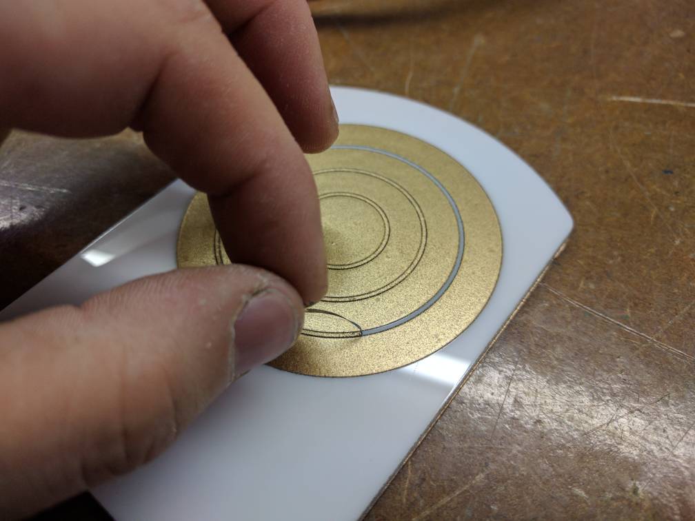

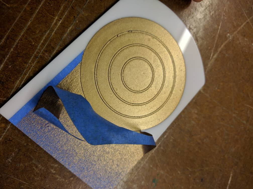

One glossy, one matte. Paint sticks better to matte, so I made it that way just in case.
I think it looks pretty good, but I'm excited to see how the other two methods turn out.
There's a black piece at the bottom I still have to add.
