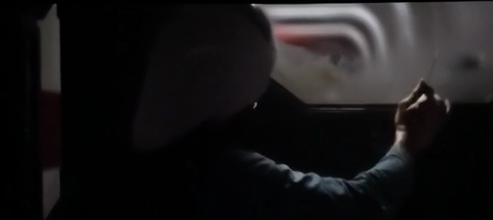

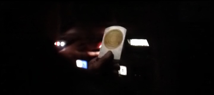

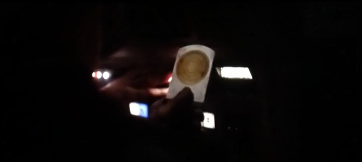

The card is a thin (silver) metal plate and the bottom bar is stepped.
I really think it's white, and just looks silver because of the lighting/reflection. You really only see it for these three frames when it's close up, and then later from the side when it's given to Leia.
vlcsnap-2016-12-30-20h14m48s752.pngvlcsnap-2016-12-30-20h14m48s752.pngvlcsnap-2016-12-30-20h14m44s149.png

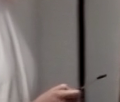

It's in his right hand here, side view.

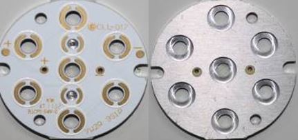

Super thin though. I'm pretty sure the way it was manufactured was the etching method. The material I used for that is FR4, fiberglass coated with copper. Perhaps it was made the other way circuit boards are made, with an aluminum base, then a dielectric layer, then coated with copper, but that top surface around the gold/copper area isn't going to be the exposed aluminum... it'd be the dielectric layer, which would then have been coated with a white soldermask. The back would be silver in color this way. If I can get my hands on that other type of board I'll try it with that.
This is that style, aluminum base, white shiny solder mask:

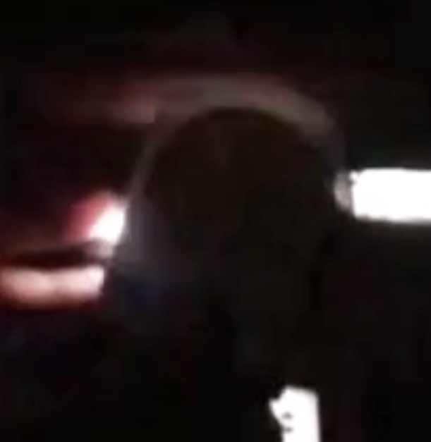

What about this frame that shows you can see through it? No way the main card portion is metal.
No, there's not light coming through in that frame. Go frame by frame right up to and right past that frame. I just did it several times and the optical illusion presented in the frame you posted is very clear. You can see that the area on the right where it looks like the light is shining through actually isn't and is just next to it. This frame, the lights are off and it's hard to see the edge of the card, but the edge is clear of the light and the light is just shining next to it, not through it.
That light on the right, where the left most part of the light that looks like it might be shining through the card, that left area is viewable in different frames and it looks the same, even when the card isn't in front of that light.
I'm even more convinced now that this is the aluminum base style of board
