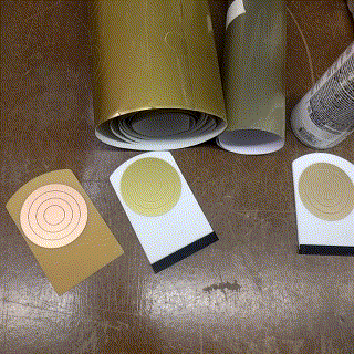

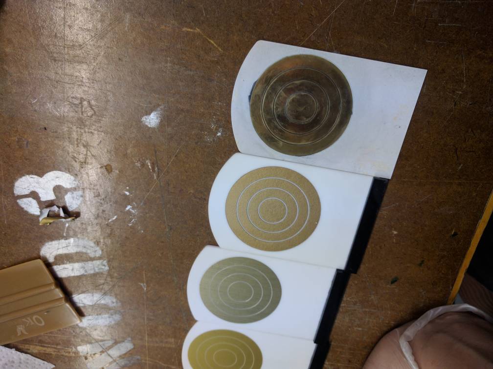

The new gold brushed vinyl arrived and I'm going to try that one out today too.

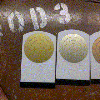

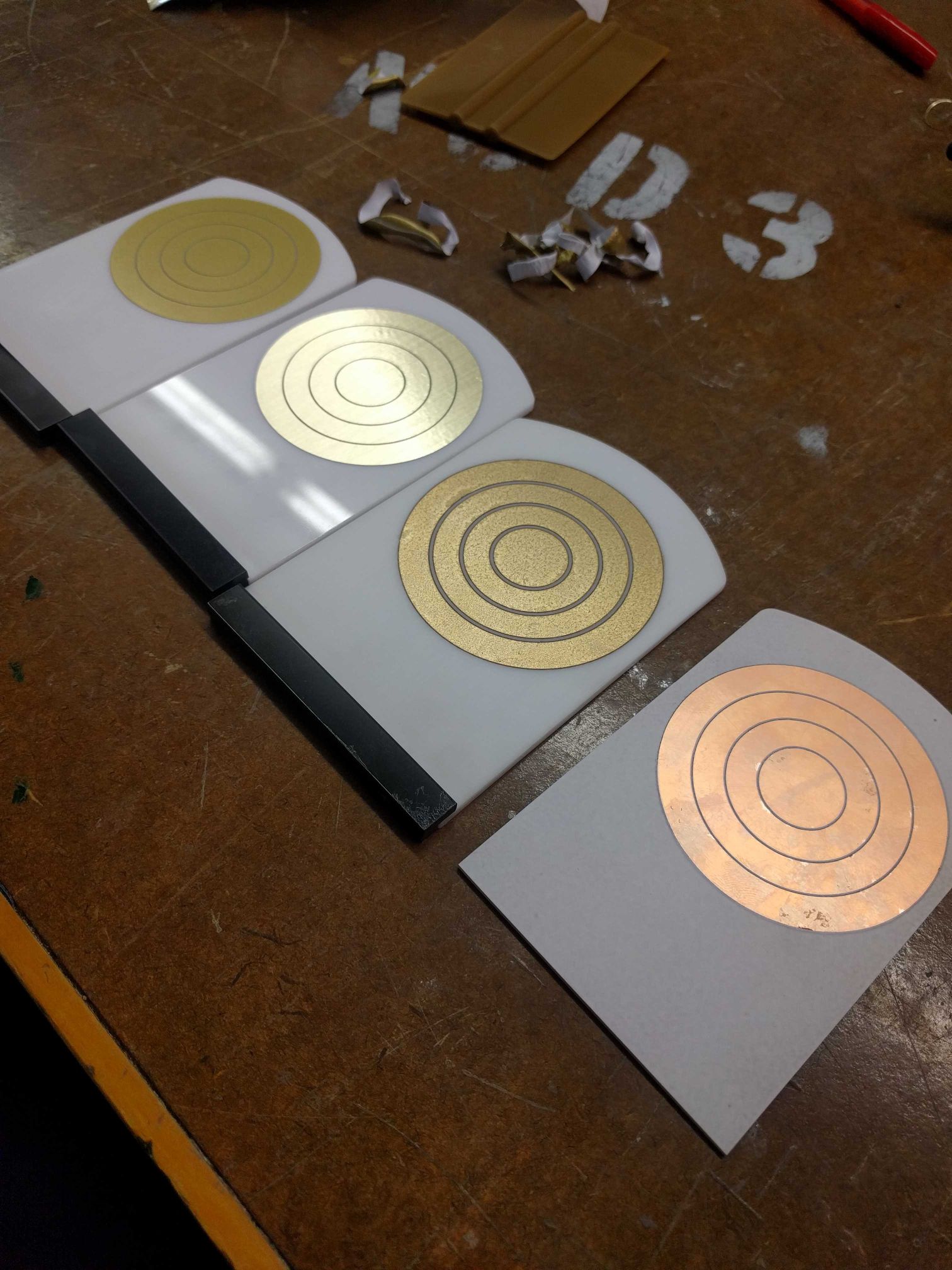

Here's what we have so far:
From left to right, that's the unplated copper PCB, then the smooth gold vinyl, then the brushed gold vinyl not yet cut, then the gold painted one.
Today I'll be cutting a new card from the white acrylic and cutting and applying the brushed gold vinyl, and plating the copper etched PCB.

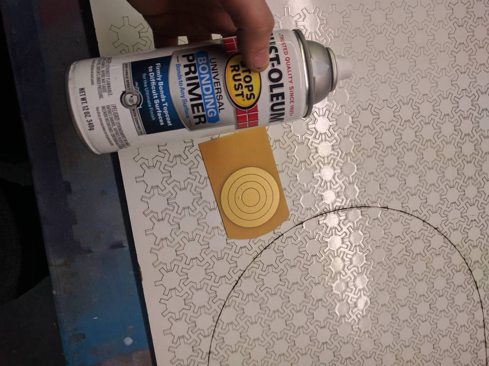

I'm not so thrilled with the color of the PCB, because it is yellowish, and from the references we have it should be much more white. I'll be painting the yellowish area white.
Sent from my Nexus 5X using Tapatalk

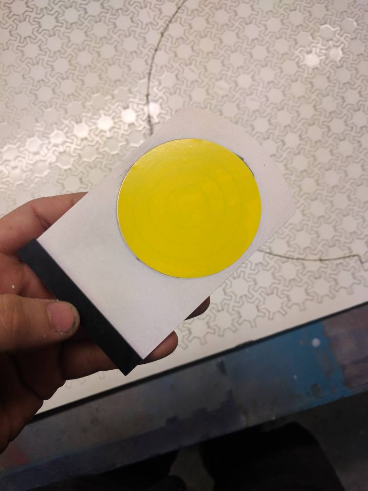

Painting the board for the etched option

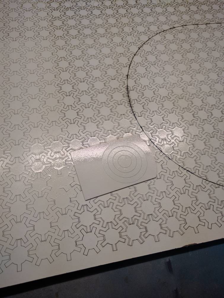

Cutting new brushed gold vinyl

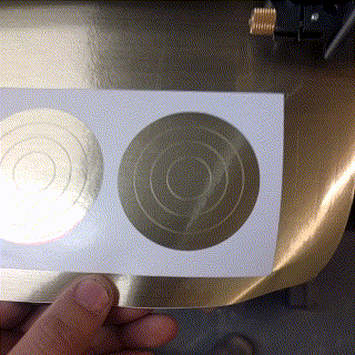

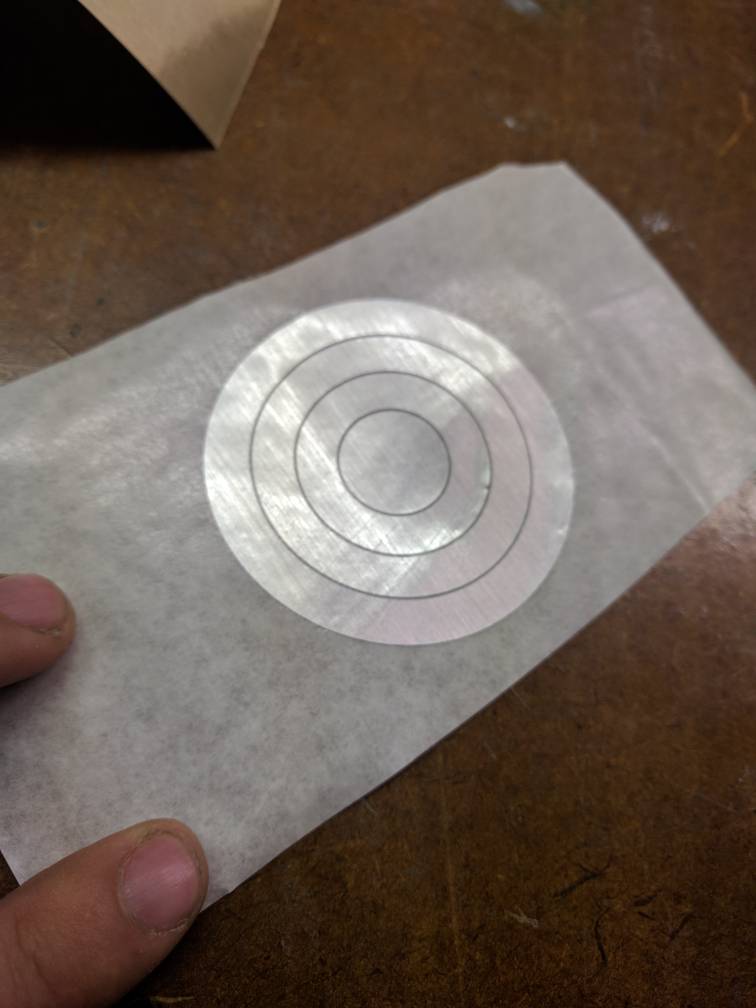

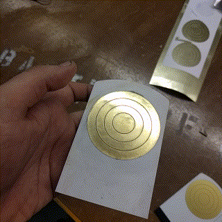

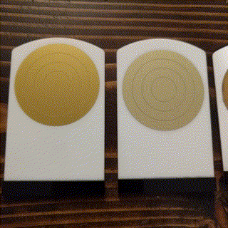

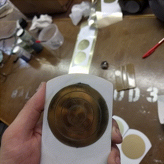

transferring vinyl using transfer tape. This is a metallic foil vinyl.
This material is way stiffer than the smooth gold vinyl. It's a metal foil and way harder to apply.
From left to right, smooth gold vinyl, brushed metallic gold vinyl, and gold paint.

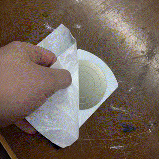

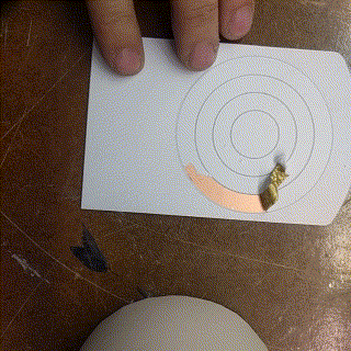

Paint is dry, time to remove the vinyl and expose the copper.
Now on to the plating!

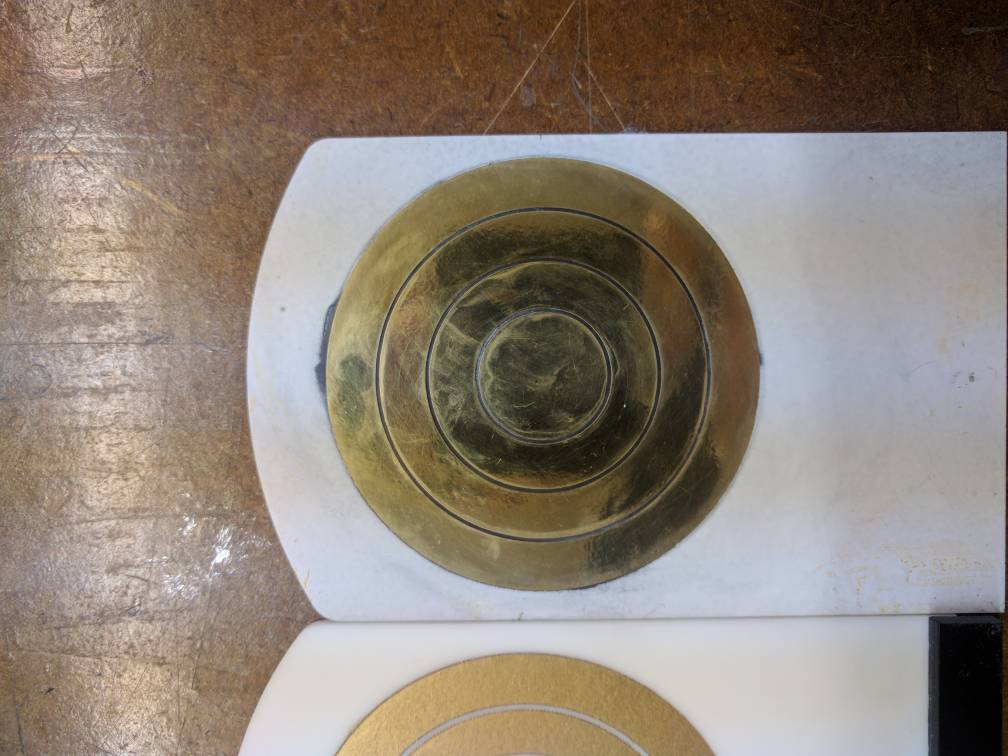

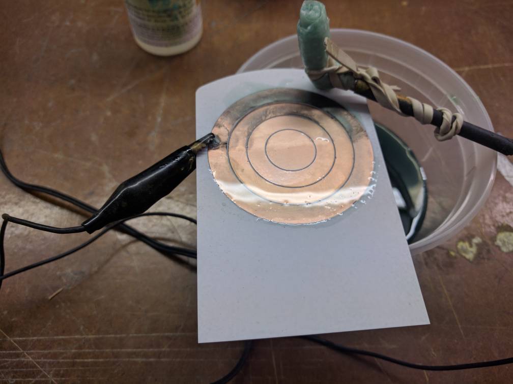

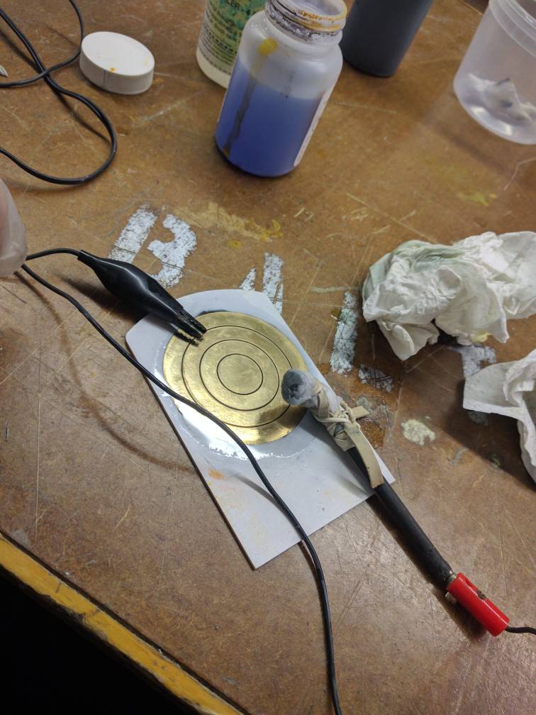

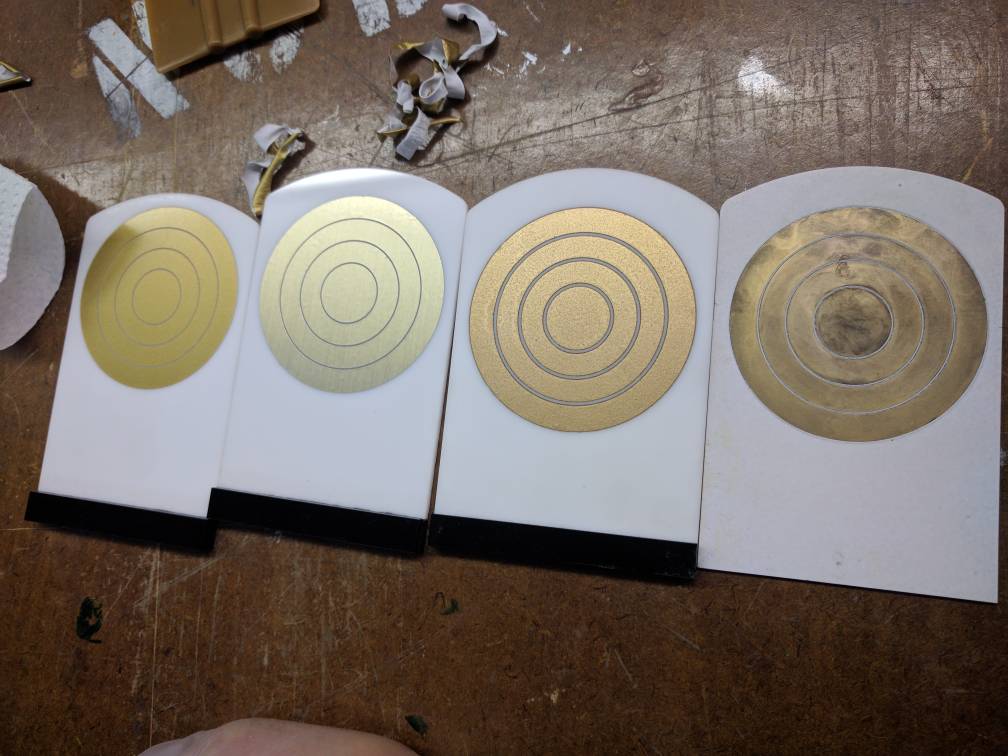

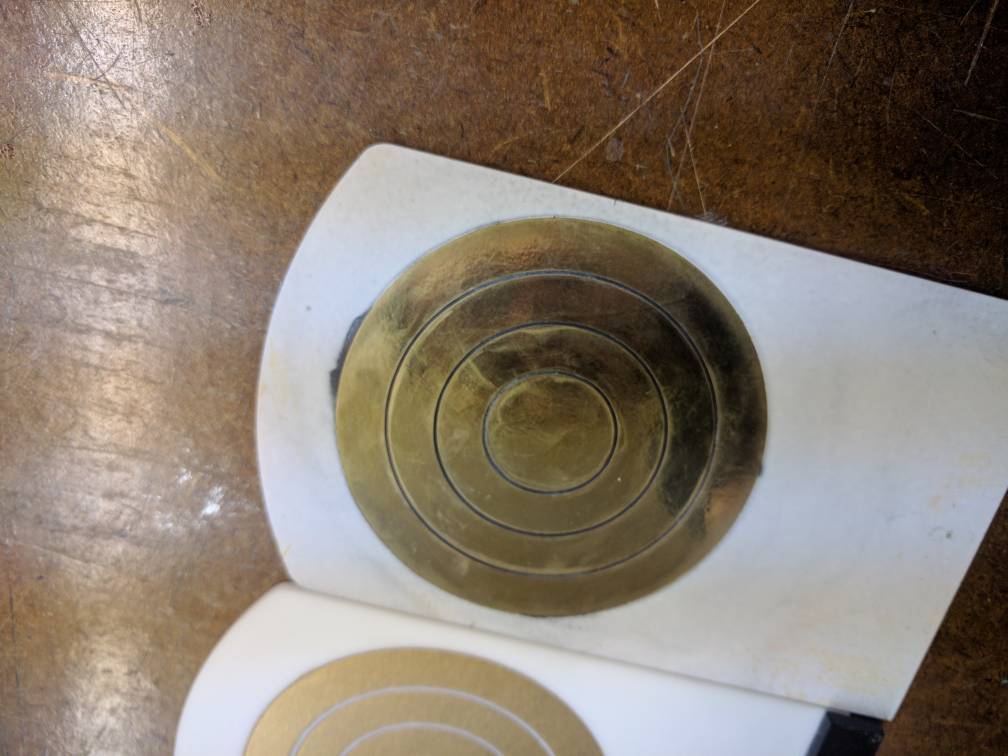

Well, plating is hard.
I didn't clean the surface enough before betting started, so the first plating job worked but looks crappy. I polished the plating off with my rotary tool so I could try again. The polishing cleaned it up real nice, but I also nicked the painted area so there are some flaws in the second plating picture because of that.

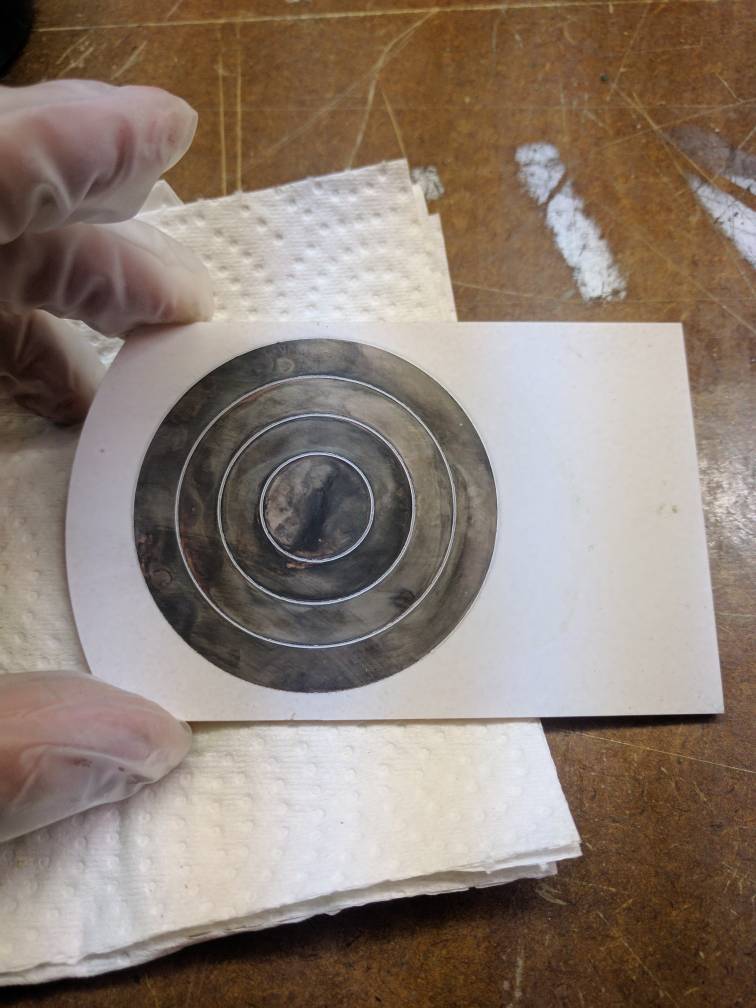

Starting the nickel plate the first time
First try, nickel plate. Ugly
After gold plate, first try
Same order as before.
Then I polished it all off and repeated:
Didn't snap a pic of the nickel plate on rev2, but here's gold rev 2
So not perfect, but way better. If I polish it right from the start, I think we'll get an even better look.

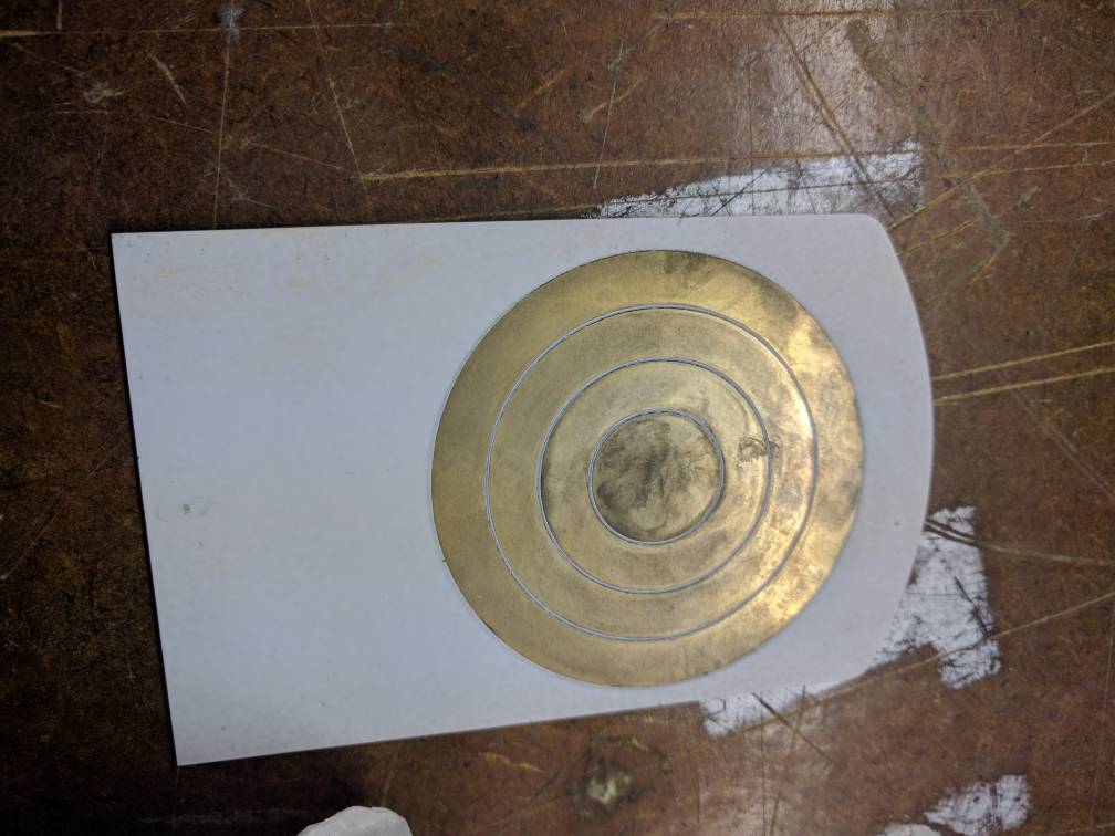

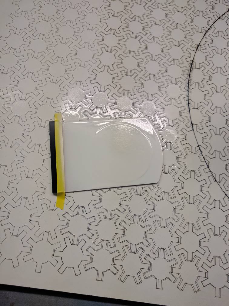

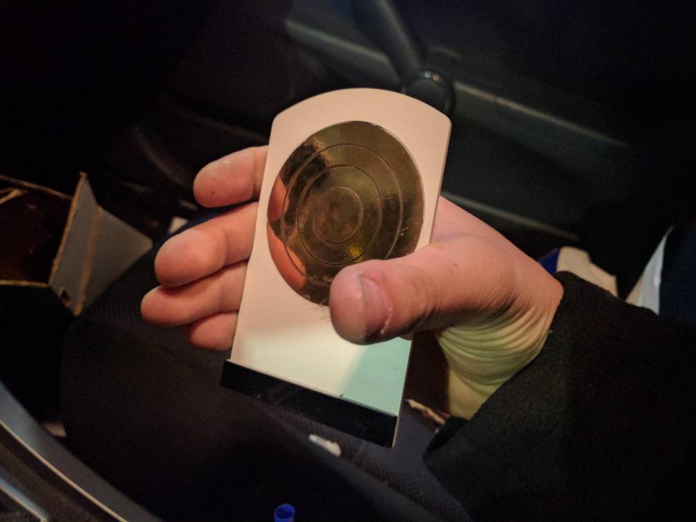

touched up the paint. I had a funny reaction with the vinyl and the chemicals from plating that I guess I didn't clean off a bit. The adhesive from the back of the vinyl came off a bit and I smudged the paint again while cleaning that up. It's way better than before though. I'm sort of hiding it with my thumb here.
That's a wrap! Figuring out how to make more of these efficiently is the next step. You know where to look.
