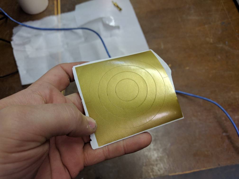

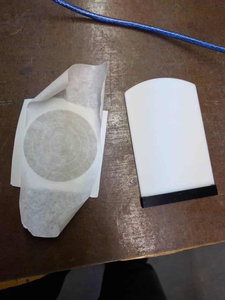

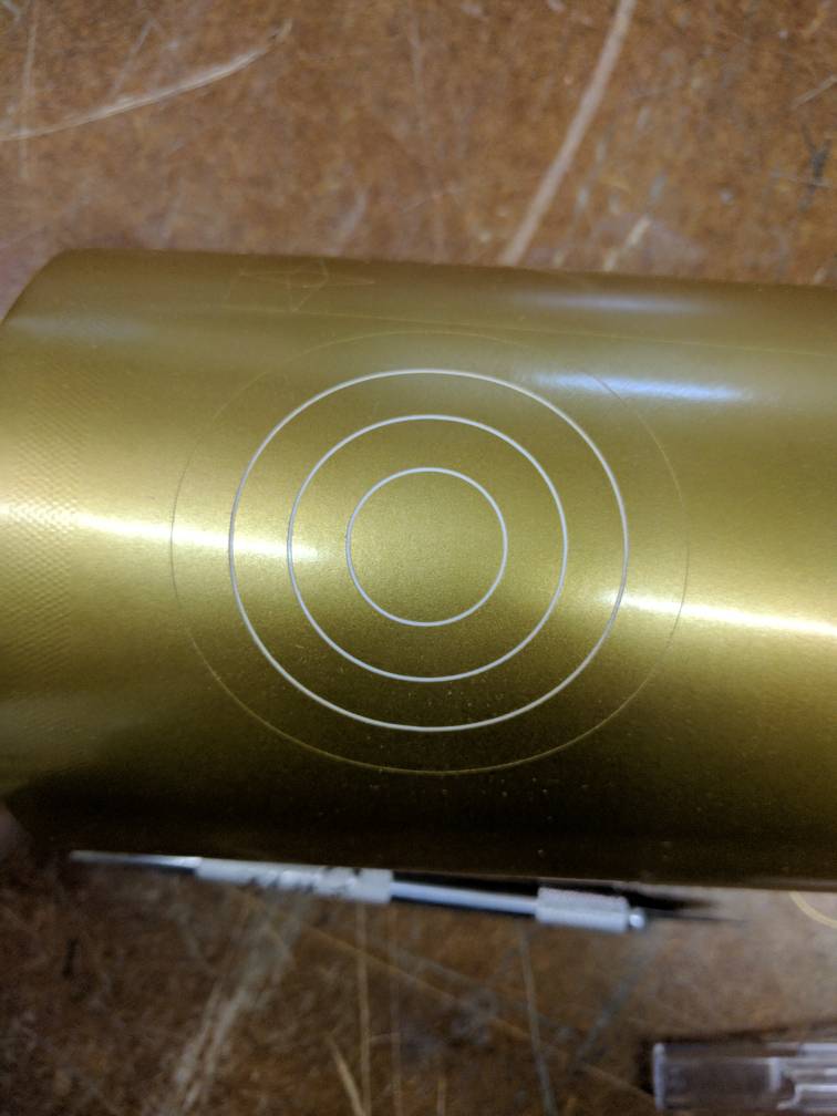

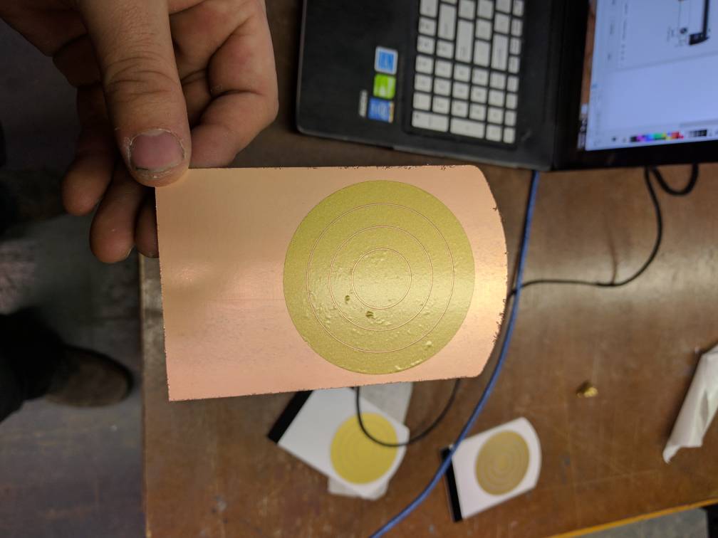

I ordered two types of gold vinyl, first one is here, this smoothed one. The brushed kind is still on its way. Here it is in comparison to the painted one:
Sent from my Nexus 5X using Tapatalk

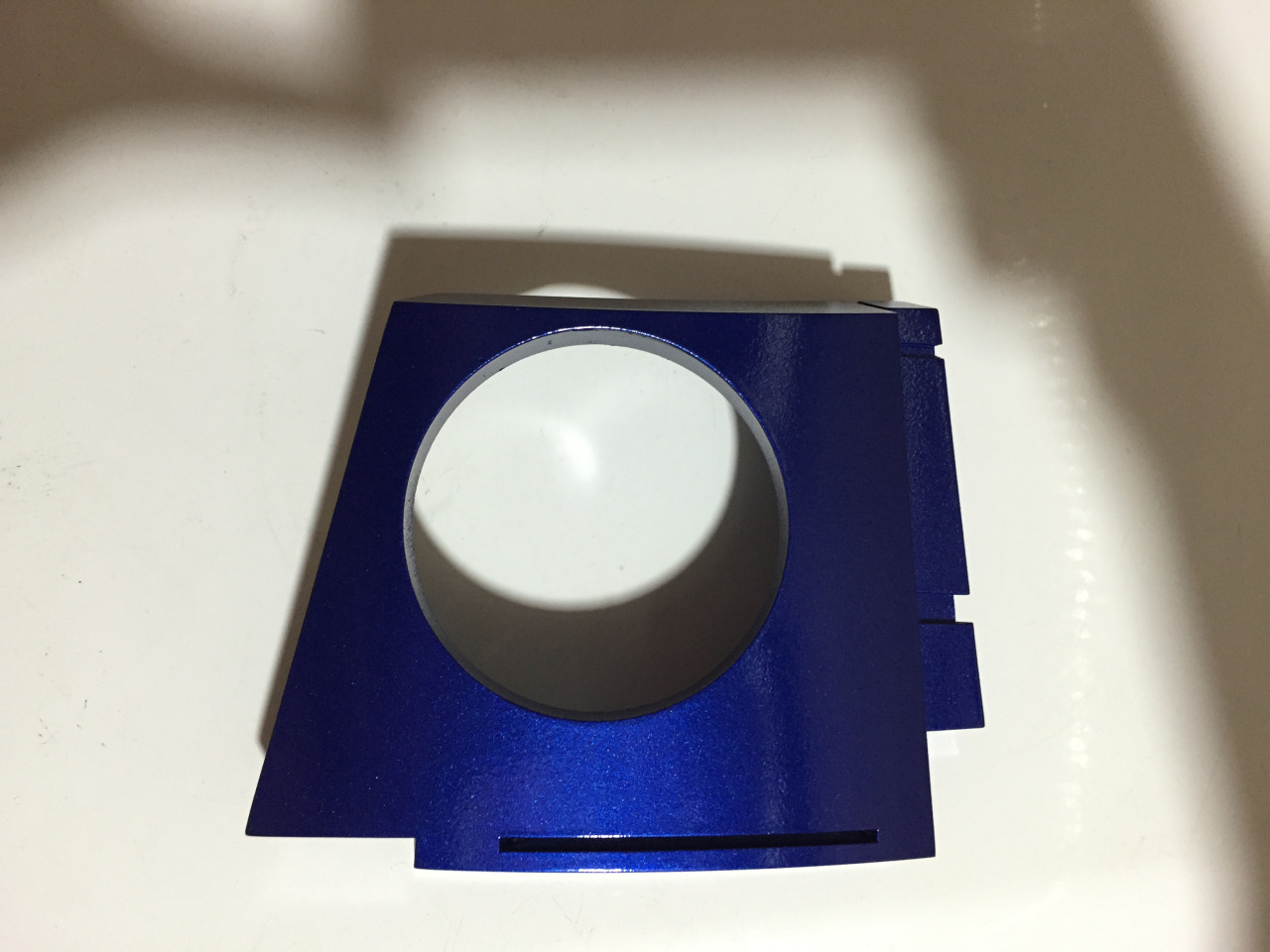

Give me a couple of hours to get home. I'll measure the slot exactly on my R2's Radar Eye.

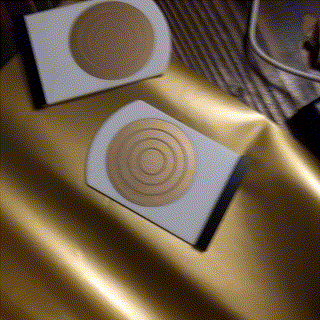

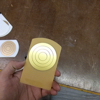

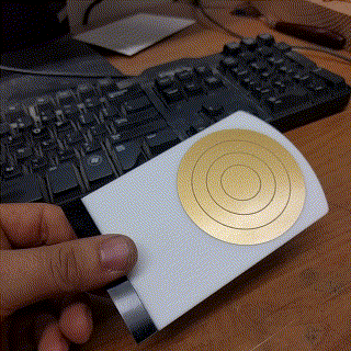

So today I cut the smooth gold vinyl instead of using paint, adjusted the width, length and arc, and tweaked the black bar so you don't see any white on the side of the black part.
The brushed gold vinyl is still on its way, but I like the vinyl better than paint already. Plus it's easier to do so that'll keep the cost down.
I messed up the placement of the vinyl on this prototype... It's too high.
Me likey! I think it looks a thousand times better! Aside from the placement, of course. Like you said.

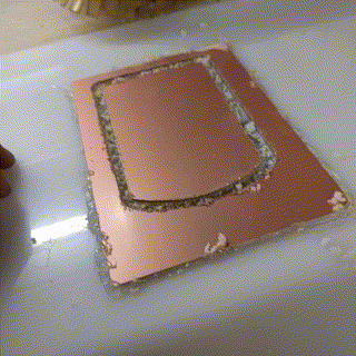

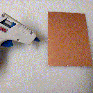

So the fancy way to do this:
Route out the copper PCB, transfer a vinyl sticker as a mask, etch away all the exposed copped, remove the vinyl mask, nickel plate the copper, gold plate the nickel.
Gluing down the copper board to a base layer

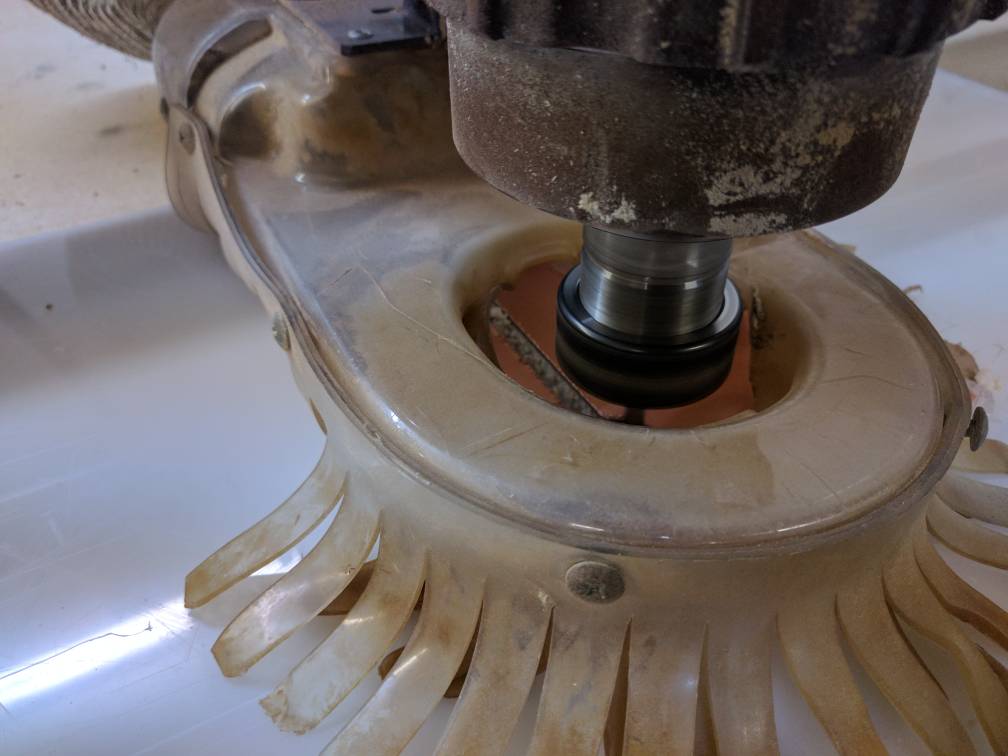

Cutting out the shape of the board with the router

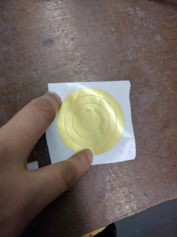

Cutting vinyl for etching mask

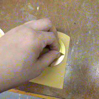

Use transfer tape to move the vinyl to the copper board (sorry it's not centered! Just a prototype)

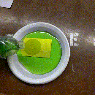

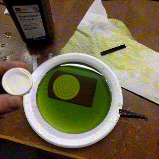

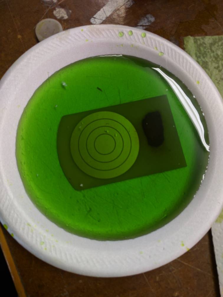

pouring homemade etching solution to eat away the exposed copper
Waiting waiting waiting...

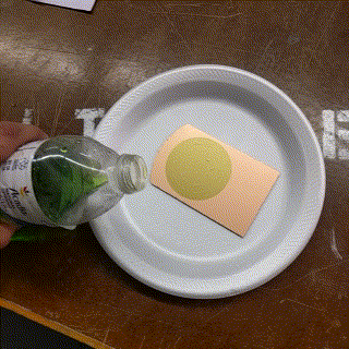

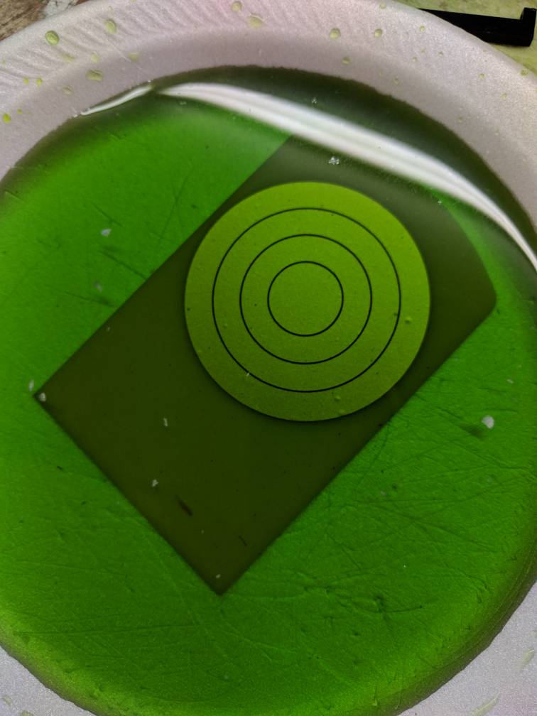

Etching, refreshing solution with more oxygen, and finally removing the mask! If it turns out this color of the fiberglass is no good, I'll paint it the right color before removing the mask.
Next step is playing the copper with nickel, and then gold!
