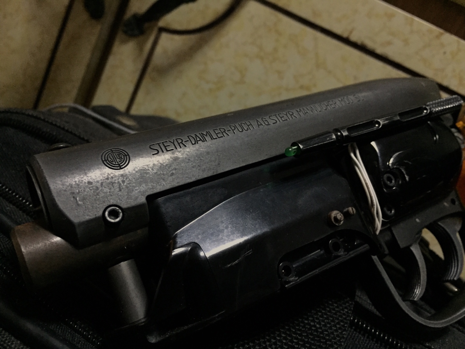

It actually showed up after I blued the barrel. I let some of the blueing solution residue sit on the barrel to get some speckle stains on it and they turned to rust. Somehow its not working the same way for the top receiver, so I'm still trying to figure out how to achieve the stains and rust on the top.
Nice rust on the barrel, did you do that somehow or was it already there?
The receiver is ZAMAK (I forget the exact number) which is a zinc alloy. It won't rust like the steel barrel. They make rust solutions that you can paint on, though, which could work!
Thanks for the info!! It's helps more than you would think!

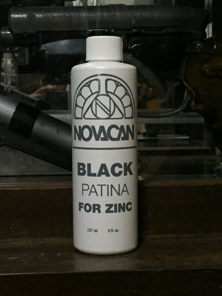

So I have yet another development, thanks to the info provided by veektohr about the material of the top receiver. I found a zinc blacking solution that gave me the results I was looking for. However I'll consider this more of a practice run as I gave it an all around coating to darken the entire receiver but it ended up dulling the finish a bit. As soon as I get my Birchwood Perma, I'm gonna re-polish all the parts of the receiver and blue it again. Once that's done I'll sprinkle the zinc solution like I did on this try to get the rusty spots that I was looking for.

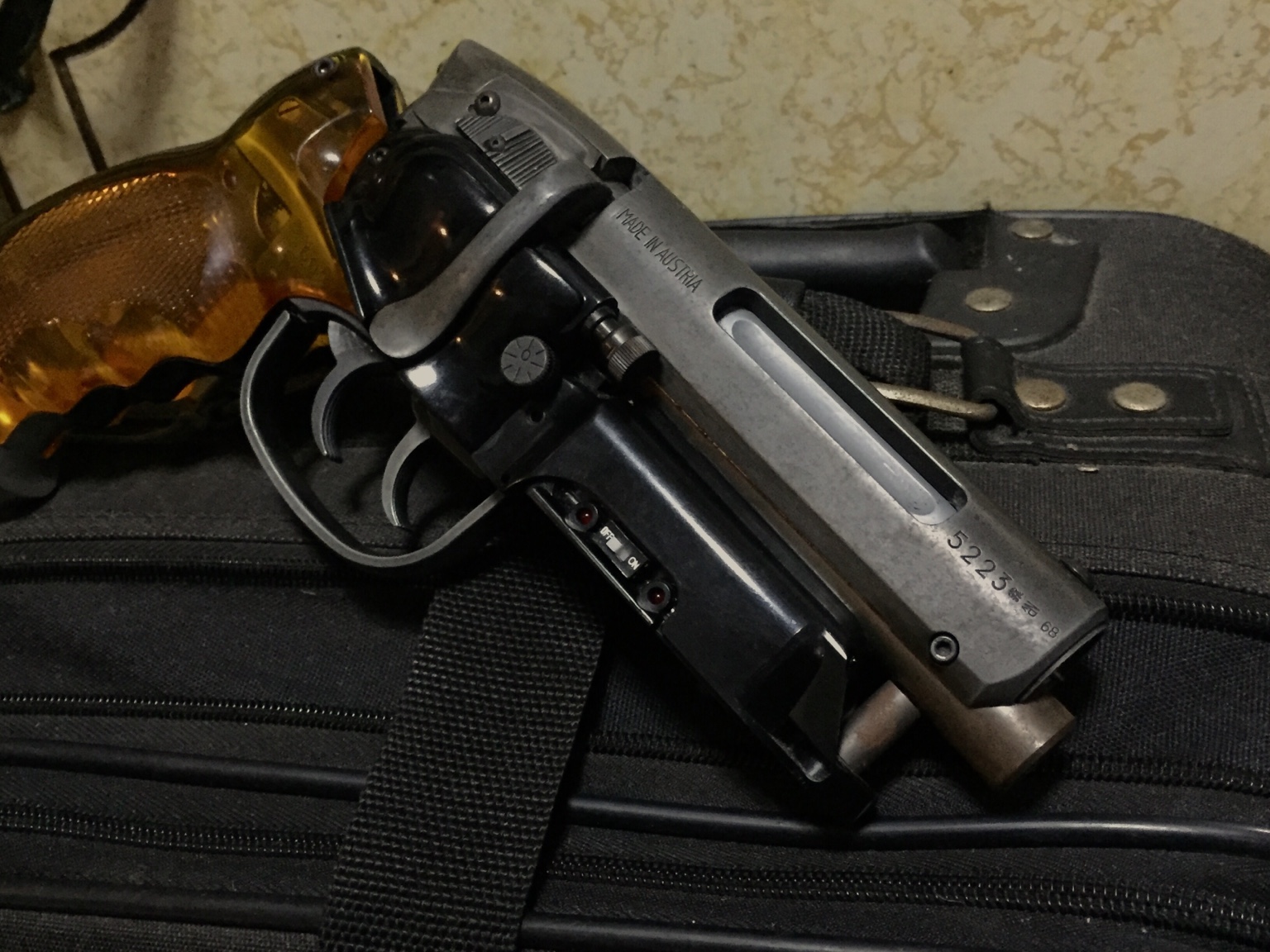

Crapy cellphone pictures for now. I'll post better ones after I polish and re apply the bluing and rusting.
