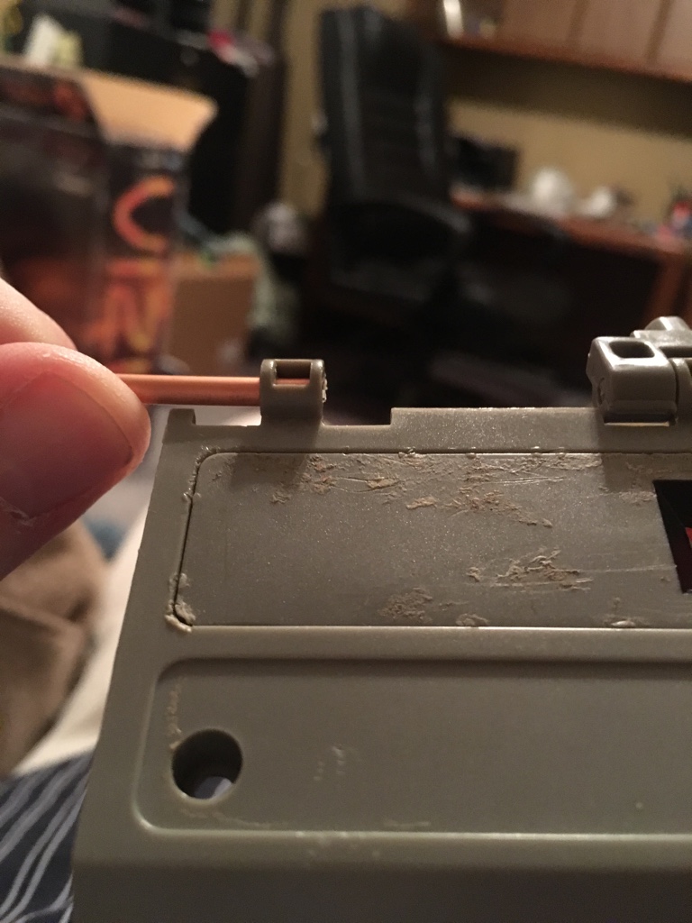

The one thing I had yet to figure out was how to get lighting inside the door of the toy. Luckily, Alex Kalcher had a plan to use brass in the plastic hinge system to move electrical current to the door. I decided I was gonna try this out. So I went to Hobby Lobby, and couldn't find brass tubing and rod, so I settled for copper. It's my hope this works well, and the plastic and paint insulates the circuit.
You can see I haven't quite cut the pieces yet. Wish me luck on this folks!

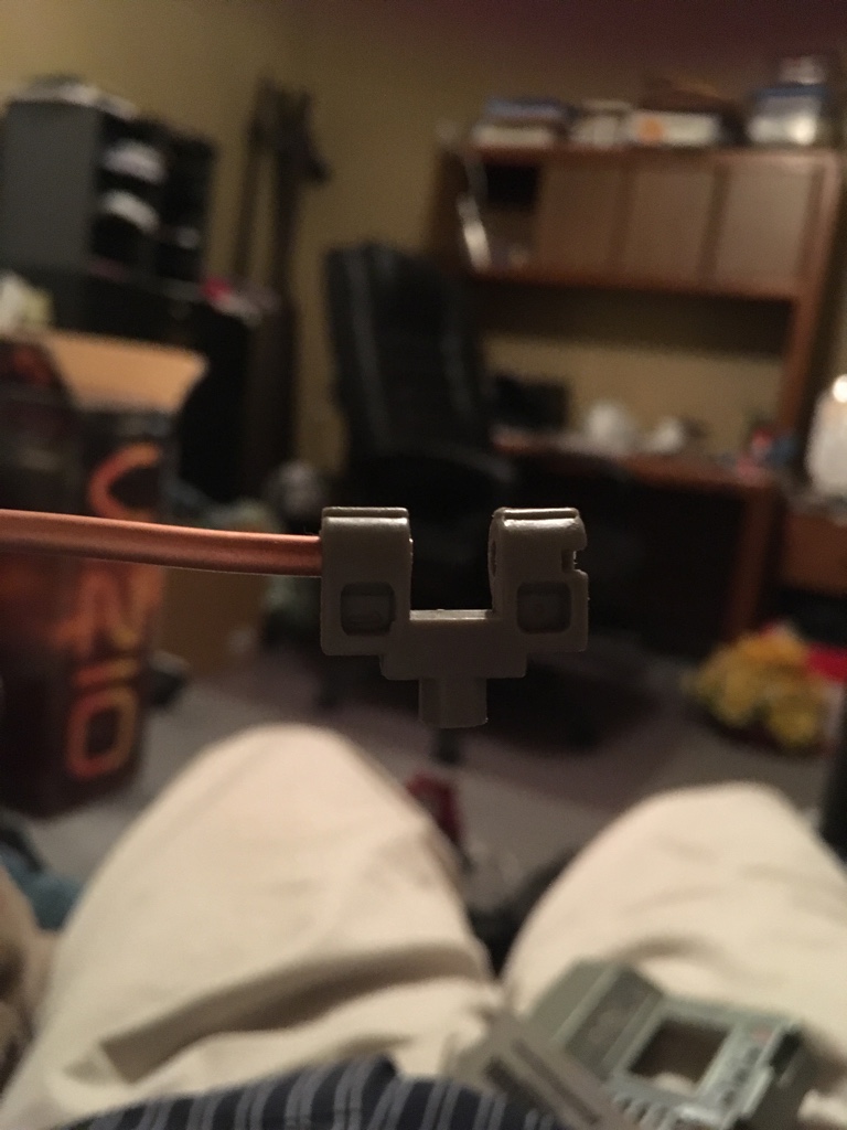

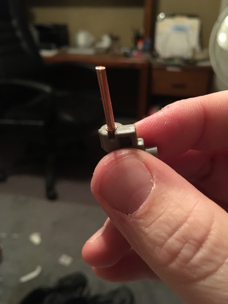

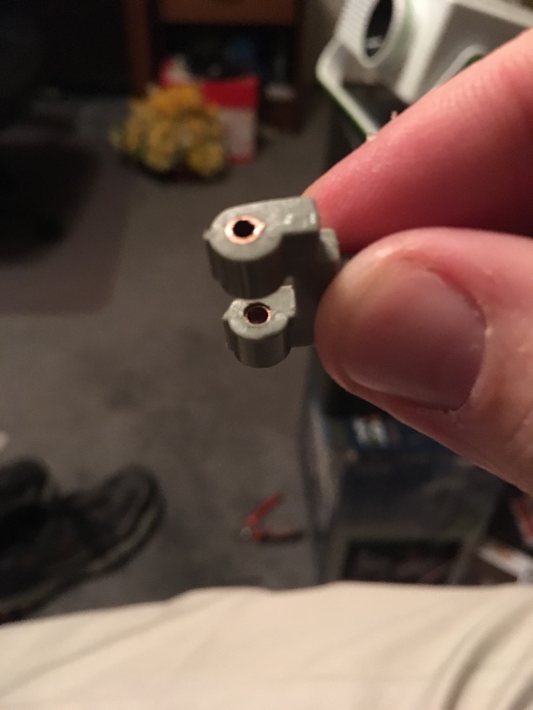

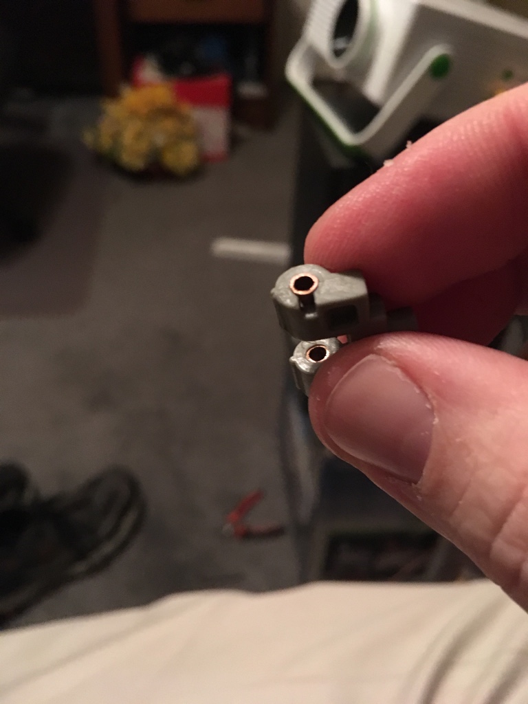

Copper in the door part of the hinge
Copper in the hinge itself. I bought everything just a tad too small, but it'll still work and completely fit the way I want it to.
I've got a lot more work on this to do. My plan is to have the entire door sealed, puttied, and smooth like the rest of the body. Gonna buff out the copper to allow for easy soldering, and hopefully find my wiring so I can hook this baby up to the electronics (just found out the kit actually has a positive and negative lead on the viewscreen board, super stoked about that)

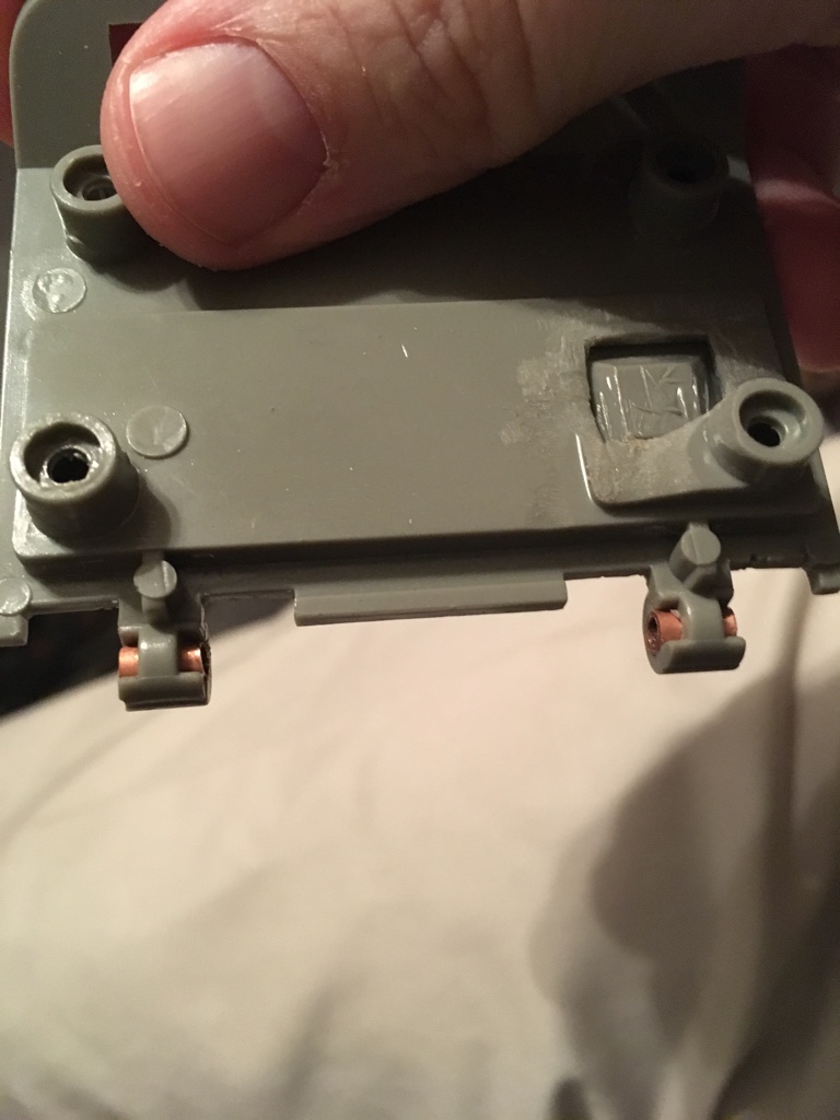

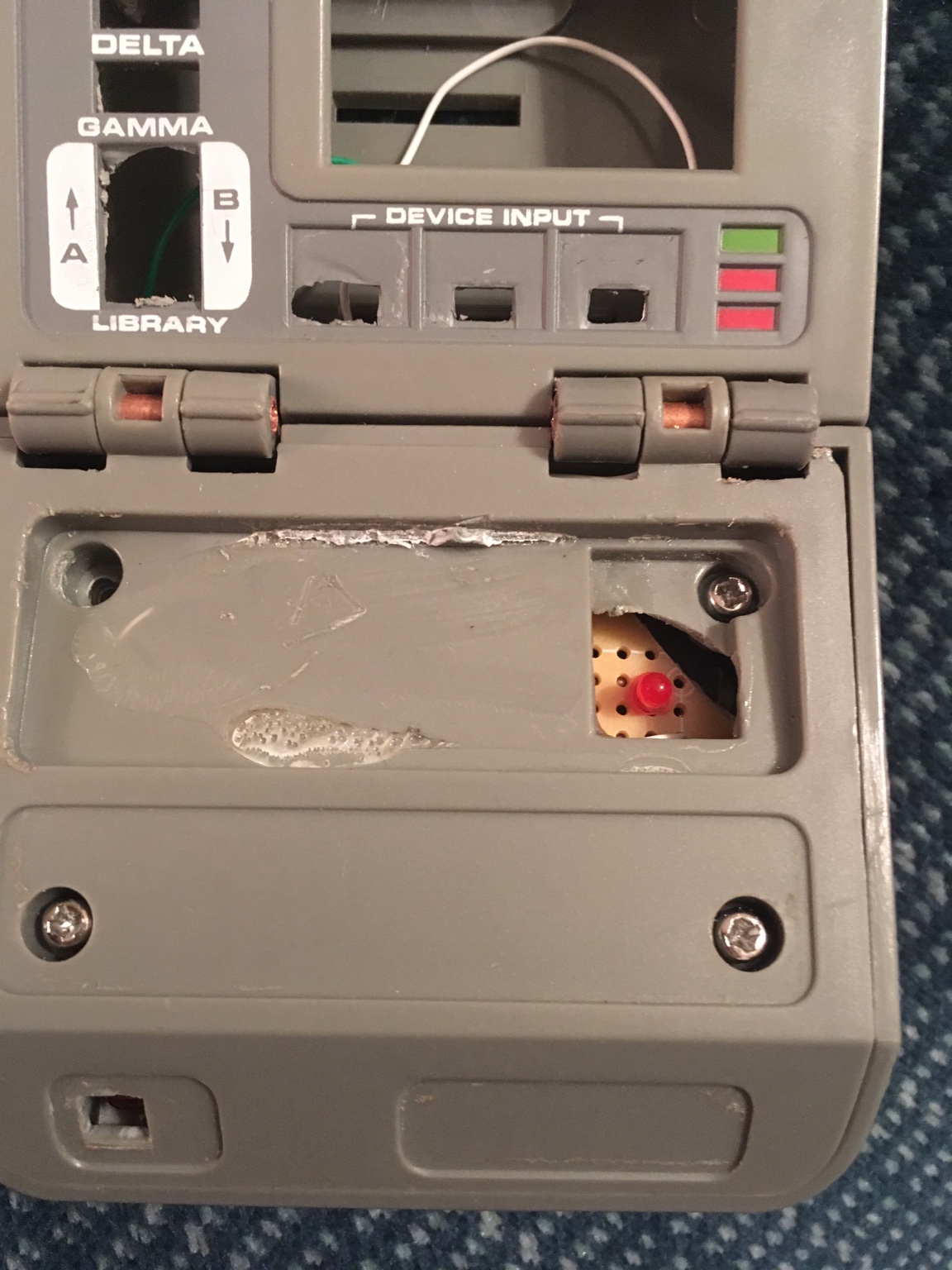

Did a little more work on the door and have one hinge finished and will be working on the other one today or tomorrow one :)
Another GMProps playmates Mark VII Tricorder

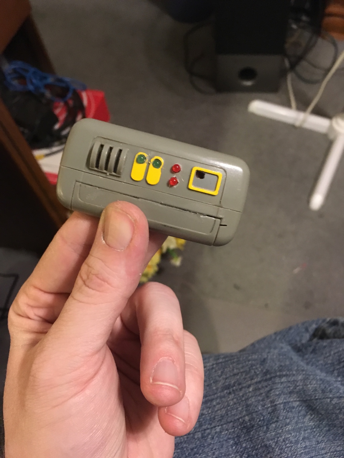

Finished the hinge electronic system. Tested and!
They work!
I also managed to instal the magnets as well. I used Gorilla Glue Mounting tape to secure it. Shouldn't have any problems with things becoming lose, but I also plan on using hot glue as well to secure it tightly.
Decided to take a picture of door working. Using weak battery

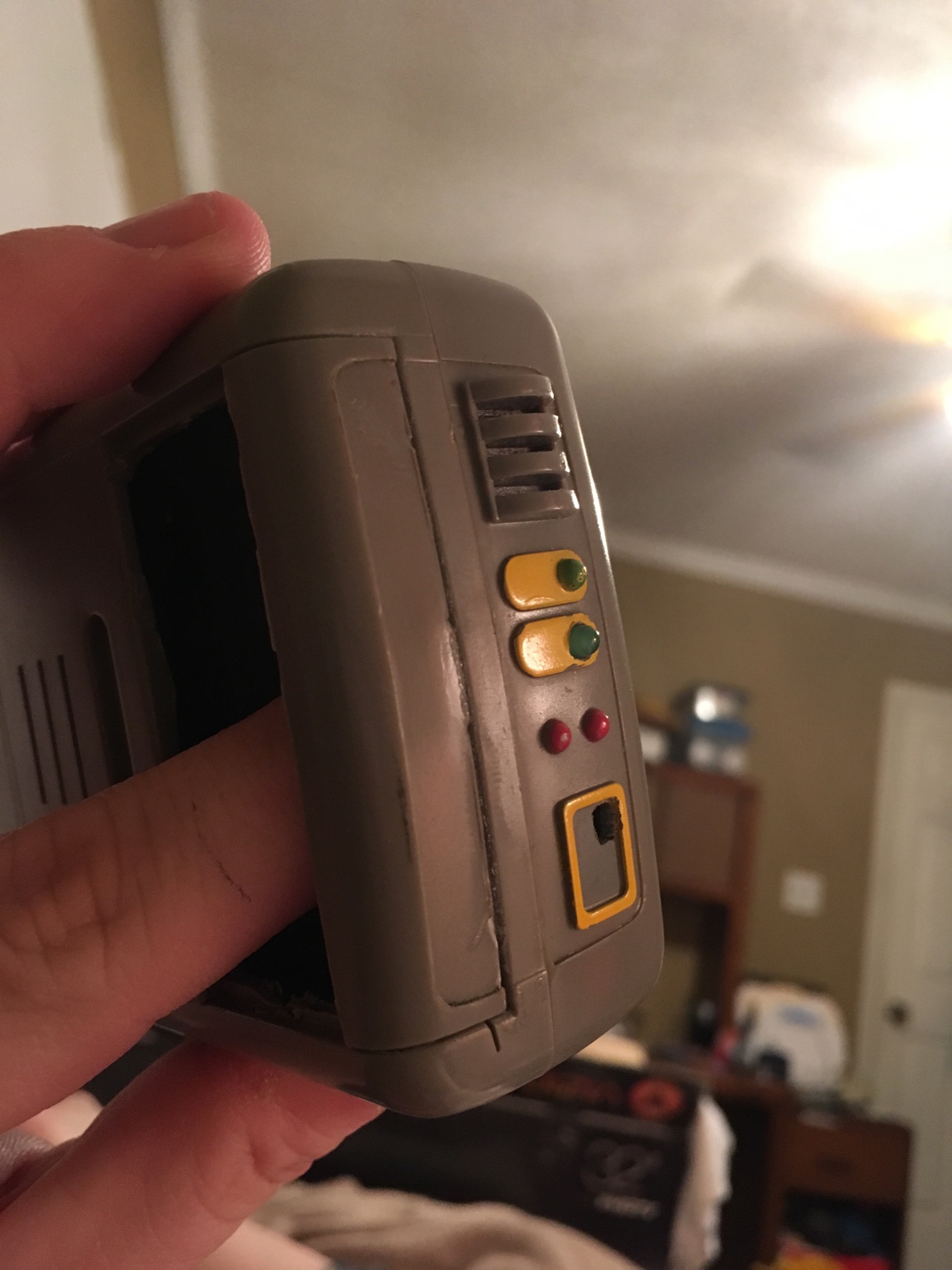

Front sensor array needs another white coat where they go, but I'm happy with the results

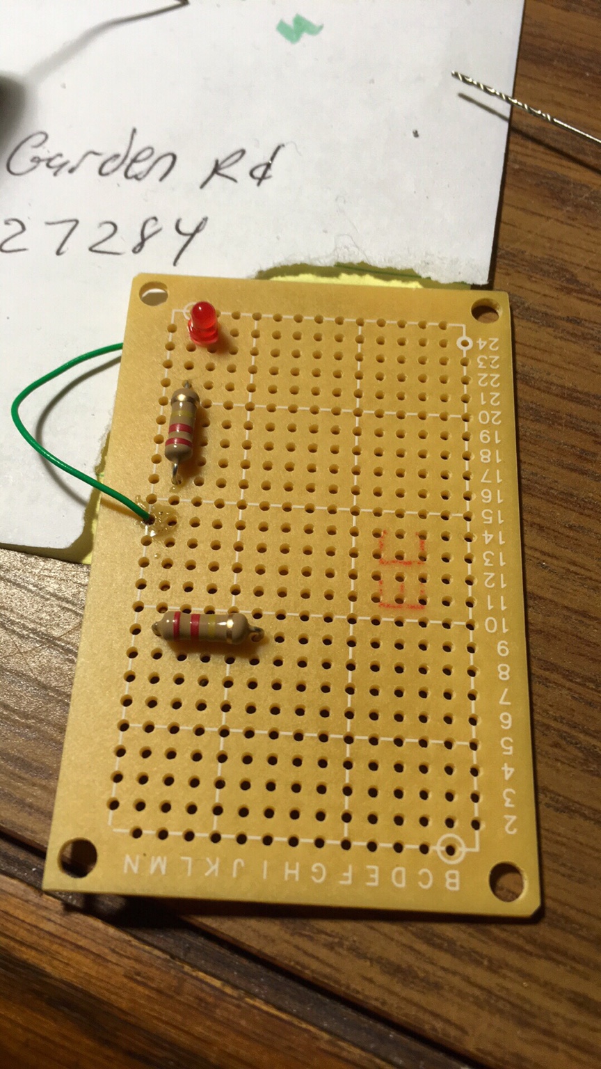

The door LED's...I think are underpowered due to me using a higher resistor...oops, but next time!
