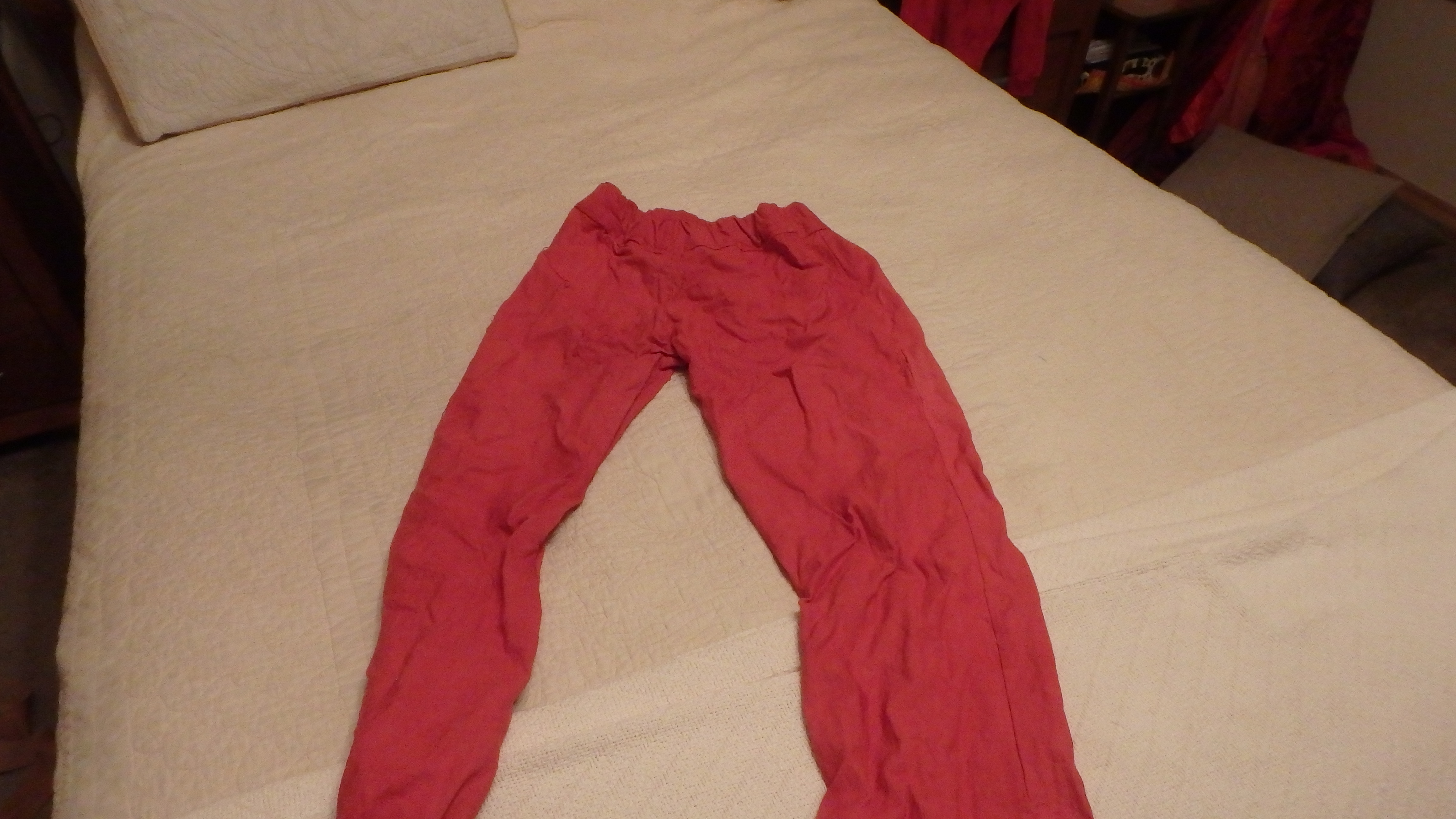

The Pants:
This is where it gets extremely inaccurate. As I didn't have a whole lot of fabric left I decided to go with a tighter pant then in the movie or historic. The reason for this is that in the movie you don't really see it and it is wrapped up tight with the greaves and other wraps. Instead of having the extra fabric create heat and a lot more work while putting it on I went with a rough pattern from an old pair of jeans and went to work.
They look ridiculous without any of the armor but once the armor is on you don't really see them and overall match the costume.

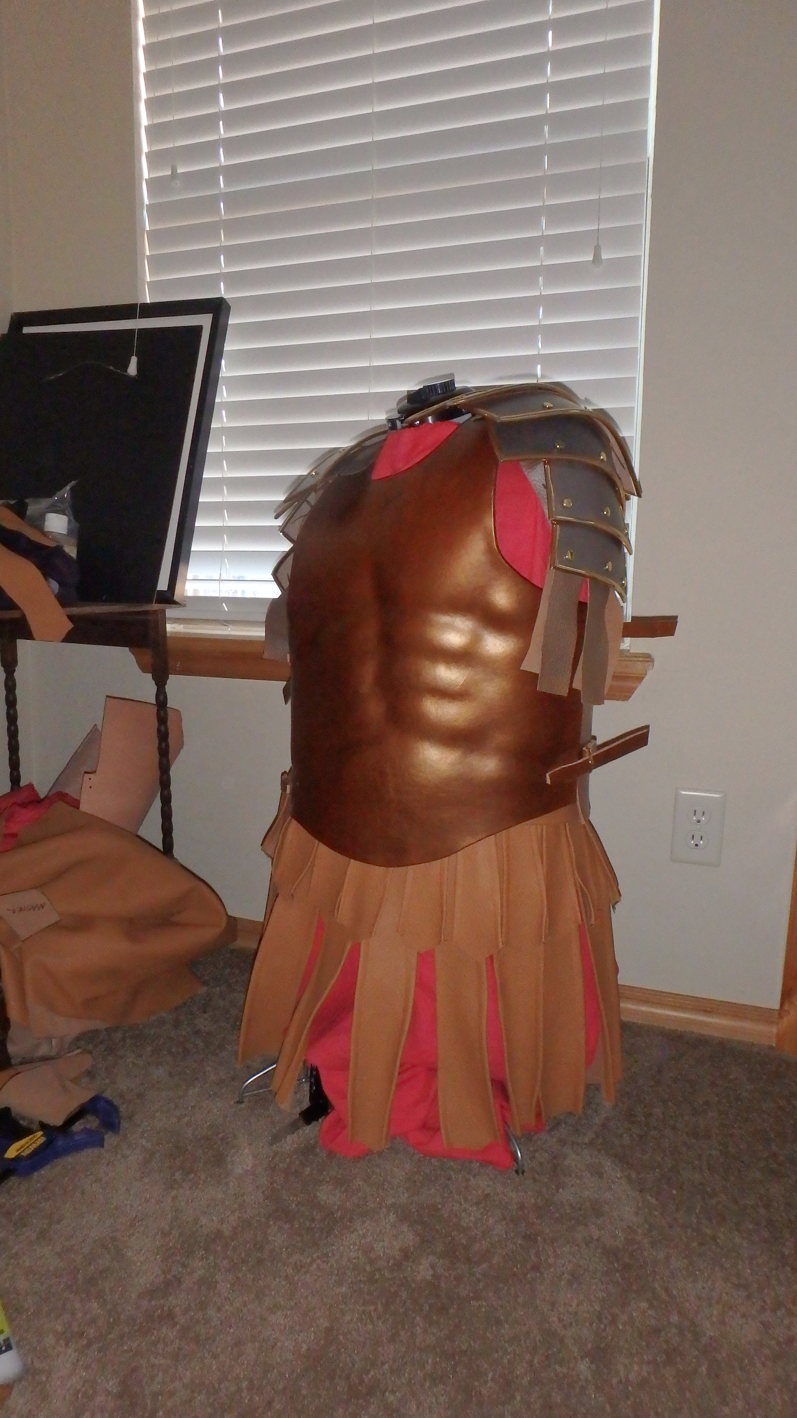

The Cuirass:
When I started this project my plan was instead of spending hours and money trying to make something look like the real thing instead I would just use the real thing. The primary example for this was the leather work. Instead of using foam or some other material and making it look like leather I would just use leather. The base cuirass was purchased already formed (Seemed like a good deal off ebay at the time) with the back piece made out of some Vege Tanned leather. This was formed by wetting the leather and laying it over a dress form.
The pauldrons were made out of the same leather and wet formed in the same way. The leather was then stained with gold and silver water based dyes where appropriate.
Some soft leather was then used to combine all the pauldron pieces together. Initially I used split pins as I though the flat look at top was more accurate but ended up settling on rivets that were a lot stronger.
The leather skirt was made of more of the soft leather. This was cut to shape and a seam sewn using my wife's sewing machine. This was all glue together using barge cement.
My 3 year old daughter was impressed with this and proclaimed "Daddy has pretty skirt" so I knew I was on the right track. Finally some left over vege tanned leather was combined with some buckles to connect the front and back. I ended up joining the skirt to the cuirass to simplify putting the costume on. The actual costume seems to have these as two separate pieces.
When going back through this build I had forgotten that I had mocked the whole cuirass up in cardboard (complete with hot glue sculpts) before buying anything.

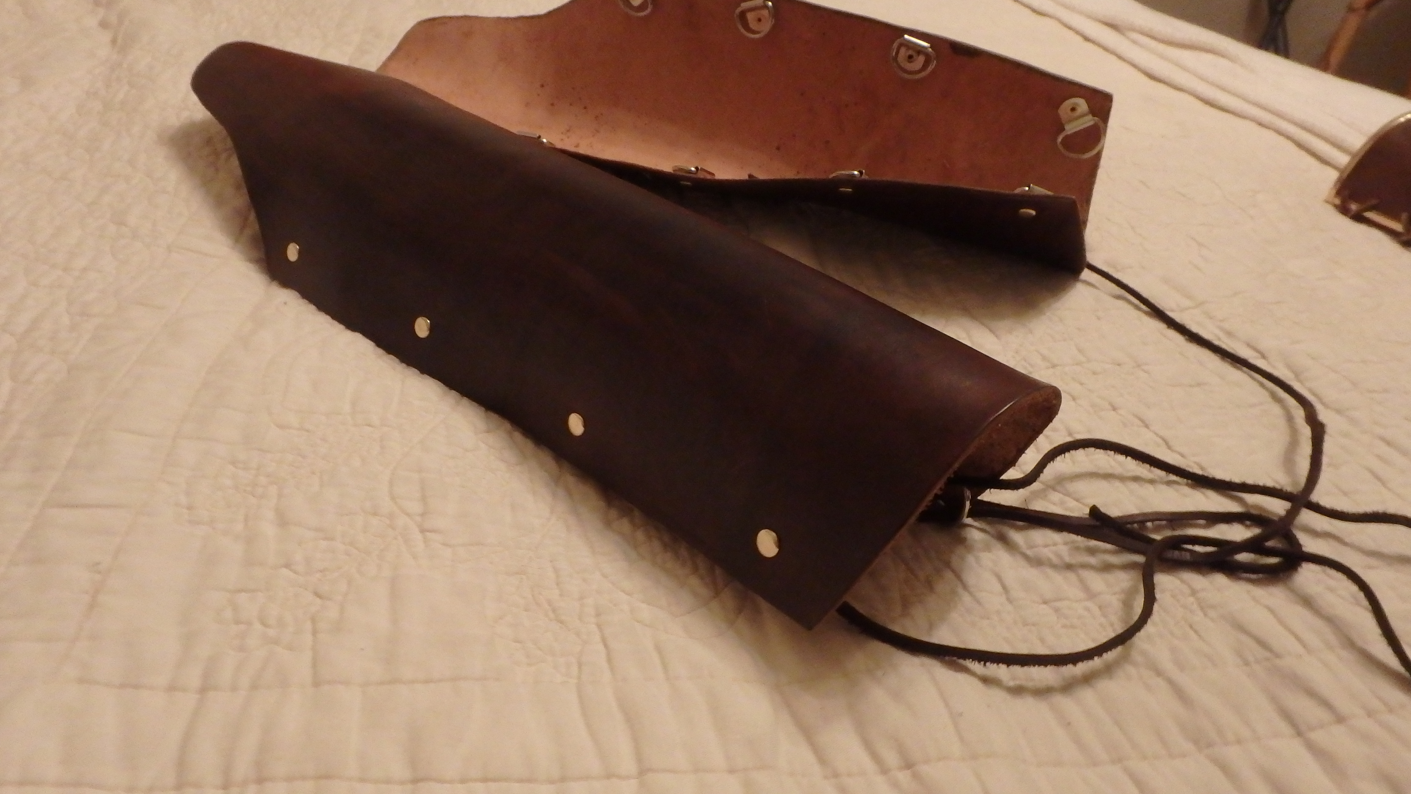

The Braces:
This followed a similar thread to the Greaves. I intially planned on trying to mimic the original as best I could, however my initially attempts failed so I followed my own artistic guidance after this. The patterns was originally made by getting some string and beads and making a negative that would be imprinted into the leather. This failed to work so I ended up purchasing some filigree metal works from the local hobby lobby beading section and made a negative impression out of it. I then wet my leather that I was using for the braces and attempted to imprint the pattern into the leather. After various attempts at using a slip roll (tool for creating rolled metal sheets), hammering, driving over and simply pressing the pattern in my final technique involved literally jacking my car (Subaru Outback) on top of the wet leather and pattern. This worked quite well and gave a nice subtle pattern even if it was time consuming.
After hitting it with the same gold stain I used of the Cuirass the pattern was acceptable visible. The edges were covered with Gold Automotive trim which I used on the Pauldron pieces as well. This how Gator Fett did his build which can be seen here

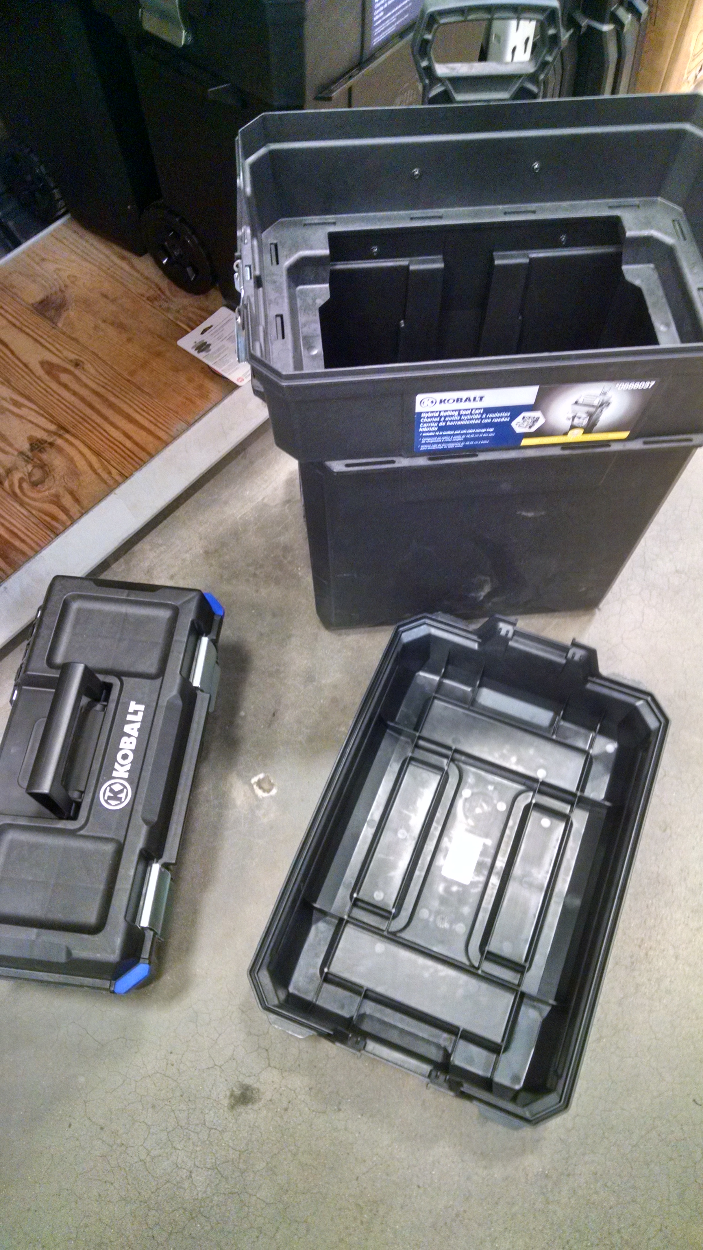

Storage: Since I have had this sitting in our bedroom on a dress form for the last year as I worked on it, I decided now that it was complete it was time to put it away.(My wife's costume occupies that place for now, but more on that later). I have seen previous threads on how people store their costumes and decided I would add this last little part just to show how I solved it.
After searching all the local hardware stores and other storage stores I came across a rather odd shaped tool box.
After adding some foam to protect the front I created a hanger that would basically hang the costume from the shoulders.
Finally all the soft parts were put in the base of the chest with one of the soft pieces layered on top to stop the whole piece from moving too much.
It is a little awkward getting out but I feel confident it will hold up to the abuse of being moved around.
