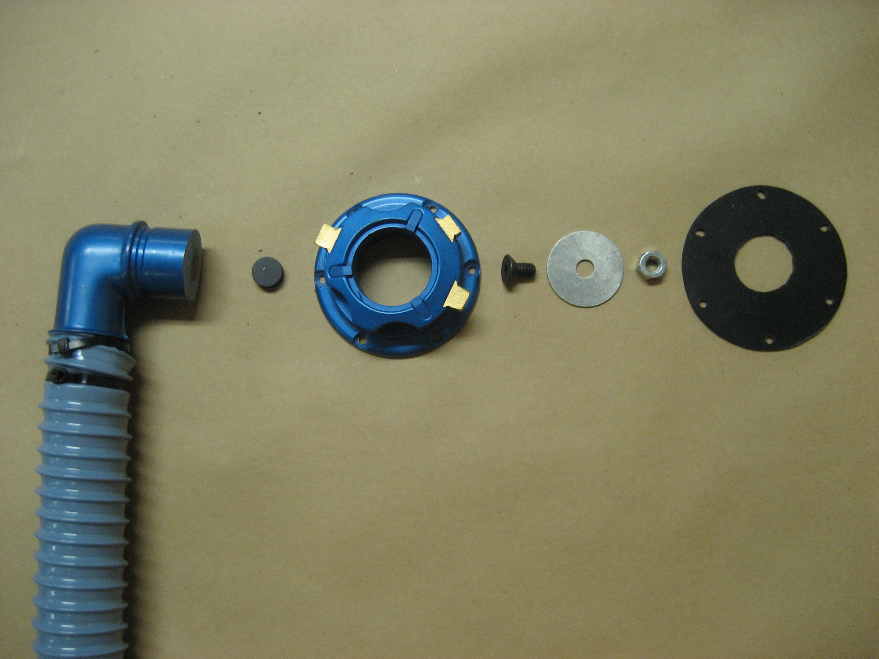

Here are some Apollo spacesuit fittings, cast in urethane with a metallic blue powder. Only the surface is dusted and I think the resin is black.
