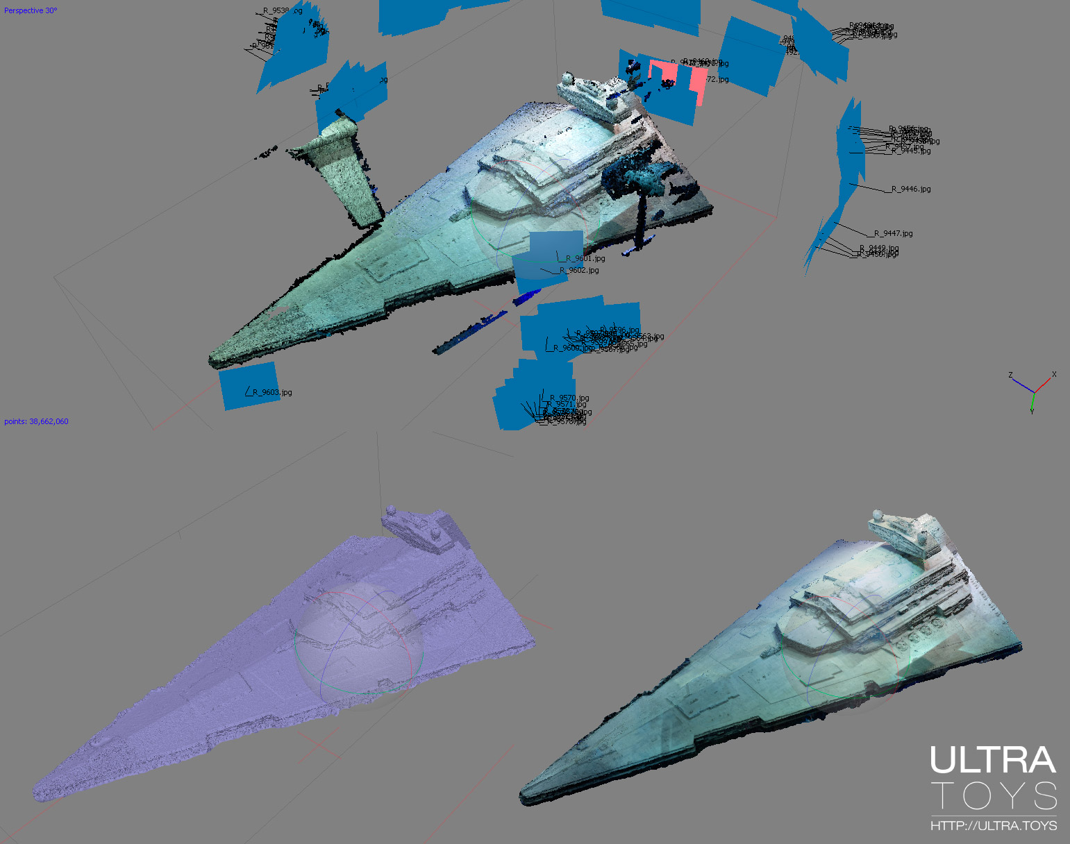

Then recently, I wanted to own again an ISD. I looked at the kit and all the new ones doesn't look nice, too small, not enough details, or difficult to find or very expensive. Then why not doing my own, using my 3D printers. I was also very lucky to visit the Star Wars identities exhibition in Paris which was presenting the Avenger. I took a bunch of photos and when back at home, I have been able to rebuild it through a 3D scan (I used the photos to produce the 3D scan). I had most of the references I was looking for.
I'm currently at the early stages of the production: looking to the proportions, building the main volumes. Then when everything will be done, I'll do a test print of the assembly, then I'll start the details part. It will be at 1/1600 scale, making a 100 cm model kit.
Some images. The 3D Scan:

The point cloud looks great! Which photogrammetry software are you using?
Re: Imperial Start Destroyer Avenger 1/2000 - 3D Printing
Thorst: I'm using Photoscan d'Agisoft. Very cheap and really powerful!

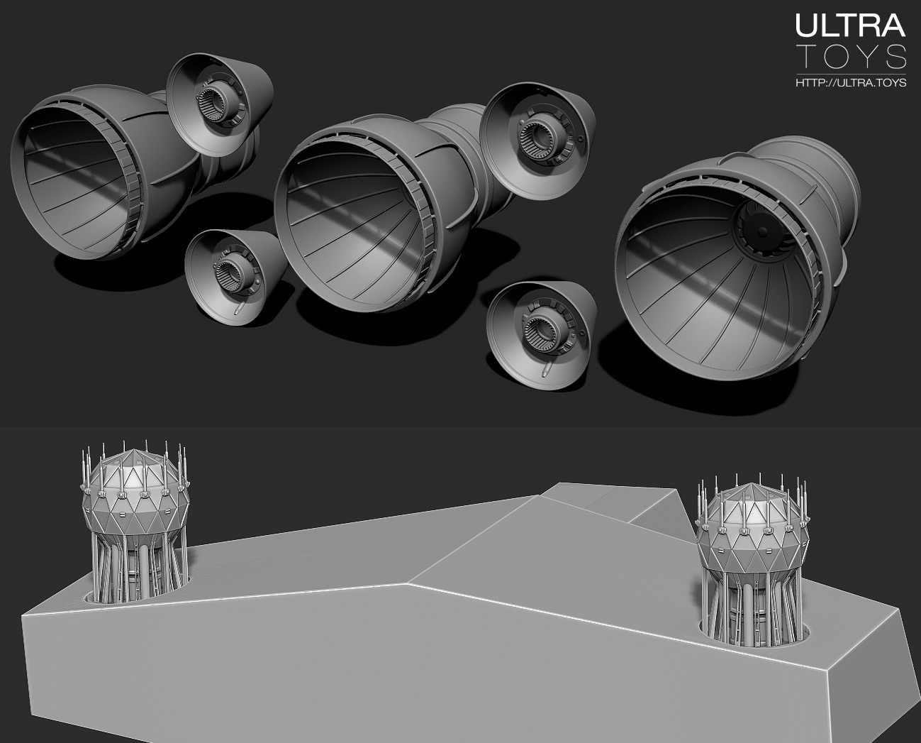

I found some time to start building some detailed parts. It's not that much, but it helps me anticipating what will be long to build or not.
Then I started with the shield generators and the main engines.
I did a test print of the shield generators and even if the printer has been able to print the small antennas, it's way to thin at this scale. Then I had to change the thickness. I may adjust later this part.

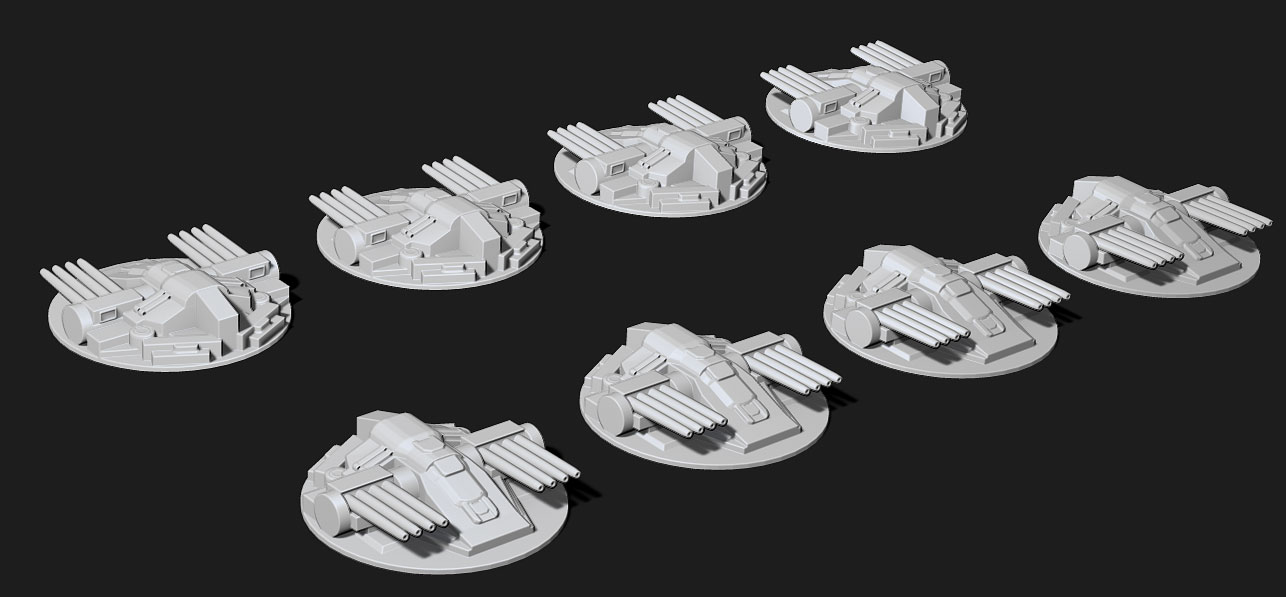

Some updates... I add to rebuild some parts as it was problematic for 3D printing with some very tiny parts, especially the antennas of the shield generators. I also moved forward on other parts like the main turbo lasers and now I'm focusing almost on the main deck (don't know the name in english, sorry, the top part..)
These are the Turbolaser. Not easy to find accurate references, but they looks close to what I have in my bunch of photos.
And a test print:
This is a photo of a test print of the shield generators. I'm happy to see that i'll be able to print the tiny antennas without issues this time. I slightly bend them during the manipulation, I'll have to be extremely careful when I'll do my final prints.

For now, I'm on the engine part. I did all the core items and I started to build multiple parts that I will reuse all along the project. Then I hope it will speed up the process.
