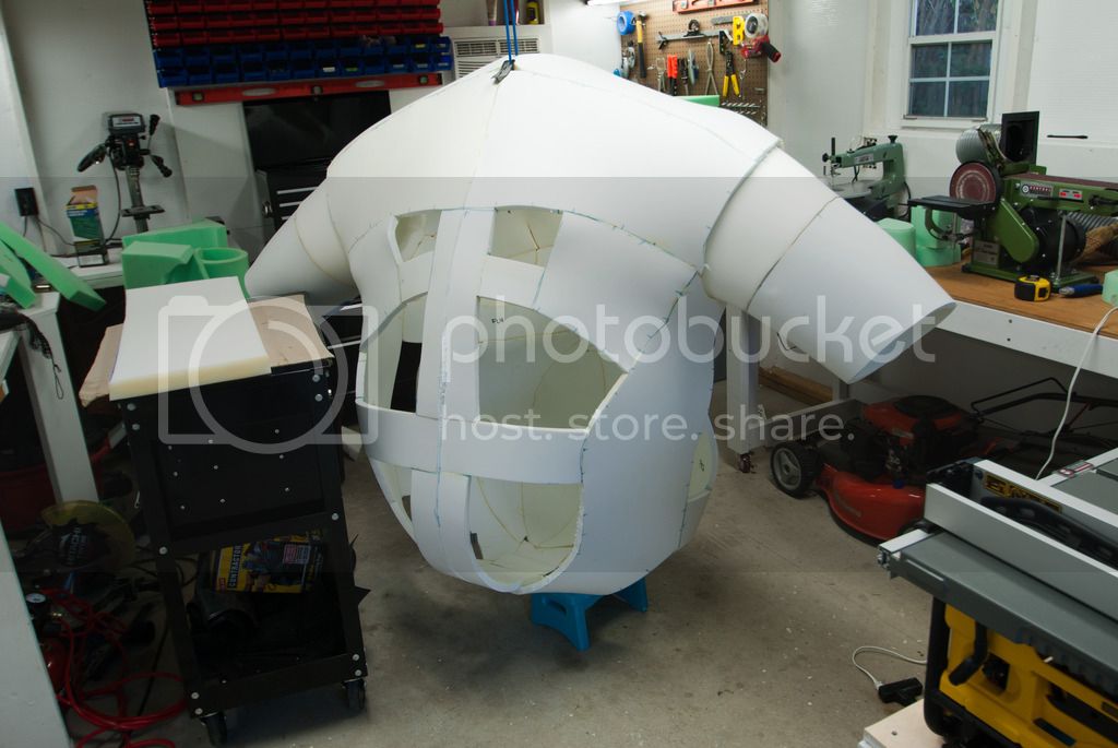

Foam Assembly -
using 3/4" L200 Foam white and Barge Rubber Cement
Beginnings of Body
Foam head with Blue painter tape to mock up the face and mouth
Torso and Head checking scale with Daughter (who I call Ace ..so she will be called Ace for the rest of this thread)
Ace inspects my glue job
first time working with Barge or the Foam but it's pretty east to work with as long as you have a game plan- just be sure of good ventilation and wear a painter mask when working with it.
Back- cut the seam in it so I can get in and out of the costume and I have 4 buckles on the inside to clip it back together-
Here you can see the buckles and the Harness I built into the suit - along with the Barge cement they are bolted in the 3/8 carriage bolts Stainless Steel (so I won't get rust if they ever get wet.
Body complete- the legs and arm section between the shoulder and forearm is 1 1/2 upholstery foam so it has better flexibility- You can also see the side vent I put on each side of the belly to help move air thru the suit...it will be covevred with fabric and unseen but the material we are using will still let some air in and with the open space on the back help push heat out keeping me comfortable.
