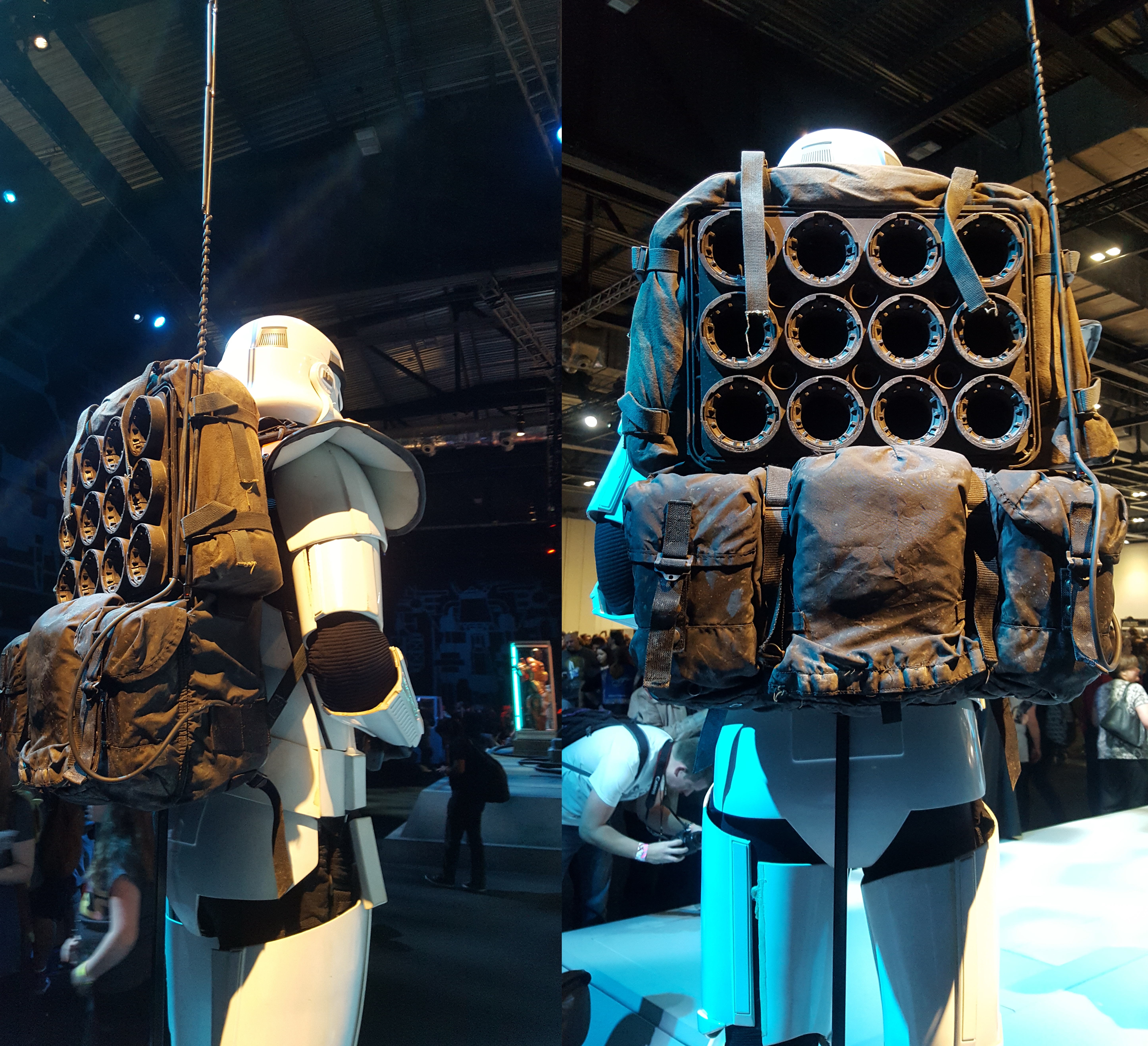

This thread will look at the Rogue One Stormtrooper (R1 TK) back pack as seen on display at Celebration Europe 2016 (CE) in London.

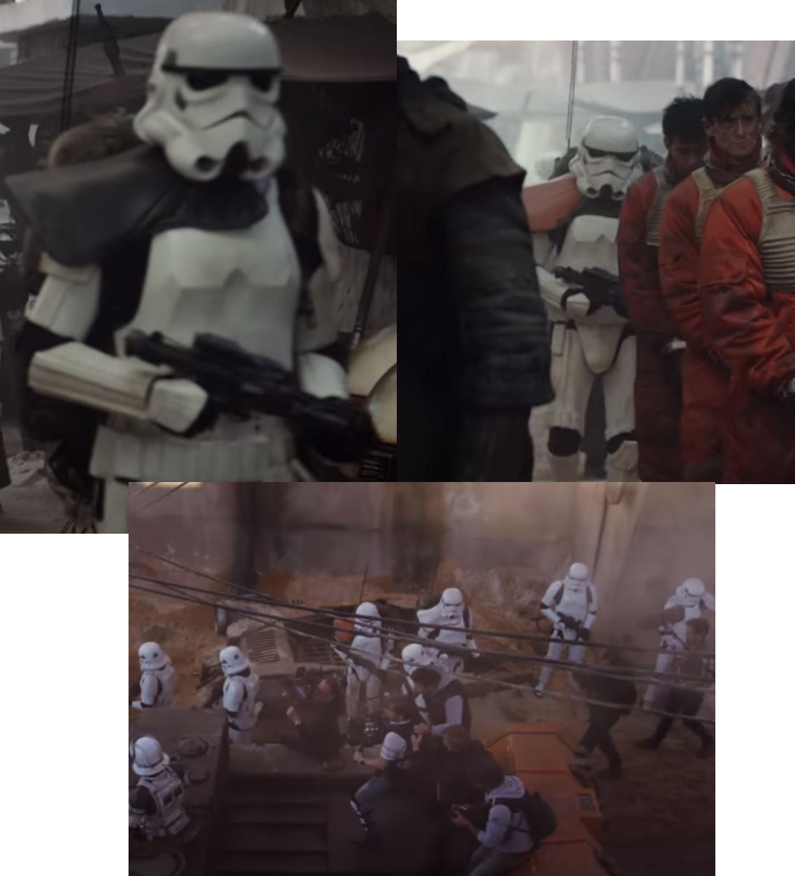

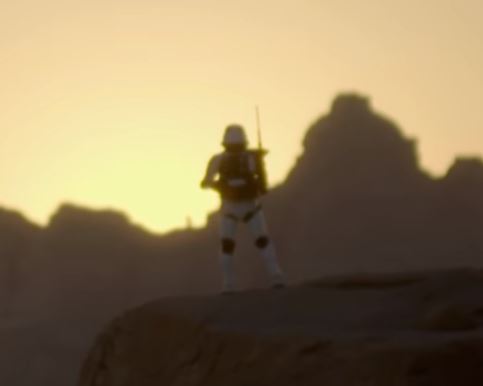

It is recognised that at least 3-4 R1 TKs have been seen wearing the back pack in the trailers, CE sizzle reel, and various promotional material. This build is concerned ONLY with the CE R1 TK pack, as this is the most documented and readily scrutinisable prop; due the vast online reference library generated by attendees at the convention. It is possible that there are variations in the builds of other packs used on screen in the final theatrical cut of Rogue One.
We will also mention obvious variations in wearing the pack such as: placement of the pauldron over or under the right shoulder strap, and inclusion or omission of the detonator cylinder.
This build is NOT associated with the R1 TK ‘hard’ back pack – the ‘Jedha Stormtrooper patrol’ pack – available from Hot Toys…
…and glimpsed in the CE sizzle reel.

The investigation behind the thread has been on-going since the pack was first seen in July 2016 at CE, with an increased focus over the last few weeks. The research is primarily a collaboration between four individuals: Paul Prentice (mr paul), Chris Trevas (lonepigeon) of ‘Parts of Star Wars’ (PoSW), Jody Williams (ht7), and myself Ian Reach (Yutani Exec). Other notable contributions regarding certain parts have come from Andy Rodgers of ‘The Shed of Glittering Delights!’ (SoGD) Facebook group, and also the initial thread started by TK Gino on ‘1st Imperial Stormtrooper Detachment / whitearmor.net’ (FISD)’.
As well as significant time and effort researching the pack and its components, the team has also purchased found part components, along with numerous samples of ‘close to’ parts and sub-components, in efforts to build the most accurate / authentic pack possible. Many a blind alley has been explored, with a discard pile of ‘not quite correct’ parts steadily building over the last couple of weeks. The build is based mr paul’s version 2.0 pack, as he and ireachy broke-down his version 1.0 pack based on the team’s detailed observations.
The thread is intended to share the knowledge developed by the team, help others avoid mistakes we have made, and to act as a guide to building the most authentic R1 TK back pack possible. Of course, you can take as much detail, or as little, from this thread as you wish to inform your own builds, but we hope to present a compelling break-down and guide to building the prop.

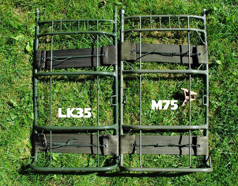

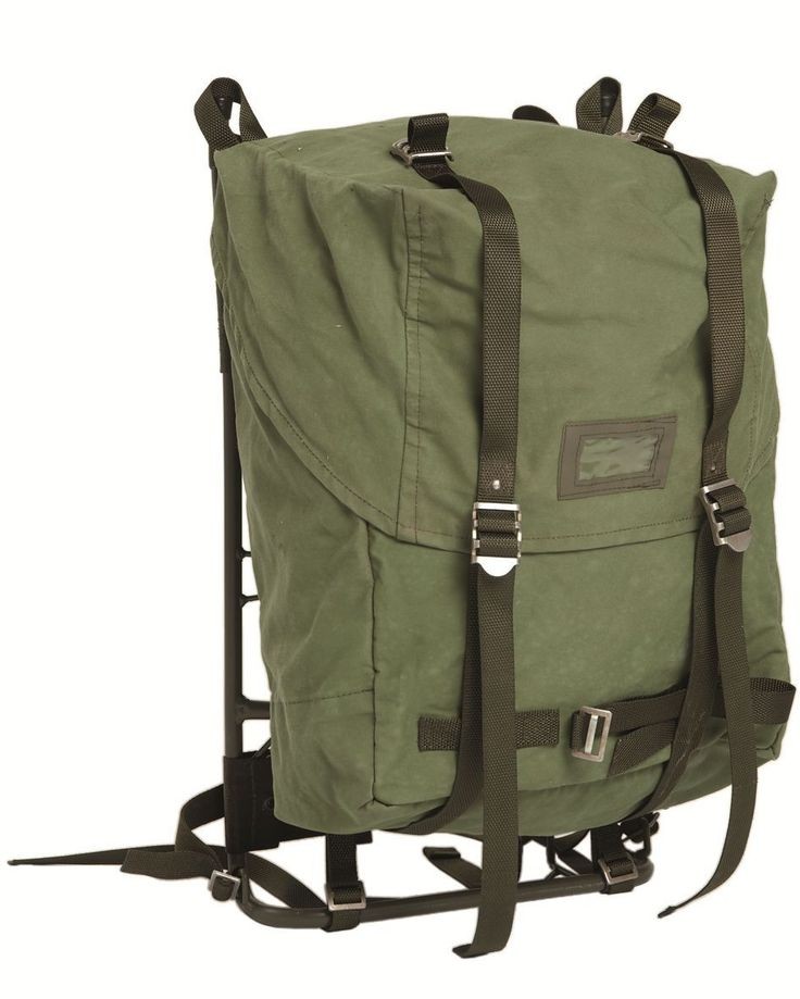

Haglofs made a civilian version of the LK75 until the late 1990's, with early models having cotton webbing straps, and later version with nylon ones (Lars E Grimstad, on PoSW).
However, clear pictures of the CE back pack frame, especially detailed ones are very difficult to find. Primarily due to the fact that it is obscured by the trooper and the rest of the actual TK pack itself. However as seen in the pictures above, the frame is mounted outside of the attachments. The frame is not within the Alice pack.

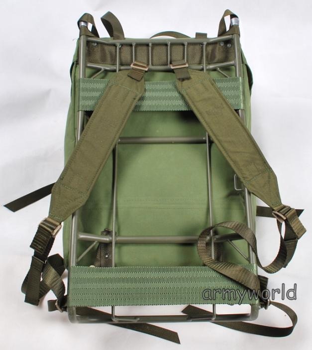

The LK35 and the M75 packs are almost identical, and discussions on various forums have shown that suppliers themselves do not appear to realise the distinctions between the two packs. Reading through discussions it has become apparent that LK35s have been sold as M75s, and vice versa. Pictures listed with a supply of LK35s can be M75s, and more worryingly many M75s listed with accurate M75 pictures are turning out to be LK35s. It appears the only way to mitigate this mis-identification will be to visit a surplus store in person and sort through the stock.
The pack below is an LK35…
…and this pack is an M75…
…and this pack is sold as an LK35, and yet it is an M75…
It is relevant to note that the soft part of the pack and the shoulder straps are discarded. They are NOT part of the CE TK back pack, and NONE of the webbing or buckles are used in the build (evidence to support this will be discussed in greater detail in subsequent build sections associated with the Alice pack and the canvas roll).

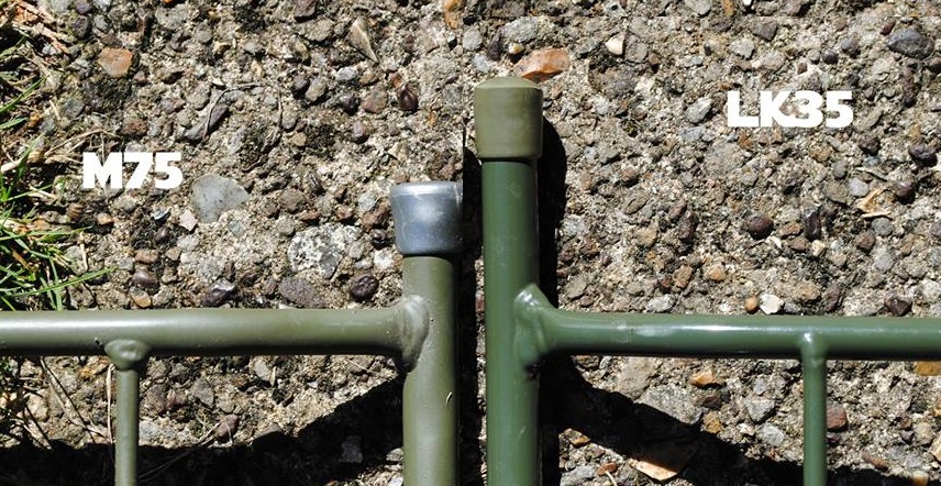

The photographs below show a comparison between the LK35 and M75 frames…
…and show the key diagnostic features to determine the LK35 from the M75 relate:
• The height of the frame posts at the top of the frame to which the soft part attaches;
o 45 mm on the LK35;
o 28 mm on the M75; and
• The shape and colour of the frame post end caps;
o Linear and green on the LK35;
o Slight inverted cone shape and light grey on the M75
 Note that there are apparent colour variations and some correct shaped end caps have been supplied in black, not the light grey;
• The shape, angle and welding points of the webbing attach mounting at the bend of the frame’s ‘shelf’;
o Nearly perpendicular to the frame back and shelf on the LK35, and welded to outside of the frame;
o More acutely angled in relation to the frame back on the M75, and welded in-line with the frame;
• Slightly larger / deeper shelf on the M75 compared to the LK35;
o The LK35 shelf depth is ~90 mm; and
o The M75 shelf depth is ~105-110 mm.

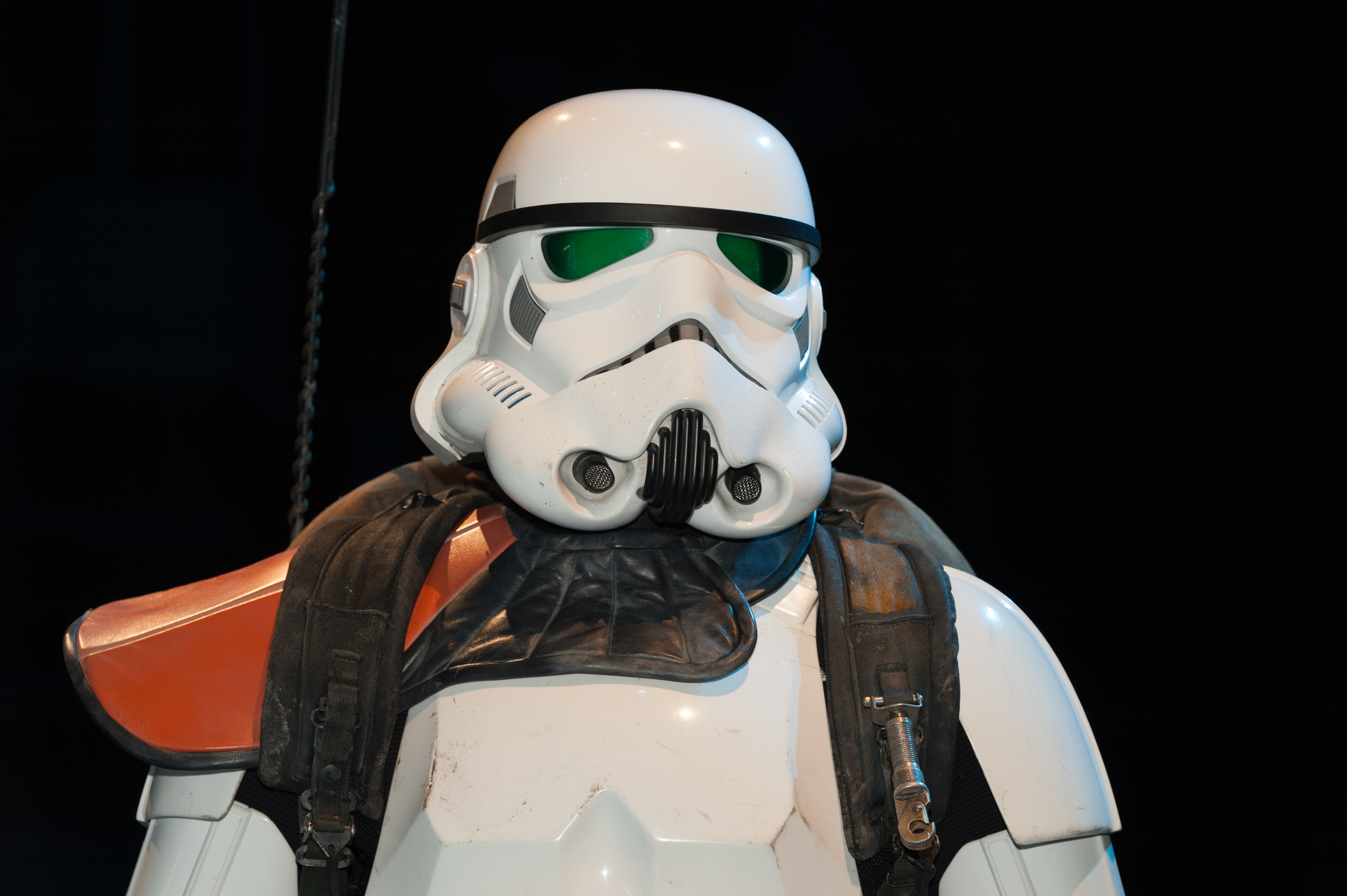

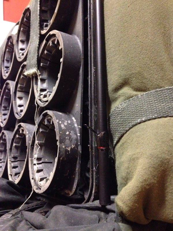

These details are important, as analysis of reference photography for the CE back pack, primarily associated with the posts and end caps and the webbing attachment mount, has allowed identification of the frame type used on the prop. The details seem to indicate that the correct pack frame used on the CE back pack is the M75, NOT the LK35. The M75 ‘feels’ slightly more robust and bulky than the taller LK35 – although this is purely a subjective feeling. This said, do note that certain M75s have been received with the correct shaped end caps but in black, not the light grey seen on the CE prop.
The picture below shows the post end cap is grey, not the green seen on the LK35.
Also, the frame section tubes are ~14 mm diameter, and the height of the post, from the horizontal top bar of the frame, is approximately twice that measurement i.e. close to the 28 mm of the M75 frame. Certainly not the 45 mm of the LK35.

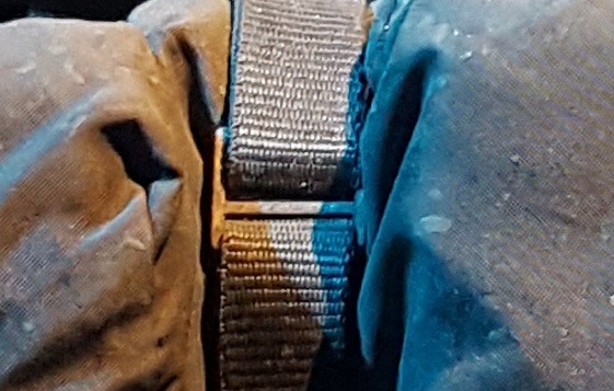

We also know that the webbing on the canvas roll is 1” / 25 mm width webbing (this will be examined in greater detail in the canvas roll build section). The distance from the top horizontal bar on the frame is nearly exacting the same height as the webbing width (on the canvas roll). This means that there is little more than 1" / ~25mm left on the frame upright from the upper horizontal bar to the end of the post and top of the end cap = ~28 mm = M75. If the frame was an LK35, then the top of the post (from the top horizontal bar) would be closer to 2 x width of the webbing (on the canvas roll). This appears to validate the hypothesis that the frame is the M75.
The picture below shows that the weld spot for the webbing attachment mount does not extend all the way across the frame outside as is evident on the LK35. Rather, it is aligned with the frame and is barely discernible.

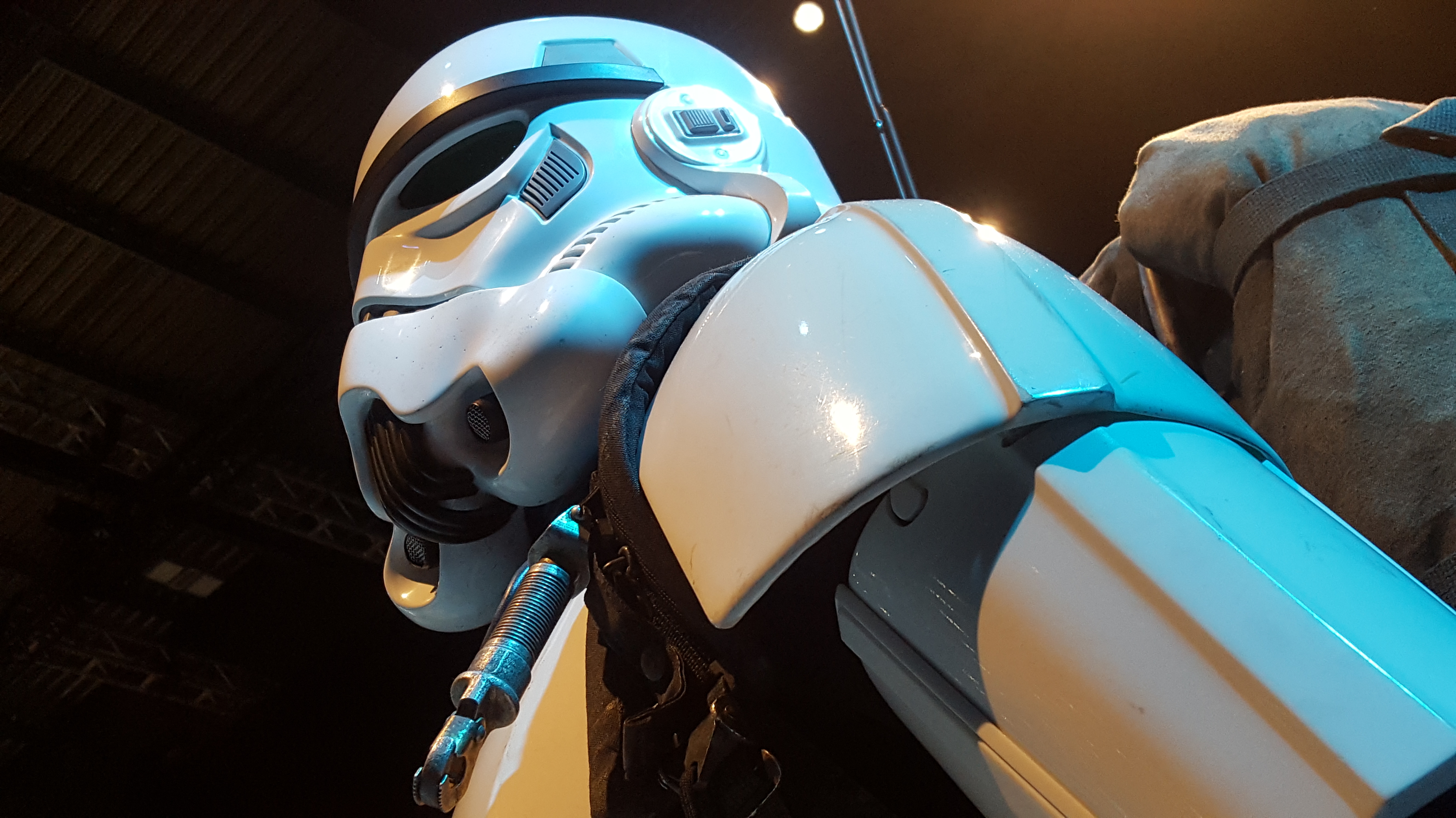

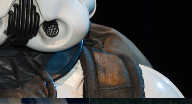

As a nod to the release of some awesome R1 posters and the latest trailer last week, the team thought that we should cut across the build thread and divulge what we have found out about the metal hook greeblie used on the left shoulder strap of the pack. Our observations will again relate to the CE prop. However we do know that this greeblie is present on all packs seen in trailers, the sizzle reel, and promo pics, along with the Hot Toy. It should be noted that certain insights have also been provided to the team by Andy Rodgers of DA Props and Face Book forum ‘The Shed of Glittering Delights’.
As stated, in keeping with the rest of the build thread, the observations presented here are based primarily on the back pack seen, and photographed, at Celebration Europe 2016 (CE). The various trailers and the sizzle reel indicate that the hook greeblie is present on all of the Jedha large back packs seen to date, although shots from these sources are not detailed enough to contribute to any detailed analyses of the greeblie itself.
Towards the end of August / beginning of September 2016, the hook greeblie was discussed / identified (as far as possible) on various forums including: ‘The Parts of Star Wars’ site ‘The Shed of Glittering Delights’ Facebook group, and on ‘FISD / whitearmor.net’. The hook greeblie is believed to be a quick release connector associated with RAF and RN 1940s onwards K-Type pilot dinghy pack. Three similar quick release units were used on each dinghy pack, to attach the pack storing the uninflated emergency single person life raft (dinghy) to the pilot / observer harness rig, or to ejection seats 1950s onwards.

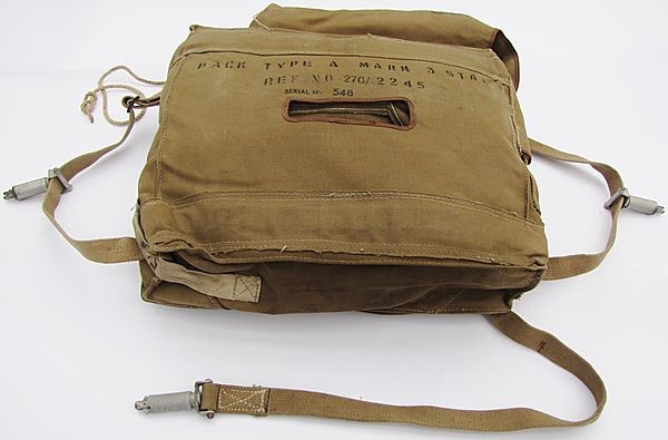

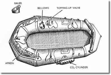

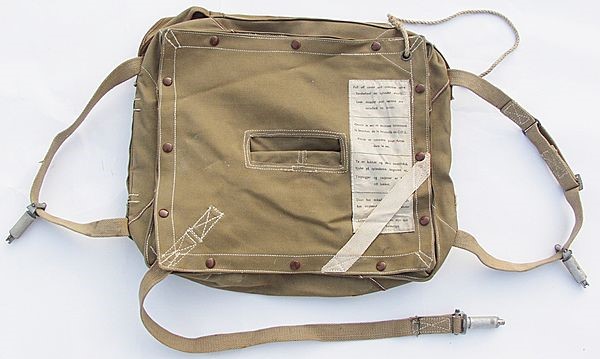

The K-Type dinghy was used in fighter aircraft or by observers in those RAF aircraft where the large multiple crew round dinghy was not practical.

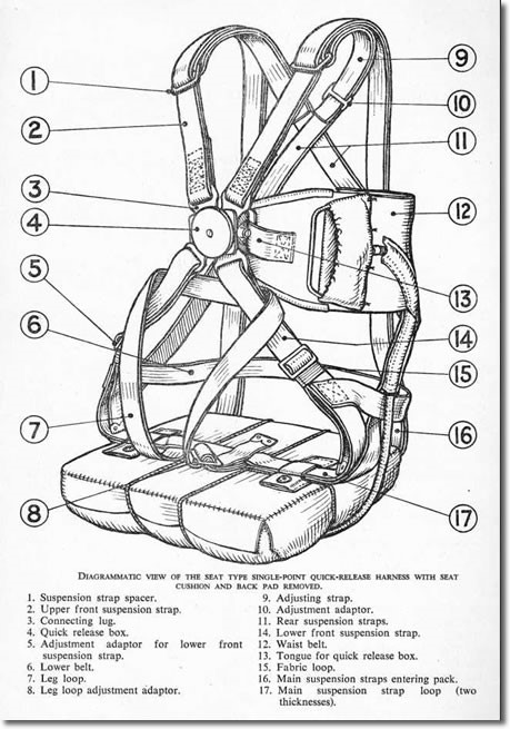

During the Second World War the K-Type dinghy pack was intended to be used by fighter pilots and observers wearing the seat type parachute, replacing the normal parachute seat cushion. They were thus referred to as the ‘seat pack’ as the pilot actually sat on the dinghy pack whilst in the aircraft.
The team believes that one of the quick release clips attached to the 1941 pattern life jacket, and a similar quick release (not associated with K-Type pack) was also associated with the parachute activation handle seen on the waist belt (near 12 in image above).
The Type A pack contained the dinghy and equipment with a readily detachable top panel connected to the dinghy by a painter, and to the pilot by a webbing strap. That webbing strap was attached via a quick release unit. Various types of K-Type dinghy pack are known with Type A, MK.II. used up to around 1942-44, and MK. III.s used 1944 onwards. The MK.III.s and Type Bs had additional features such as extra pockets for extra CO2 inflators and different arrangements of storage pockets etc.

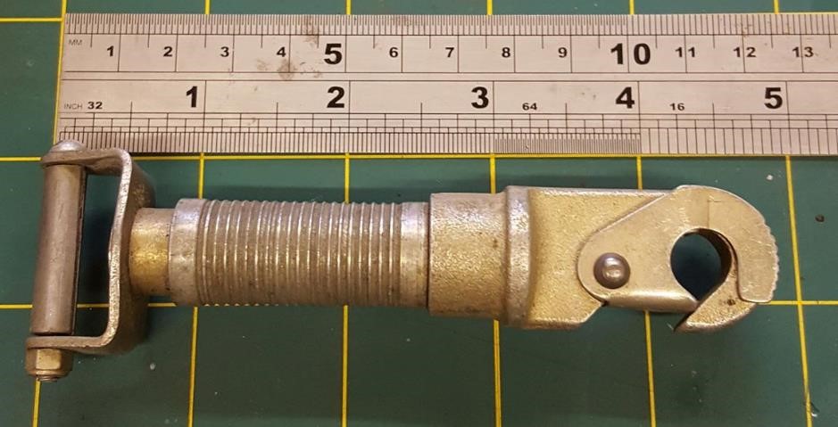

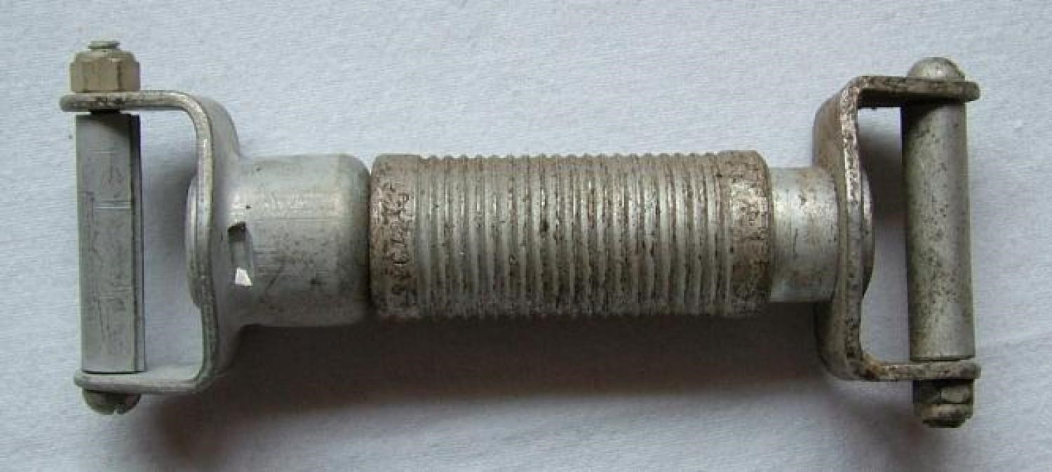

The quick release unit used for the K-Type dinghy pack consists of two components:
· A male component consisting of the quick release mechanism at one end and a T-bar for attaching to straps on the K-type dinghy pack; and
· A female T-bar component.
The quick release unit used for the CE hook greeblie also consists of two components:
· A male component consisting of the quick release mechanism and a T-bar for attaching to straps on the K type dinghy pack; and
· A female spring-loaded hook component.

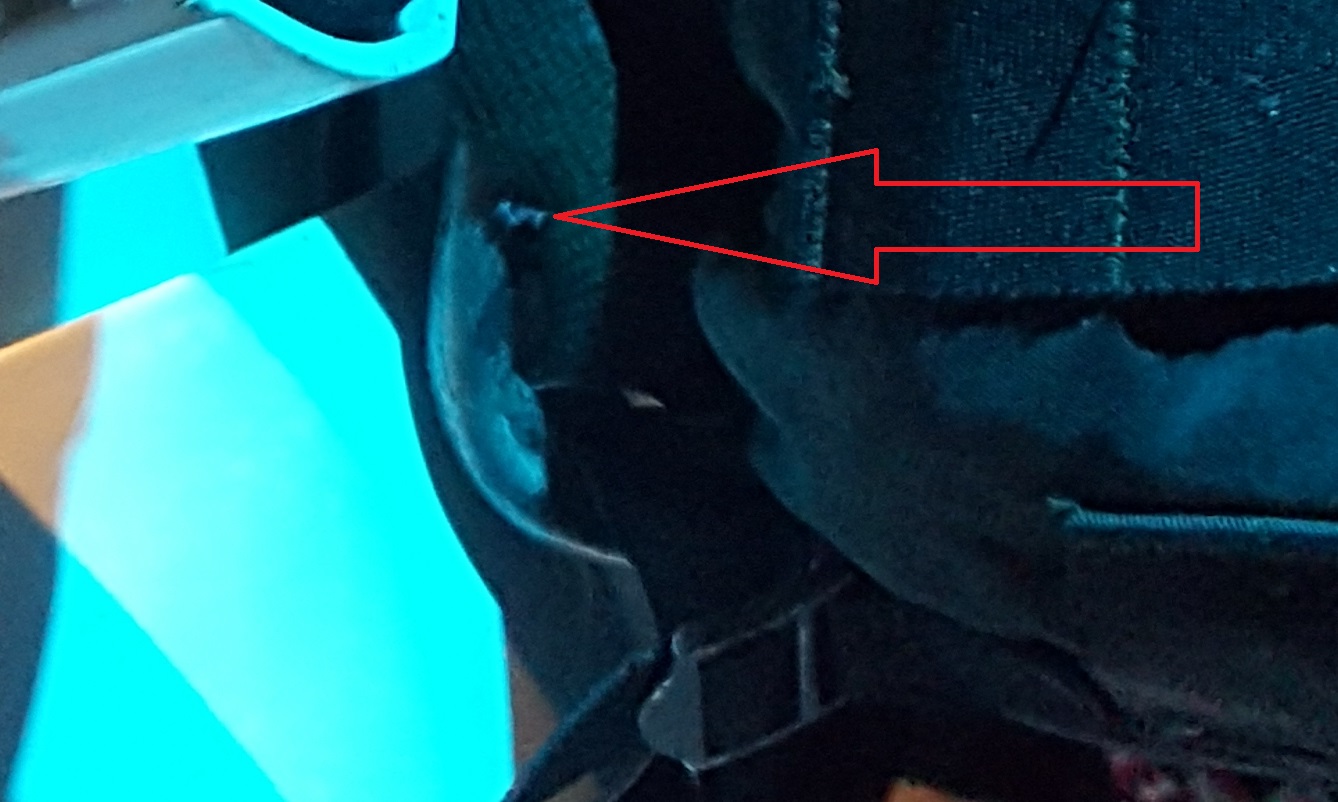

It is important to note that the team has NOT been able to locate ANY reference pictures showing the female hook component attached to K-Type dinghy packs or RAF / RN pilot / observer harnesses. However, the use of the ‘seat packs’ continued with RAF early jet aircraft (1950s), although the dinghy pack evolved into the Aircrew Personal Survival Pack (PSP) container over time which housed everything for pilot survival, including the dinghy in a Glass Reinforced Plastic (GRP) box, but still under-slung on the harness.
It is possible that the female hook component came into use once the PSP and GRP box became the standard, allowing a more efficient quick release system attaching to clips on the GRP box?

As stated, the quick release unit used for the greeblie consists of two components: male quick release unit + female hook component.

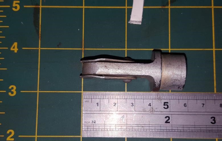

Male Quick Release Component
The male component of the quick release unit appears ubiquitous across many 1940s+ RAF and RN flight gear. It is known to have been used on the K-Type dinghy pack, along with 1941 pattern seat parachutes. The male component has no readily identifiable maker’s mark, but most samples do have either a Patent Number on them: Pat No. 478506, or the following ID No. 27C/2157. This is located around the top collar of the corrugated quick release pull mechanism near the T-bar end.
The team has so far been unable to further identify the male component, although it does appear a ubiquitous 1940s-1960s RAF / RN quick release mechanism.

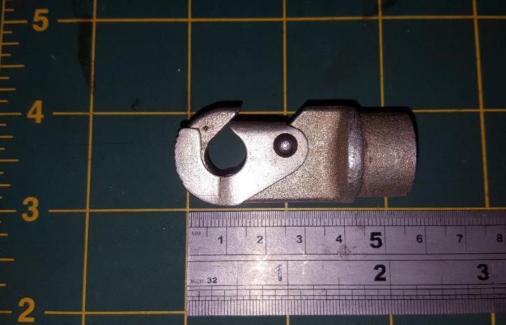

Female Hook Component

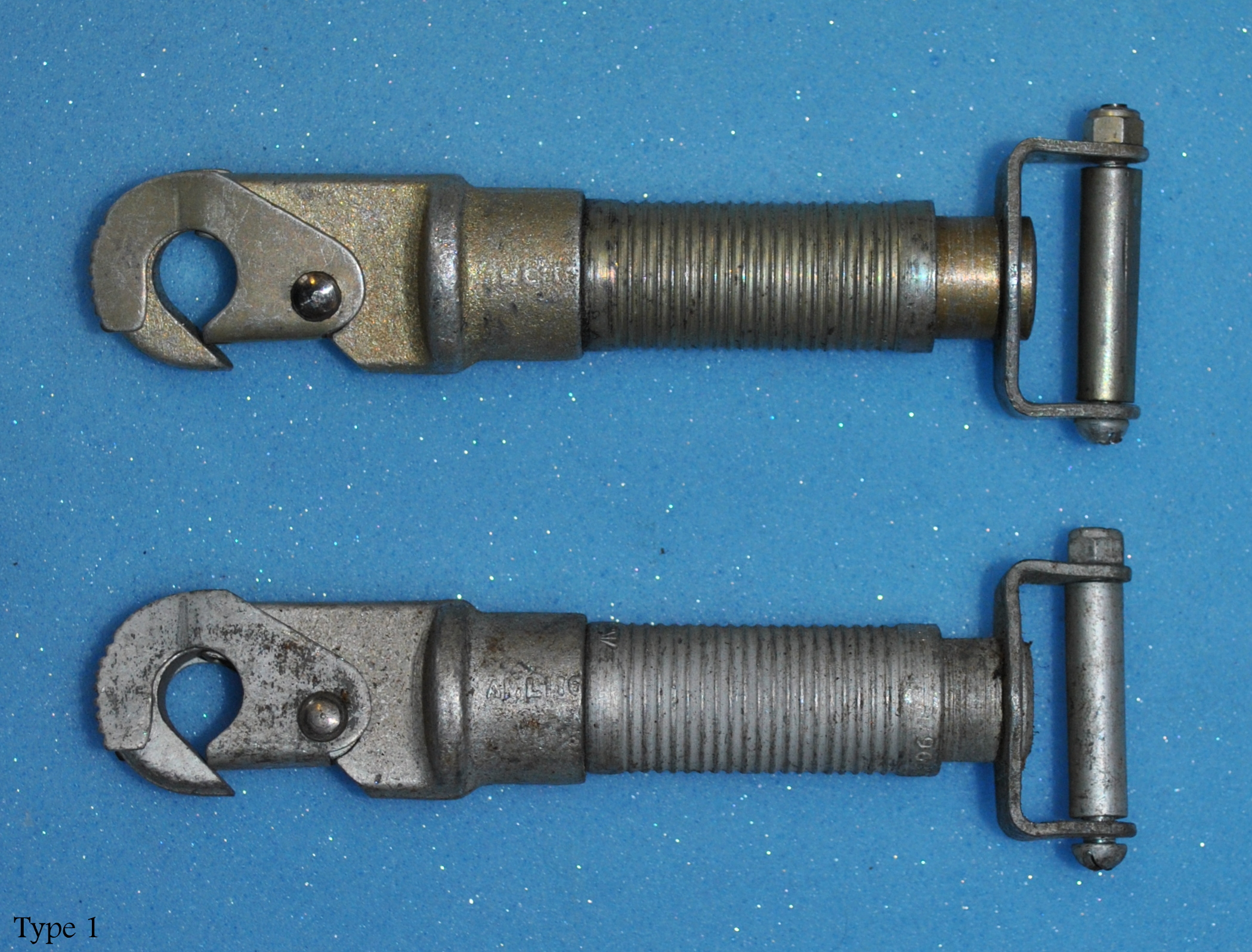

The female hook component does have a maker’s mark and part number: AML 115. Research by lonepigeon and mr paul indicates that AML refers to the maker: Aircraft Materials Limited. AML is now part of Airborne Systems, which still makes very similar equipment, although no longer produces the actual female hook component used for the greeblie (as far as we can ascertain, and certainly not in the 1940s-50s form).
Review of the team’s collective sample of quick release units has revealed both subtle, and more distinctive, variations between various female hooks.
Most notably, some male quick release and female hook components appear to be cast in a silver finish metal whilst others are cast in a metal with a ‘gold’ finish.

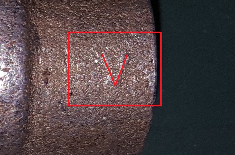

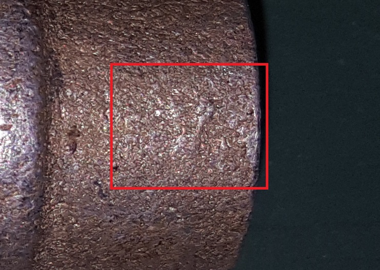

The female hook is cast metal with the maker’s mark consisting of a cast alphanumeric on one side of the hook stem – AML115. In general the ‘5’ is exceedingly indistinct, although some samples do show this character, most often the silver metal versions which appear to retain a sharper moulding than the ‘gold’ hooks.
On the reverse side of the stem a V can discerned.

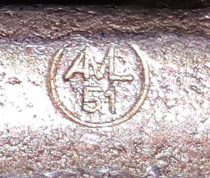

However, some hooks also have the maker’s mark and part number stamped onto the outside neck of the hook. The stamp is AML115, so it appears that these hooks just have a more clear presentation of the information we already know concerning the maker – AML – and the part number – 115.
Following the mark AML115 on the neck there is also a stamp mark. This is a circle containing a stylised AML over the numeric 51. The team has not been able to identify the significance of the numeric 51, however this could be a year stamp e.g. 1951, with those hooks not displaying this feature being manufactured prior to 1951? However, this is conjecture, we do not presently know, and this is one of the questions being asked at the Imperial War Museum.
From the photographic material available of the CE prop greeblie it is impossible to determine if the maker’s stamp and part number are present on the neck of the one used on the CE pack.
There is another, slightly different female hook available. This has the same version of toothed hook jaw and spring mechanism as the previous types described. However the main hook stem and body has some noticeable variations. These are:
1. Appears cast in a different metal type, it is less ‘granular’ with an almost machined finish;
2. The ‘step ’between the stem (which attaches to the male quick release component) and the ‘hook’ is much less rounded, more angular then on the other hooks;
3. AML 115 is very clearly and cleanly stamped onto the face of the hook;
4. There is a maker’s mark stamped above the AML 115 mark; and
5. There are two parallel lines running around the stem of the hook.
Whilst prominent, it is difficult to discern what the circular stamp mark actually contains, although the numeric 1 is clearly visible at centre bottom. The first and last letter may be L. The team is unsure about the second and third characters. This will require some more analysis. Pic to be posted later.
