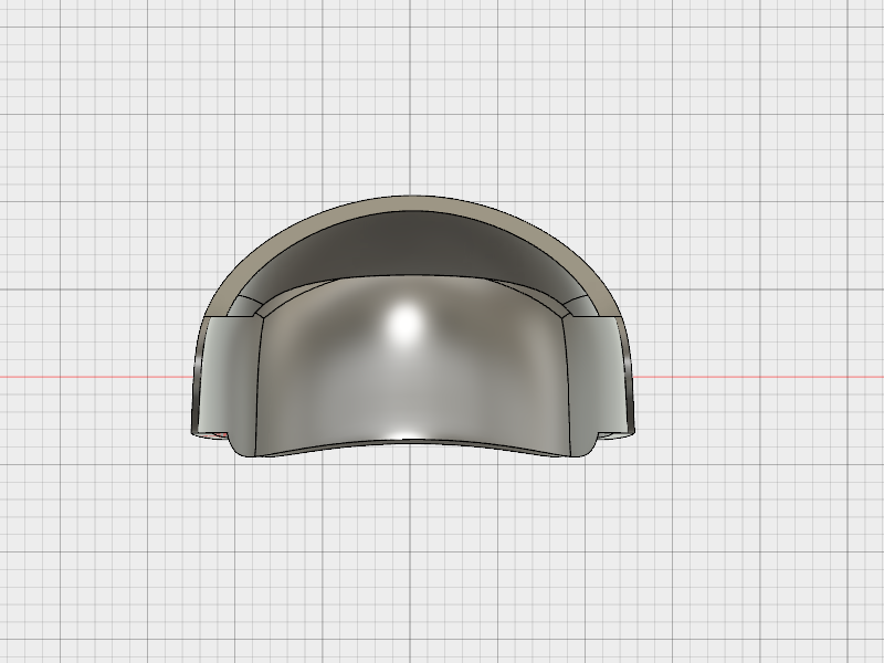

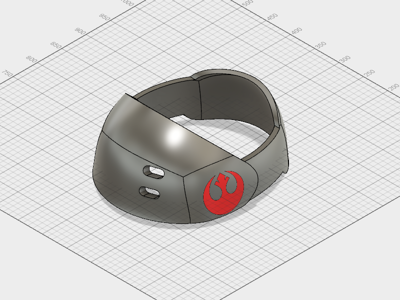

    Nov 9, 2016, 1:48 PM - Re: Rogue One Rebel Soldier Helmet #262

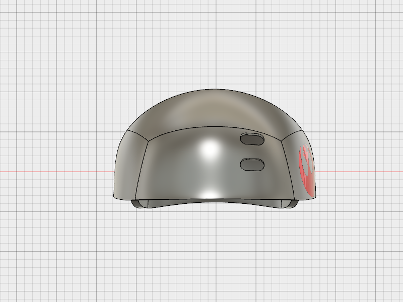

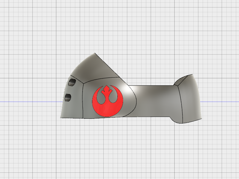

    @halliwax I can work on it. It might just be faster to blow up a ballon squash it into the helmet and cast arond that then you have your lip and stuff. Im my head with out going crazy on detail I would put the armor on a clay base ballon inside and put your joint in(for 2part mould) paint with silicon, how ever many coats then coat in fiberglass/plastic and bingo.
    Im really extending my skill with this helmet, Although the pics look fairly accurate I dont want to risk spending all this time and other peoples money to have something that is crap. I have not done anything like this before, my new plan is to;
    download 123catch (take a bunch of pics of a RL object and the software turns it into a 3d object), So take a bunch of pics of my M1 helmet then use the 3d helmet.
    Go to fusion 360 and make a 10mm thick outer with maybe 5mm clearance and cut it to shape. (still wanting better pics of the back of the helmet)
    @elr02k Whats your print bed size? I can just cut it to fit, seperating it into quarters or more if needed. Mine is about 125mm. Duno about the filament used? I use pla has minimal shrinkage and is fairly easy to get a good finish. You might want to grab some Resin filler like XTC 3d or the like.

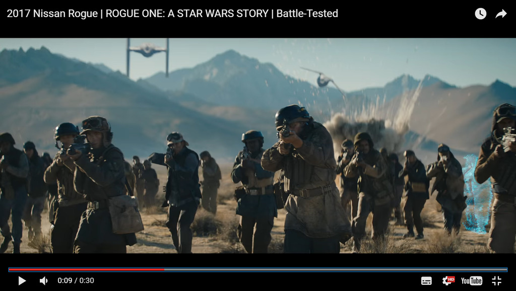

    New trailer, new shots of the helmet! Finally a clear look at the details on the back...should be helpful:

    Legend @Thain
    I know what I will be doing this weekend, you can just make out the back of the helmet
    Looking back I dont think its quite as rounded at the back. more filleted angles. I will just do a mirror for the other side, Hey Im at work at the mo are there any more angles of the holes on the otherside?

    Another little photo drop from one of the TV spots
