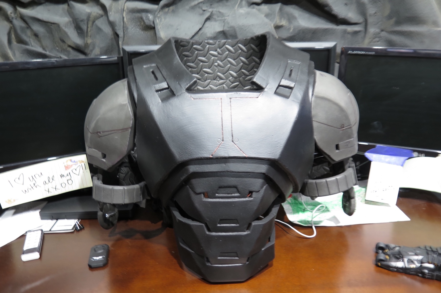

The next step was to start putting together the torso, working on the pecs, shoulders, and back. It was coming together nicely, although it did take some time! Each piece seemed to need some kind of curve added to it which meant firing up the heat gun. There’s a learning … curve … there for sure! But it was really coming together.
The abs cutting and assembly took me about four hours – those were a bit difficult!
I then attached the abs to the rest of the torso, and sanded down the seams. I then added some Kwik Seal to fill in the seams, and let it dry. The easiest way to seal the armor, from what I found, was to use Mod Podge. Apparently just applying it with a foam brush is the best way to go, and that’s what I did.
Unfortunately for me, I decided that I had kind of tapered the space between the pecs and the abs instead of just letting it drop off. So, I cut the torso apart and did it again! It took some sanding and re-Mod-Podging, but it came back together well and looked better in my mind.
I would add a tip about how to get rid of brush lines when using Mod Podge, but I actually have no idea! After applying mine, I found all kinds of brush lines on my beautimous armor, and sanding with my newly-created sanding sticks wasn’t making it go away! Oh well, time to PlastiDip.
Wow! Looking great! BUT … oh crap. I forgot to add those detail lines on the pecs! I’m not really sure how I’m going to add those, especially since it would have actually looked good to do before the foam had any Mod Podge on it. Argh. I guess this is a tip …
Tip: Remember to add detail to the foam before sealing / painting it!

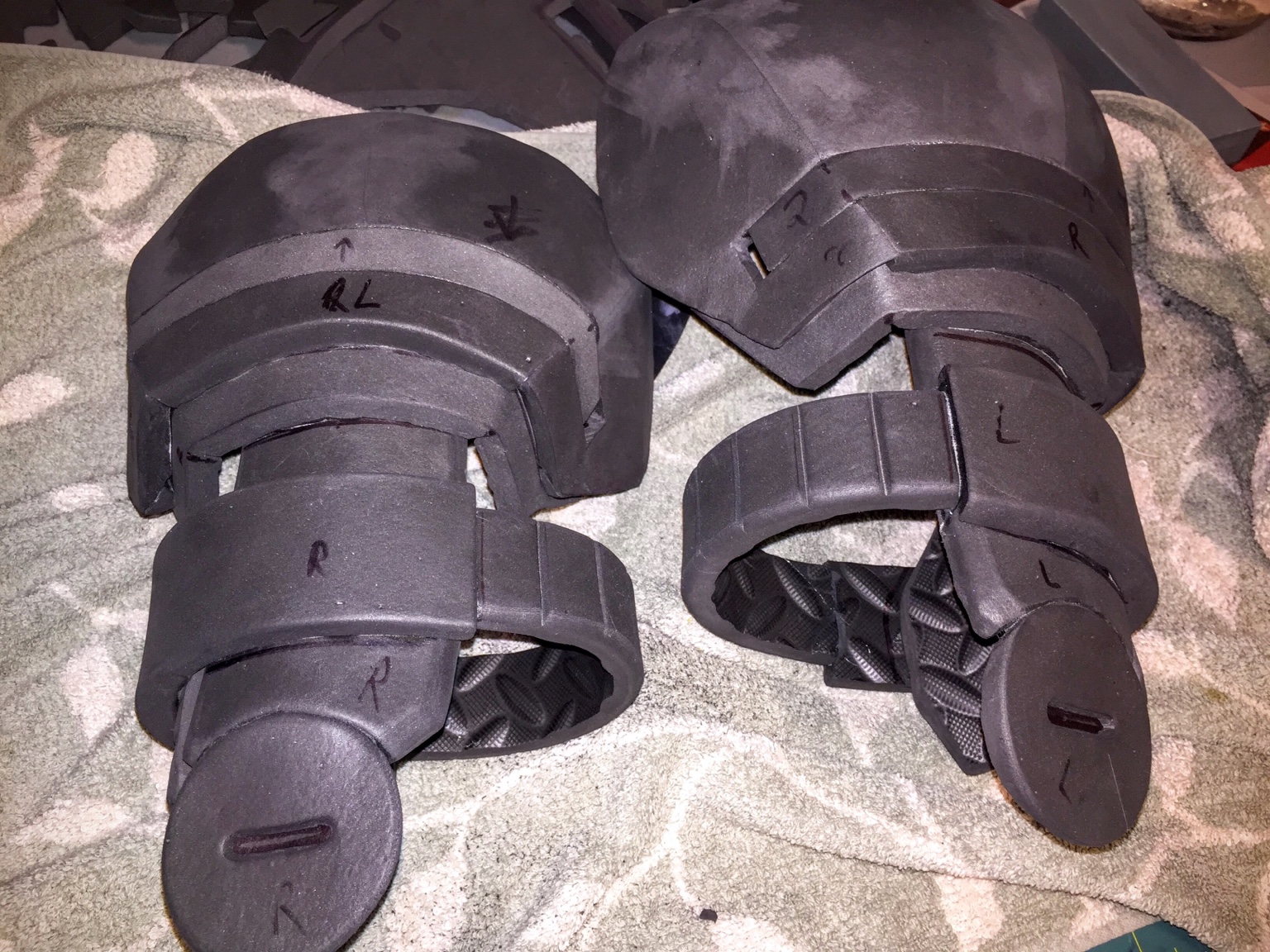

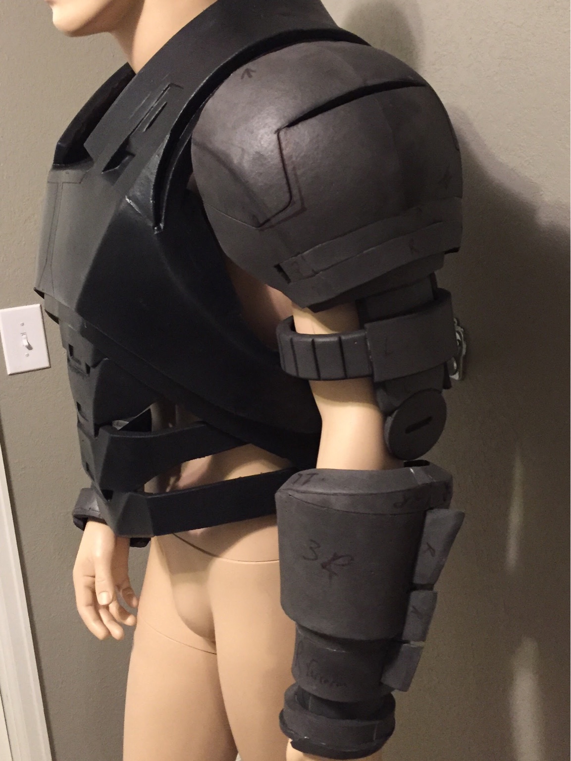

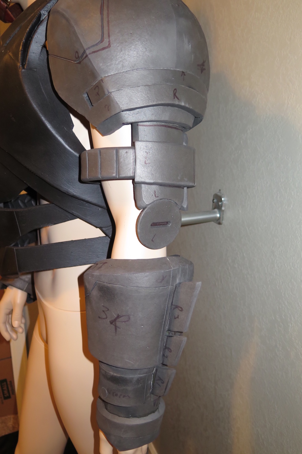

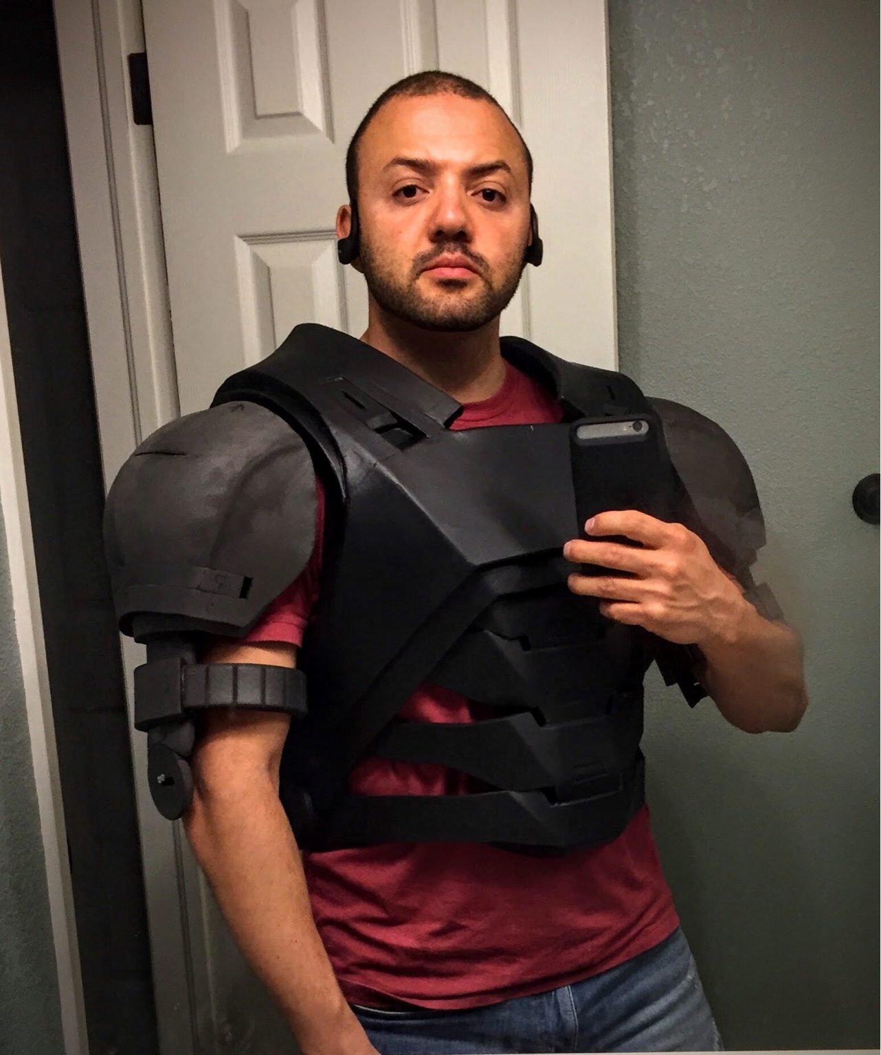

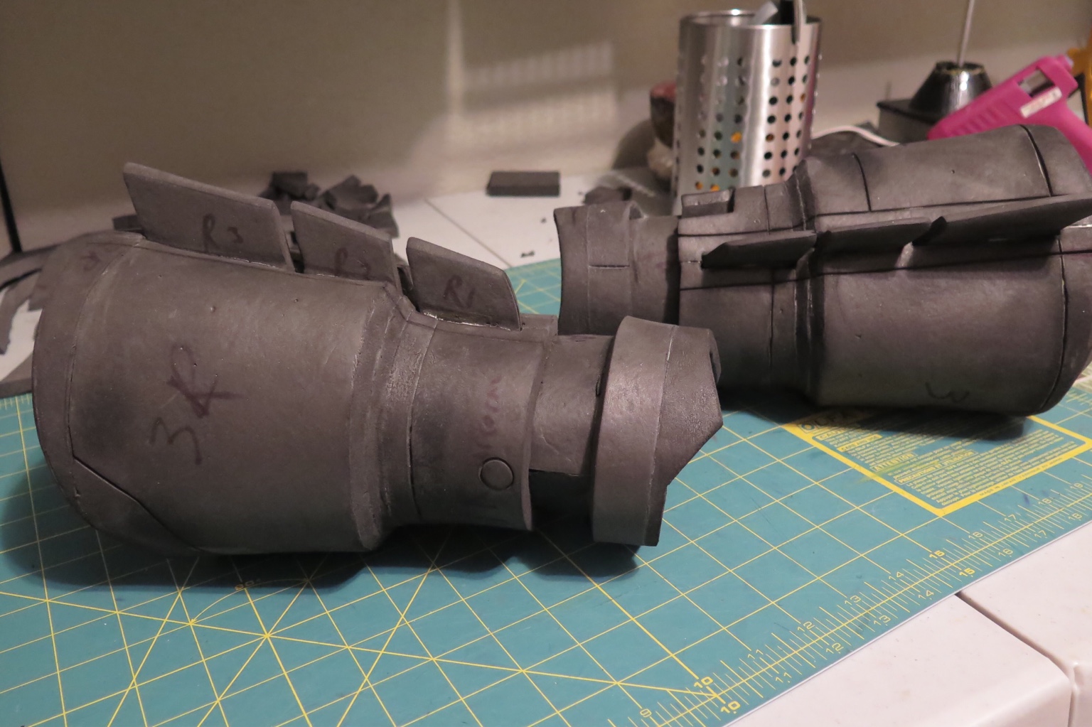

Sooo I've got a quite bit more done on this. Finished up the shoulders and the forearms - but I'm not going to coat them just yet. Screwed up by coating the torso too early! Anyway, I made a video if anyone wants to check it out:
https://youtu.be/cEdSZFaR_Xc
And here are just some pics:
