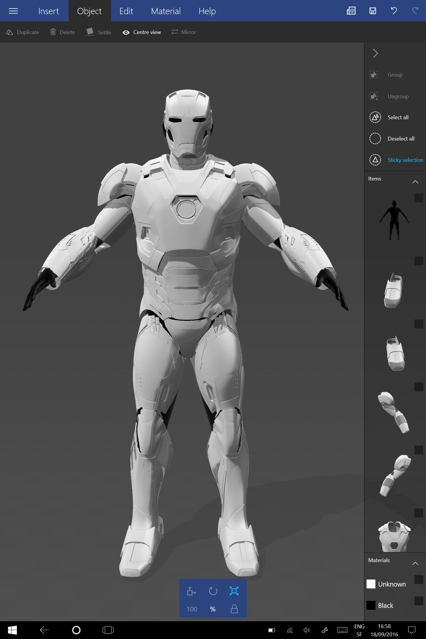

Firstly I use a software called makeHuman to create a model of my body then saved it as an obj. Then I used netfabb to repair the model. Next I repaired the Iron Man MK46 stl files using 3D Builder then I imported the makehuman body and the Iron Man MK46 files into Meshmixer and scaled the parts(except for the legs Ill do them at a later stage) to fit me as uniformly as possible:

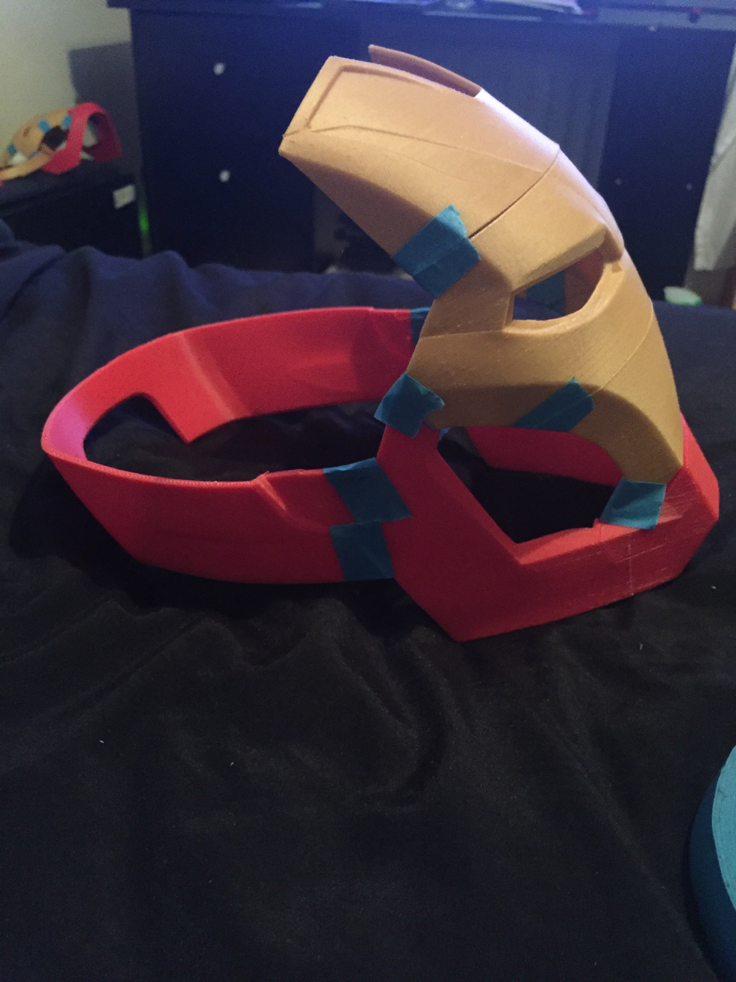

So far I am working on the helmet and this is my second time printing it as when I was printing it at first I had a feeling that it was small but I kept printing then it was clear that it was small so I scaled it bigger and started printing it again.
Here are the pics of the prints so far nothing is glued together yet but it will be chemically welded using ABS slurry.
New jaw vs old jaw.

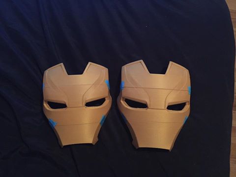

The old faceplate vs the new faceplate.

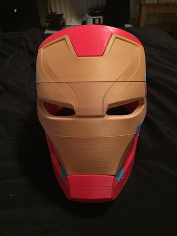

The top part of the faceplate is slightly warped but I think thats an easy fix.

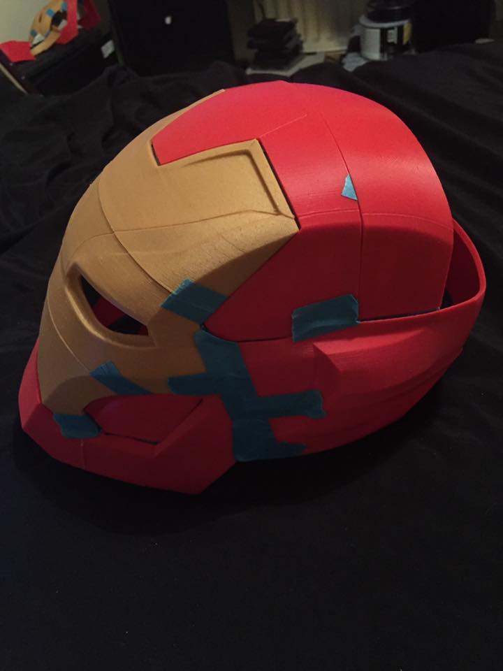

Cheeks added.

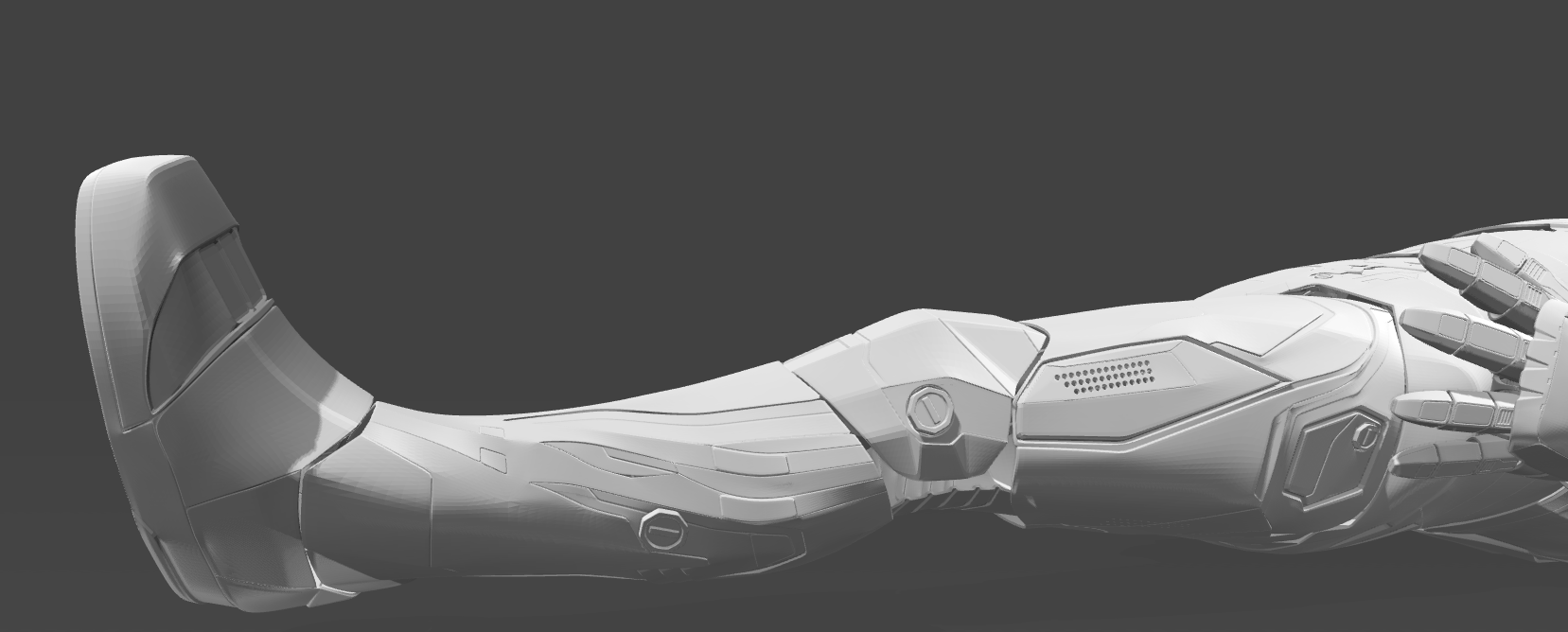

Max's files are great. Very smooth models. And I find his fit to be more "wearer aware" than Do3d's more screen-accurate but ultimately idealised proportions.
Max's models are also definitely great value for money at around 1/4 the price of Do3d.
I'm currently building a mashup of the Do3d and Maxcraft Mk45 suit:
That looks really cool I find that MZX files are a bit more accurate than DO3D for example the silver stripe on the shins on DO3D it goes across the full front of the shin where MZX only goes half way and from looking at the MK46 hot toys and taking close looks at the suit in the movie by pausing it :p it seems to me that MZX is more accurate in that aspect.
