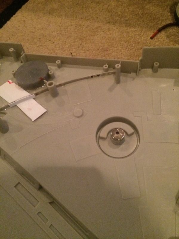

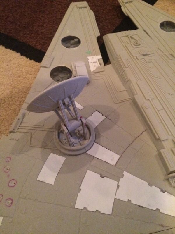

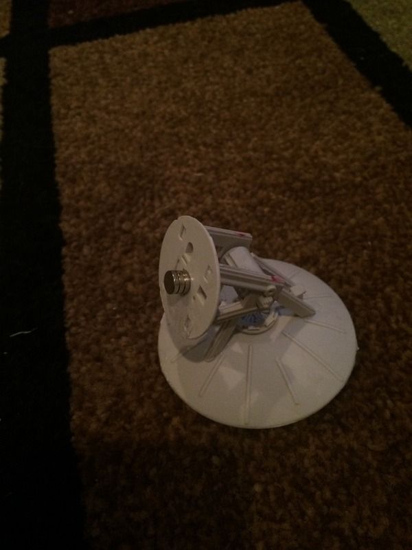

Small update on a 5 min job from last night. Just some earth magnets for a rotating radar dish ( mainly to give it a breakaway function in case it gets bumped.

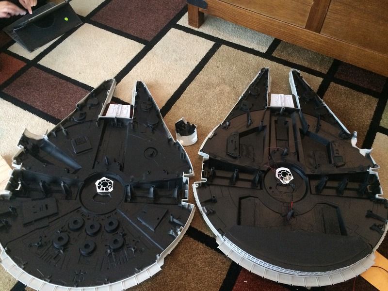

Good idea on those magnets! RE: light blocking in the 'engine', try lining the LED box with self adhesive aluminum foil tape (used for sealing HVAC ducts - but it isn't 'duck' tape, but an actual foil.) The shine will help with reflecting light out the opening to some degree as well... especially if you make a reflector shape for the LEDs.

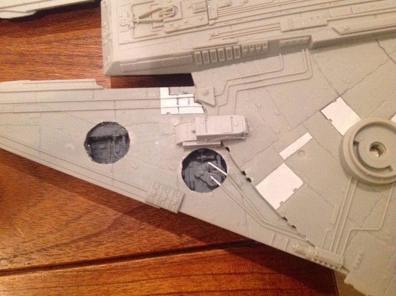

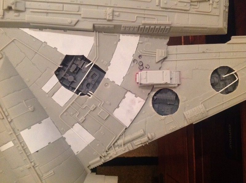

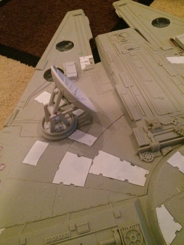

I wasn't happy w my landing bays so I got some off sir Charles and installed them tonight. I think they are so much better. Thanks Charles.
I also brought out the wire for my LED's. I will likely install the switch and store the battery on the panavise itself.
Also i so I think I understand the cockpit install now. Just need to do some trimming to get it to fit. After that I will start the paint process.

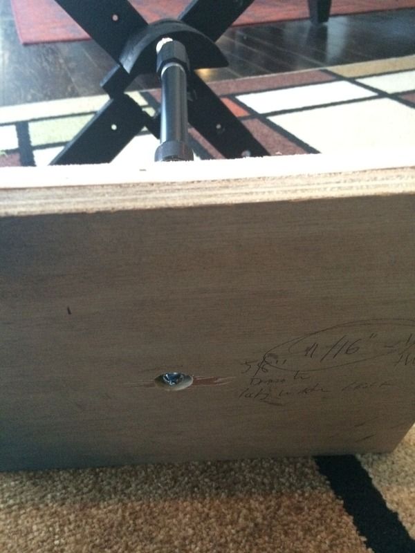

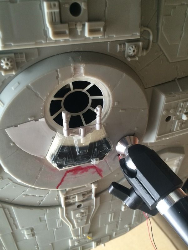

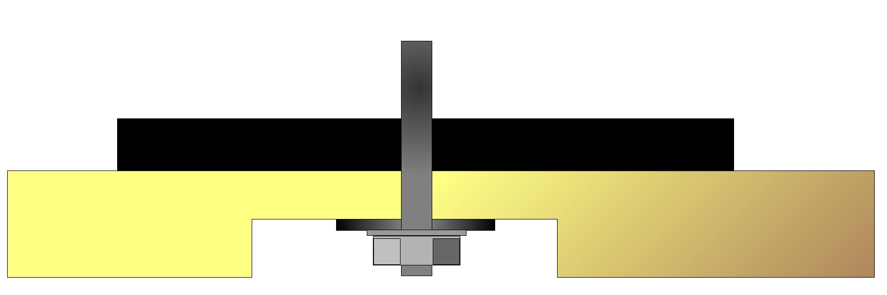

TND, here is an idea for a base using a wood underlayment to the acrylic, to support the lag bolt (or some such) that mounts the Panavise adapter:
Cutting the recess for the bolt head is the trick but you can use a chisel to do that. Just needs to big enough to allow for a wrench socket. Use a lock washer as well as a plate washer to ensure it stays tight and is well supported. Since the acrylic isn't really carrying an load (it basically acts as a big washer), all it should need is a good glue (like Gorilla Glue) to attach it. I'd drill first and use the bolt to align it over the hole in the wood base.
FWIW! Regards, Robert
(for what its worth)
FWIW! ? whats that?
i like the idea of the wood underlay, but maybe I'll make it ever so slightly smaller than the acrylic, so the acrylic overhangs a little. It seems that special drill bit is needed for the acrylic but otherwise shouldnt be an issue to drill.
thanks
[url]http://img.photobucket.com/albums/v634/theyrenotdolls/Falcon/09EACAB4-03A2-4374-B70F-9AA9F9619754.jpg[/URL]
Thanks man! Glad they worked out!

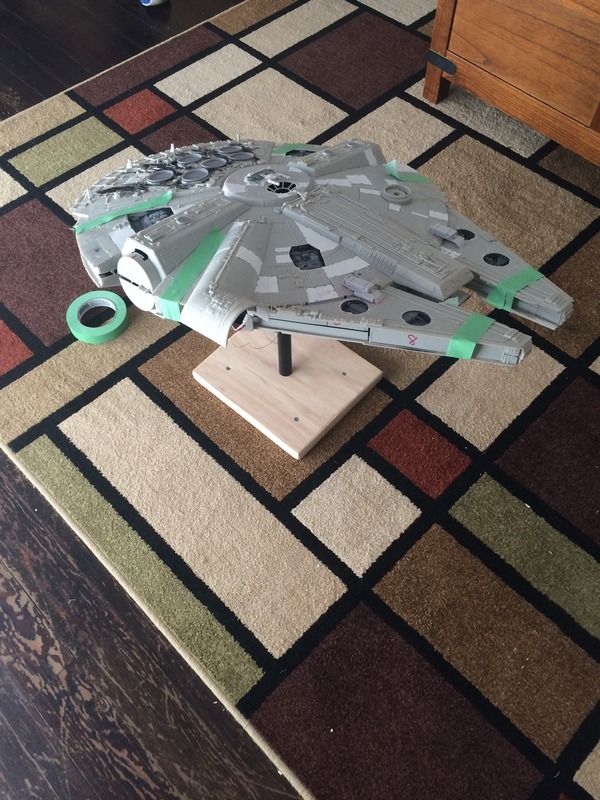

Have you looked at how I mounted my panavise? I just put it in a wood base and then eventually I plan to make a cover for the wood to look like the death star.
Sent from my SM-N915V using Tapatalk
charles, i saw your mount, is that a 2x12 piece of wood you used? i have some 1/2" thick plywood here already I'm hoping I can use that as a base, even if I have to glue a couple pieces together to get the proper support/weight/thickness.

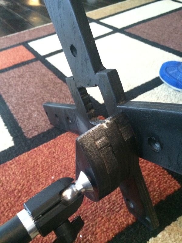

My mount is designed in 3D to perfectly fit the Hasbro Falcon and then 3D printed.

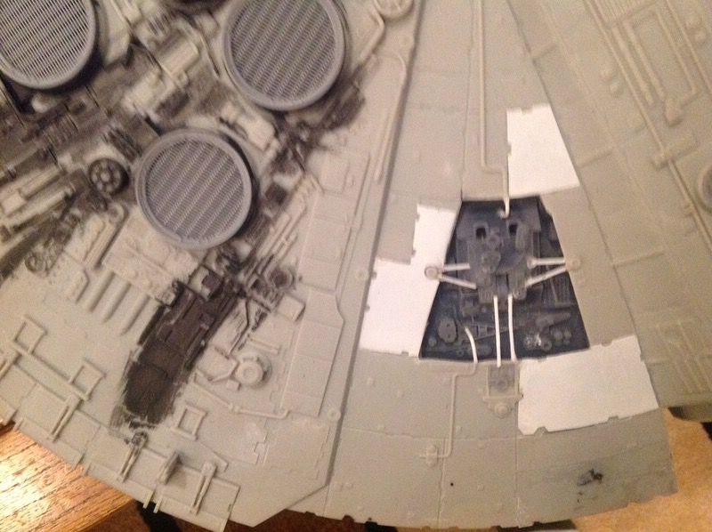

Sprayed the inside w plastidip which adhered really well. It also has a really great texture.

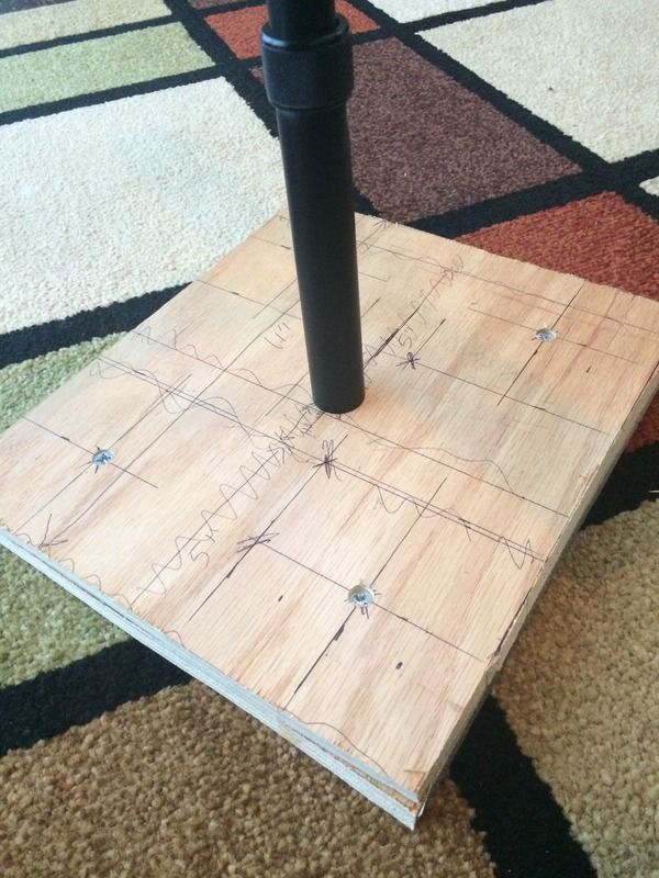

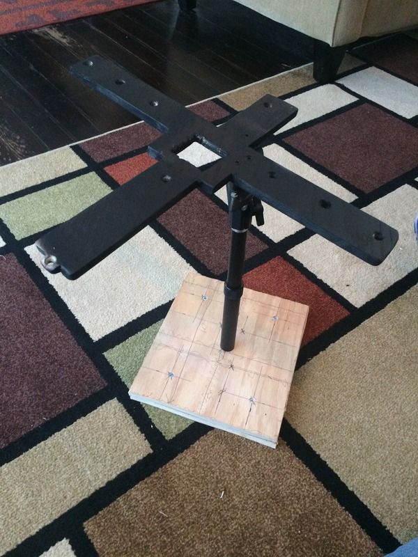

also I constructed the base and installed the panavise. I think I'm gonna nix the black acrylic idea. I want something more creative for this project. And whatever that is, I'll just put directly on the board.
Need to work it a bit to perfect the fit,install the piping on top and then paint process.
Hope u enjoy.
