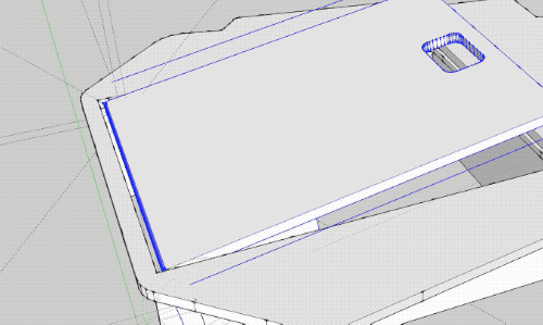

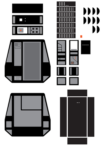

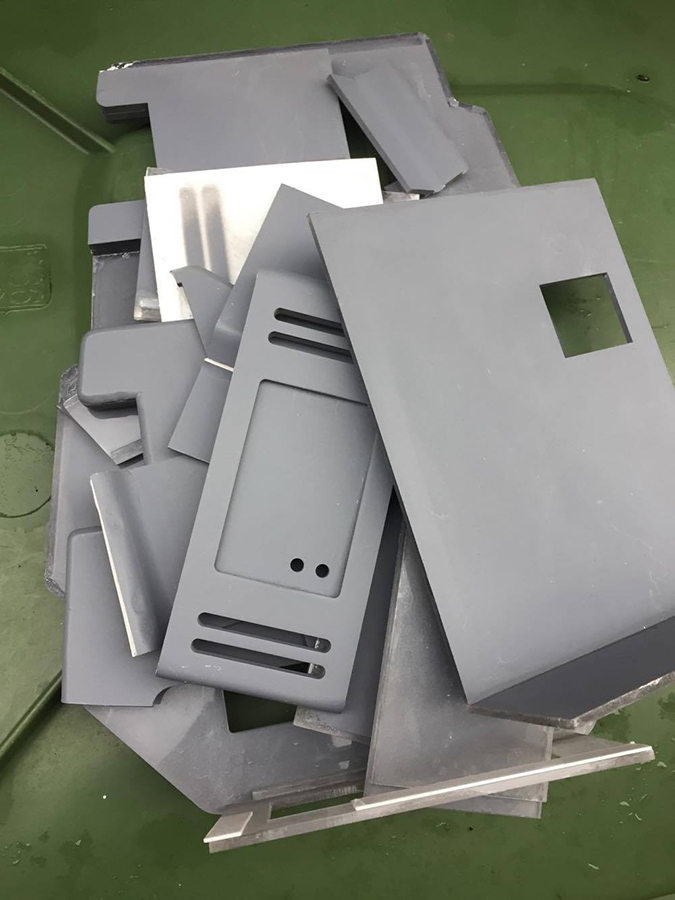

So... updates.
Some disassembly was attempted - and ended up disassembling the unit to a permanent end. Lots of cracked panels due to the strong parts being weak and the weak parts being strong. Annoying, but, there were some flaws with it that were bugging me, so, I was sort of (just sort of) pleased to start again.
Then I left DW, did two other shows with no workspaces in my office, and moved house, so all personal projects have been on hold until now.
Firstly, I redrew some of the key parts, and then rebuilt the sketchup model from that, just to be sure the door fit/cleared properly (trying to modify the door holes on V1 is what led me down this path of shattered dreams/perspex).
So we'll see. The best laid plans of mice and idiots...
I've also included some reinforcement triangles in the new drawings both to brace the sidewalls but also keep them square on the edges, which was another one of the issues on V1 - a slight bit of play in one of the top parts meant the front/rear plates were a few mm askew of each other.

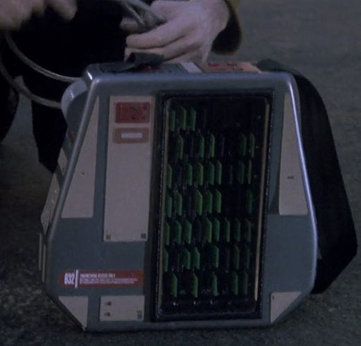

While I was there, because I am a glutton for punishment, I drew up the TNG engineering/isolinear kit as well. I've never liked the colour scheme of this thing and the temptation is to do it more in line with the medkit colours, but I'll probably go with the beige panelling.
Both are being cut next week, so, hopefully some progress again soon.

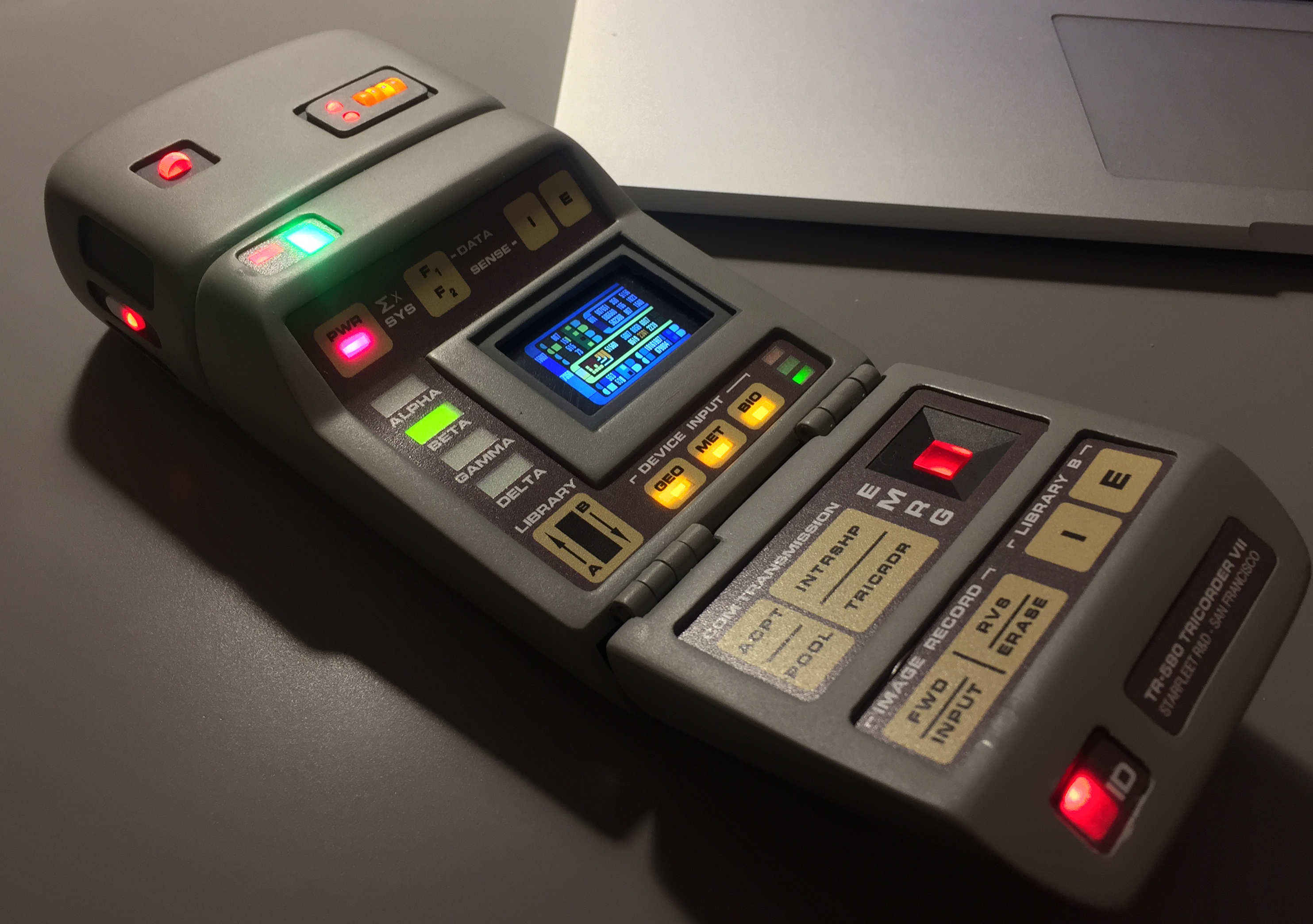

Finally got the Mk VII done:
The graphics are printed onto plastic membrane sheet - this means they function as a real membrane switch on the hidden sound button. Because they're clear there's no cutouts needed for the lights, so it's one seamless plane for the graphics + lights. The texture on them also acts as a diffusion:
Beautiful! The Mark VII medical tricorder is one of my favorite props, and you did a great job with it!
Sean
Thanks, Sean! I think there's something about the design of them that's really great, the proportions are superb, and Sternbach was always really good with his panel/detail designing - never busy but always interesting. I also really prefer how they have a 'real' screen - inset with the slide transparency. The sticker with some LEDs on the later versions was never as convincing to me. I don't think Sternbach had input on the Mk X did he? I've never seen him mention it.

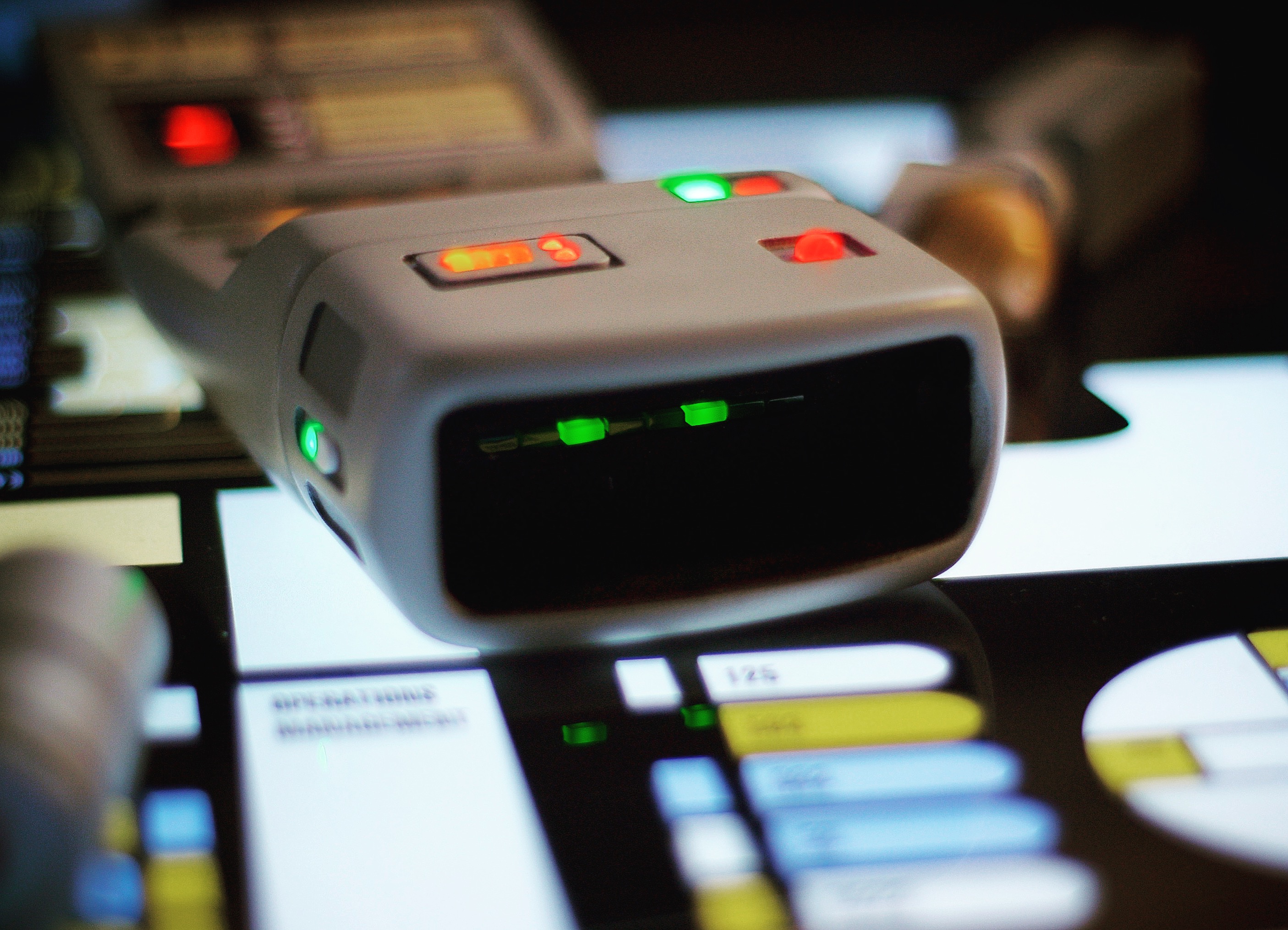

Took some beauty shots of it today, along with Stapleton's hypo:
I completely agree about the Mark X screen. It looked really fake. These backlit slides looked like a color LCD screen, they were very convincing. The tricorder came out brilliantly!

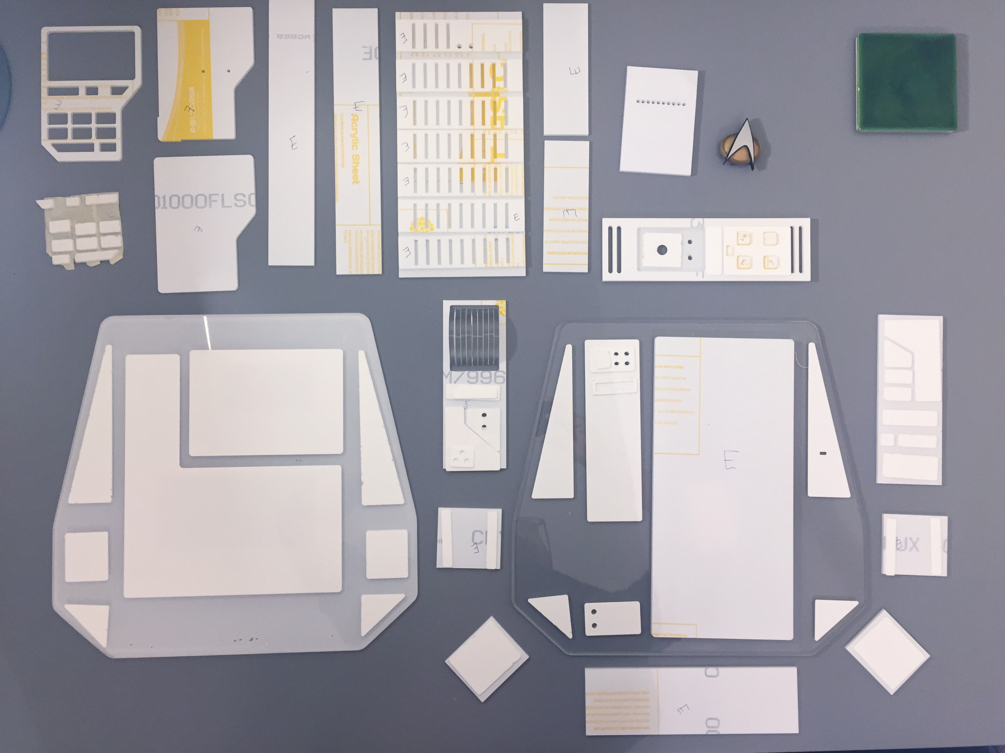

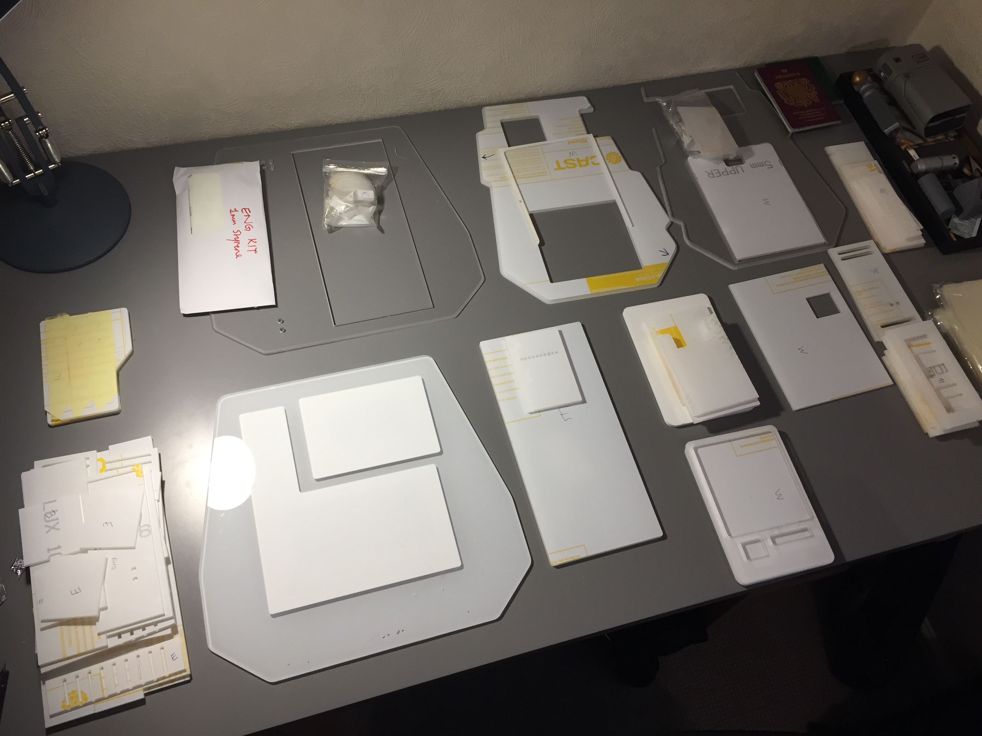

Laser cut parts arrived!
The Engineering kit / Iso case has SO MANY PLANT ONS.
Unfortunately there's an issue with some of the 3mm parts (cut file scaled too small somehow), so I couldn't get on with this this weekend. V2 of the Medkit, went together quickly. Lessons learned from last time!
Still the filling and sanding part to go after this - my least favourite - but looking forward to getting paint + graphics on it.
