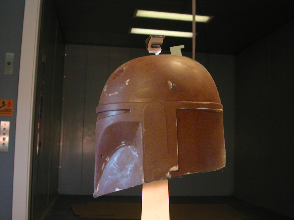

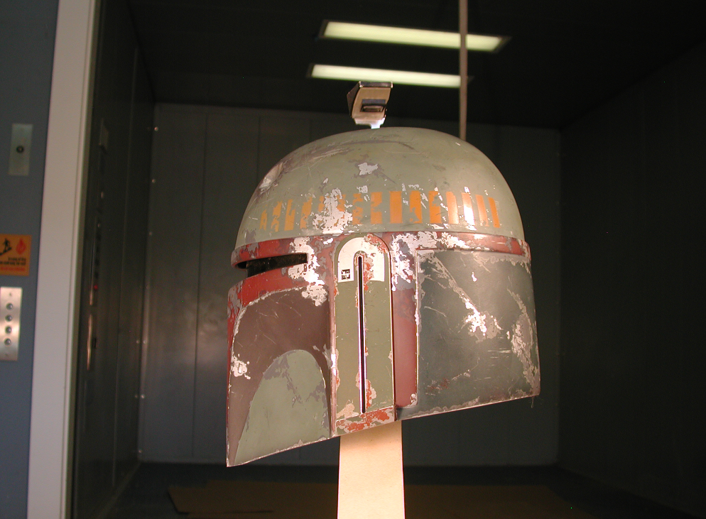

And this stage was only a few weeks ago: (Screen used helmet on the left, mine on the right)
So at this point I've already got my molding and casting materials from Smooth-on, so once I get the helmet finished to my satisfaction I'll move on to that stage. Advice and constructive criticism of any sort is greatly appreciated!

Finally found similar enough shots of an actual helmet and mine to make a decent comparison. PP3, then mine. Its getting so close...I completely blame the similarity of my helmet to the actual thing on RafalFett's great templates and measurements, which my helmet is completely based on. Many thanks Raf!

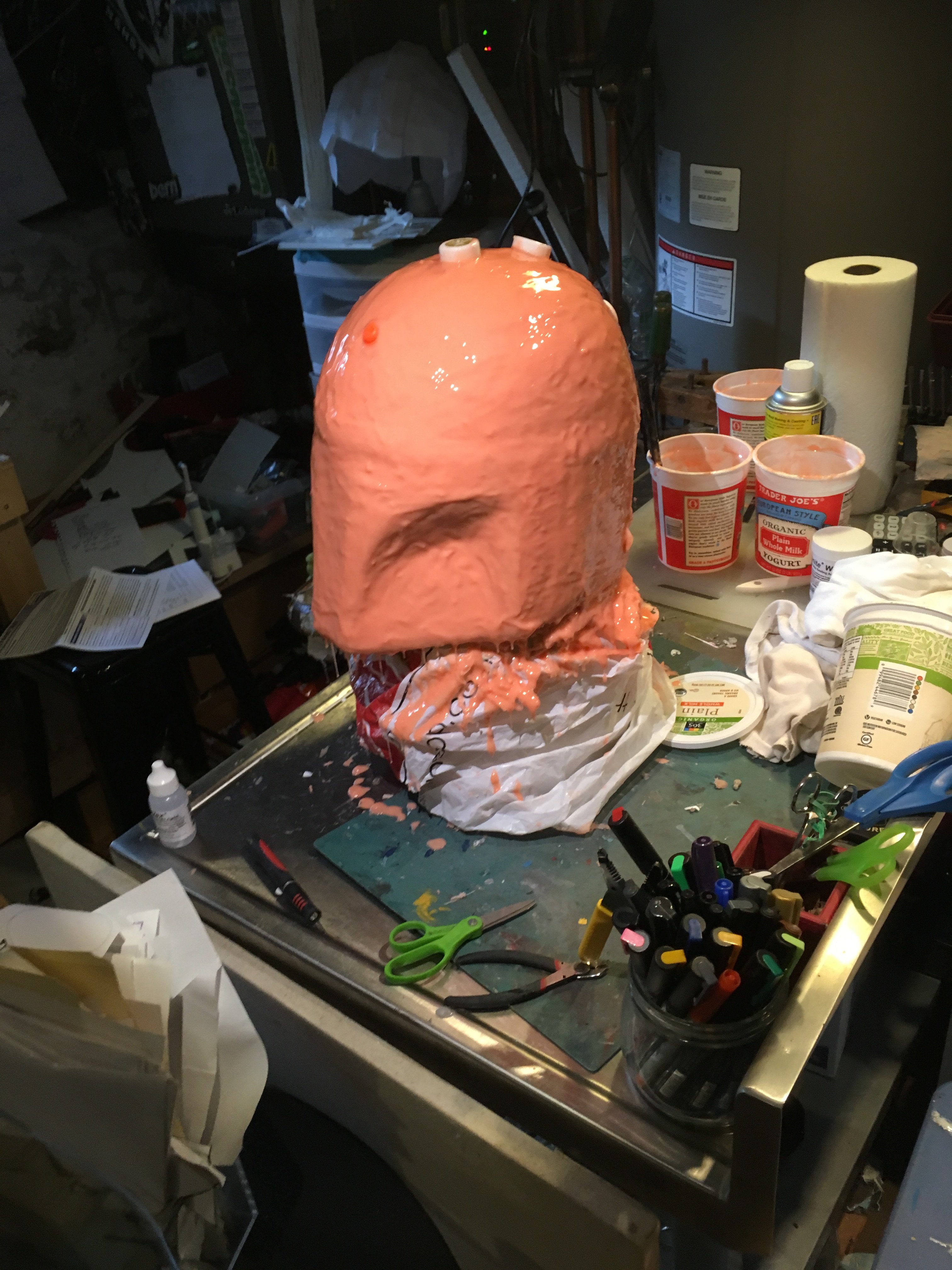

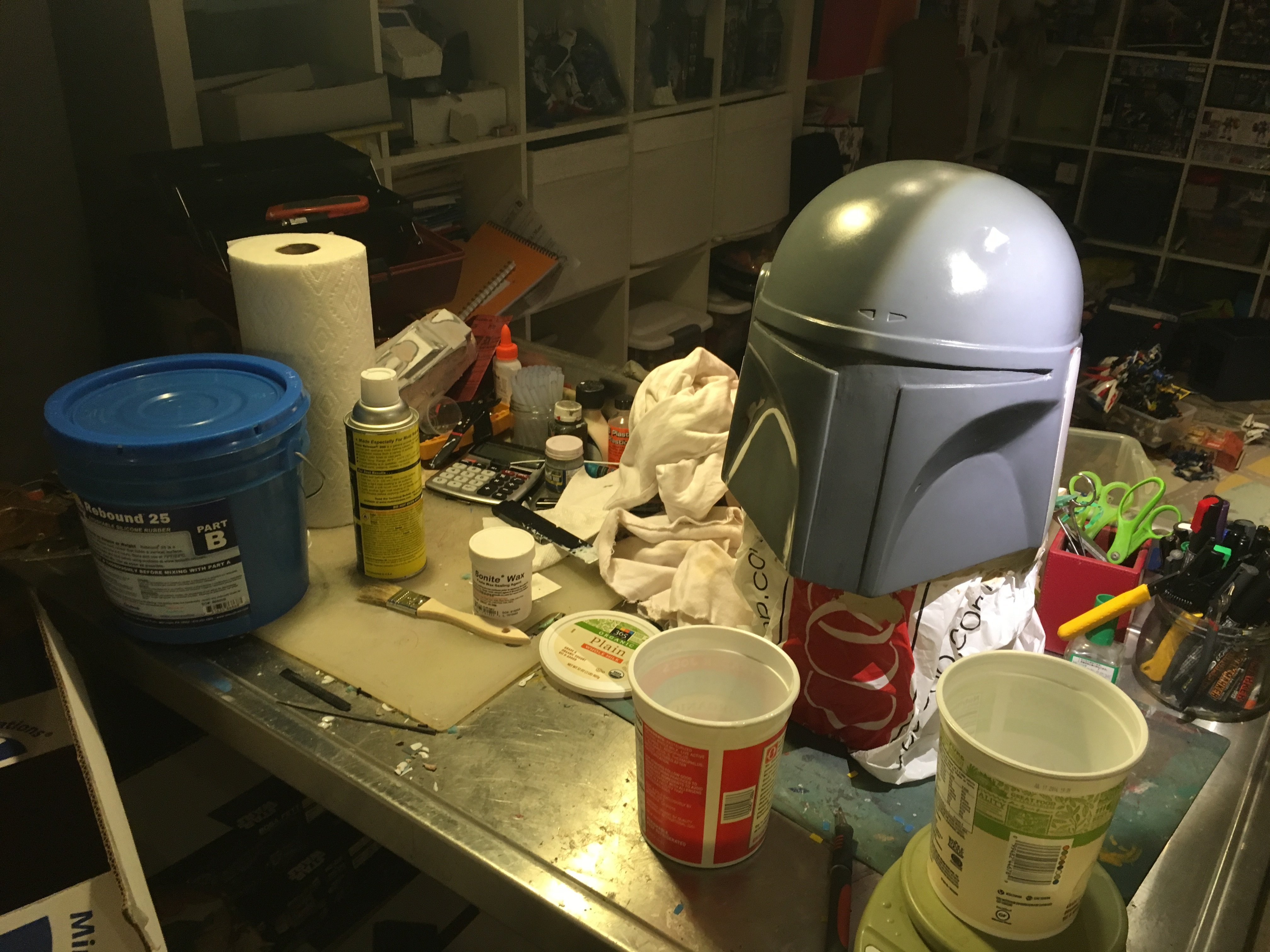

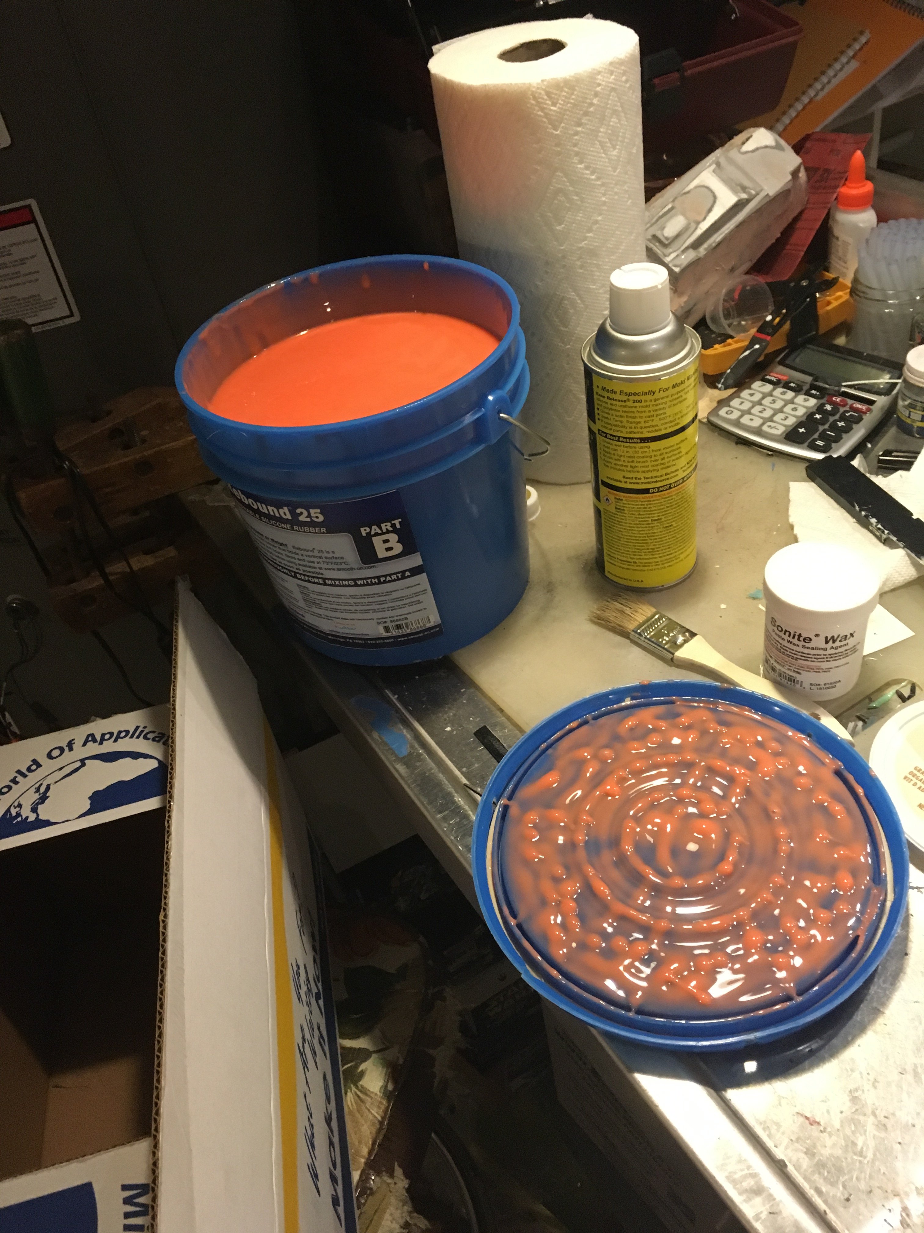

Okay so here I have my rebound 25 silicone...(part B)
Already had the helmet sealed up...(its not all gray because I did some last minute changes and the sealant is clear)
(also hating that the photos refuse to orient correctly)

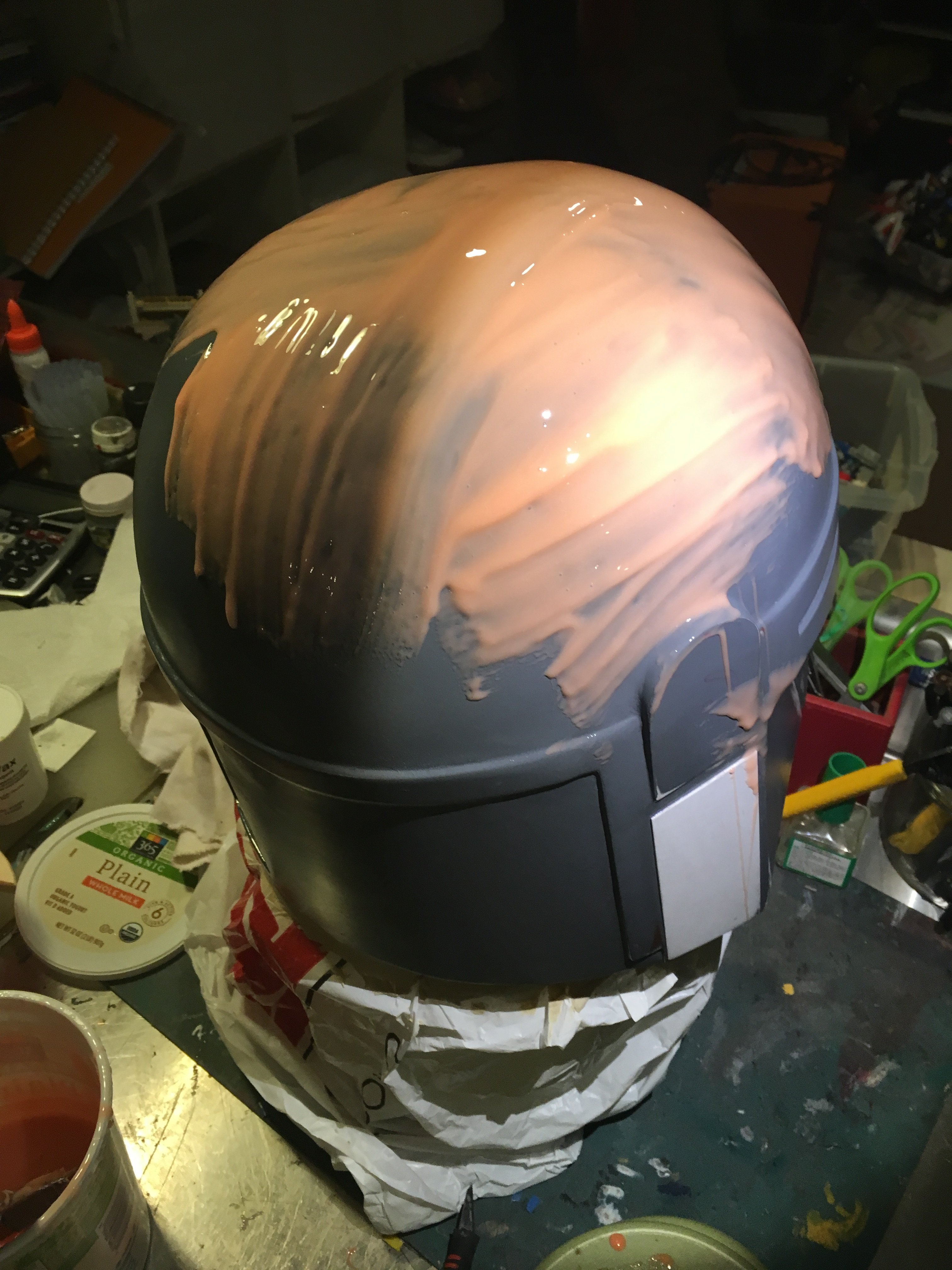

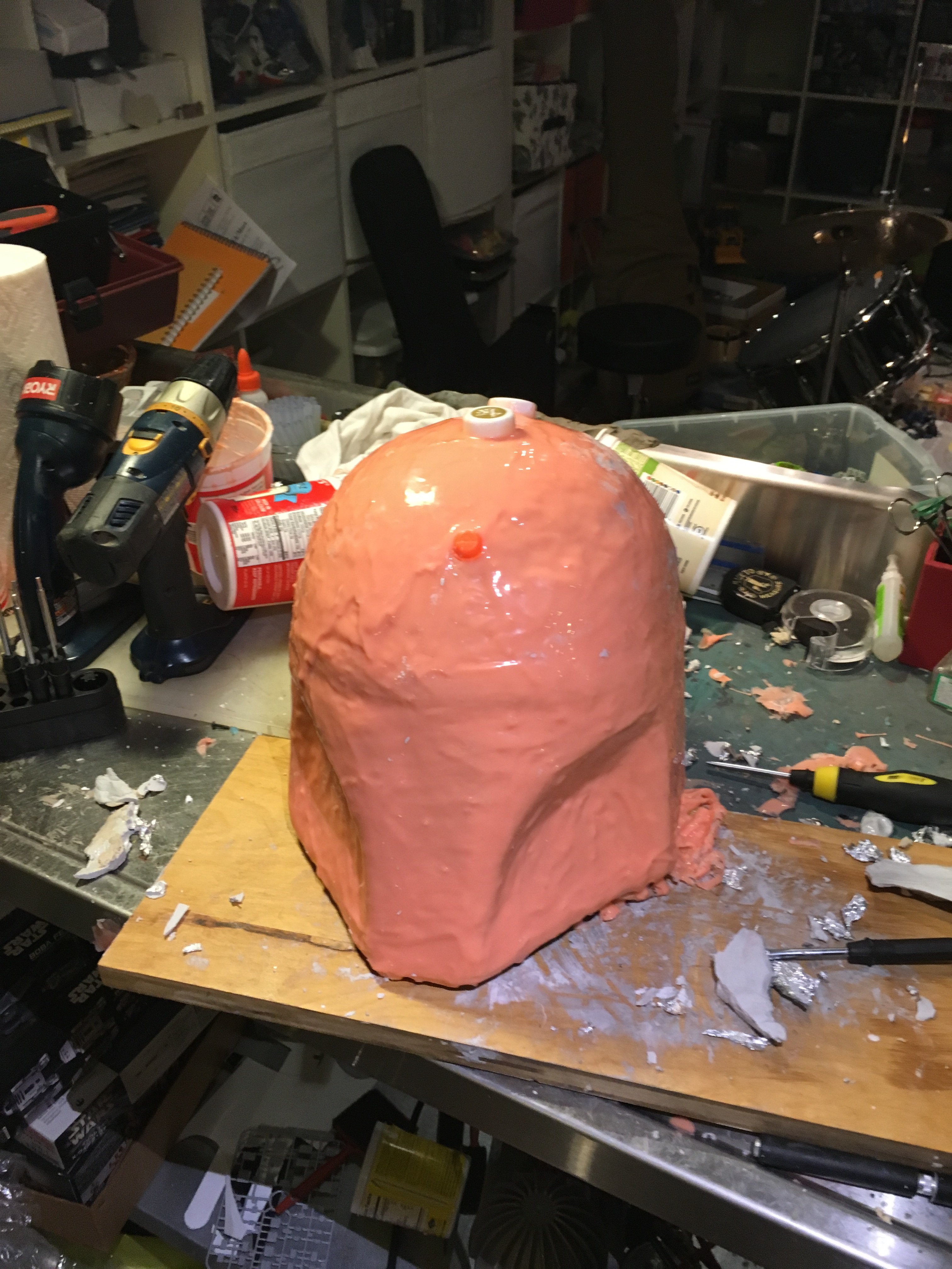

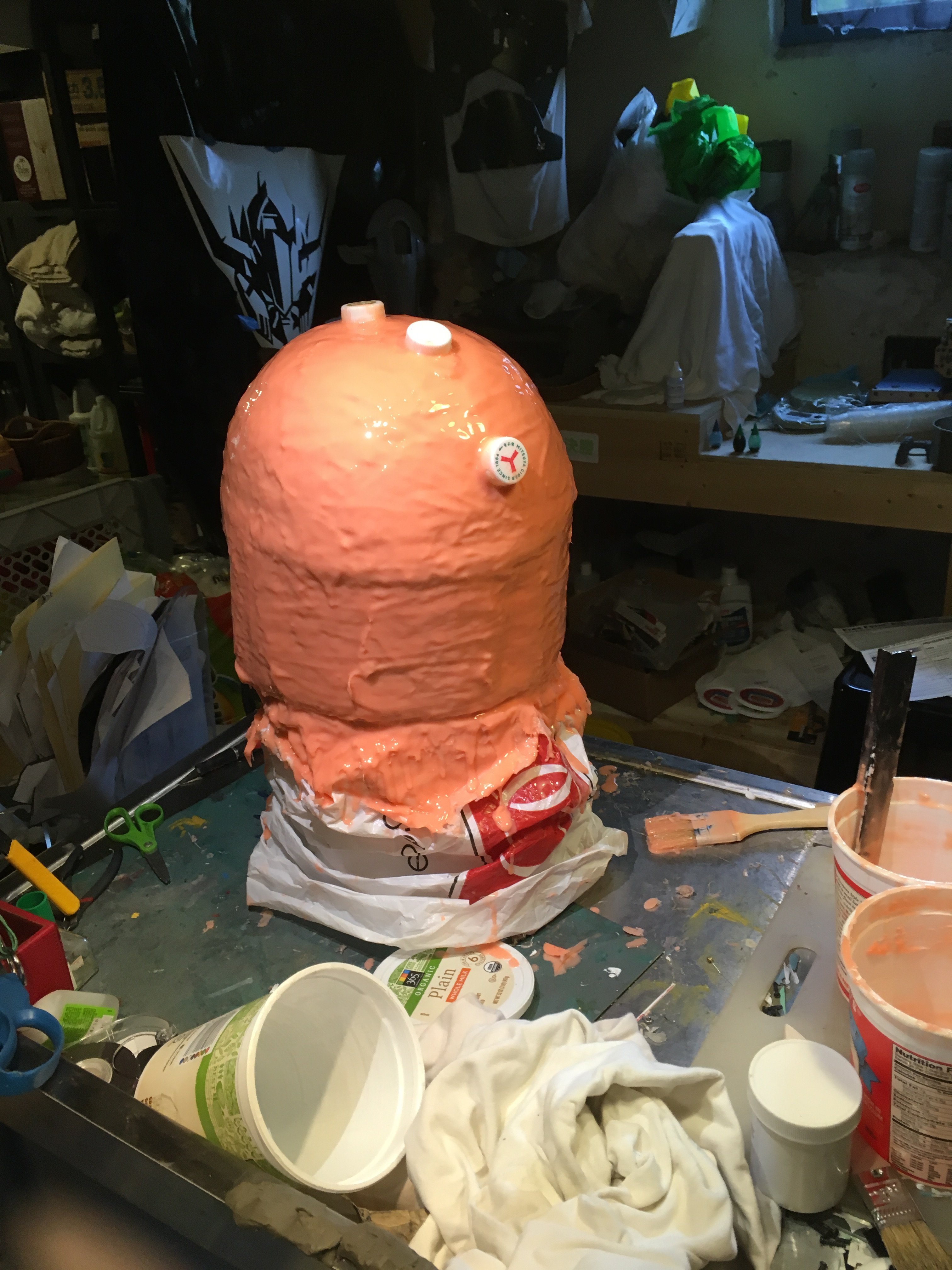

Then the first coat...
Okay, so far so good.

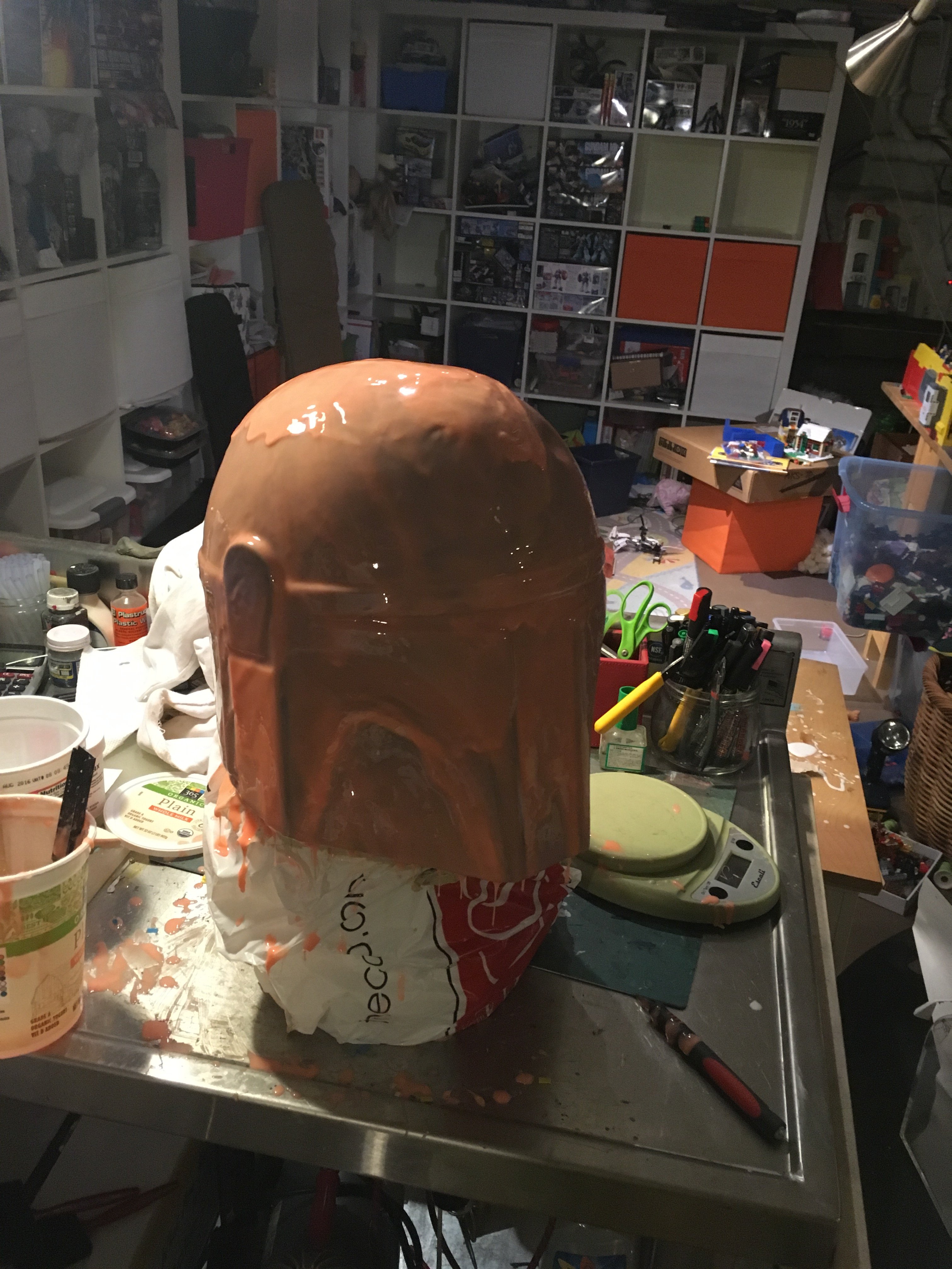

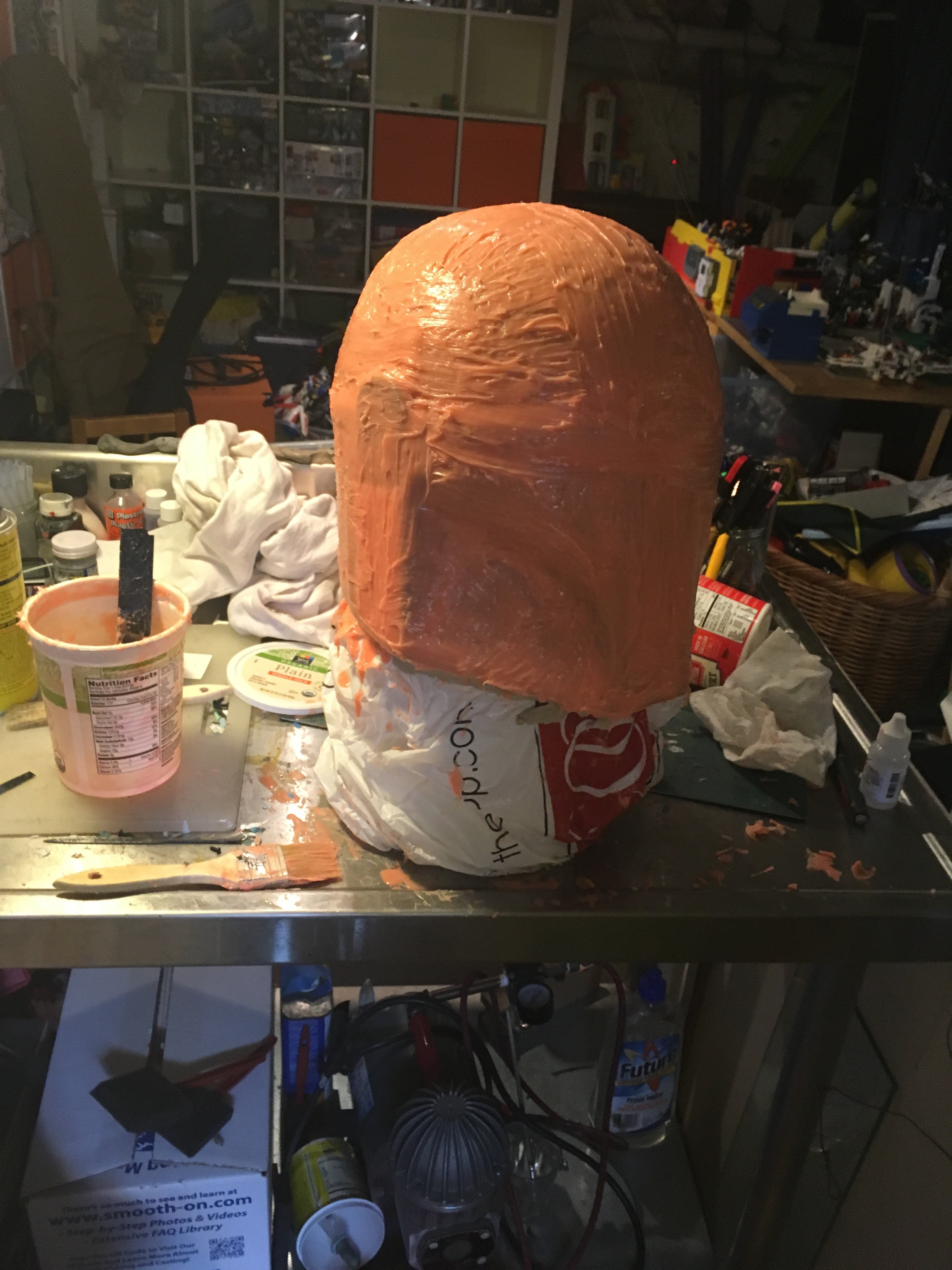

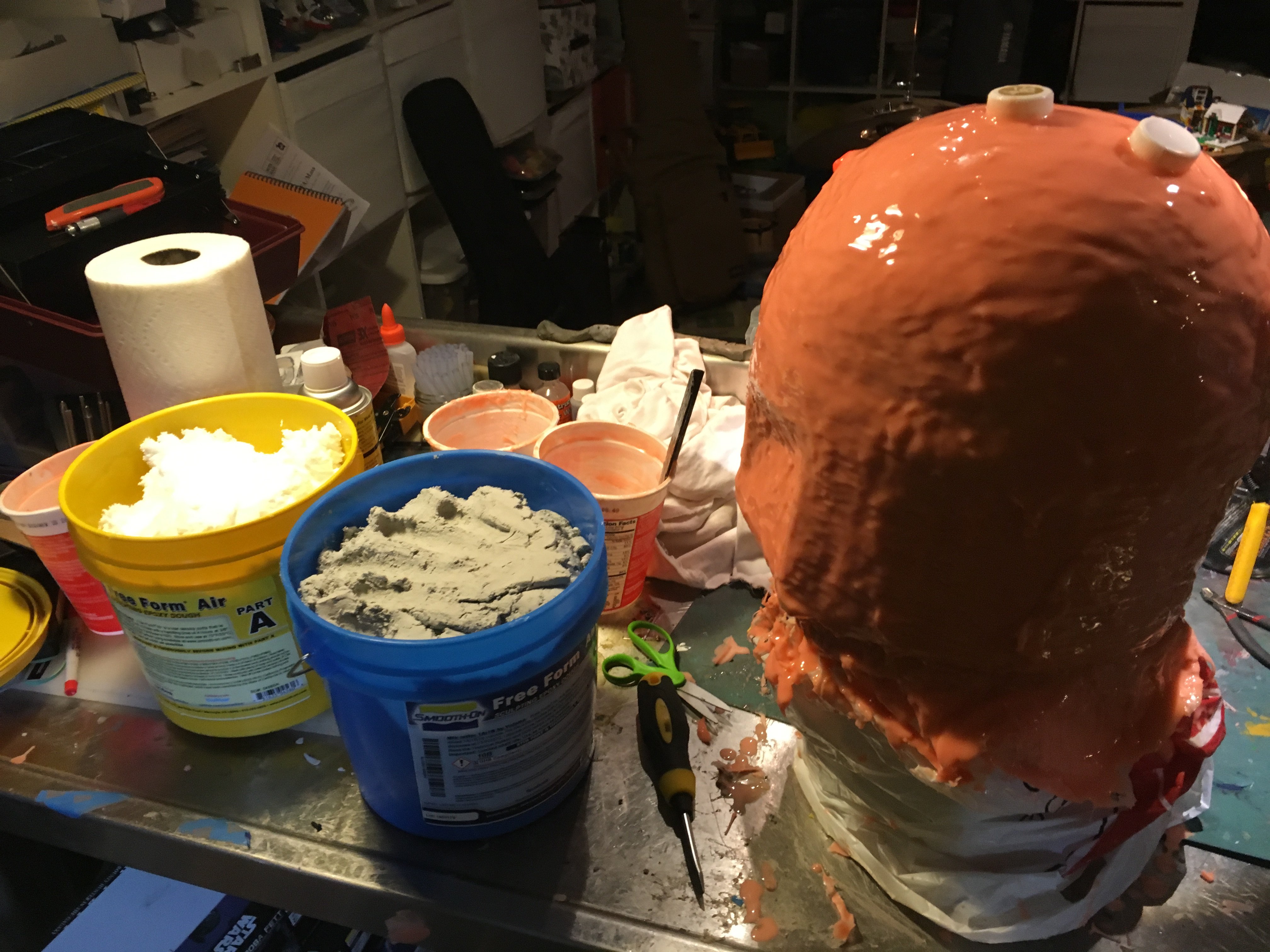

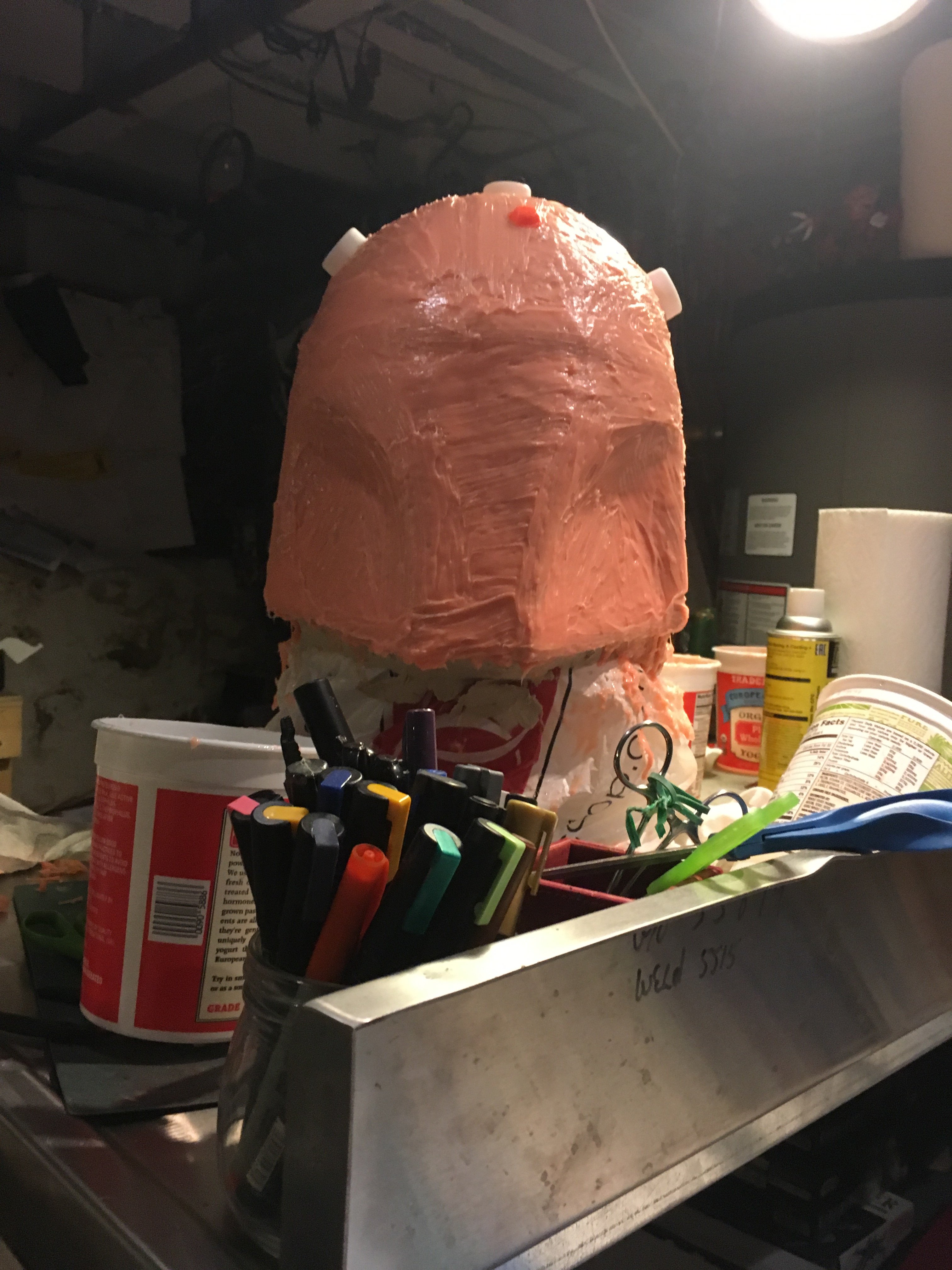

Second coat the next day, thickened with Thi-Vex.
Well, so this coat never properly cured. I later found out that I shouldn't have compensated for the Thi-Vex, thus making for an imbalanced mix of A + B. Simple mistake I guess.

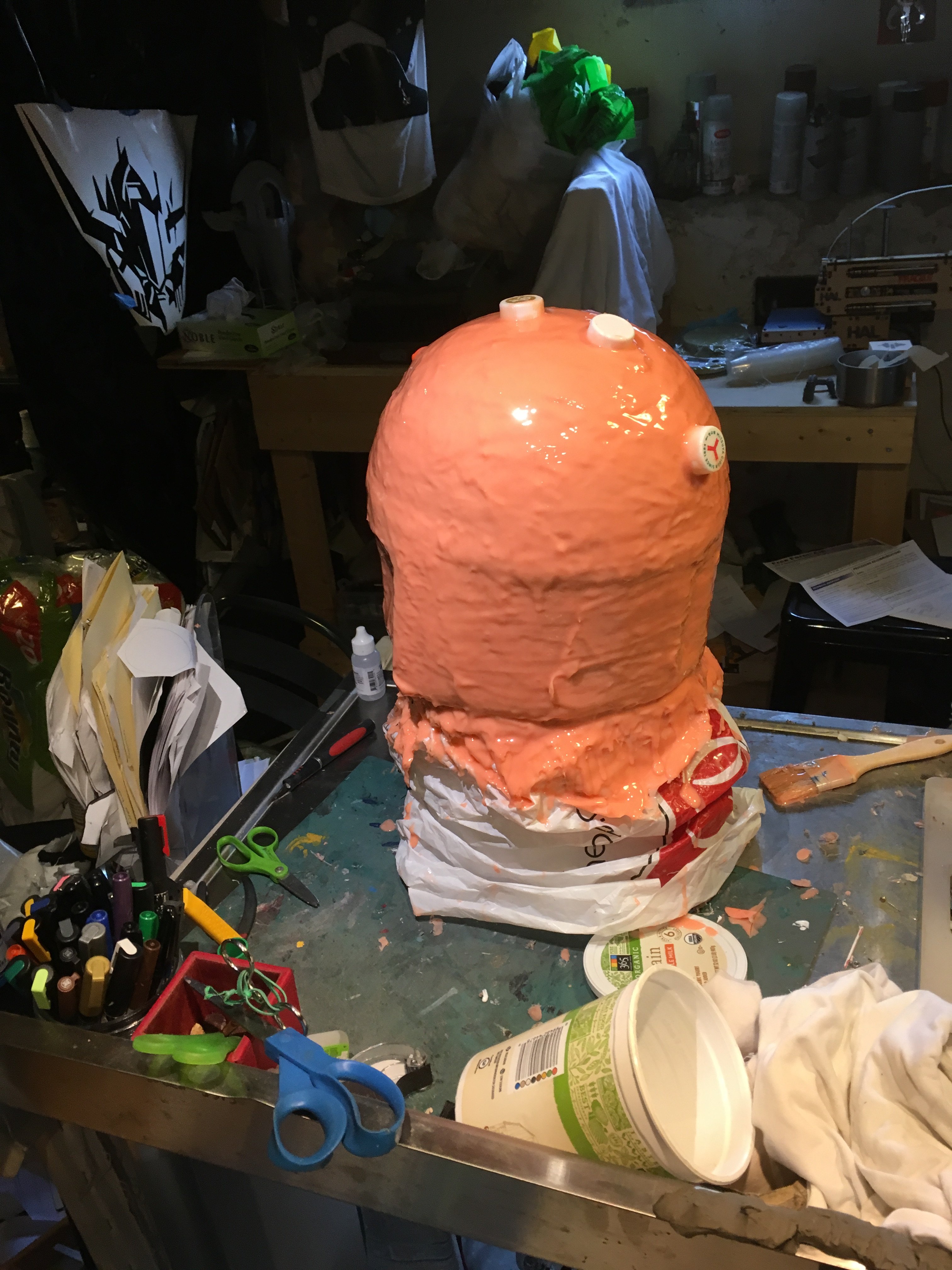

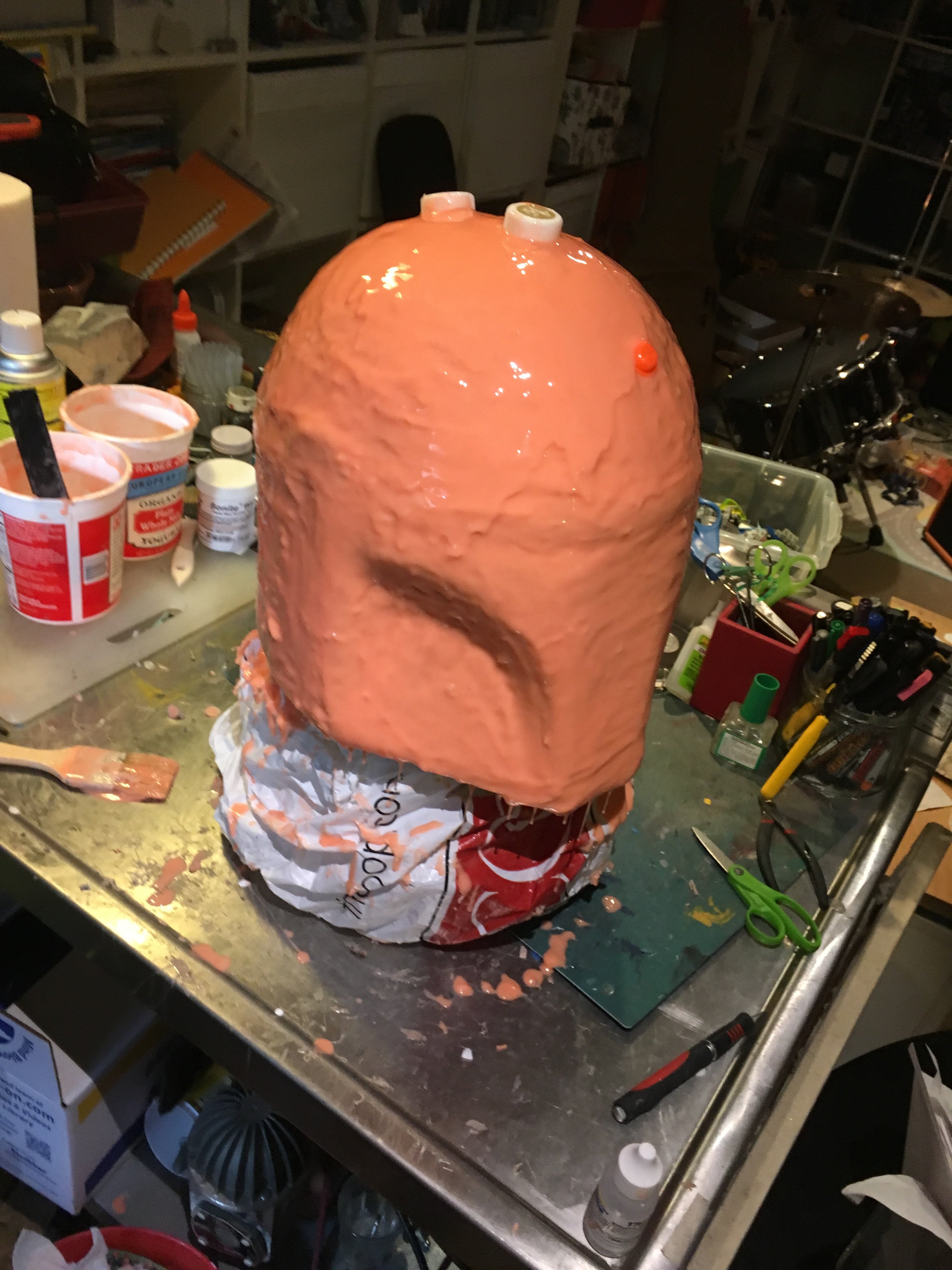

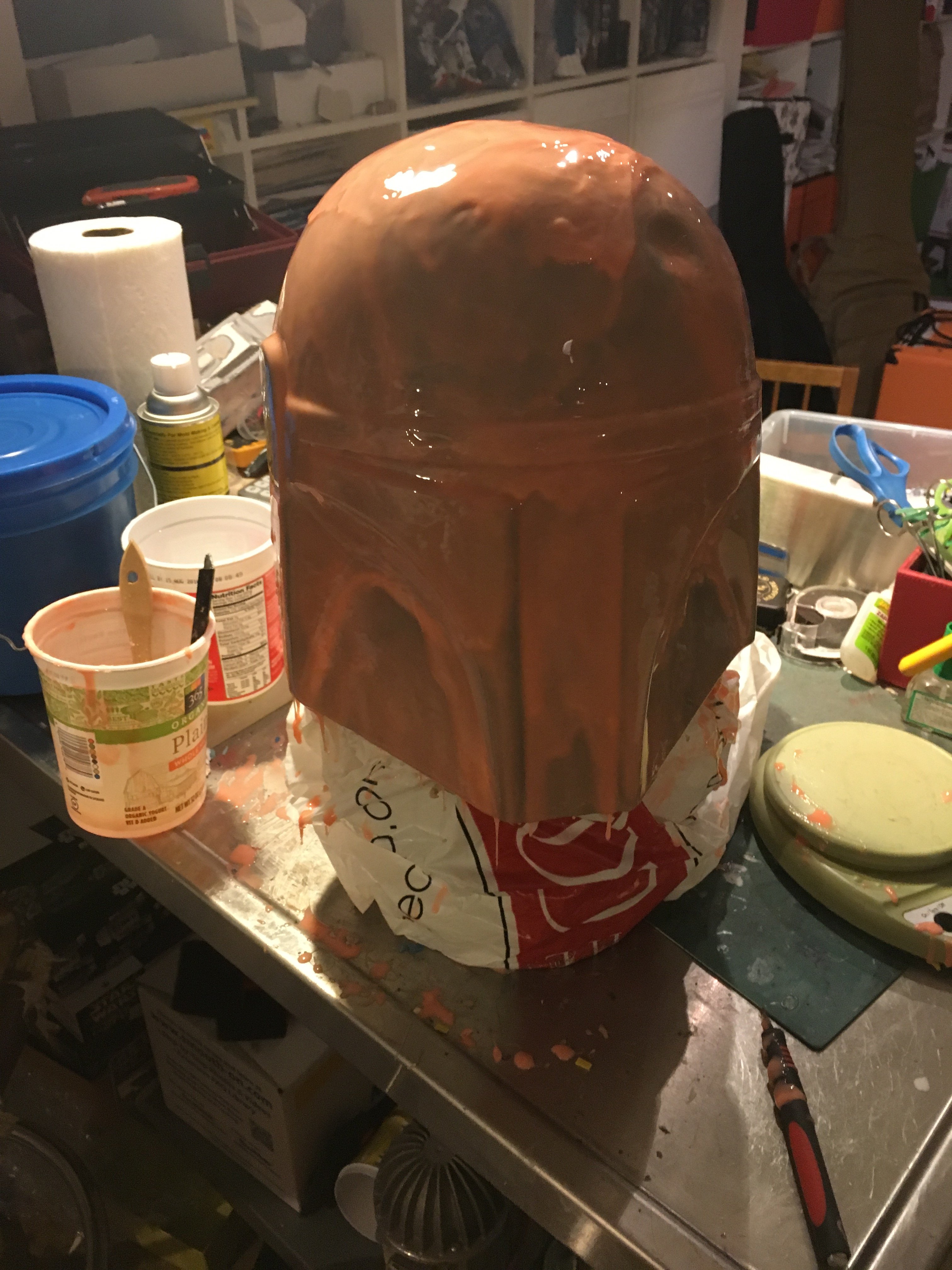

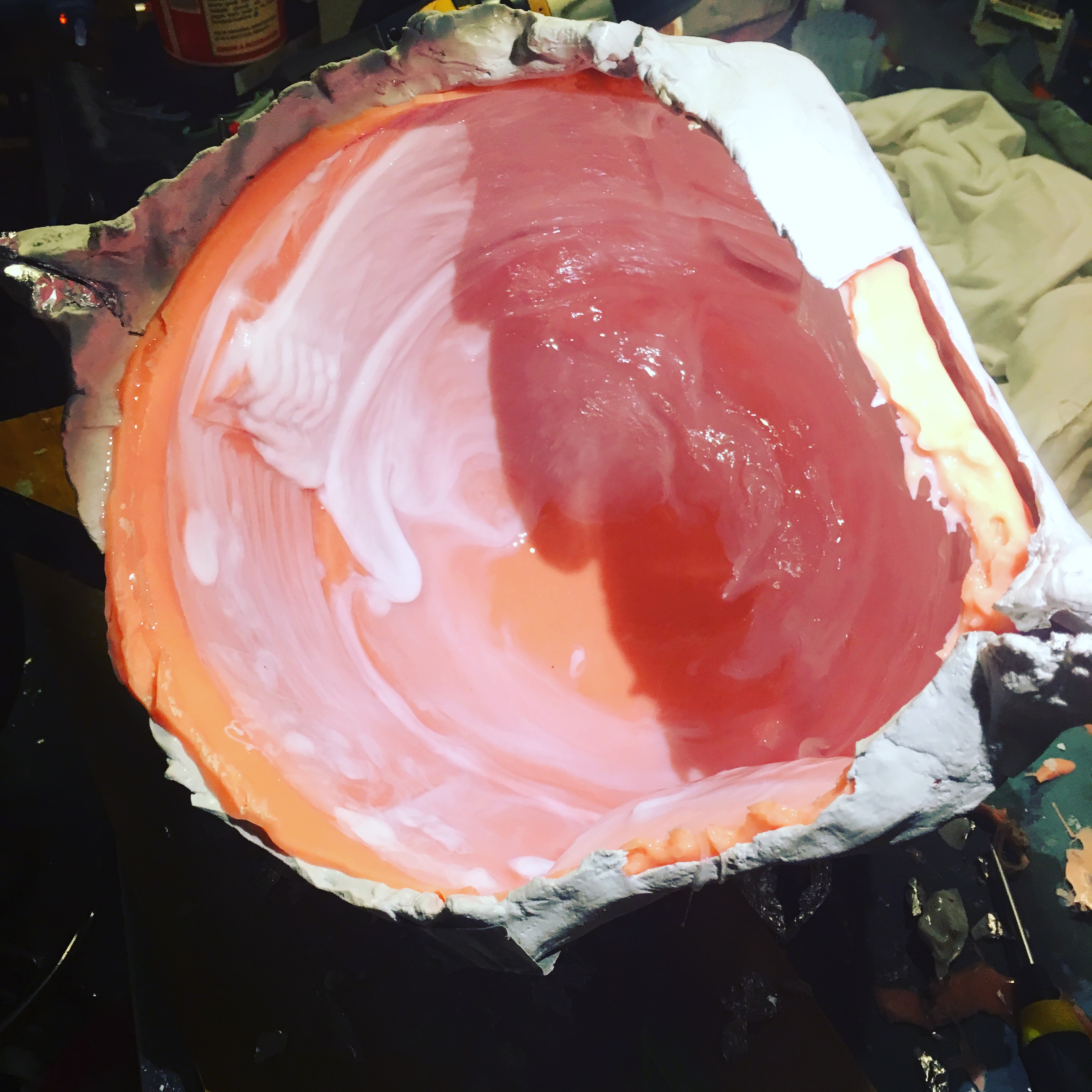

I decided to put on a third coat over this and see what happened.

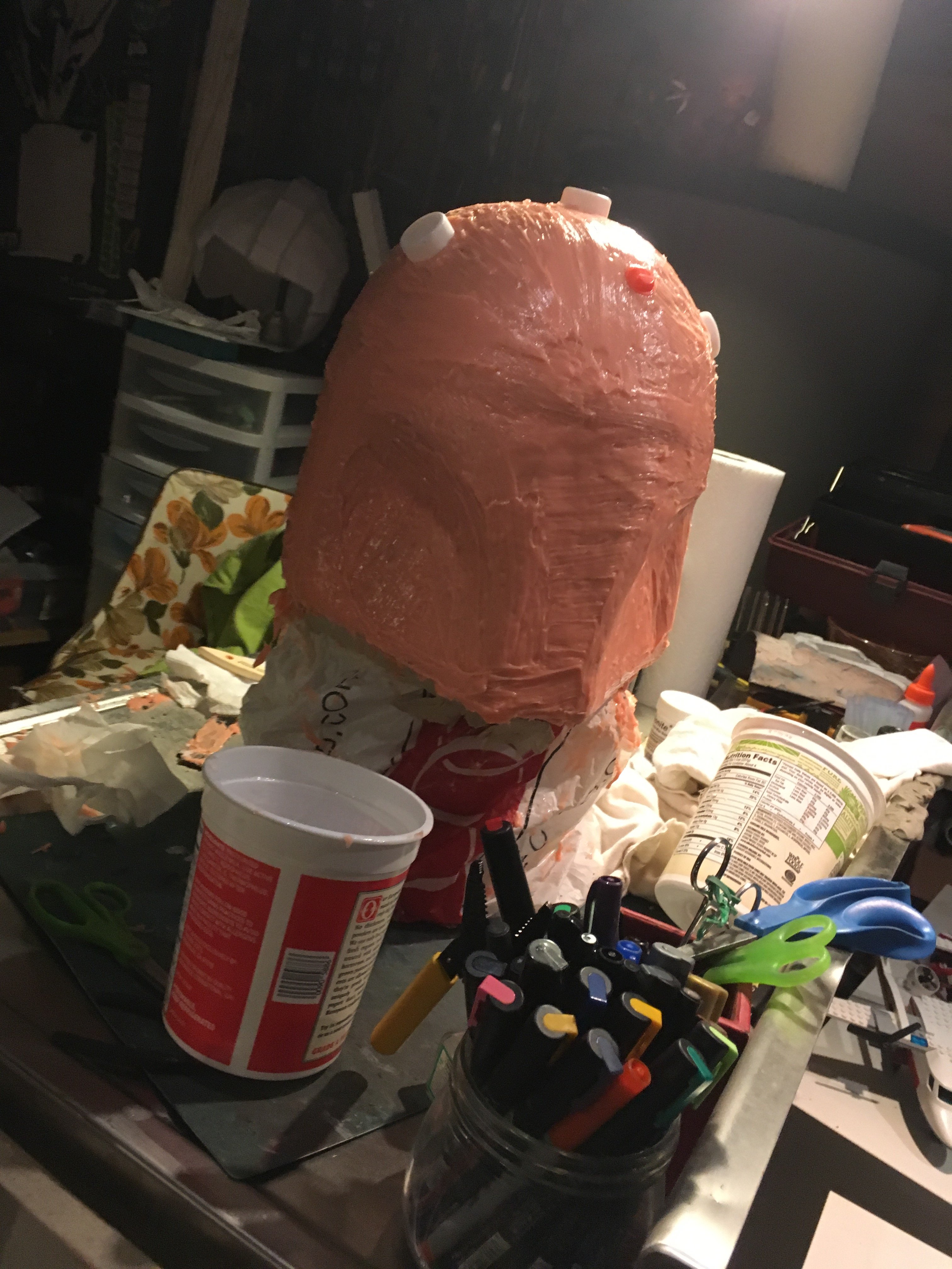

Well, it fully cured in some areas, but was still tacky in much of the place. (I put the keys for the mother-mold on funny for the purposes of amusement, Darth Fett-Maul)

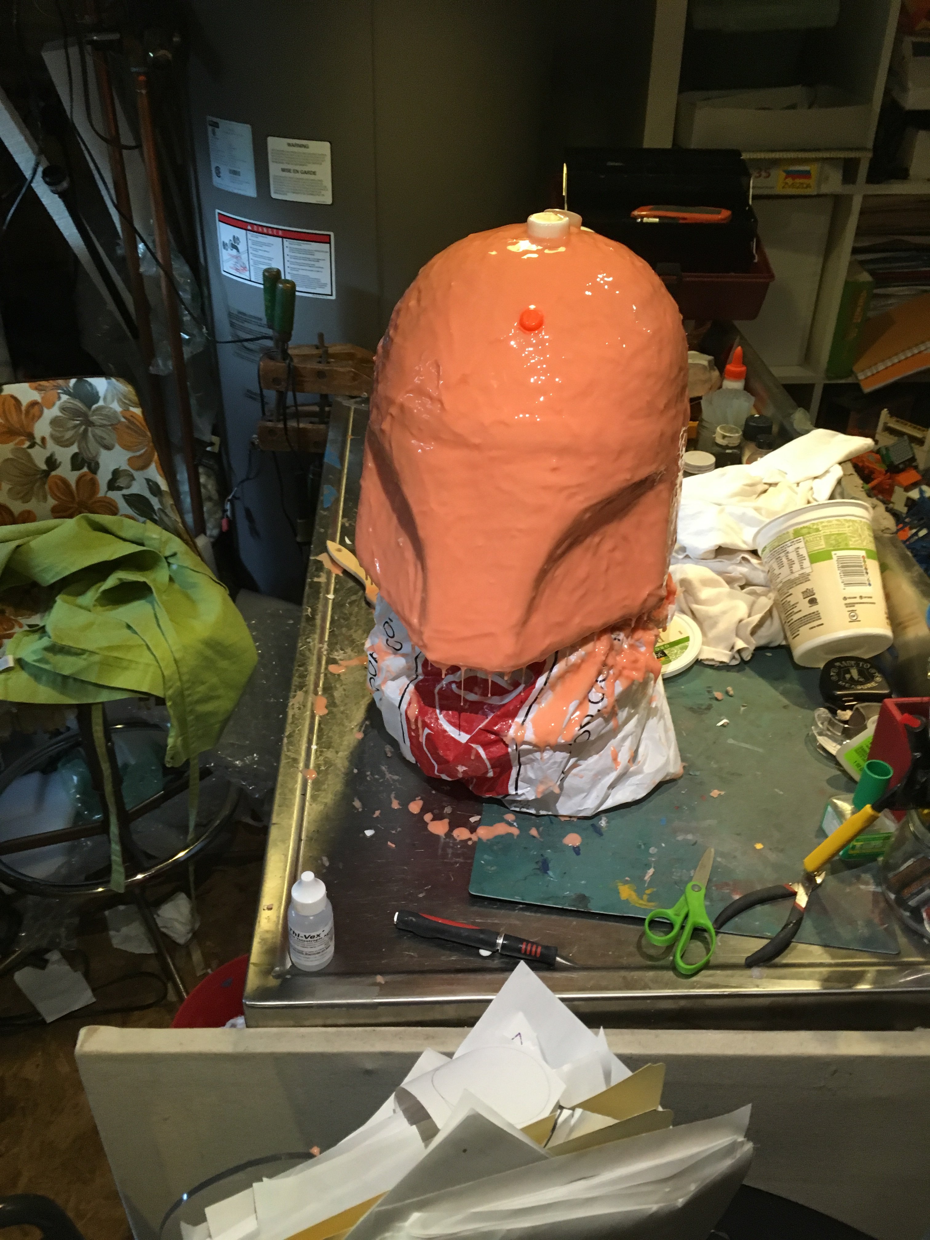

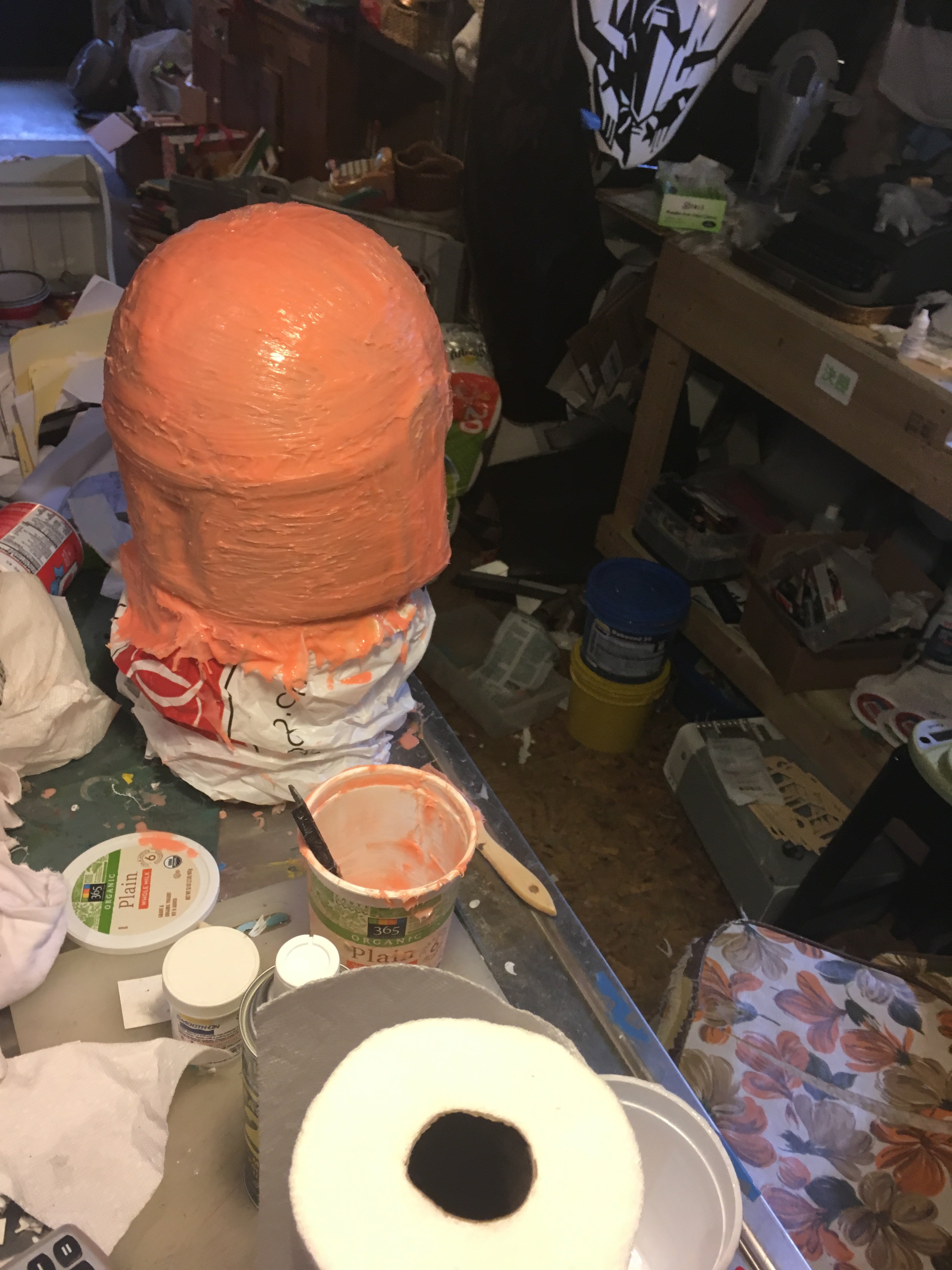

I figured a fourth layer would fix the rest, and I didn't add any Thi-Vex to this one. I can safely report that it is not tacky in the least. We shall see how the mold performs, but seems good so far.
Somehow I will never get over thinking of these molds as 'mummies made of orange sorbet'. Seems about accurate too.
Next, I shall make the mother-mold. Hoping to have a casting by tomorrow night!

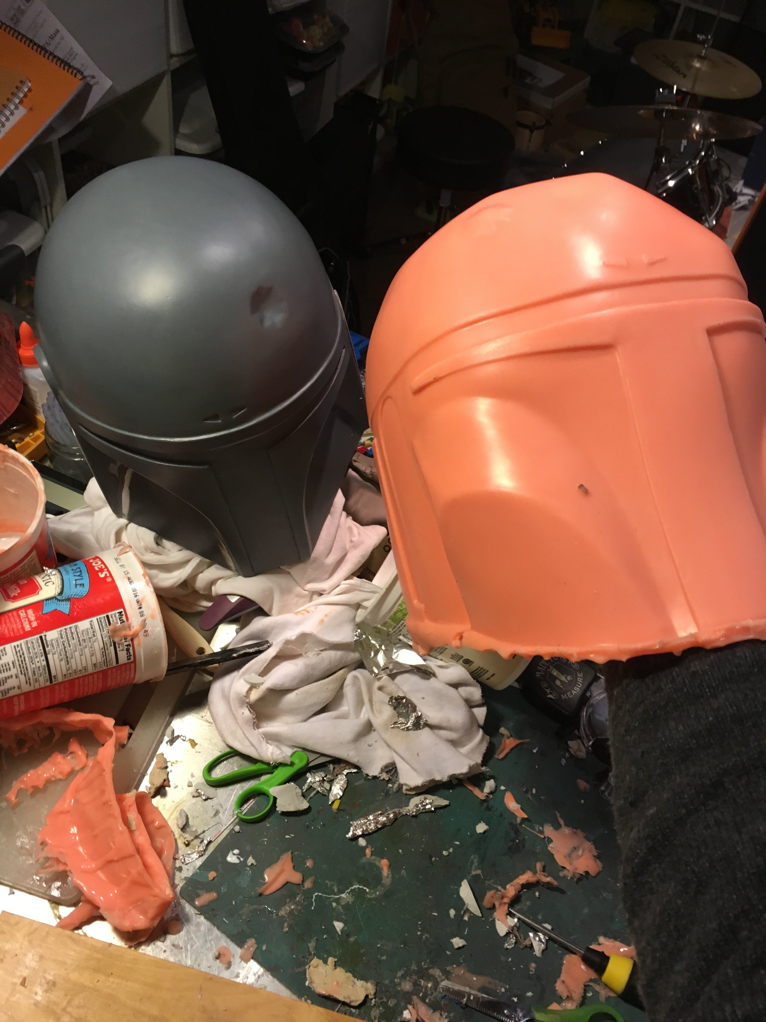

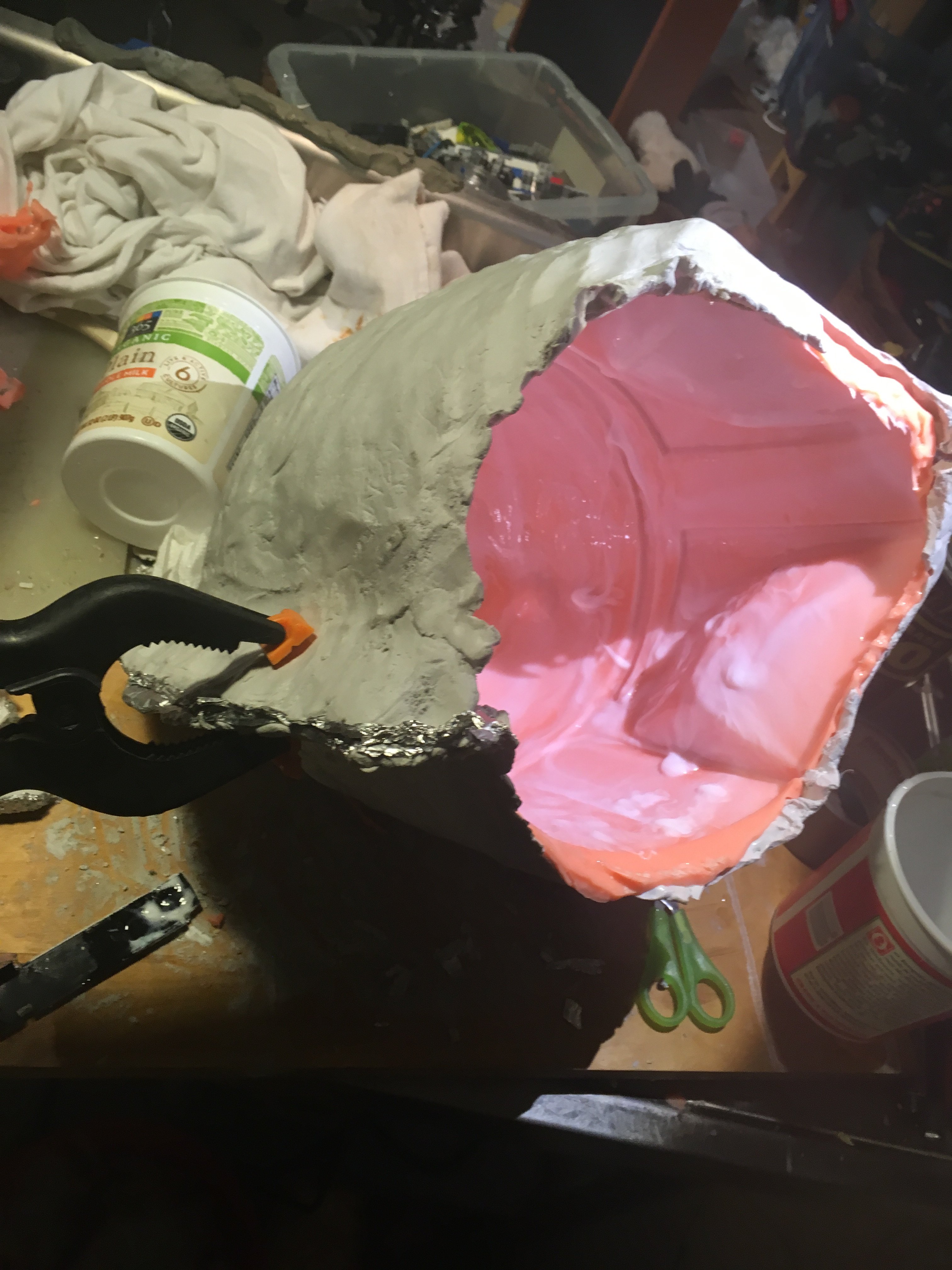

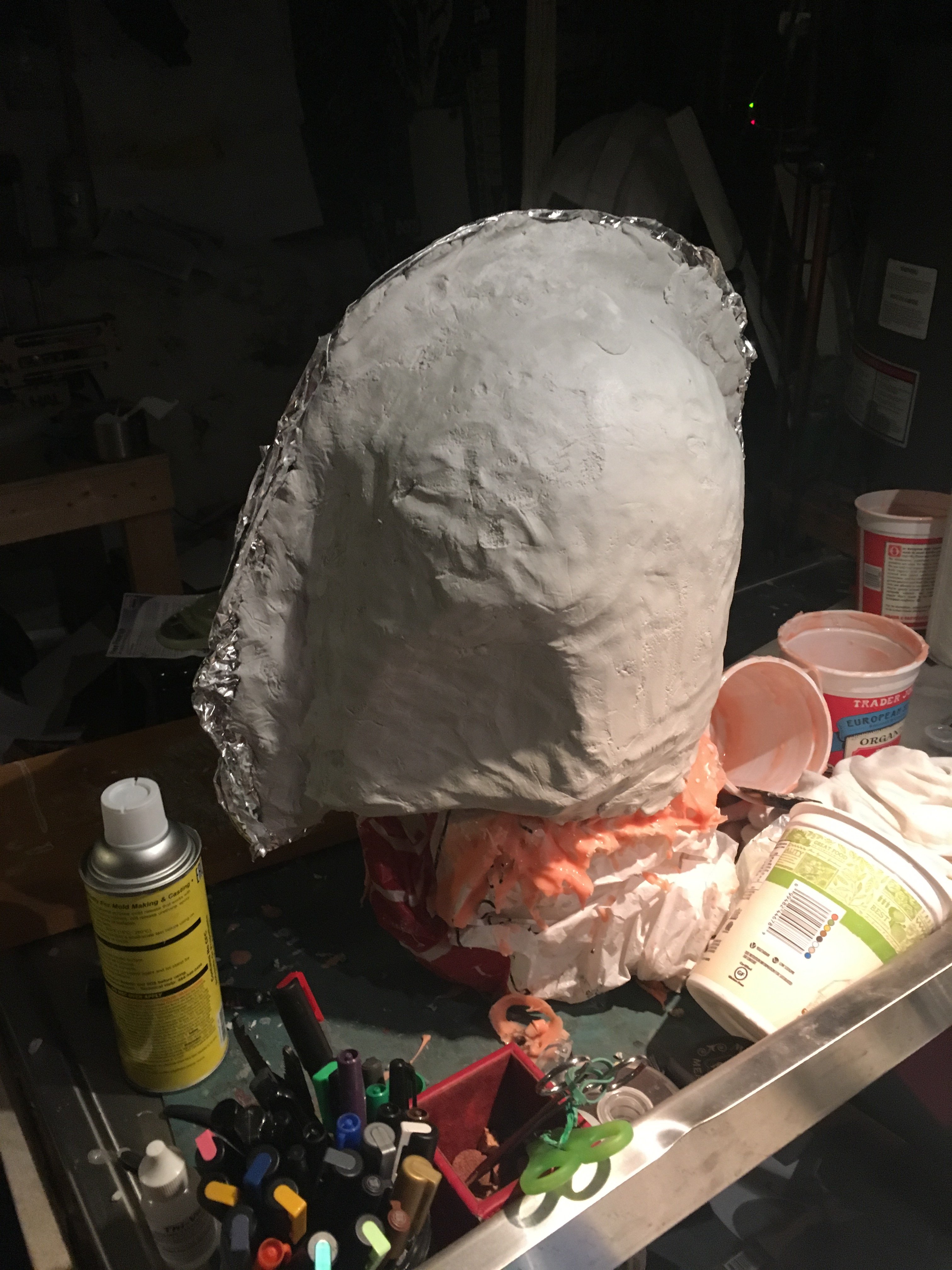

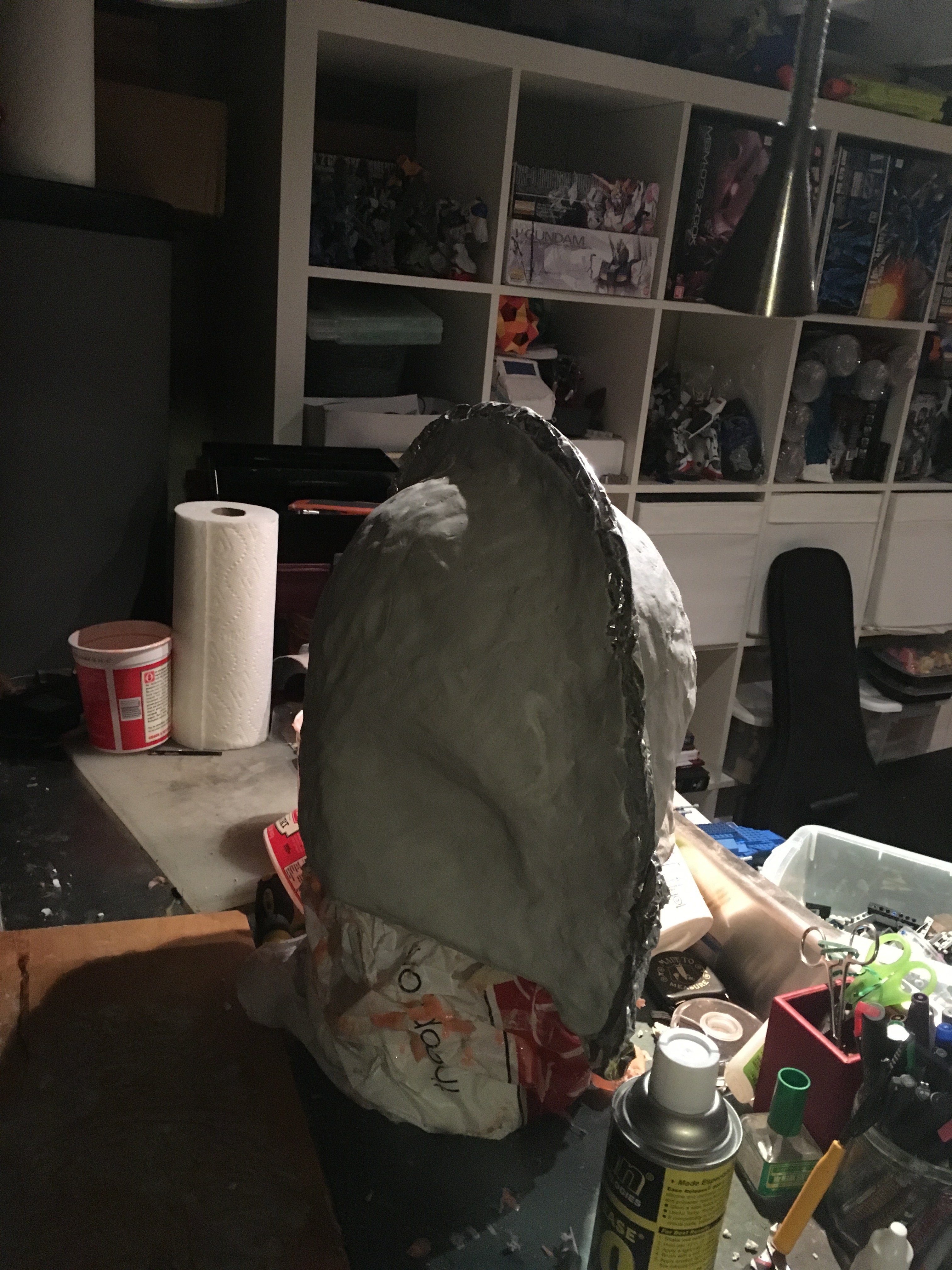

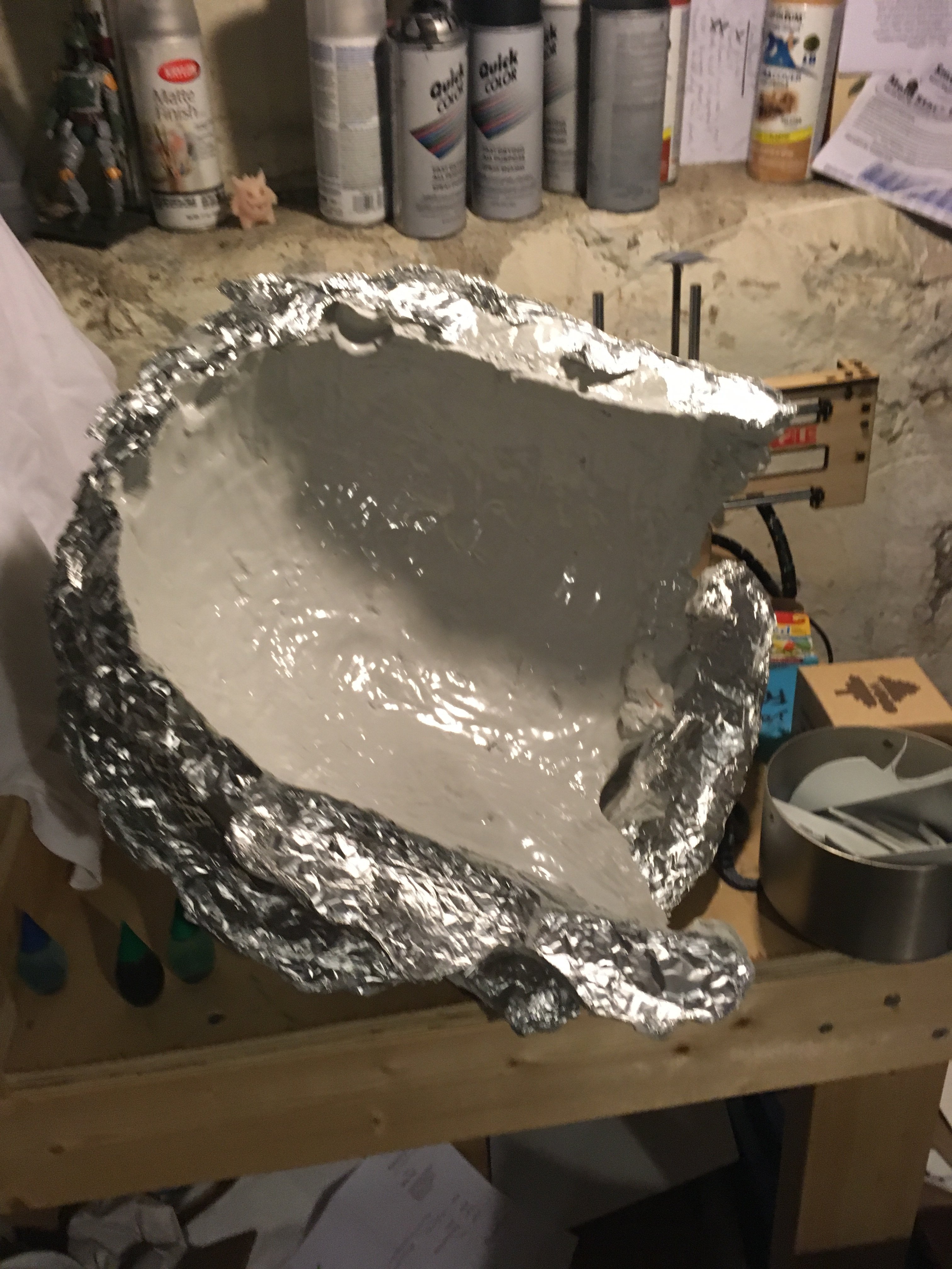

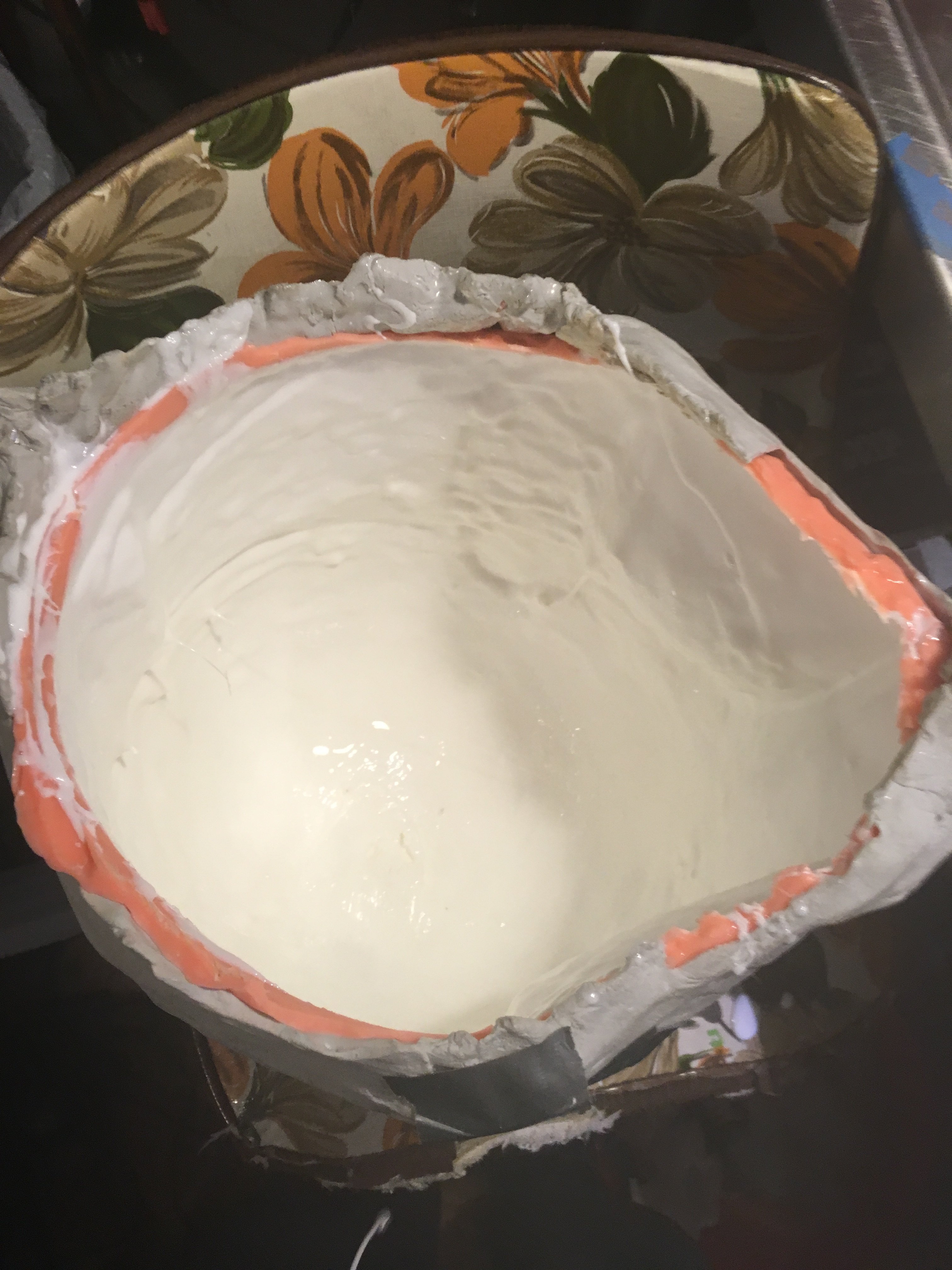

So! The mother-mold got made. I used Smooth-on's Freeform Air, which i didn't layer on thickly enough, as I found out later. Nonetheless it worked great!
Once fully cured (24 hours later) I opened it up and got my master back. (inverted mold in comparison to master)

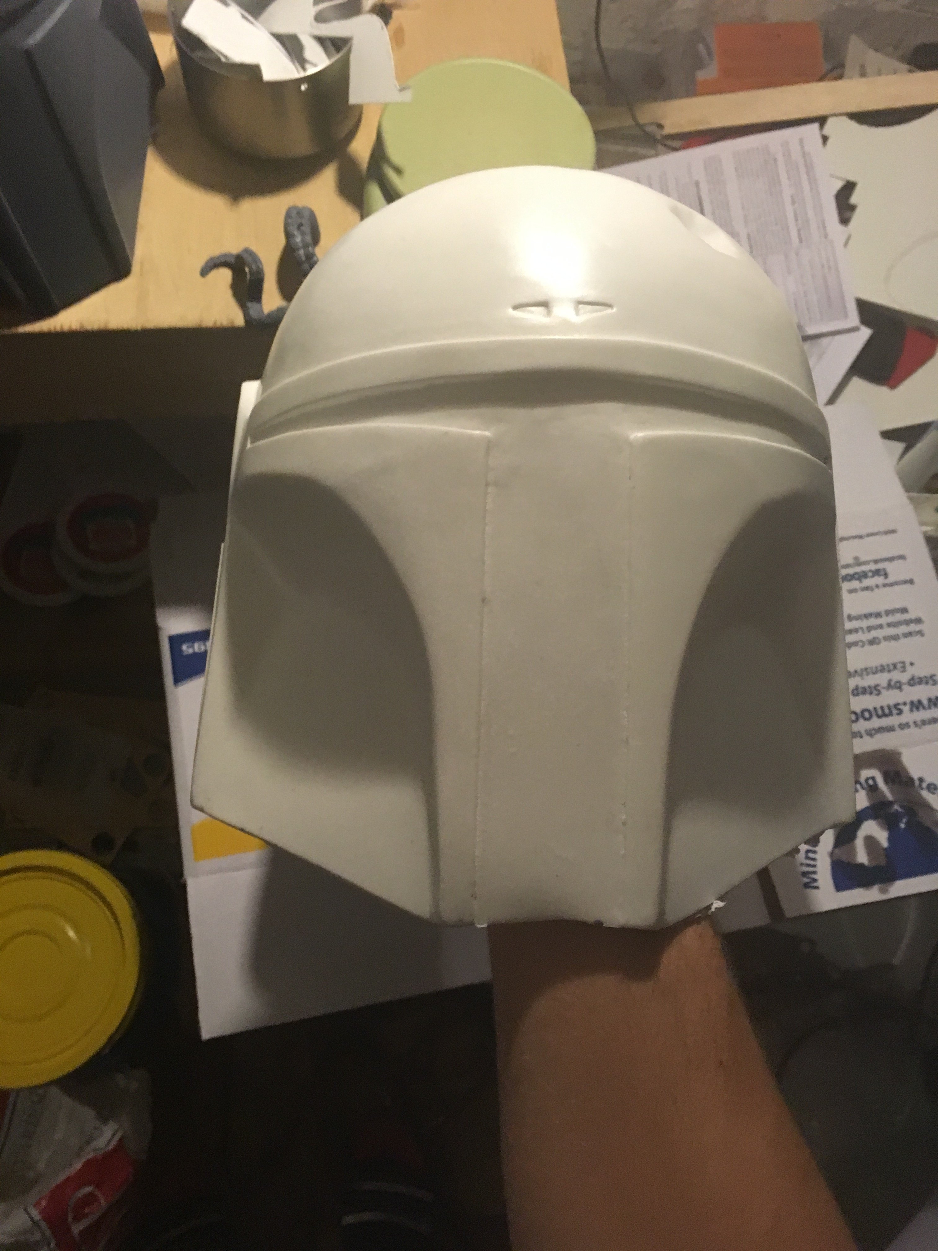

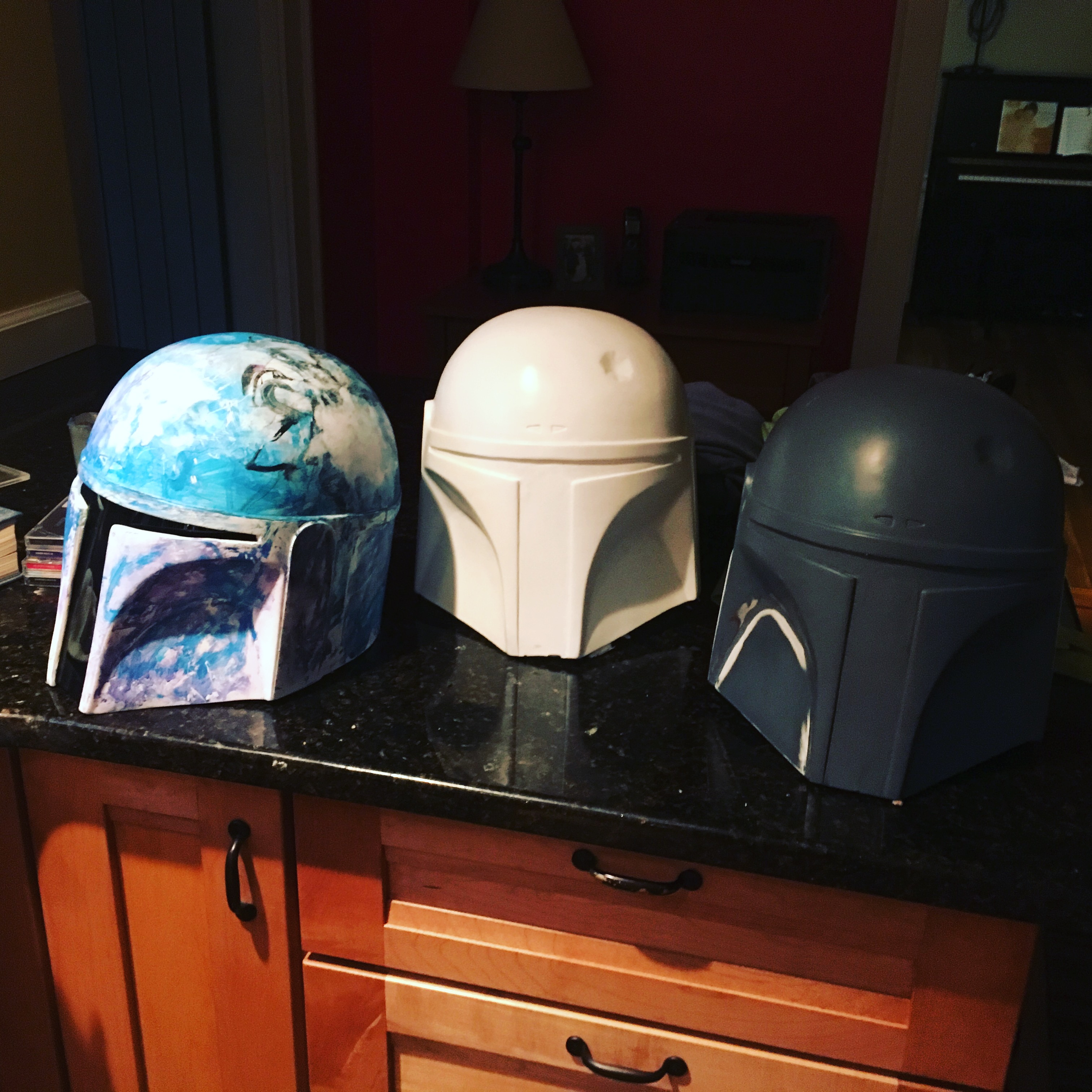

I promptly got ready to cast, and got my first helmet!!
That one I decided to have some fun with for Halloween purposes, since I didn't have time to do a proper paint up of any sort. (I left the ear pieces off on purpose)
Initial:
Next to master and another casting:

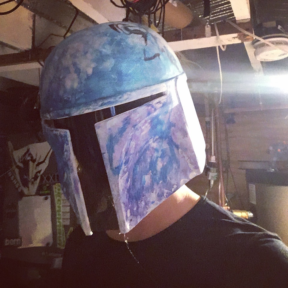

A friend got a photo of me at a party, with the additions I added later on:

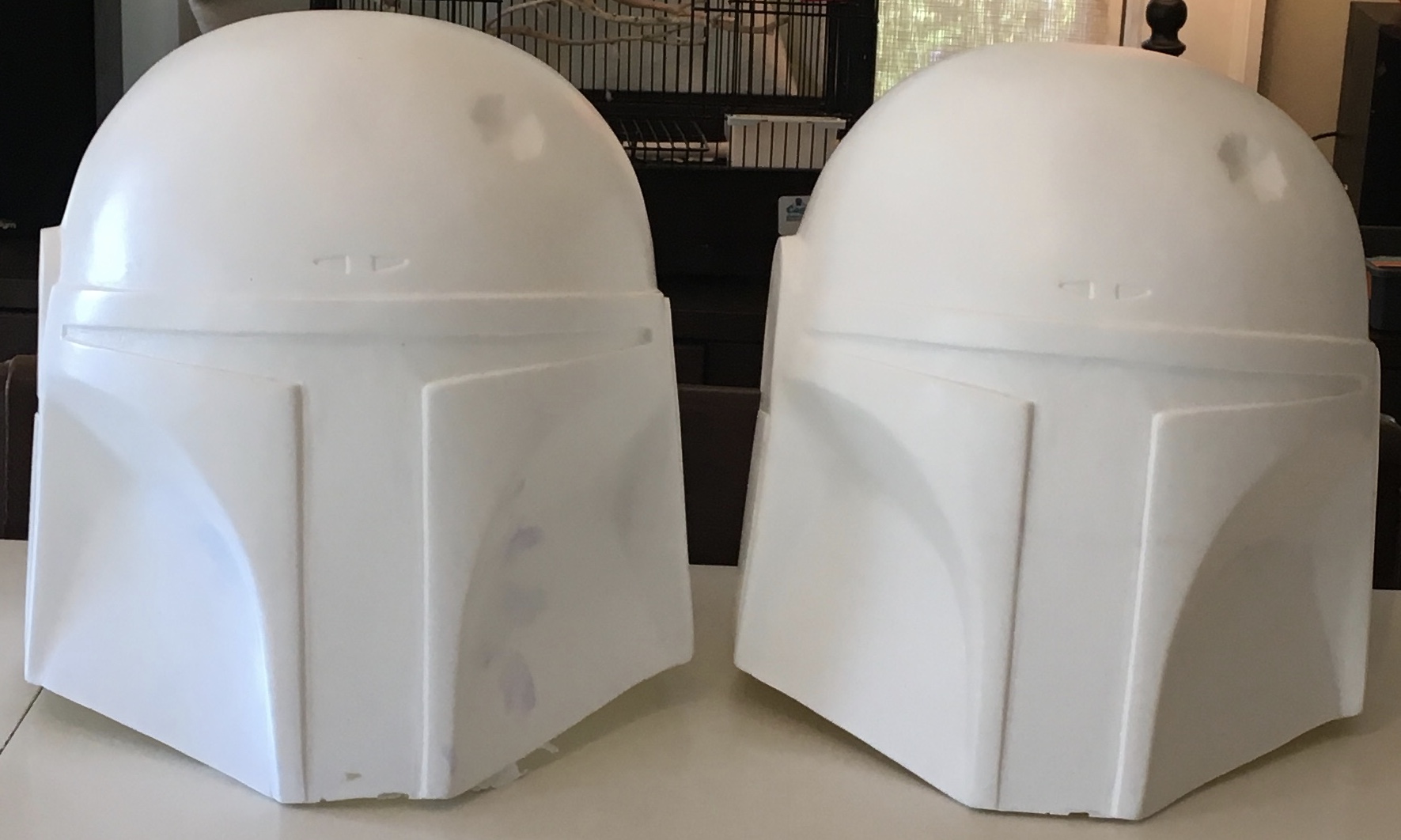

I also developed a ESB version of my helmet, (not done with it yet) that has some of the warped features, especially the flair (ESB on the left, compared to the usual on the right):
Any thoughts?
