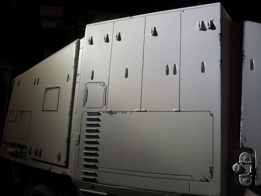

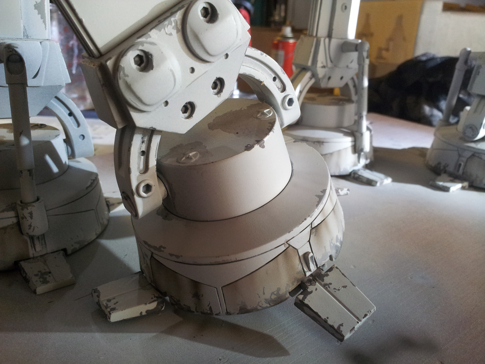

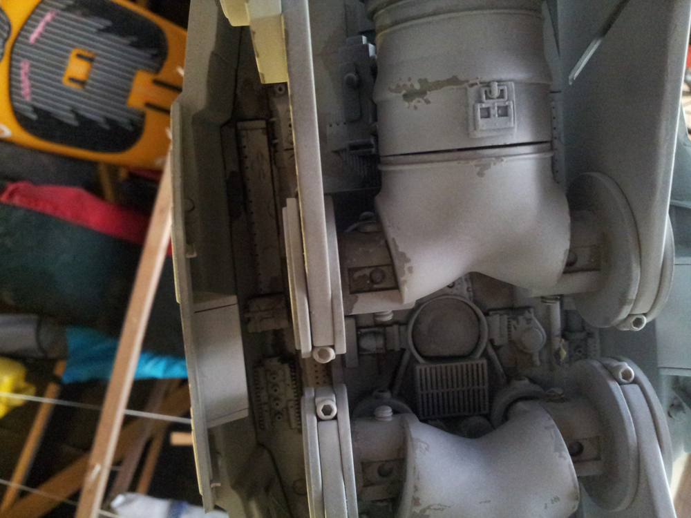

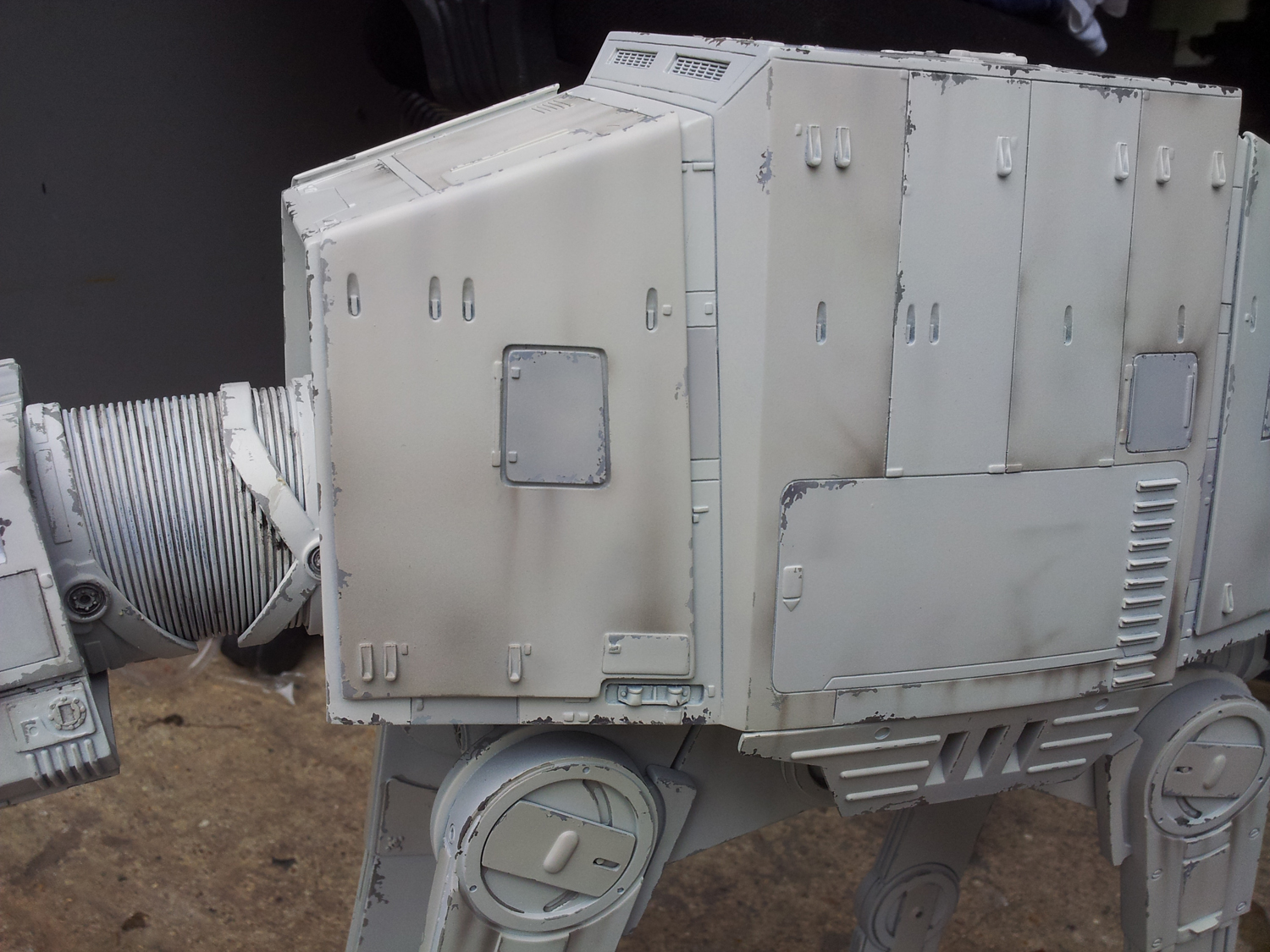

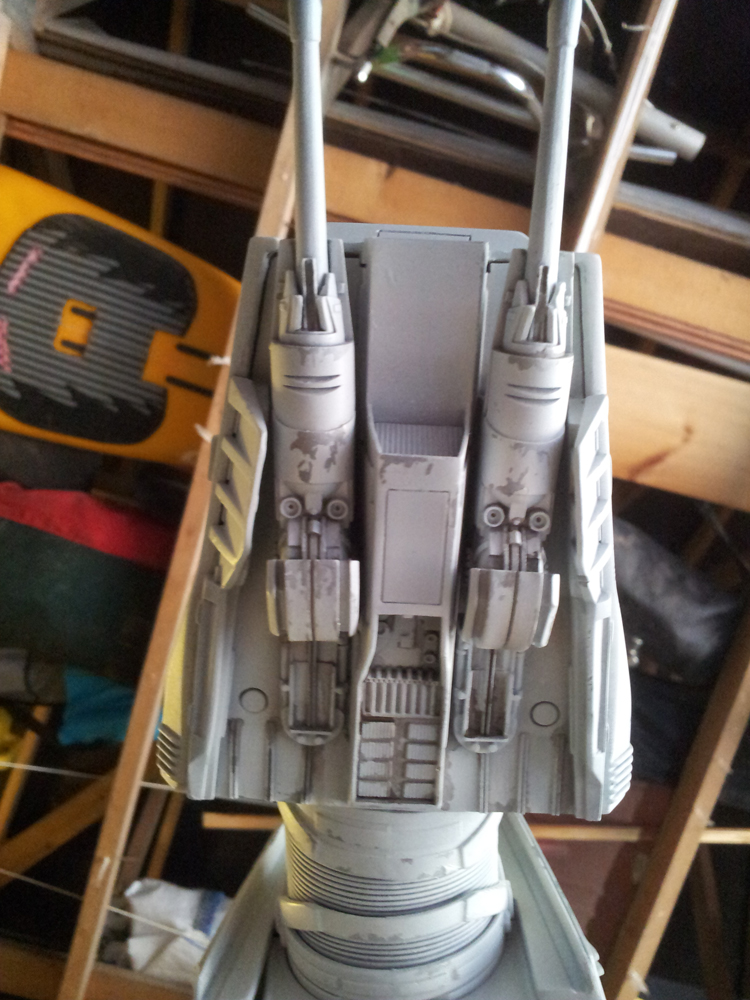

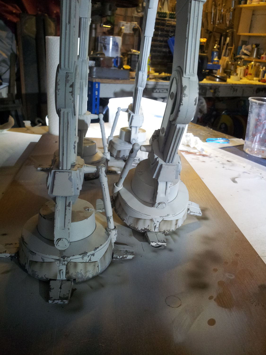

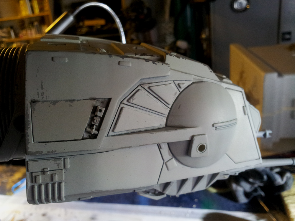

First stage is pre-darkening all areas where the paint will be chipped, giving a lovely Dalmatian look to the whole thing. Horrible!
Next up is the application of shed loads of latex masking to create small edge chips to many of the panels. Then a coat of primer ready for the base coat.

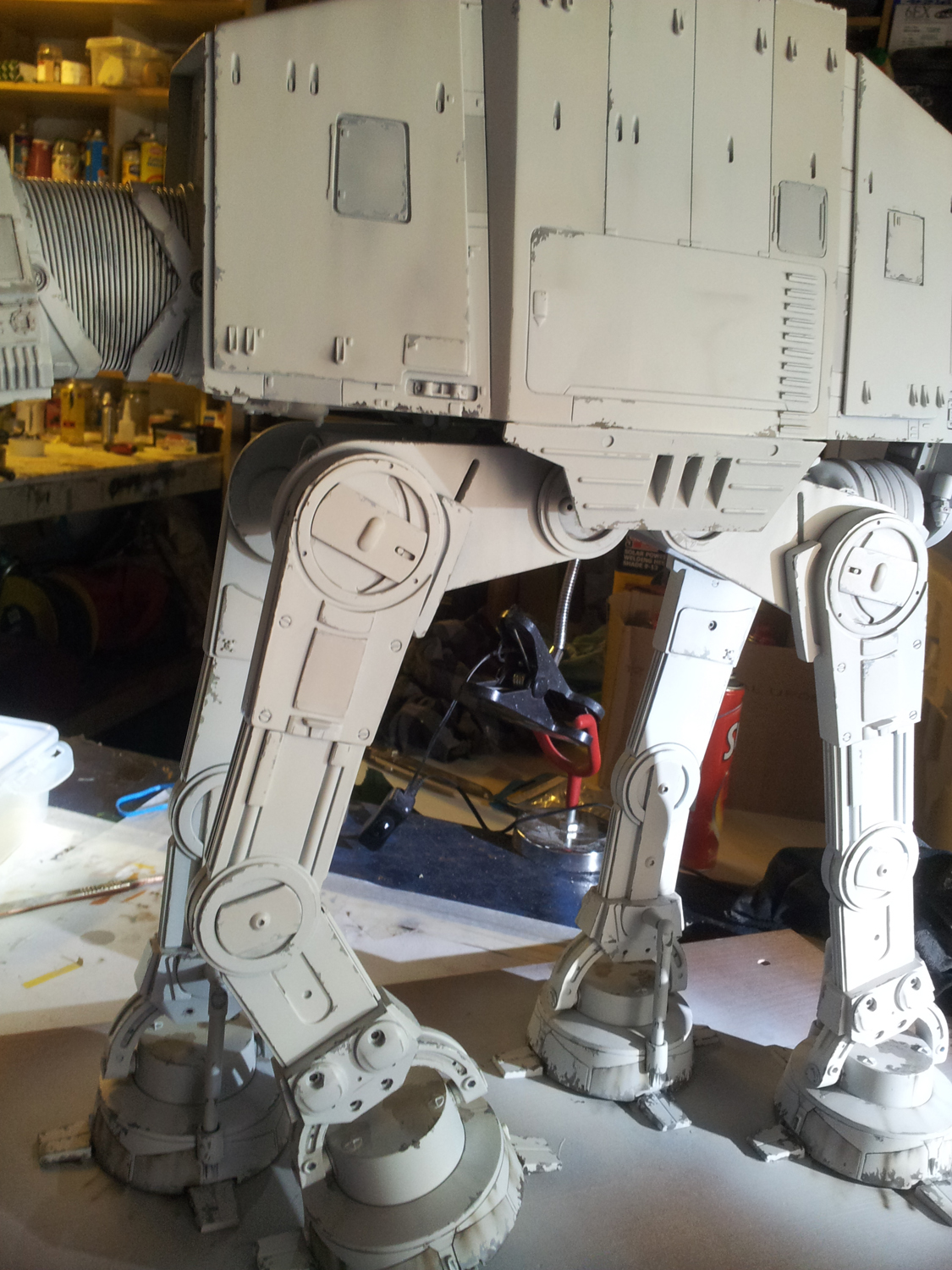

Day 2

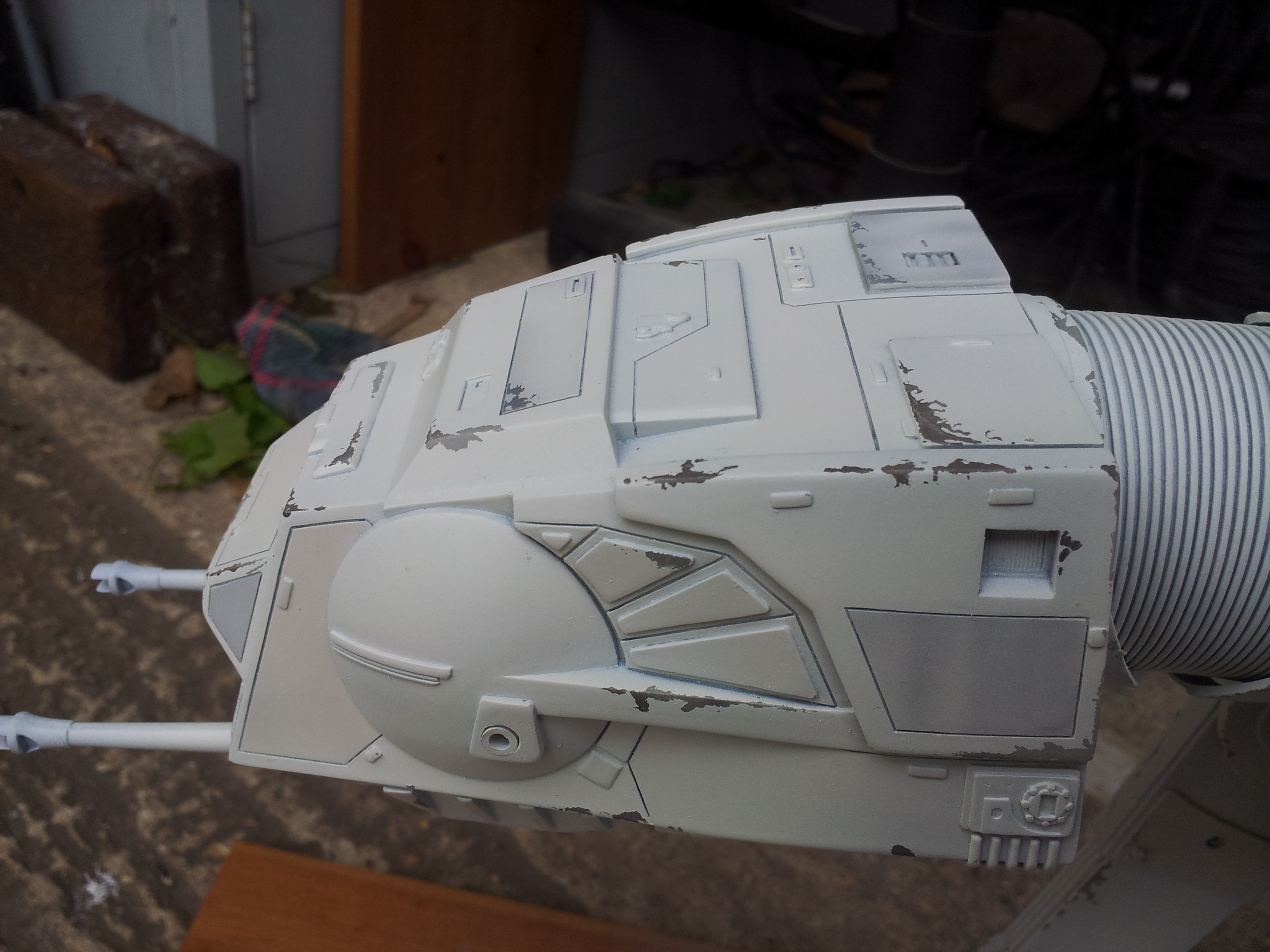

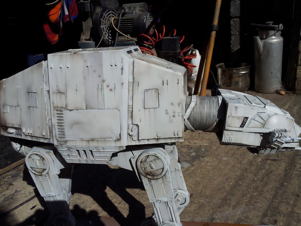

Base coat on, RAL 9001 (an old favourite) in satin finish.

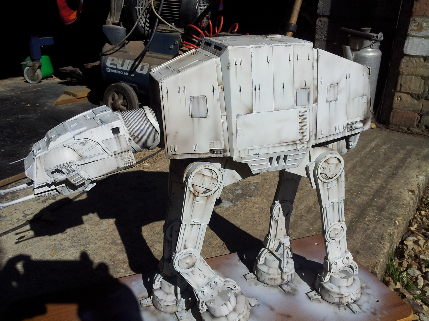

Subtle shading to bring the panels alive and some weathering started under the belly of the beast
Chipping looks heavy at this time, but it ill calm down as the other darker colours go on eventually.

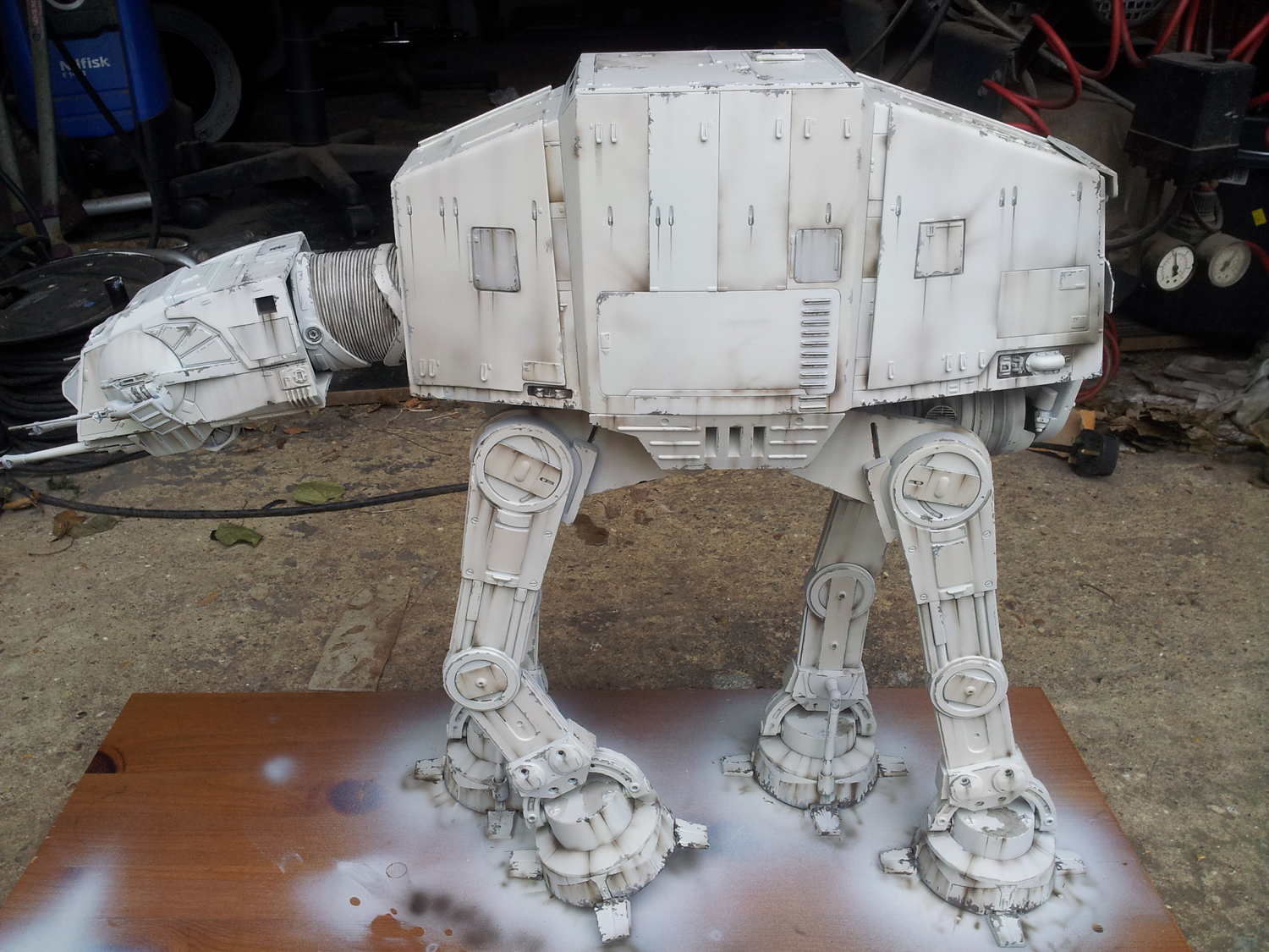

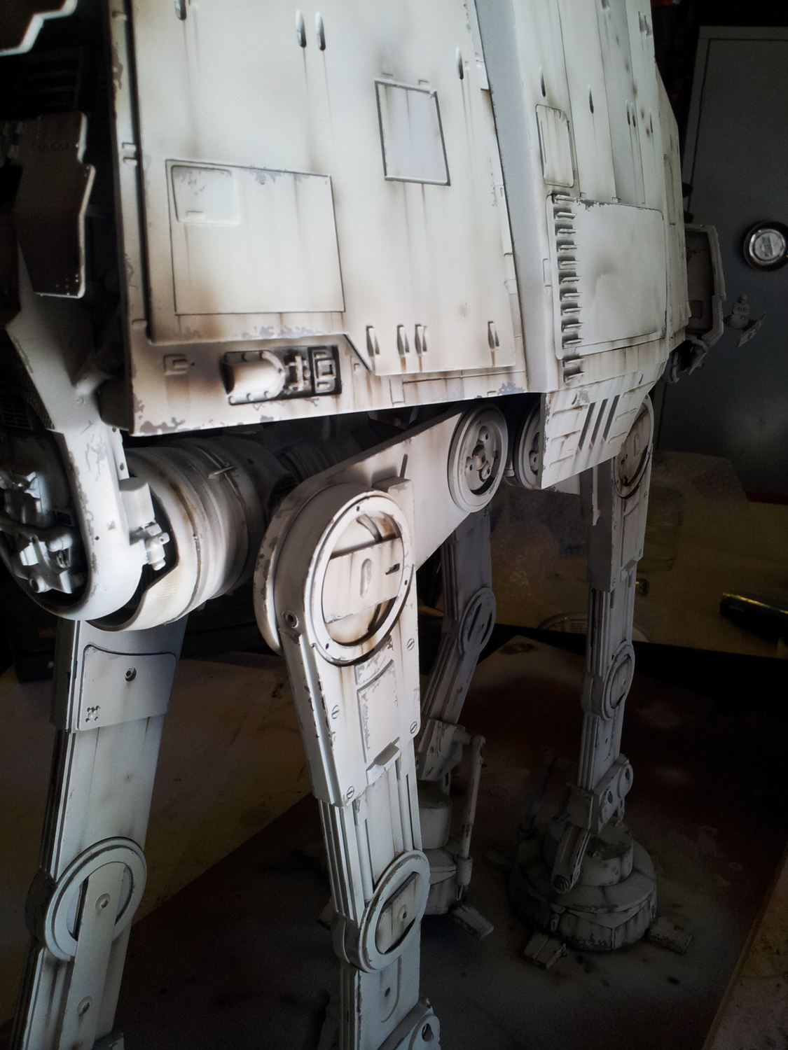

Day 3

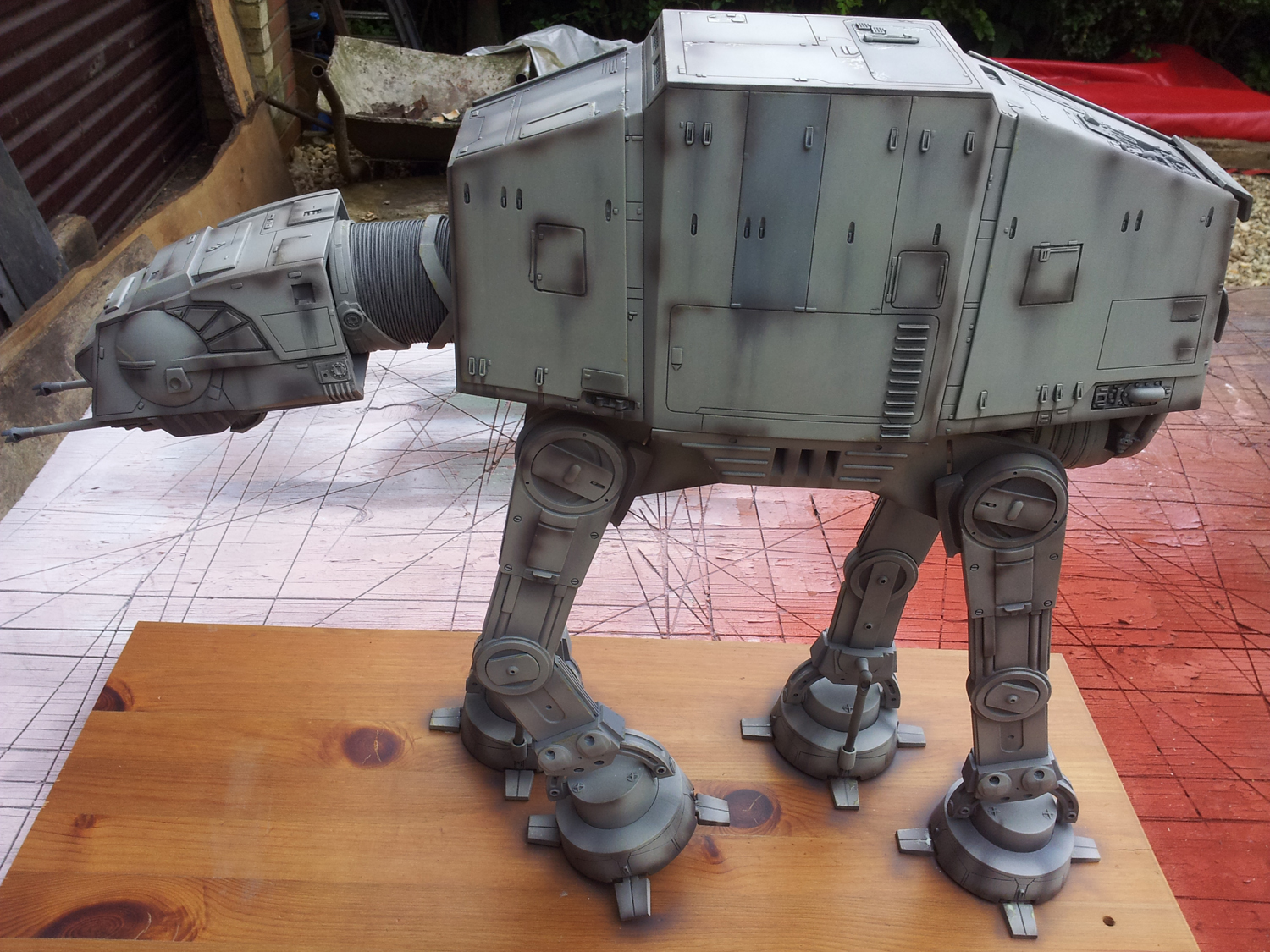

Adding shading and dirt runs to the whole thing started. This is an eyeball stage where im looing for a balance to the whole thing. Following the reference images as uch as I can, but also allowing some licence for additions as this will be a more detailed display model.

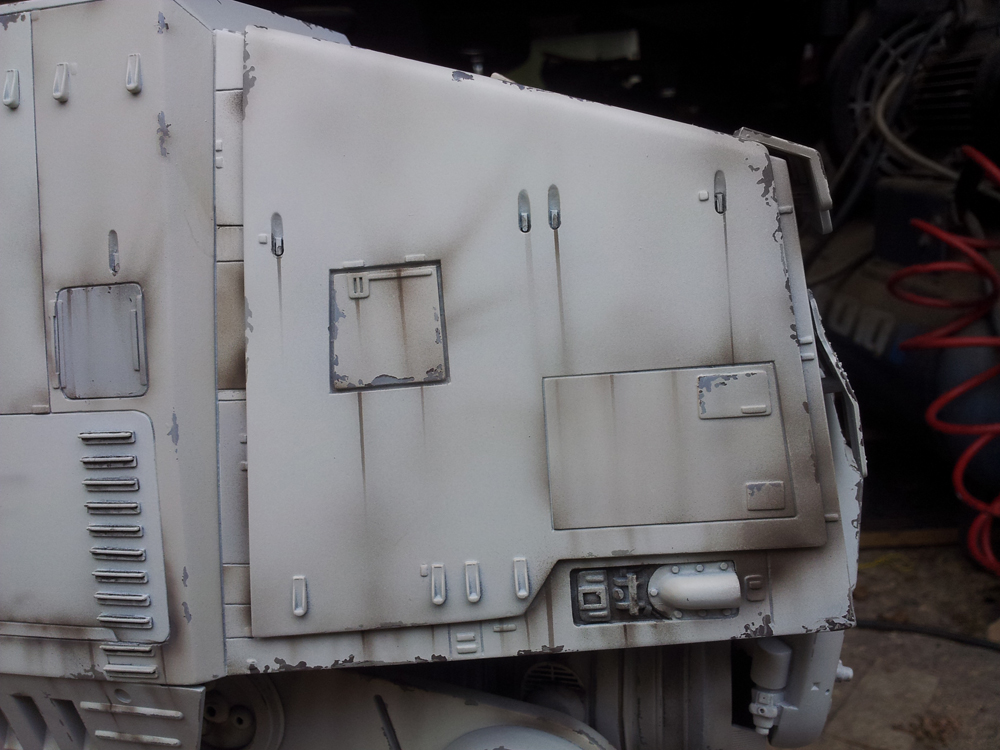

more here now

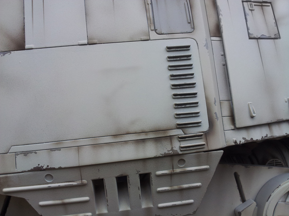

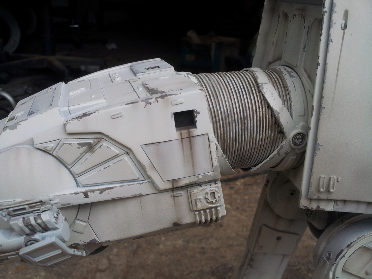

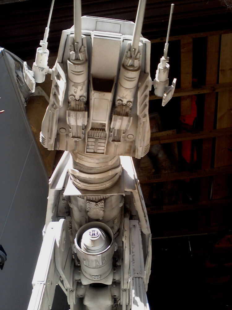

Multiple passes with subtle colour shifts to bring some detail into the flat panels and simulate old washy weathering. More fine detail is going on now with airbrushed streaks and some panel shading, but not to much, as I hate the chequerboard look which can be easy to slip into.
more soon.
IM not sure if they blew it too badly, there are a couple of areas with the wrong greeblies, and I've heard the shape is a little off, but overall I think it one of the better replica versions out there. I've not seen the kit versions, I guess a Salzo one would be closer maybe, but honestly I cant say. Its definitely not offensive to the eye, I would have this dog in my house anyday :).

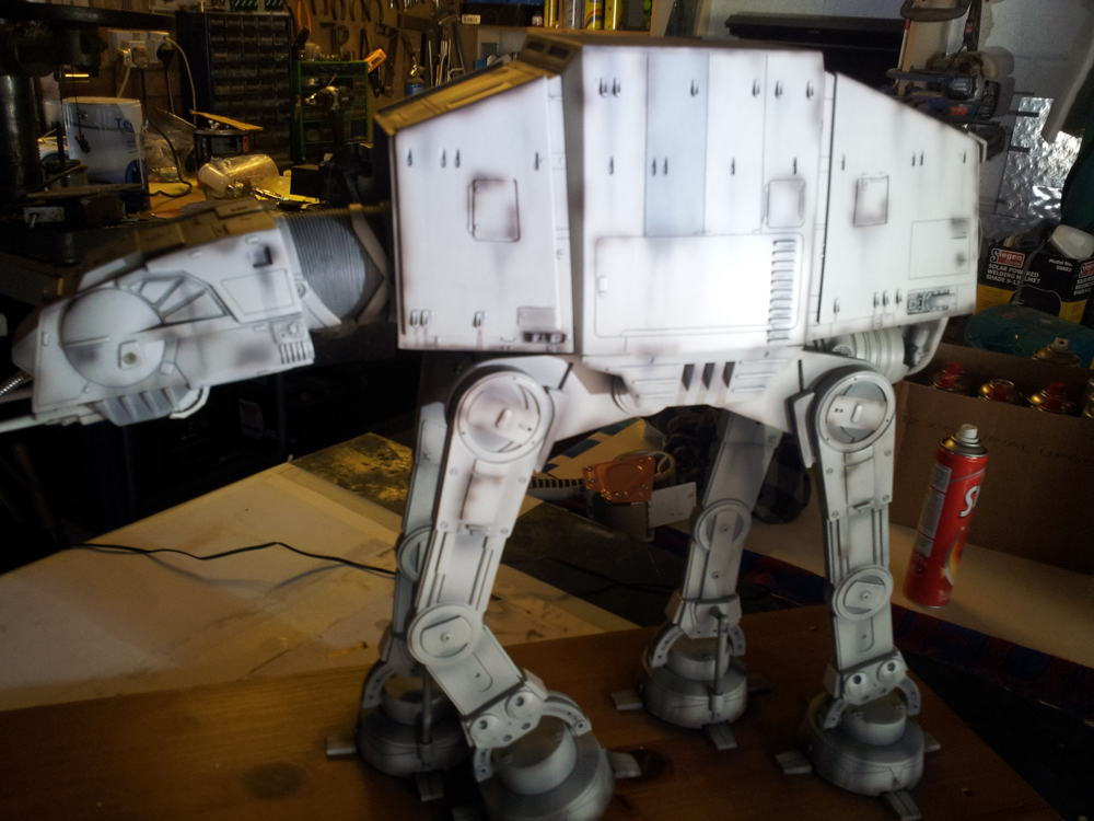

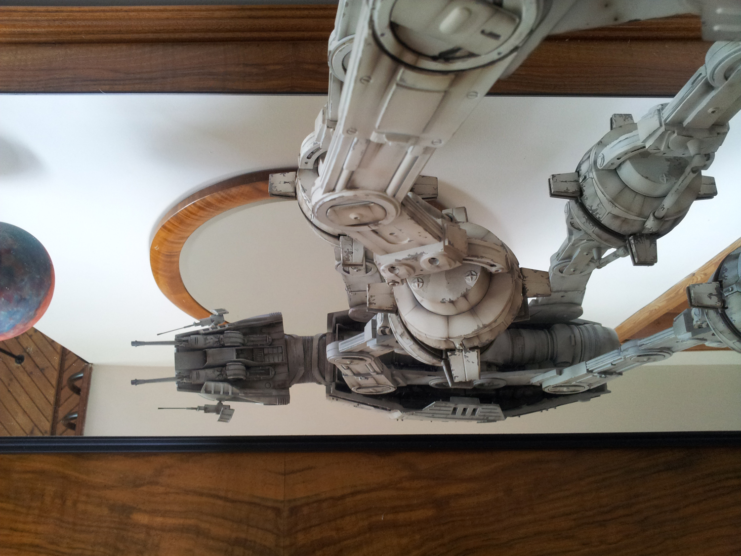

Here are the next images in the painting sequence. More detail going on, some shading now onto the panels to bring it all closer together. Its like a spot the difference challenge !!

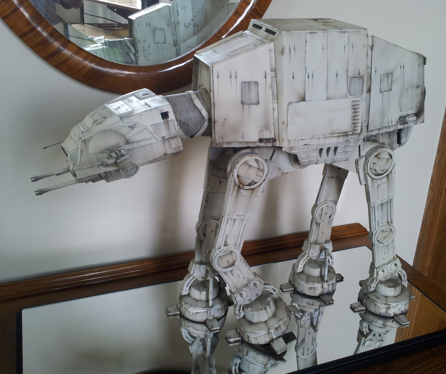

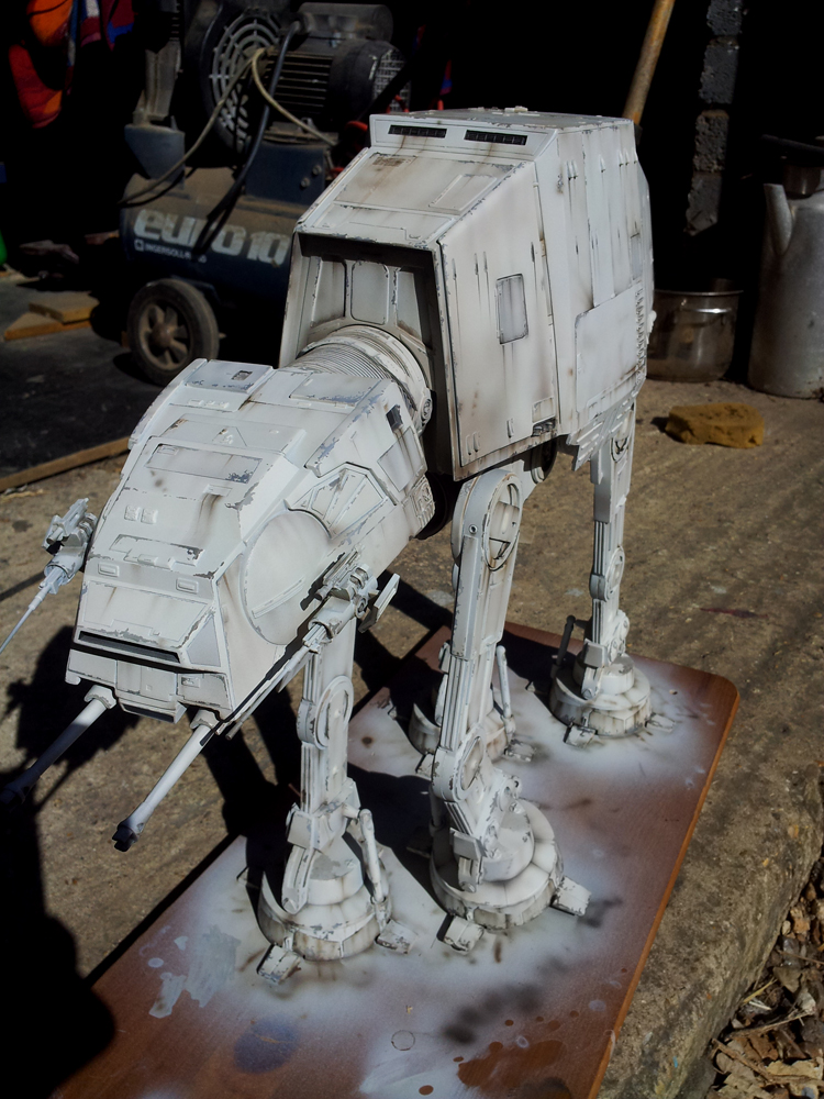

More updates on the re-paint.

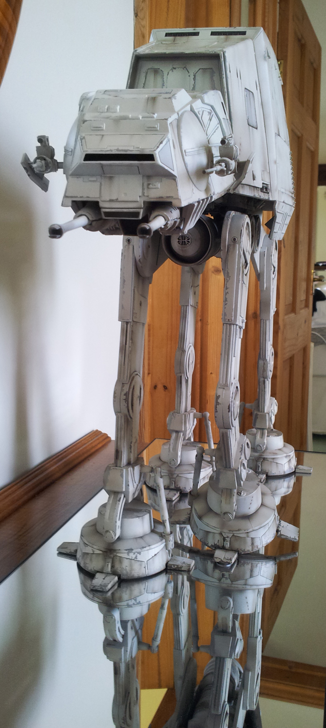

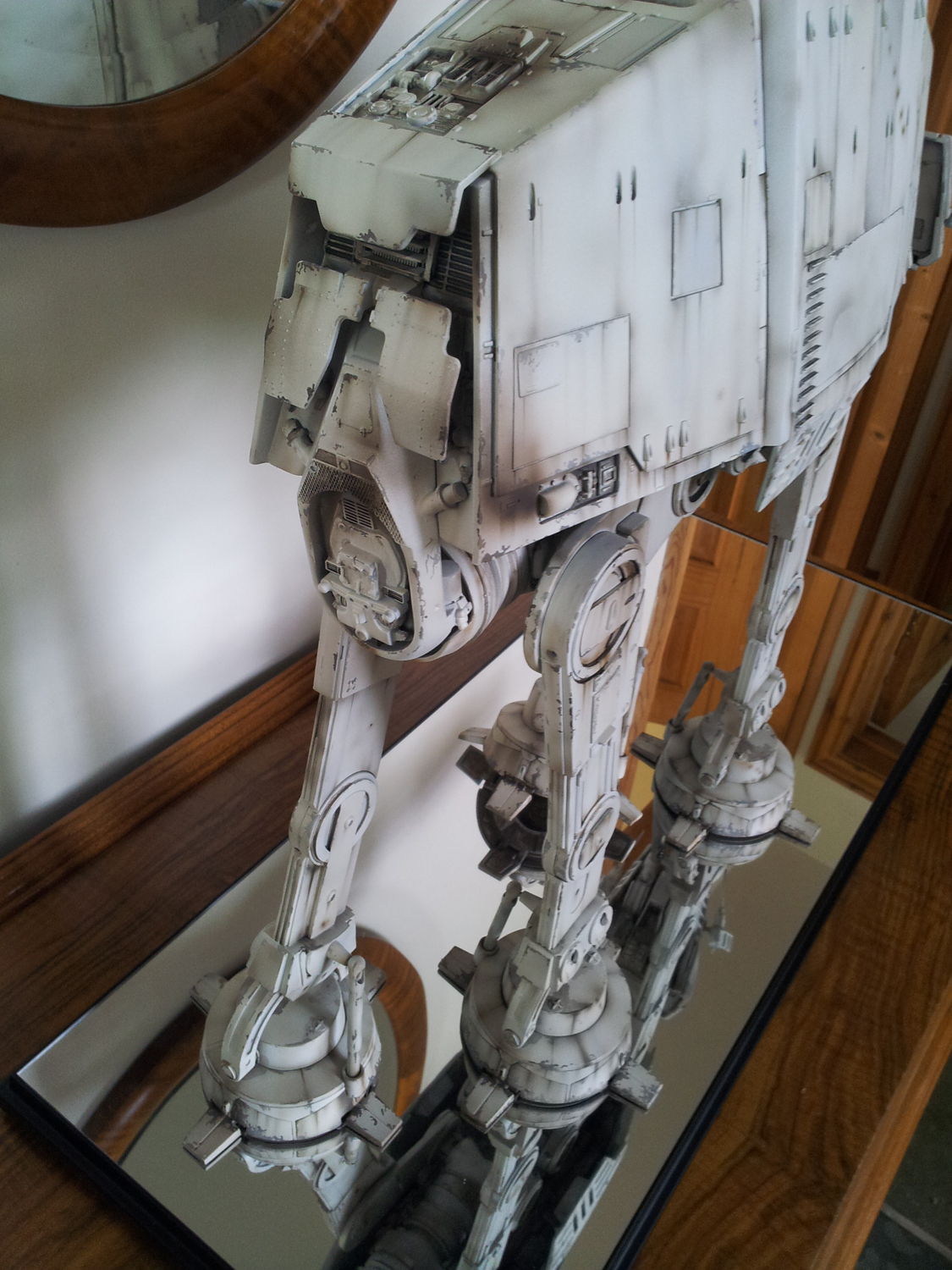

I think I've finished this one, any more would be too much I think. Hope you all like it back on is base again.
