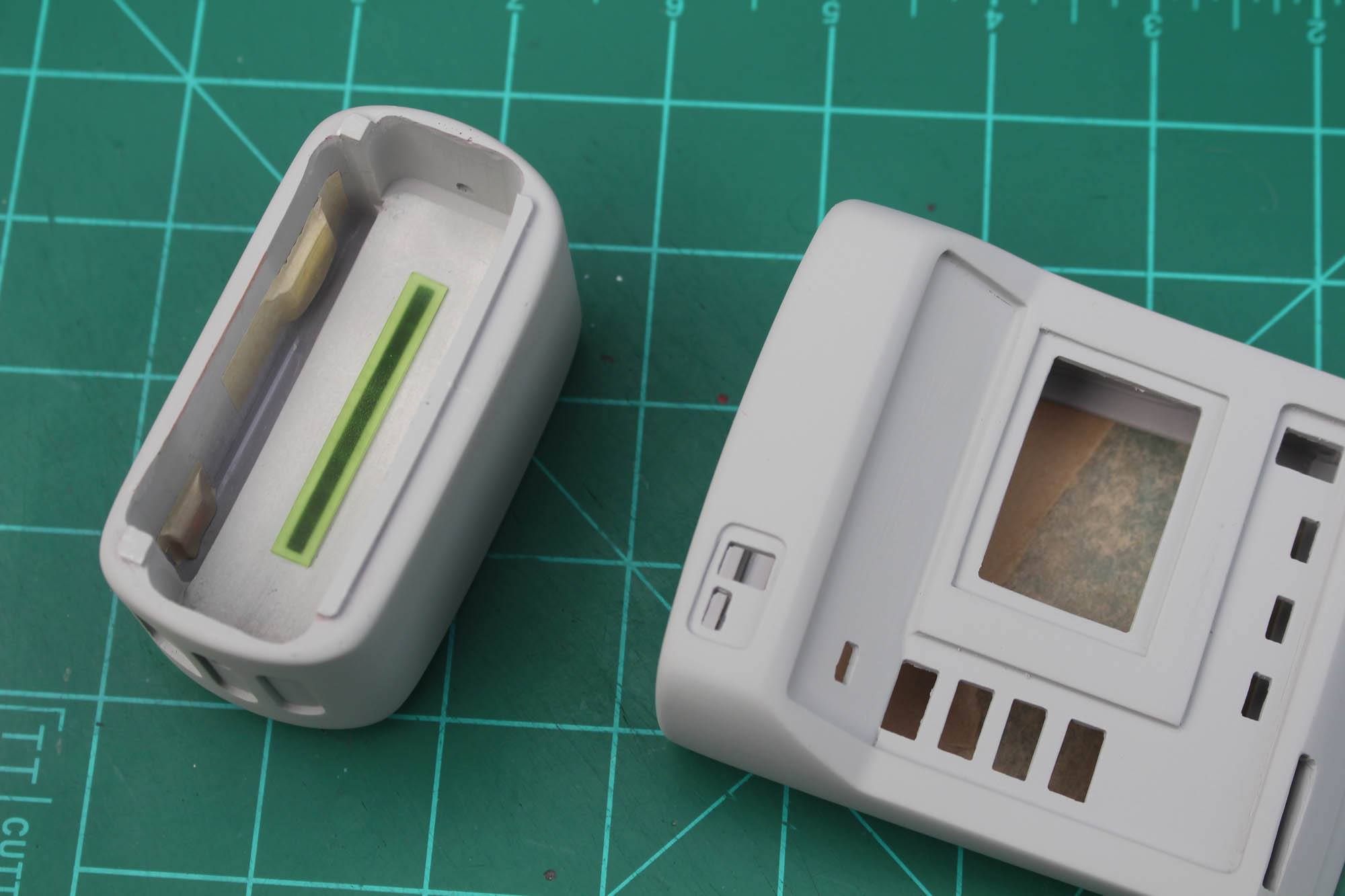

Here is the Mark VII Medical kit from Stapleton Productions.

One of the great things about The RPF is that you can involve so many other talented prop people in the design stages of your project. Fortunately, I have not submitted the electronic CAD files to the circuit board manufacturer yet which means I can still make last minute changes. So suggestions that I receive here at this point can be implemented if it is possible.
In response to the green LEDs on the hand scanner: I am currently using modified scanner electronics from the Mark X Medical tricorder. The scanning LEDs are surface mounted, soldered to the board on their sides. As soon as I get the kit from Myron I will be designing a board specifically to fit his scanner. Even though there is more room inside this scanner body (as compared to the Mark X), it may not be possible to use the 2mm x 5mm rectangular green LEDs since it would make the installation procedure much more difficult. Both the Roddenberry scanner and Myron's scanner come with clear green inserts that can be glued in place before the electronics are installed. This makes it easier to install the electronics module since these "green windows" will be backlit by the green surface mounted LEDs inside. I will look to see if it is somehow possible to mount rectangular LEDs inside the scanner and let you know if it will work.
When I am designing electronics, I no longer try to make the circuit board as "screen accurate" as the tricorder itself. It is more important that the outside looks right since not too many people are going to ever see the insides. So if it is easier to use through-hole LEDs instead of surface mount then I will use them (like the Alpha to Gamma array). Otherwise, I will use surface mount and backlight the clear colored plastic that Myron provides with his kits. Using surface mounted LEDs also makes the installation of the circuit boards much easier, especially for prop builders that are not used to installing electronics in their builds.
The tombstone LEDs in this project are actually backlit clear plastic pieces provided with the kit. Anyone looking at the finished tricorder will not notice the difference. Again, I will look at the body kit that Myron sends me and see if real tombstone LEDs will work better and if the board will be just as easy to install.
I will look into the colors of the surface mounted LEDs as you have suggested. If I can do it I will use the correct colors wherever possible. But I am limited by budget and the choices available by my suppliers.

I have to respectfully disagree that there is no visual difference from the outside. The kit's lenses look very nice in a static build, but when backlit, while they still look good, it is difficult to make them have an entirely accurate look. For example, this science tricorder with surface mount LEDs with kit lens at top, and the other two are originals with through-hole LEDs:
So the outside appearance of the prop can certainly be affected by substituting surface mount for traditional LEDs. If it's possible at all to use the traditional LEDs that would be my desire particularly since you nailed that part on the Roddenberry version :)
But yes if there is no room for traditional LEDs in the tricorder body then there's no option other than cast lenses and surface mount, and that's that. It will still look nice either way :)

Okay, those are very valid arguments. Light bleed between LEDs is a huge thorn in my side when I design these electronics. Even the original hero versions suffered from this problem. Clear light definitions are always more visually appealing than light bleed. But from a design perspective it is something that is very difficult to avoid. In many cases I have designed my circuits with through-hole LEDs that work very well and do not require any masking or "gasketing"; however, when it came to installing the boards, the through-hole LEDs made it more difficult due to space limitations. On the other hand, as Ethan mentioned, boards utilizing low profile surface mounted LEDs are not always easy to align to backlight their plastic inserts.
As far as the Mark VII Medical electronics go, I will do my best to accommodate the best of both lighting methods mentioned. The main board around the viewscreen will still be identical to the Mark VII Science version, with all through-hole LEDs being used. The door board will utilize a surface mounted LED to backlight the EMRG button. But I will have to carefully consider the LEDs I will use for the medical extension; if it is possible to use through hole LEDs then I will do so. But space is very limited and I may be forced to use surface mounts backlighting Myron's colored clear greeblies. Thanks for the feedback guys.
