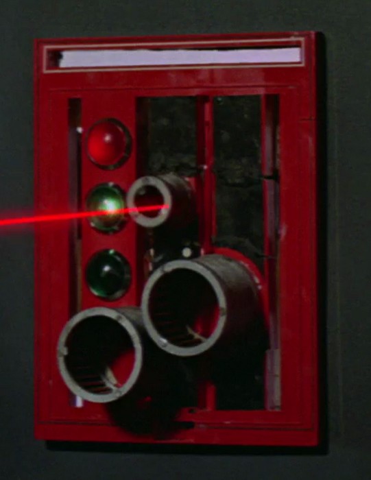

See the lights on top of the Detention Center Camera Pods?
They were used in many places in the films and I've long wanted to make them, and they are finally done.

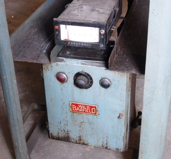

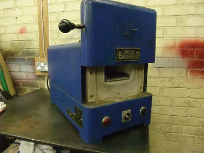

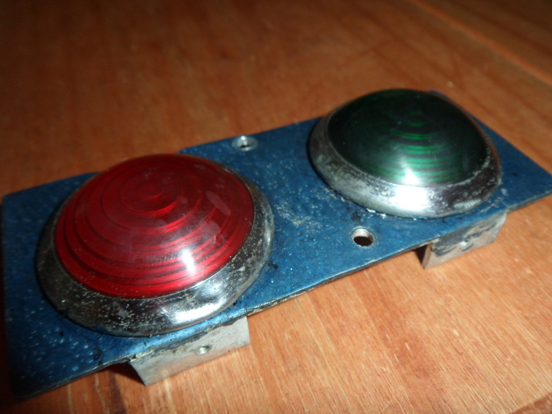

Along the way Andy managed to track down two of the actual lights, the mounting ring, bezel and lenses. Not the actual illumination, though that was likely an incandescent bulb. So far as I know these are the only two originals ever found. They were particularly used on Wild Barfield furnaces.

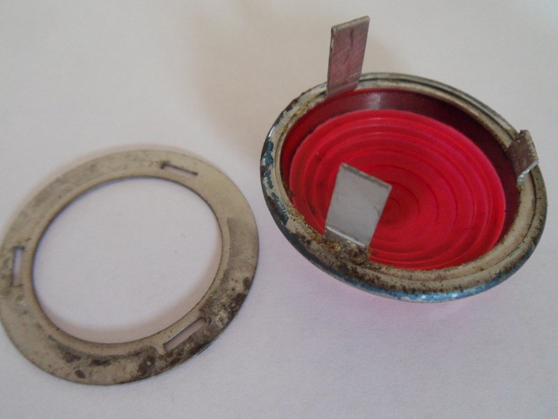

Here are photos of the lights Andy found.
And here's a photo showing how the original incandescent bulb was positioned.

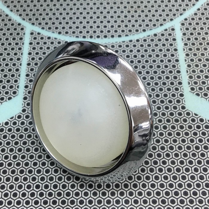

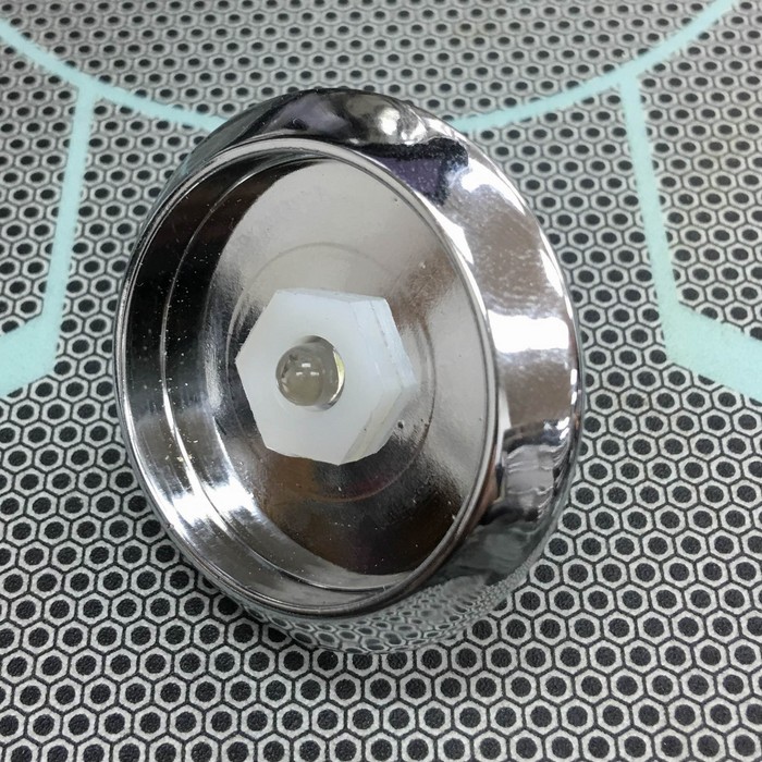

Here's what we came up with:

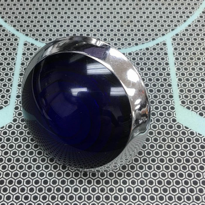

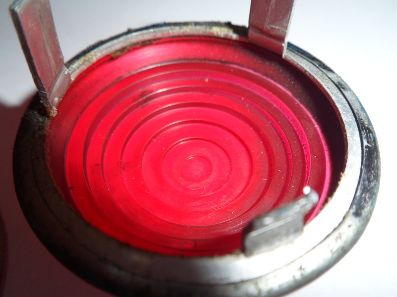

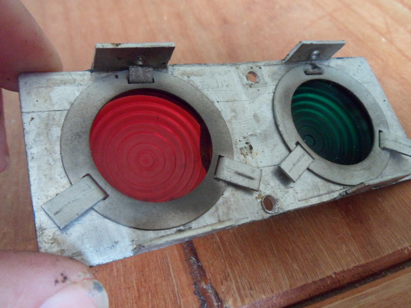

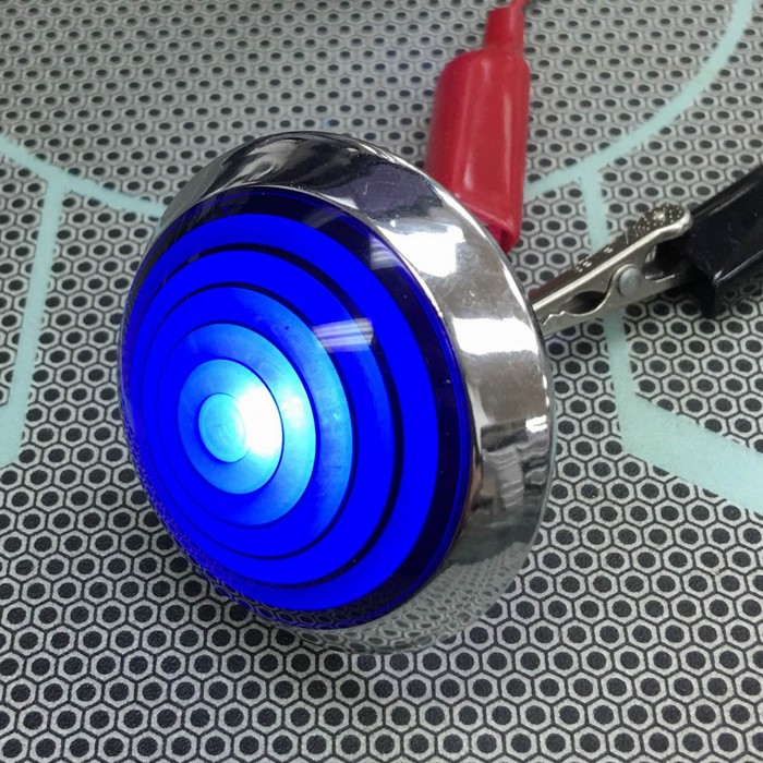

The complete light has a nylon bolt, which is precision CNC drilled and milled to accept a 5mm LED with the wire through the bolt. The head is shortened to allow the installation of the 3d printed diffusor. The bezel is vac-metalized chrome and the lens is a clear material that is tinted either red, blue, green, yellow or white. All colors seen in the film.
For the Detention Center Cameras, you don't need the illumination or diffuser, so they will have just a nylon bolt and nut, bezel and lens. Or you can supply your own 5/16-18 bolt and nut.
We also have available cold cast metalized bezels you can buff to a very nice metallic sheen and unpainted bezels so you can have a light as inexpensively as possible.
Because the process of casting the lens is difficult, some lenses have a small single bubble in them and we have them at a discount,These may be perfect for slide viewers since they aren't lit anyway.
