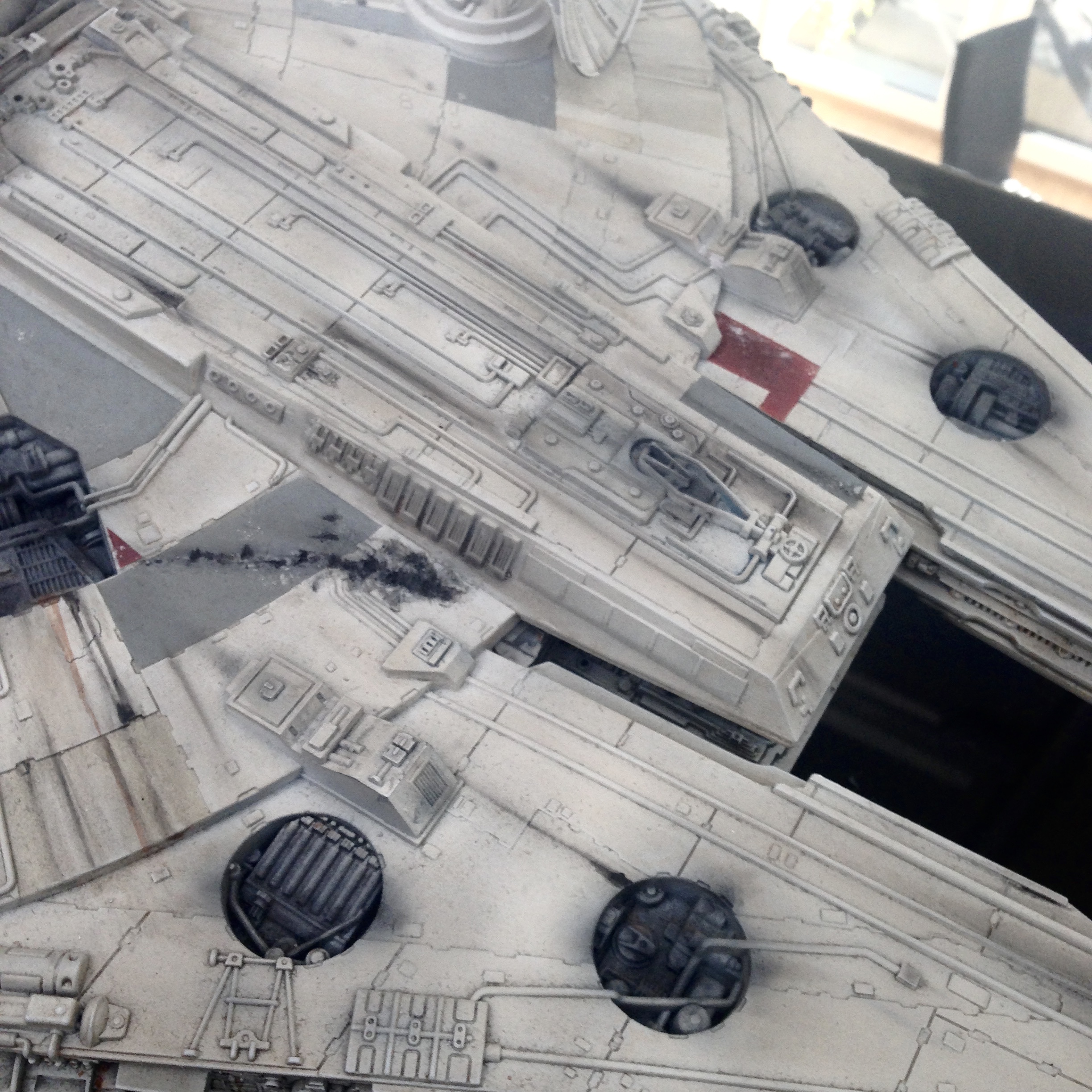

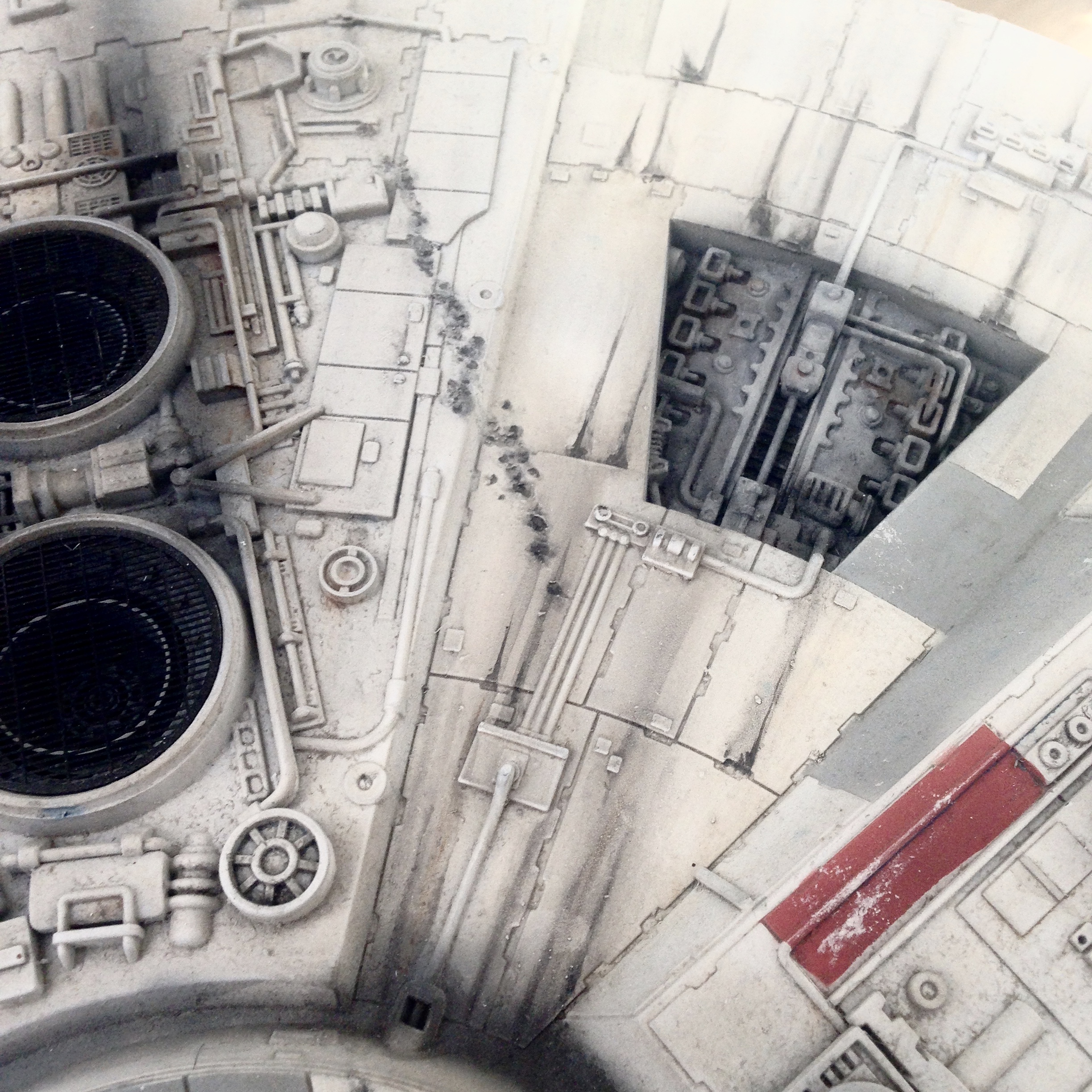

Sooo I'm almost ready for streaking. I just have some light spot oil washing to do. And some darkening here and there. (I'm going to do a lot of spatter at the end to supply a lot of the texturing.)
This build uses the shapeways cockpit and radar dish. As well as the greenstrawberry engine vents
My last 1/144 falcon was WAY too heavy on the oils. I tried to lightly differentiate between panels and although that may work on a 1/72....at the scale it looked like a quilt. (This is why I'm going for subtlety on this one. Going for clean layers that build to something. ) For this one I just used oils for the streaking
The first falcon I did, I used gundam markers. Oddly, they seemed to be scaled the best. But I can't seem to find pics of that one. Besides....it was an awful model.
Anyway, the point of this is that the streaks either make it or break it for me. What techniques did you use? And were you happy with the results?

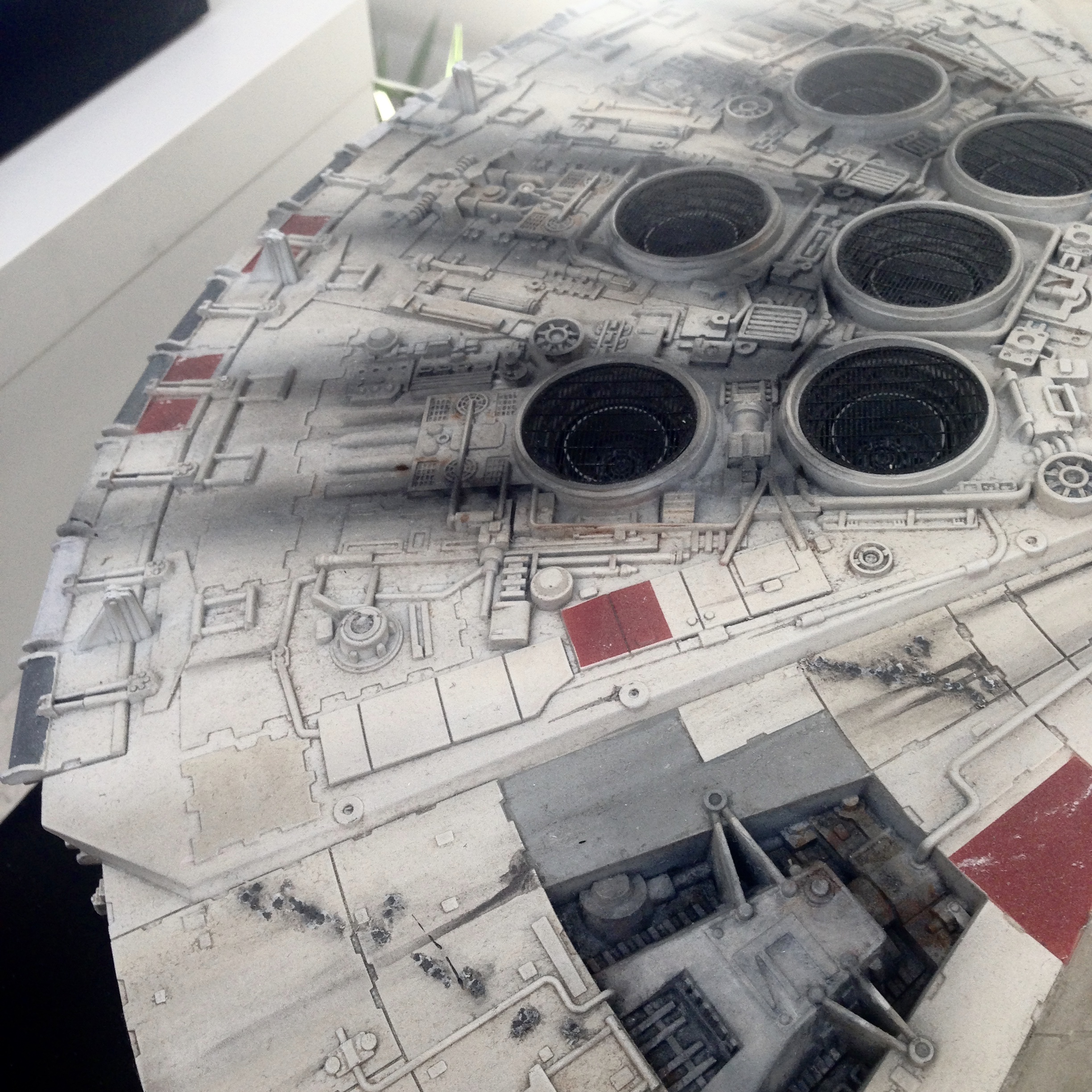

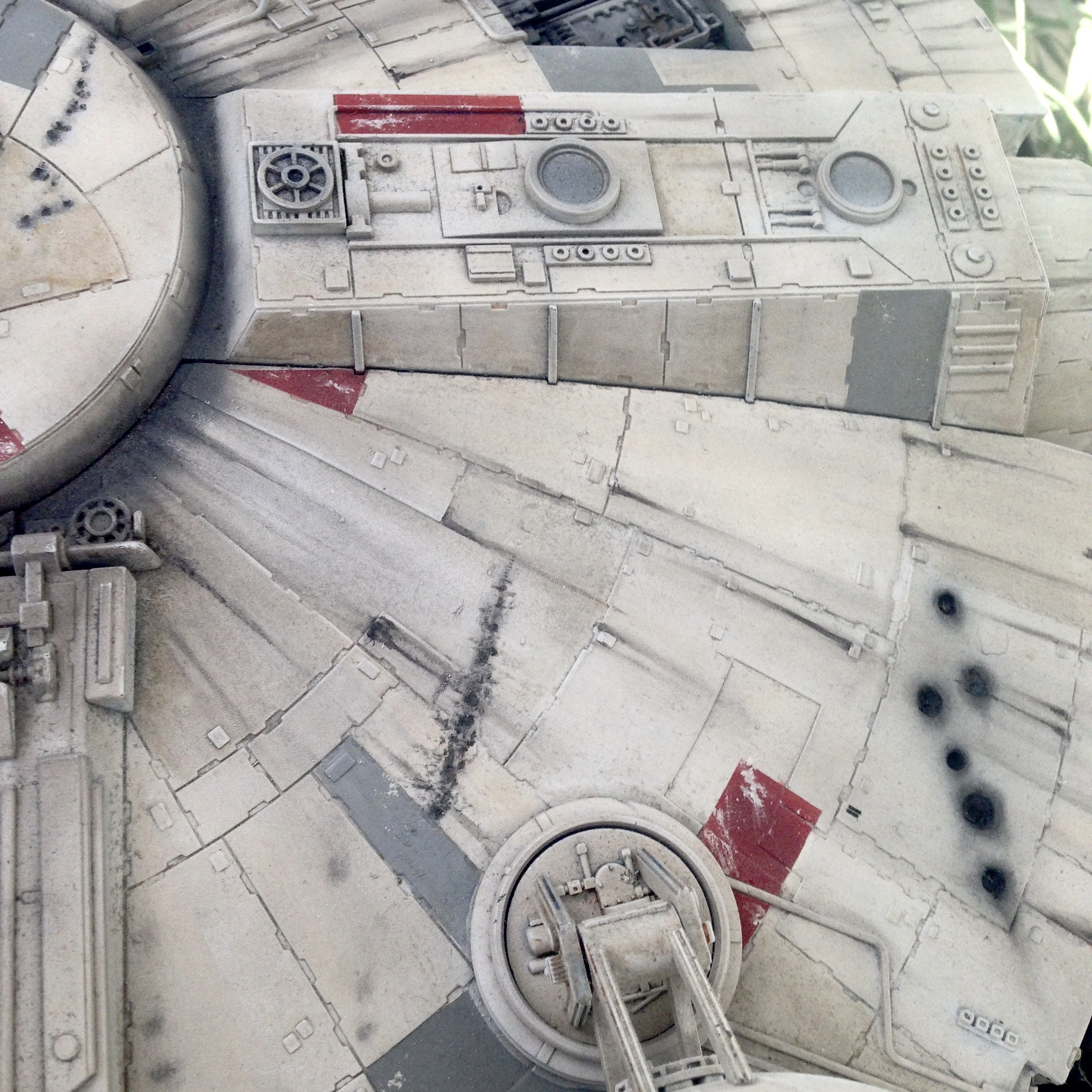

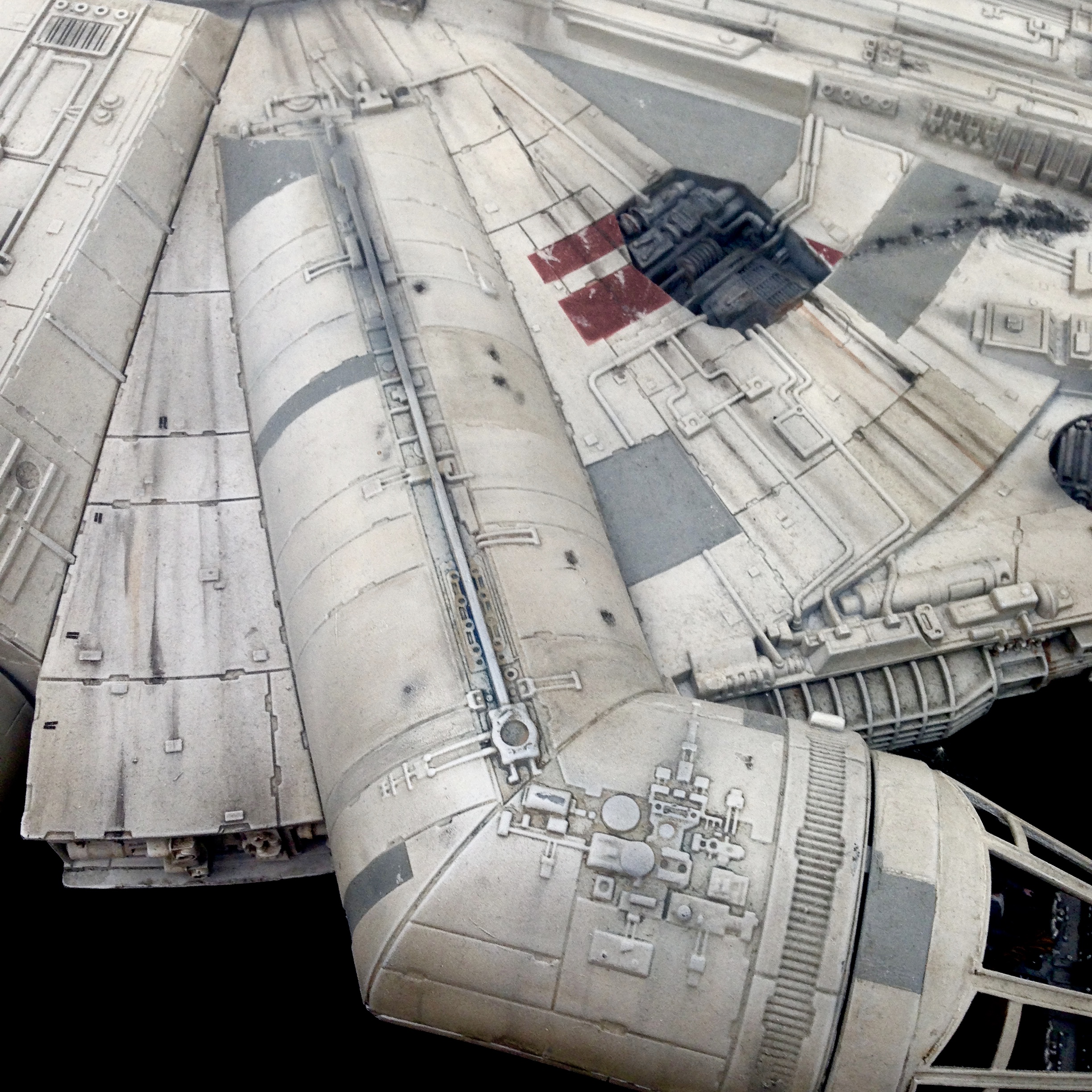

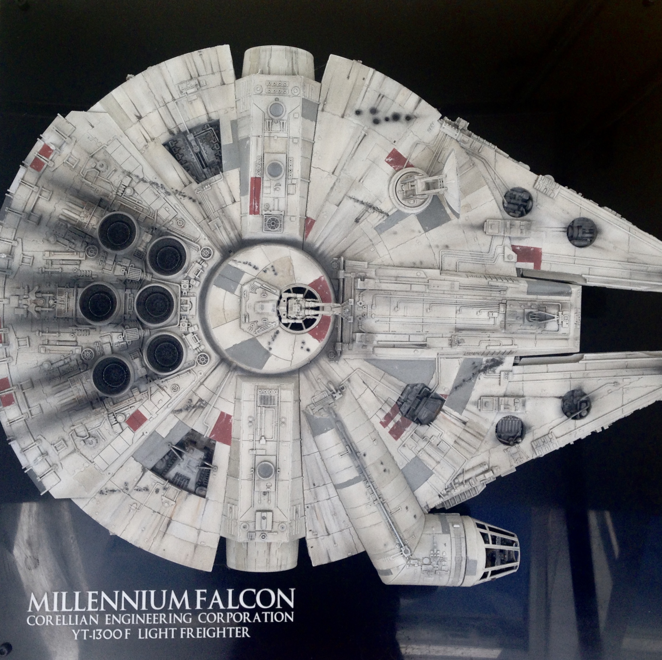

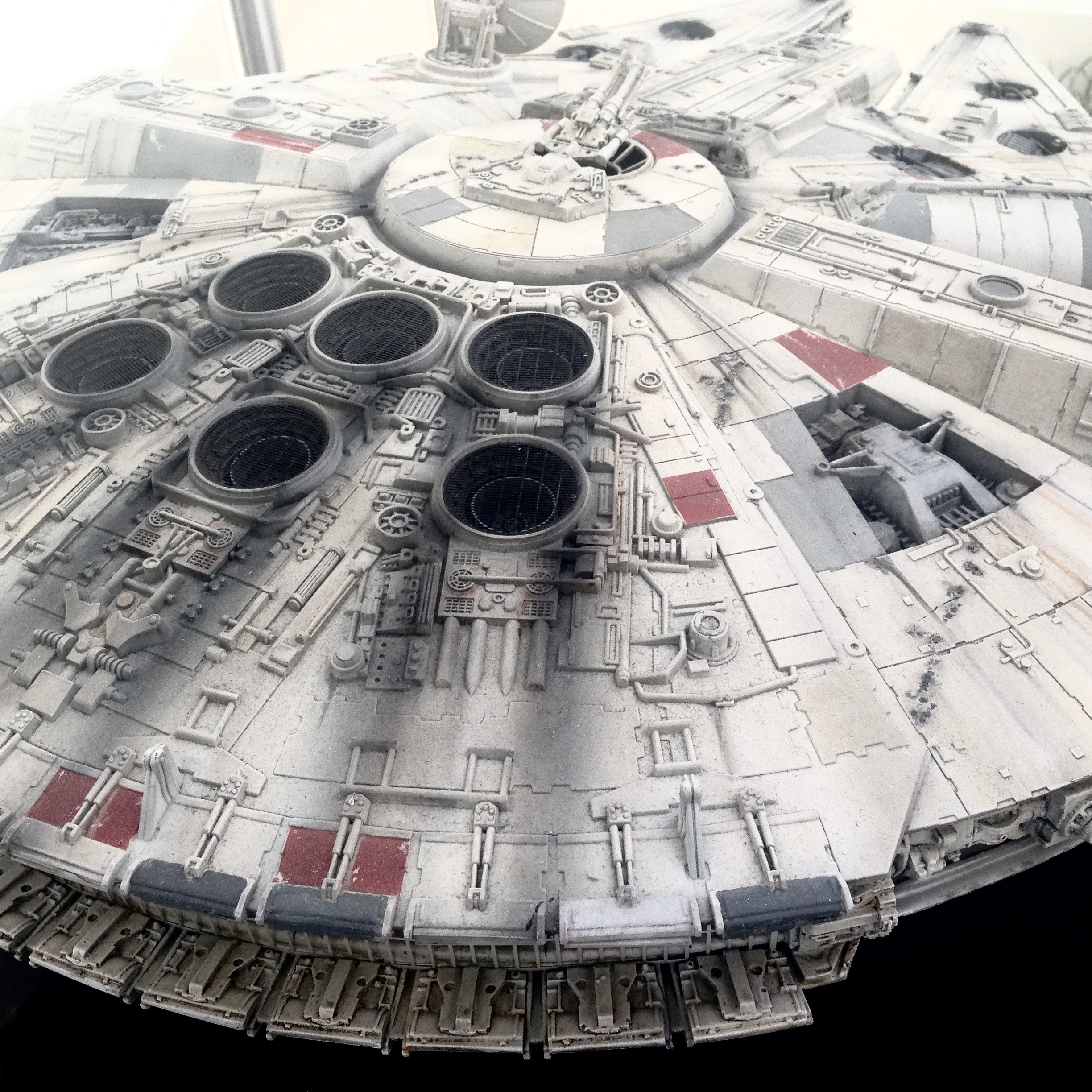

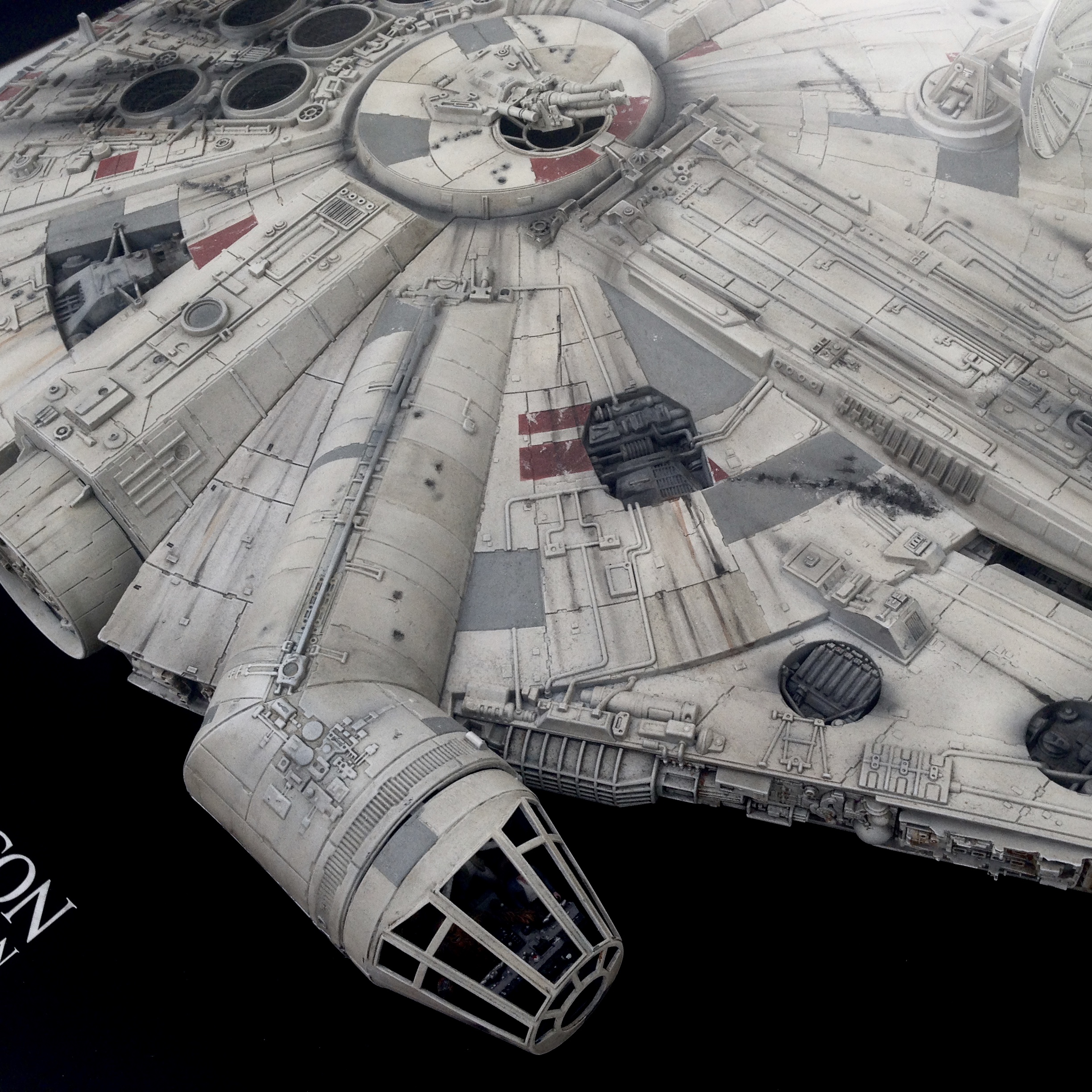

I used pastels and oils. Oils mostly for staining/filtering the colors
Pastels for most of the lighter streaks but a few oil streaks here and there for the more saturated streaking
I did a few coats, and would seal in between pastel coats
I also found going back over certain areas with a lighter pastel helped give it that faded look in many areas as well.
I thinks it's a pretty iterative process. You have to start with very light weathering and just slowly build up layers making sure not to go too far the other way. It's a fine line
For mine I might have went to subtle, especially around the engine vents
You can see how the lighting changes the effects with the difference between the brighter side and shadier side
