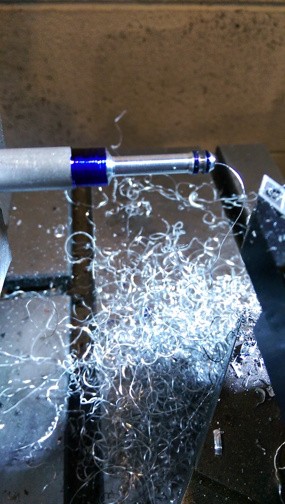

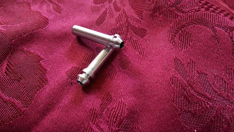

My wife asked: "Why did he turned those in metal?" My answer: "Because he can!";) Those canons will be a very nice detail for sure!
Your answer is right. :D But the main reason for turning them was to add a little more detail to the cannon bay area while keeping them functional. By functional I mean rifle drilled for lighting and front tip designed to accept the 5mm led plastic holder without needing to use glue.

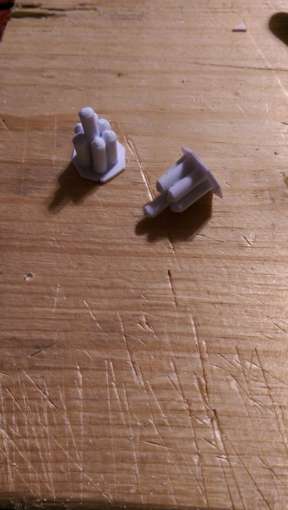

On a side note. I managed to make the two upper cockpit sensors
Thank you for the kind comments guys.

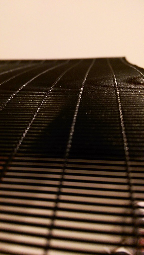

WTF...Where you got that!...is it the original or the newer stuff (looks sort a sameish) :)
Yes that's the original koolshade.
I got the Koolshade from Mark at ( The Solar Shade Screen Company ) here in the US. Mark is supper cool and nice guy. I believe he is a member of the forum. but I don't remember his user name. PM me if you need his email
Sweet!!! I got a Hasbro Tie Interseptor stashed away in the basement just waiting for it :)
At the mo I got way to many projects in the loop so the Tie will probably not see the light of day until mid 2017 or so :p. Will finish the Slave and then I got a Anigrand SD + a studio scale X-Wing that I really want to start. I will get back to you on the Coolshade for sure. That stuff will bring your model to the next level! When I built my Hasbro Tie I was to involved trying to get the cockpit right..forgot to look in to getting Coolshade for that build, so I will get it right next time.
Now, was Coolshade actually used on the Interceptor? I was under the impression that the wings on that one were textured with fluorescent light diffuser panels, not Coolshade.
Not to call into question the cool factor of the Coolshade. Great find.
--Alex
--Alex
I believe koolshade was used on both ties, the difference was that on the interceptor was only used on the back of the solar reactor and on the tie fighter was used on the wings and solar reactor.
