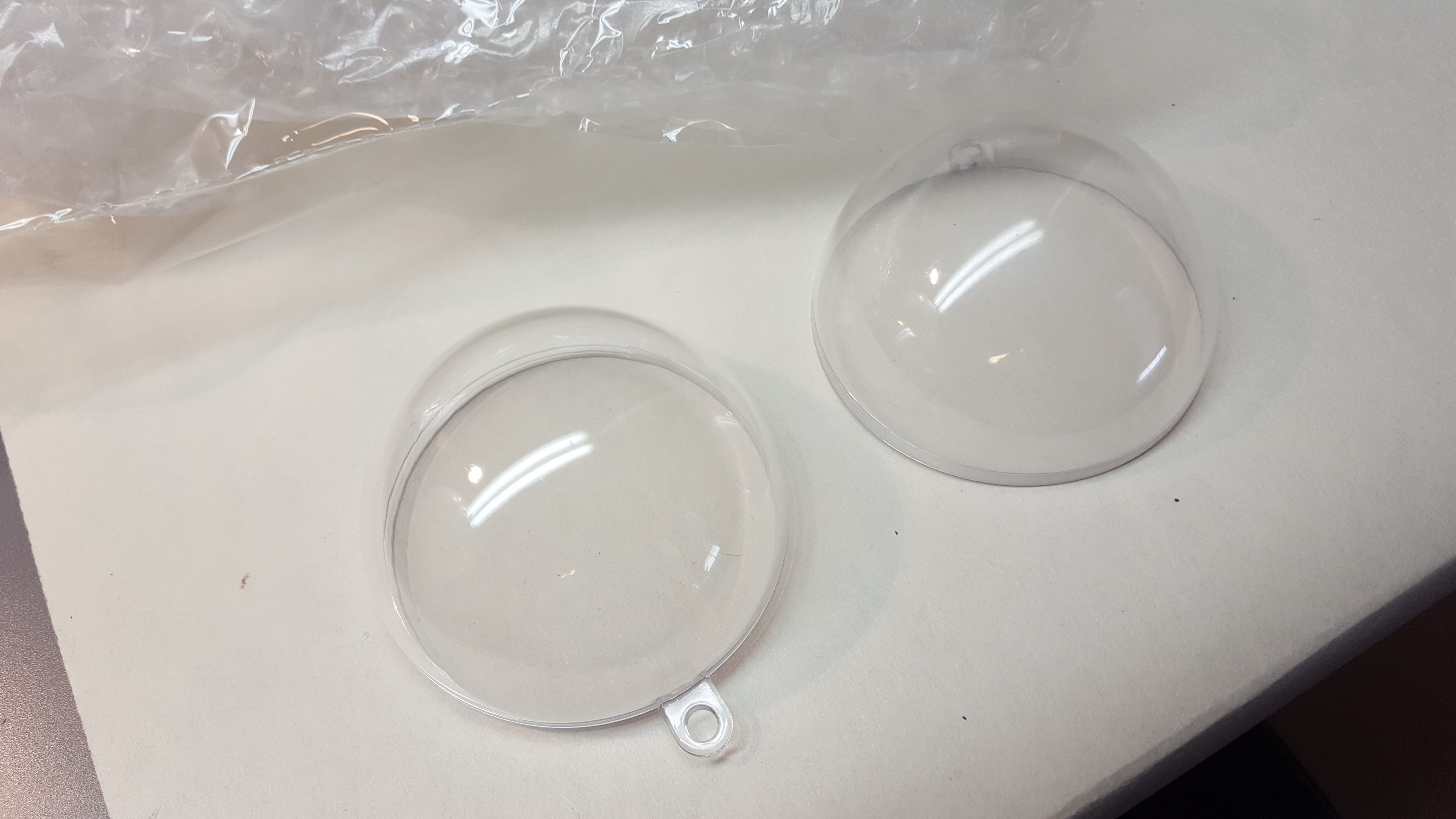

Using 2 polycarbonate spheres (Head: 300mm and Body: 500mm) made quick work of body fabrication. You can also choose to use paper mache over a ball or 3D print your body, but you can't beat the spheres for speed and simplification.

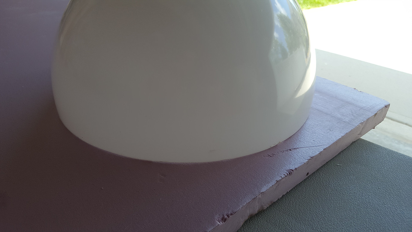

Step 4:

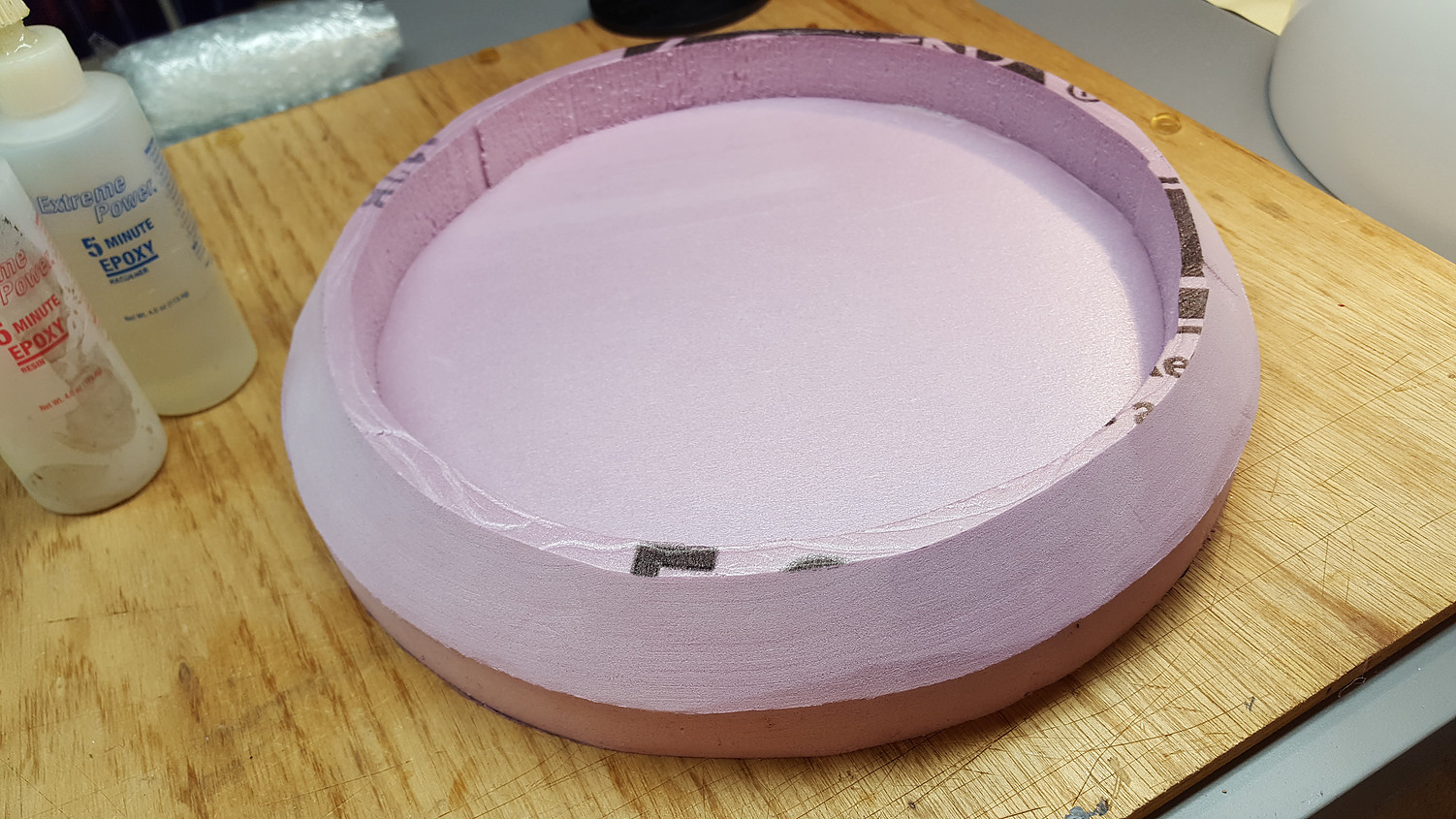

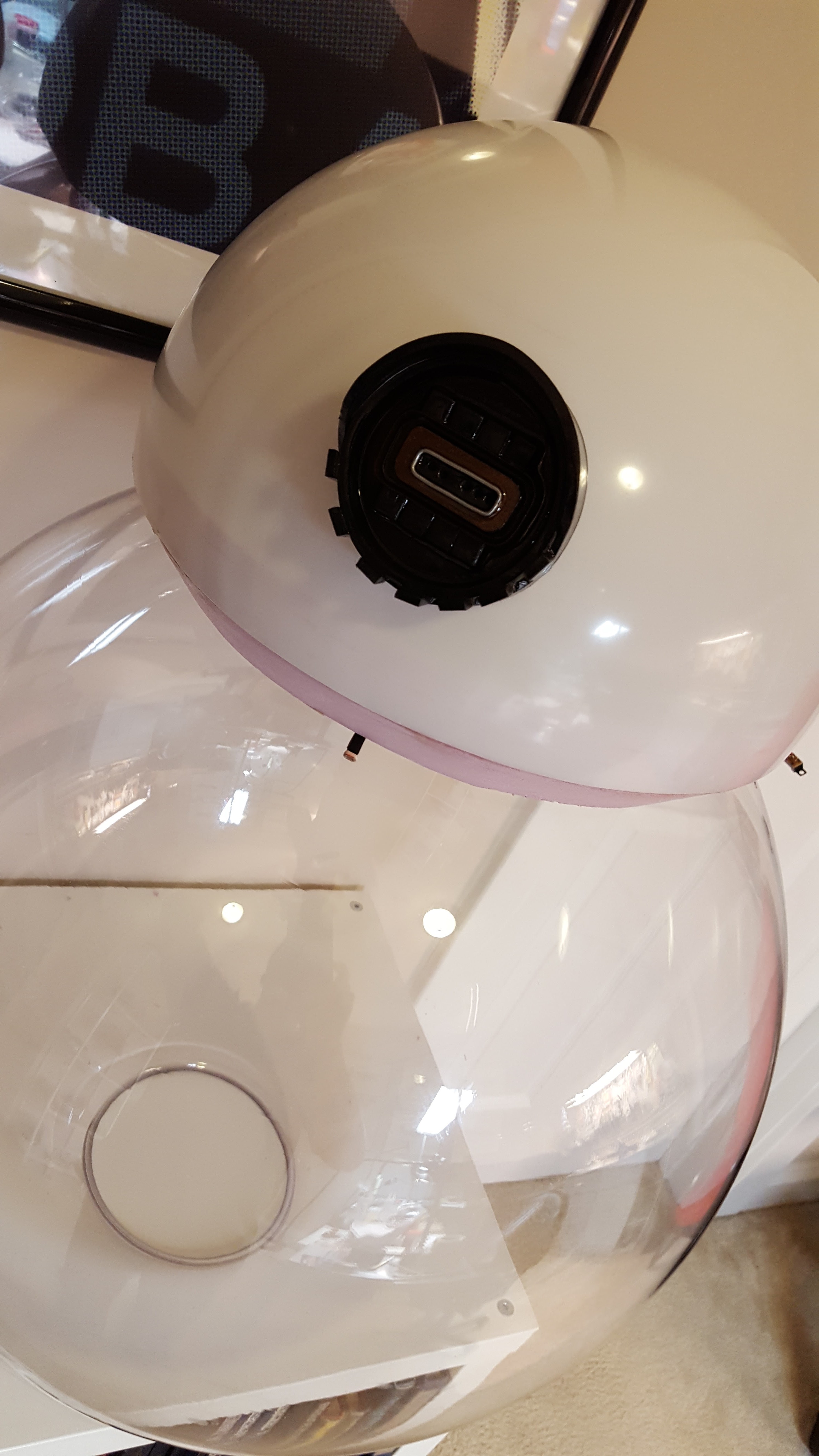

Using pink foam from the hardware store, the beveled bottom of the head can be trimmed to size. Use two layers, one to fit snug in the head and another to be beveled.
Re: BB-8 Build (Non-Rolling) - Star Wars Dark Side of the Force Halloween
Coating the entire surface of foam in 2-part epoxy quickly seals it for painting.
We're now starting to take the shape of BB-8! The body and head have been spray painted satin white in order to match. If you look closely at the movie stills, BB-8 is actually more of an ivory color than true white. However, it's easier to achieve that shade during the weathering process than matching it in spray paint cans.

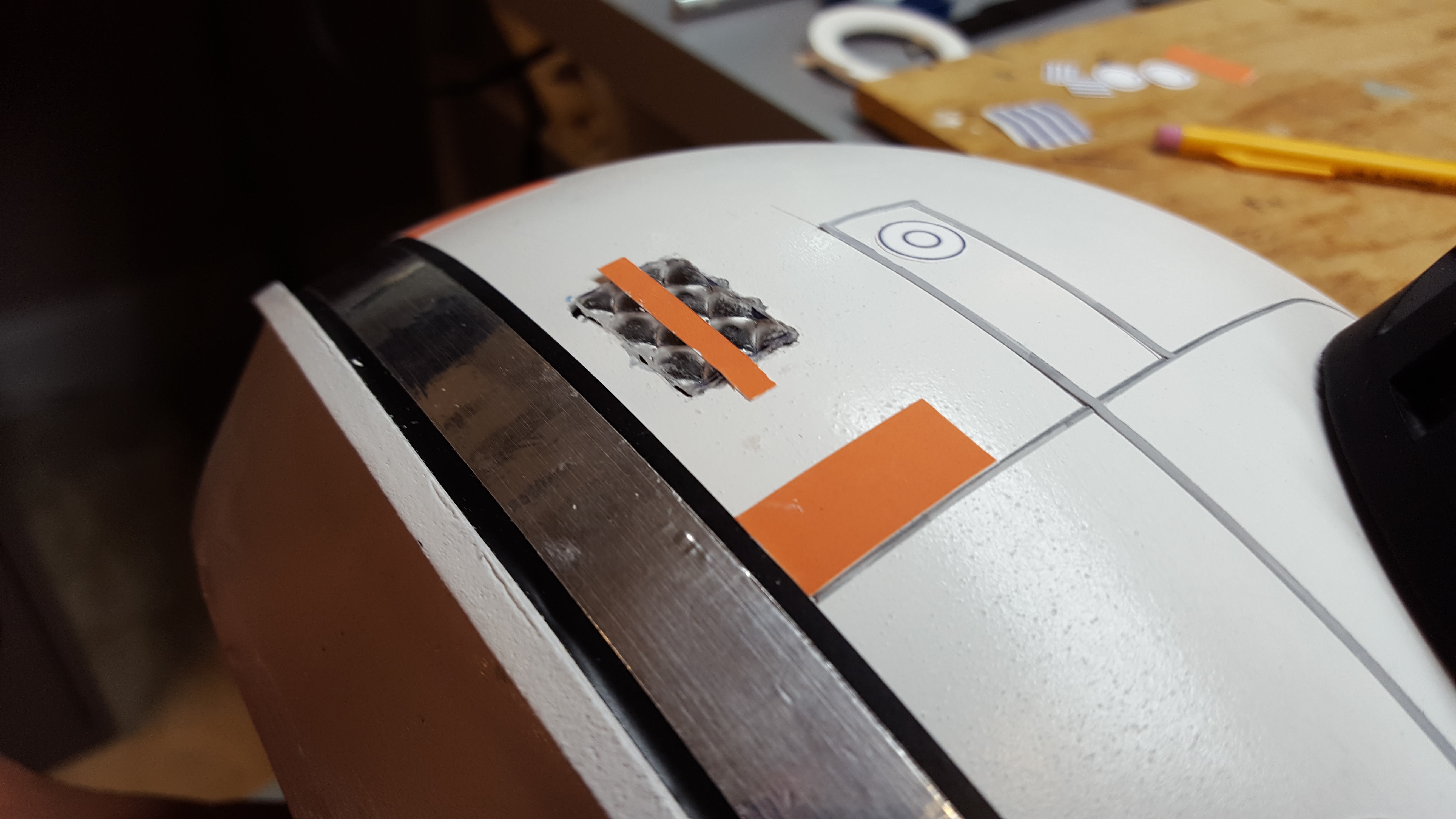

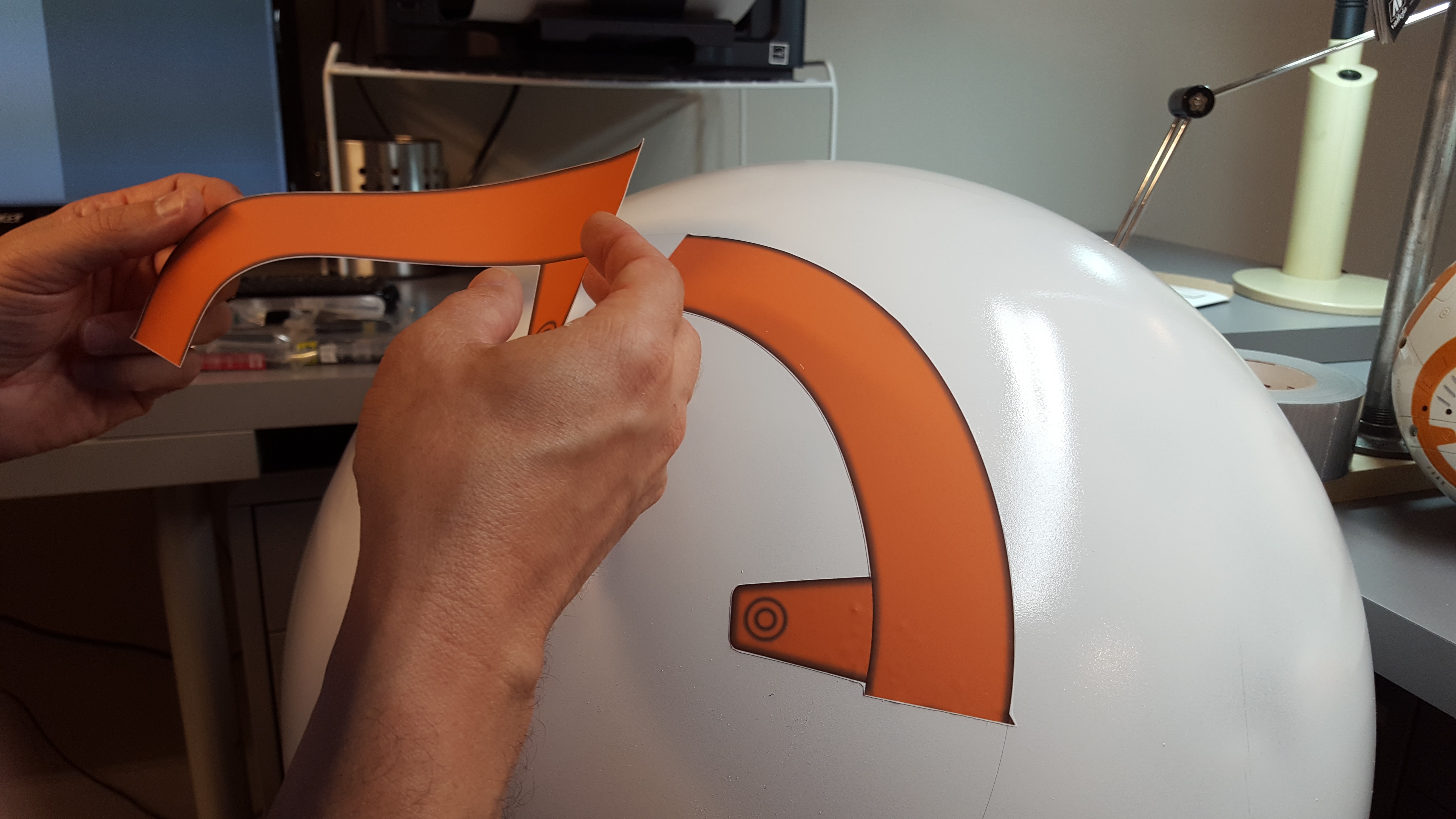

[h=3]Step 7:[/h]I considered drawing and masking off templates to pain the colored graphics, however, it proved much faster to draw effects on the computer using Photoshop and then printing them on 8.5"x11" vinyl sheets.
While measuring each orange circle pattern (6 in total), a compass can help lightly score an outline circle to help align the stickers. Simply trim the graphics out of the sheet and carefully apply them.

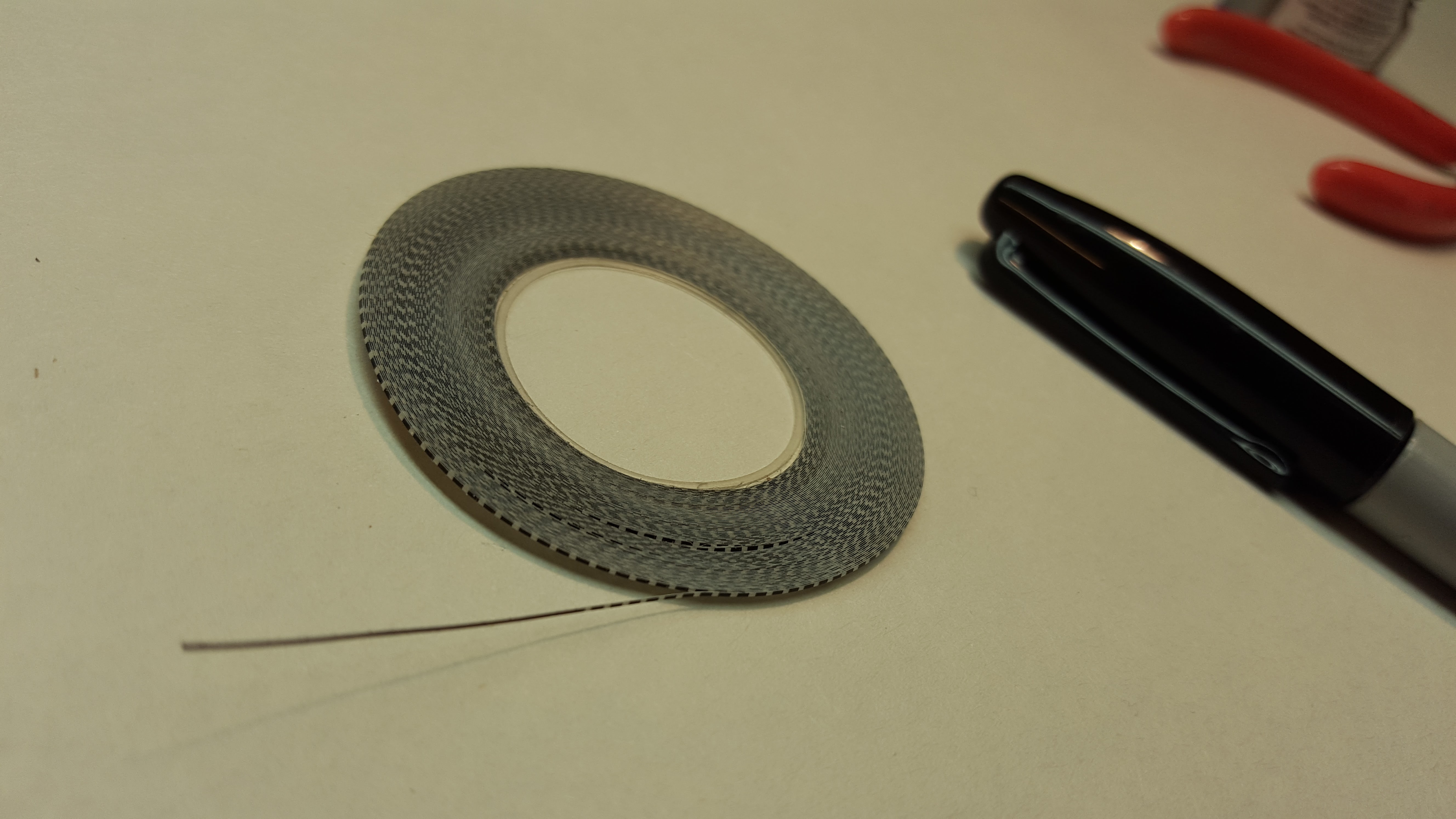

Chartpak tape (1/32 or 1/64 thickness) helps make clean straight lines around the body and head. This tape can also work well to make smooth curves as well.
The chrome strip line around the head is started with black electrical tape.
A strip of aluminum tape (trimmed shorter than the black electrical tape) is then wrapped around on top.

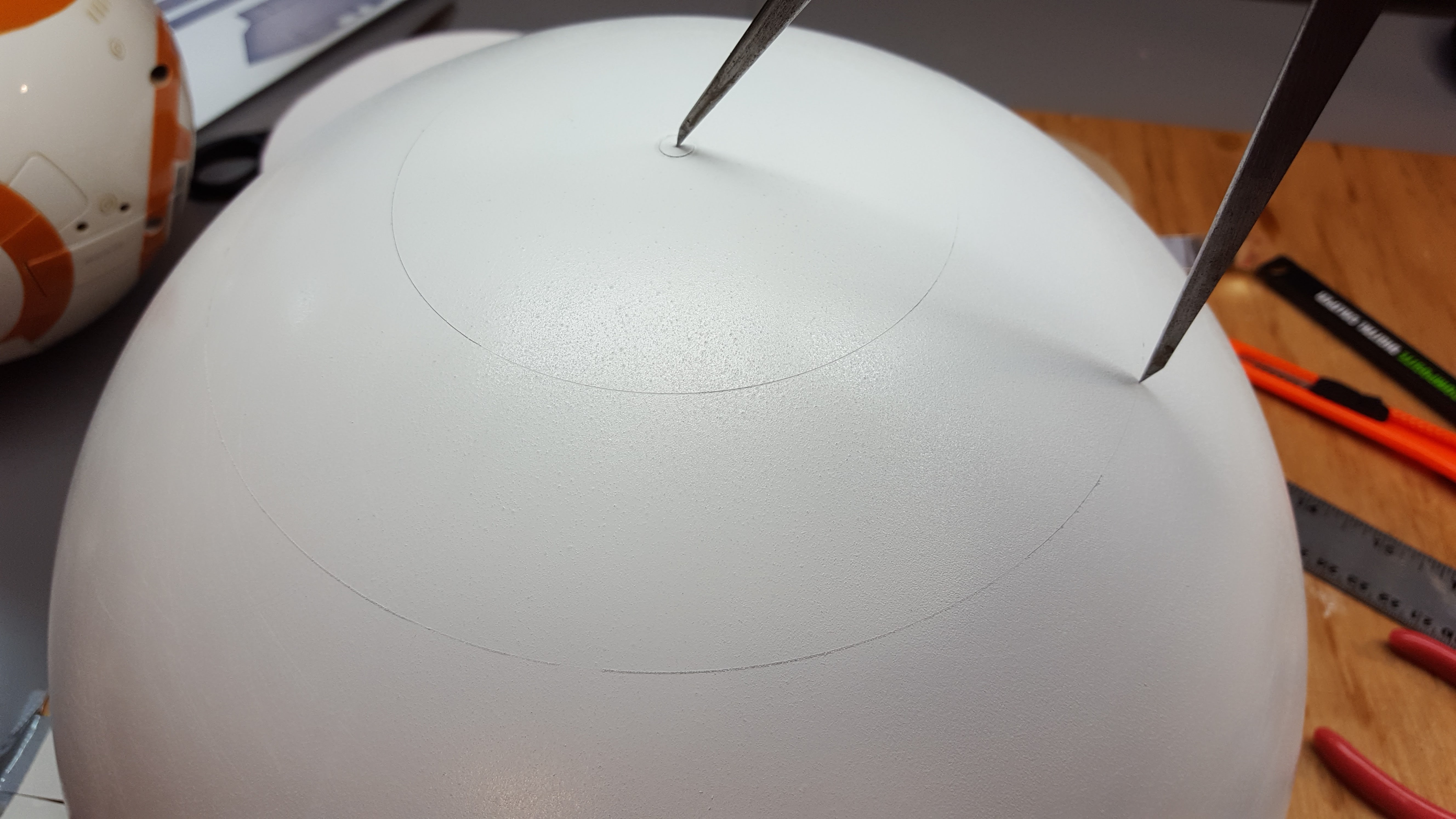

The top of the head is measured out and a compass is used to score two circles where the aluminum panels reside. Cut the strips of aluminum and place them on and use a sharp compass to score the edges to remove the scraps. A permanent marker makes quick work to color in the gaps.

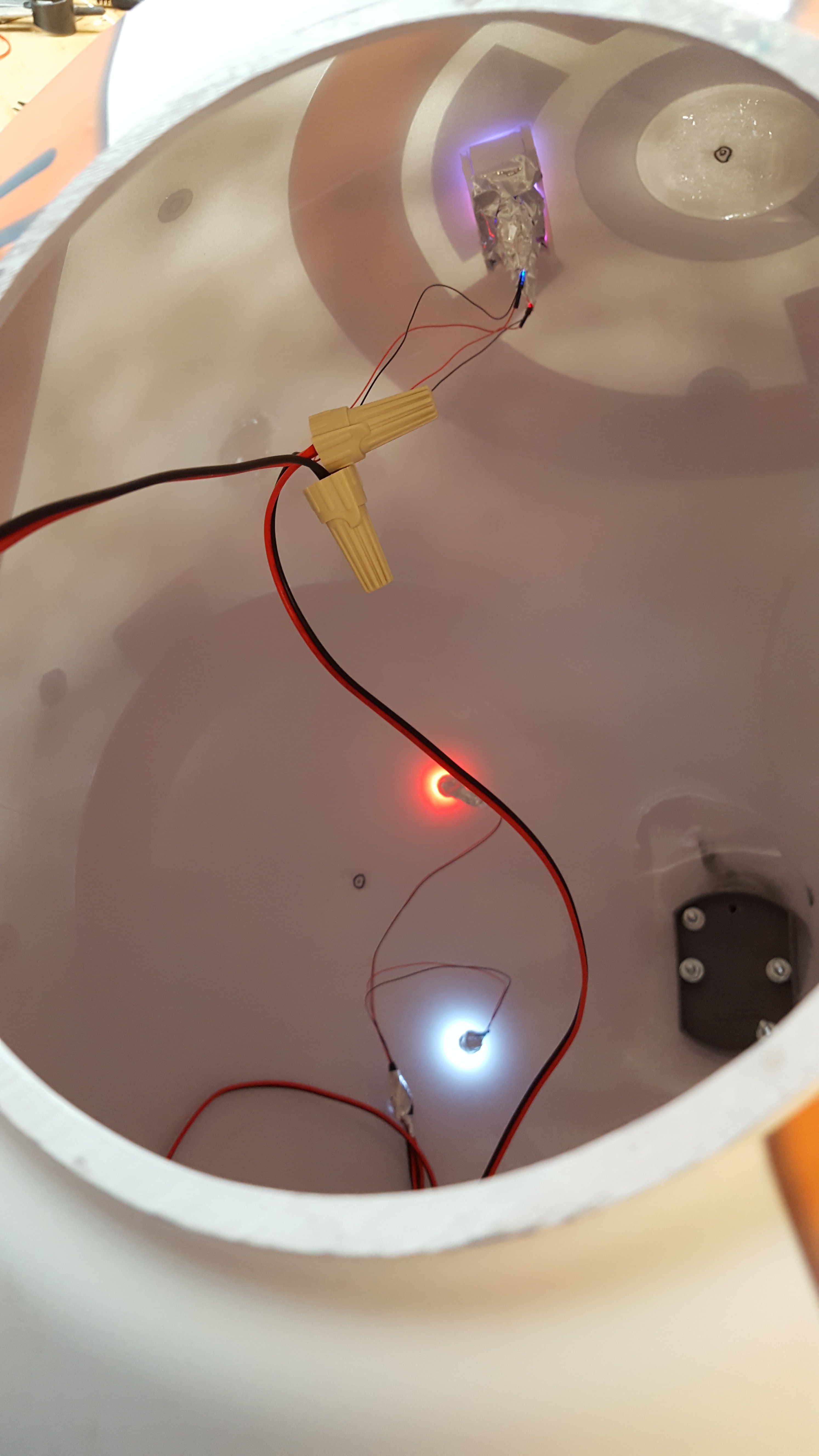

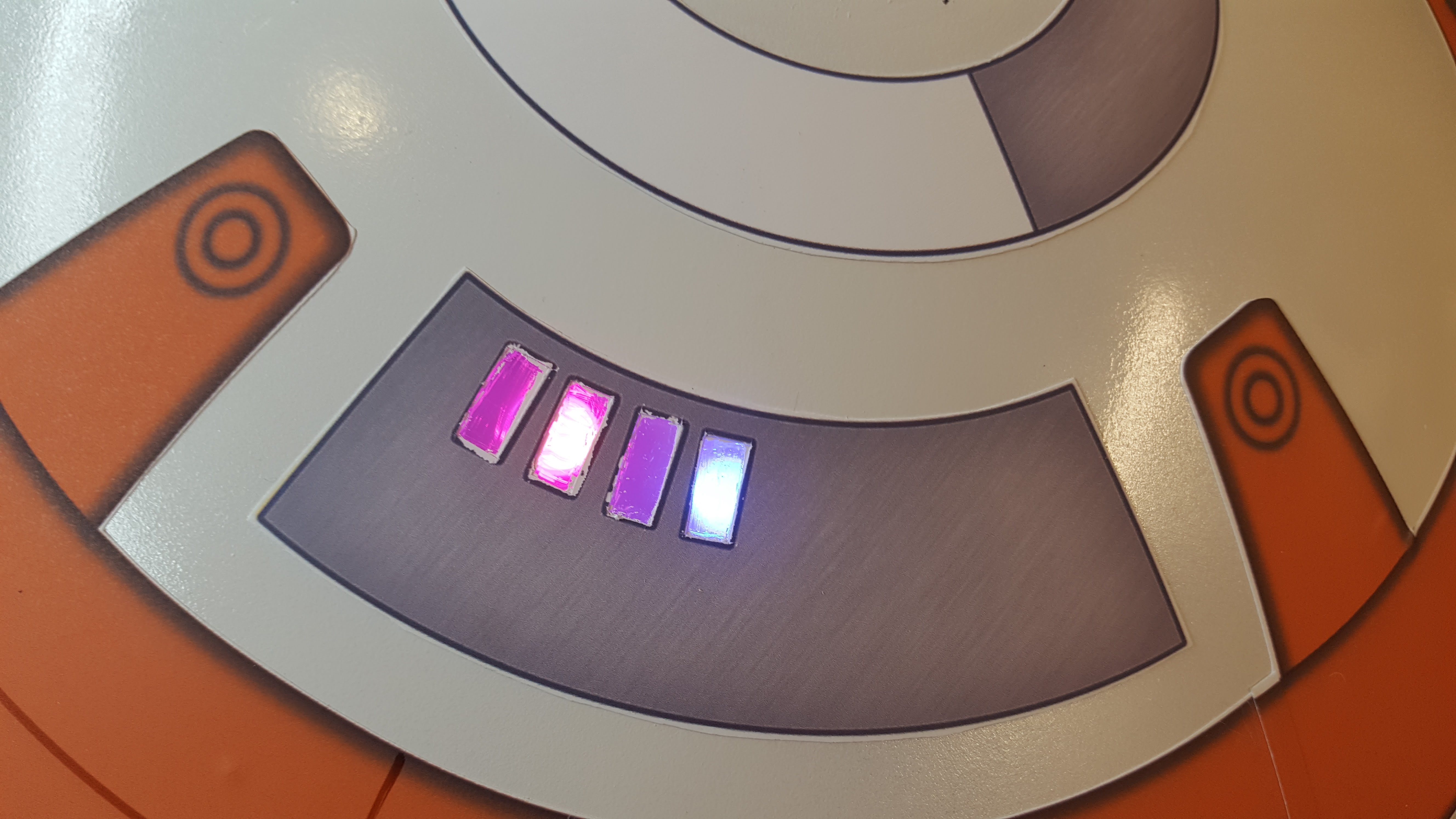

[h=3]Step 8:[/h]The lighting effort began by using small LEDs being instered into small tatoo mixing cups. A holder fashioned from foam-core board was hot-glued together.
In some cases, gluing multiple mixing cups together resulted in a more diffused color spread.
Aluminum foil tape was used to seal the wires and block any light bleed coming from cups. Lining the foam core holders with aluminum tape helps the light bounce around and make more of a soft glowing effect.
The lights were all secured inside the sphere with hot glue.
In order for the light to shine through, the stickers needed to be cut and the white spray paint scratched off with a hobby blade.
