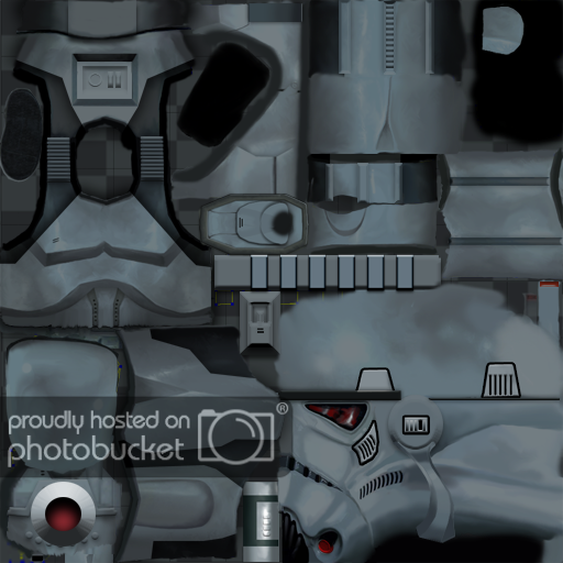

There's a bit of reference material and screen shots on the net that I was able to get hold. The best stuff came from the rpf. I've made the following design decisions when approaching this build;
* the armour is low polygon count so curvature will need to be added
* the armour is bulkier than regular stormtrooper armour but not taller
* scaling will be needed to make the suit work in the real world
* I'll refer as much as possible to a couple of colour palette/ armour shapes files I found on the net

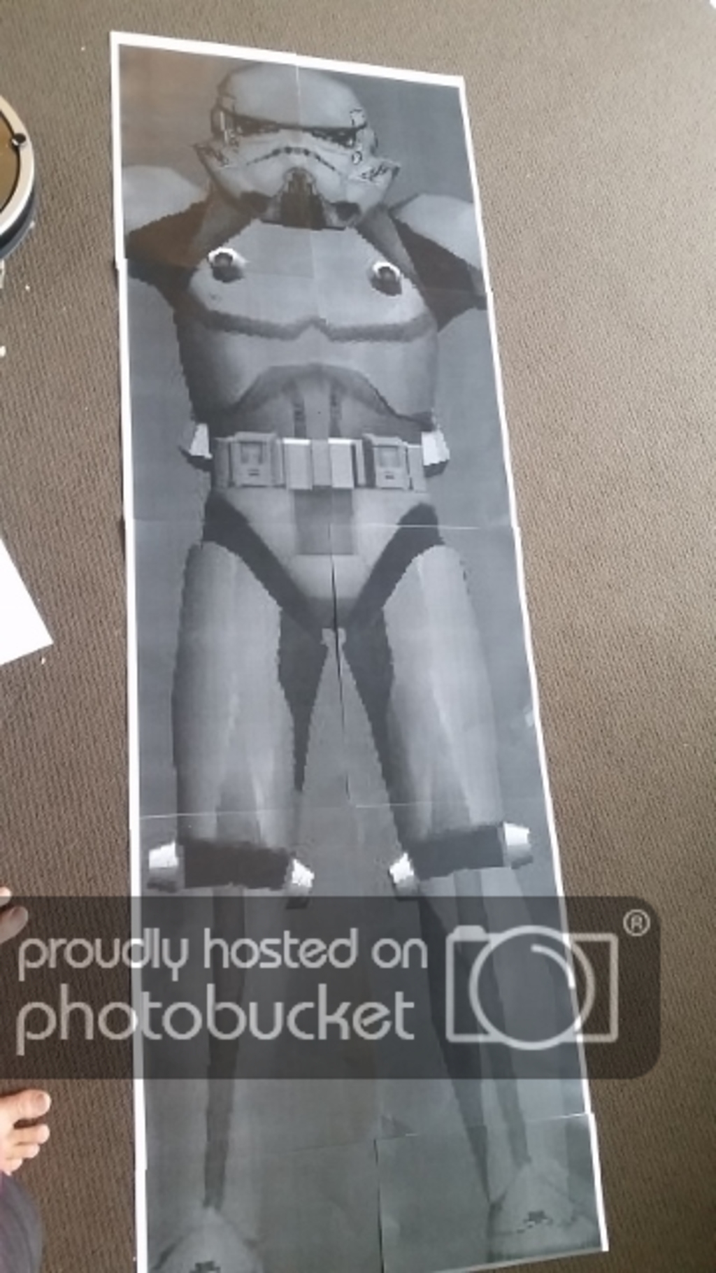

I was able to get a front, back, partial side and jet pack images which I got blown up to make a 1.8m figure. I mucked around with some of the dimensions to get it working better and got some starter profiles.
So the armour is kind of the same size as a stormtrooper just a bit wider and bulkier.

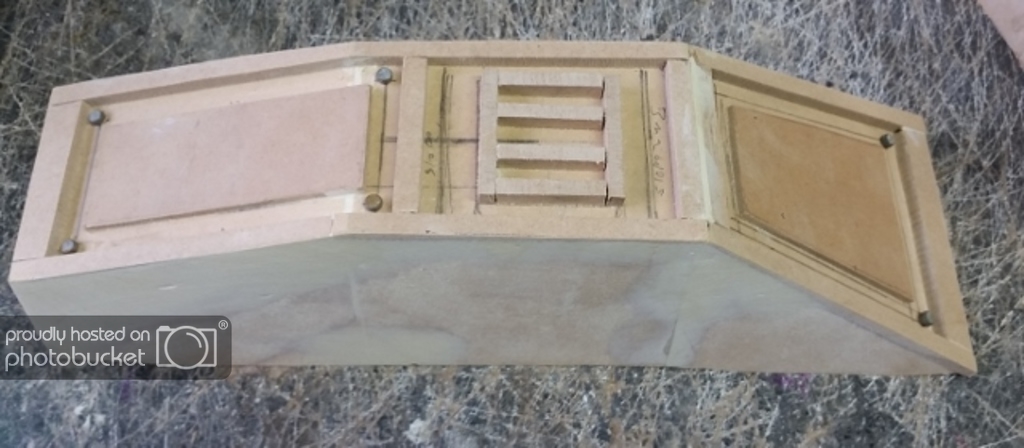

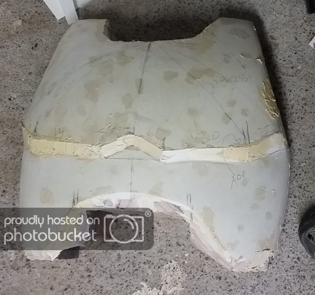

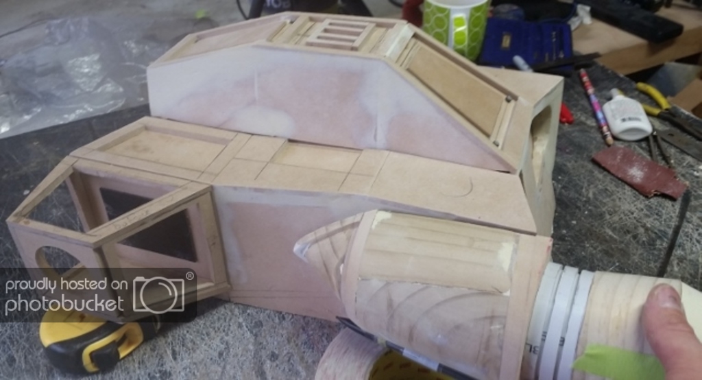

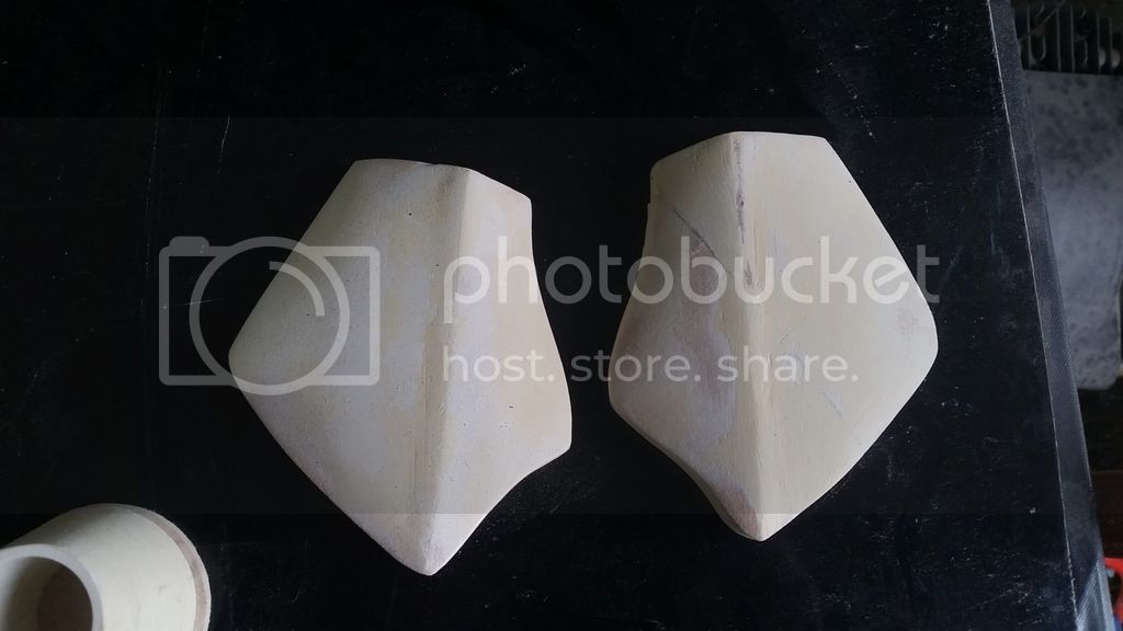

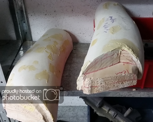

Construction for this guy is pretty straight forward but a bit labourious. I recast a few of my stormtrooper armour pieces to try and make things easier but in the end that was more hassle that it was worth and I just made most of the forms from scratch.

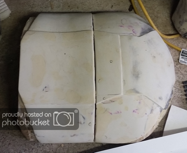

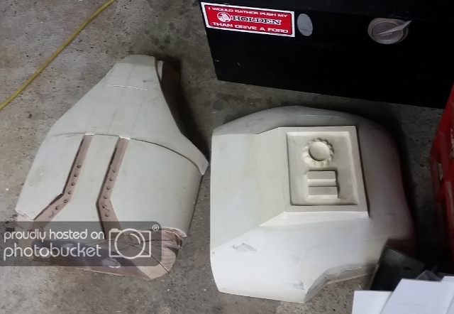

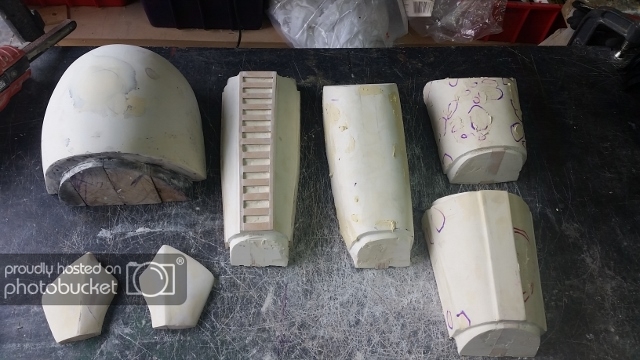

I've finished most of the forms at this stage. Quite a few need some final finishing and shaping but the bulk of the armour is done. I'll post a bunch of progress pics in this post just to give you an idea. the coolest part of the build was the jetpack! I had a lot of fun with that. The suckiest part of the build was the stupid legs. Lots of intersecting curves slowly squeezing my brain.
The chest plate is frickin' HUGE!
apologies to any ford drivers. that sticker on my toolbox was from a different time in my life I am not prejudice against fords

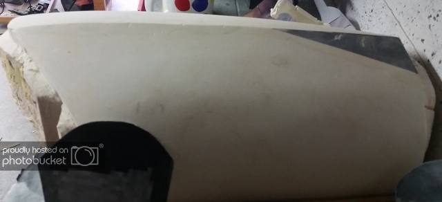

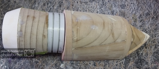

still a little bit to do on the jetpack. It's going to be roughly 8 pieces plus some backs for the inside of the main body

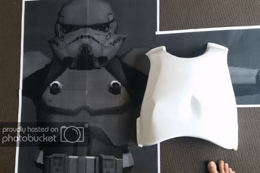

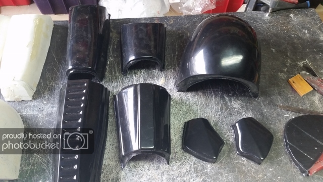

And finally I've started to pull some pieces on the vac former as I get them finished up. I started using black 2mm ABS sheet but it's a total PITA to get black ABS in New Zealand so I'm switching to white. It's all going to get painted anyway
Ok that's it for now. I'm going to be updating this thread hopefully regularly. As always comments and critique are always welcome

Looking great, thanks for sharing! The sculpts are really nice, what kind of timber do you craft them from?
Hey retiredclone cheers! For the bigger pieces I am just using pine, the smaller pieces I use mdf. I used a truckload of bog to cover the wooden forms and provide a decent surface to finish with. I think I've used 10kg of bog on this project so far :)

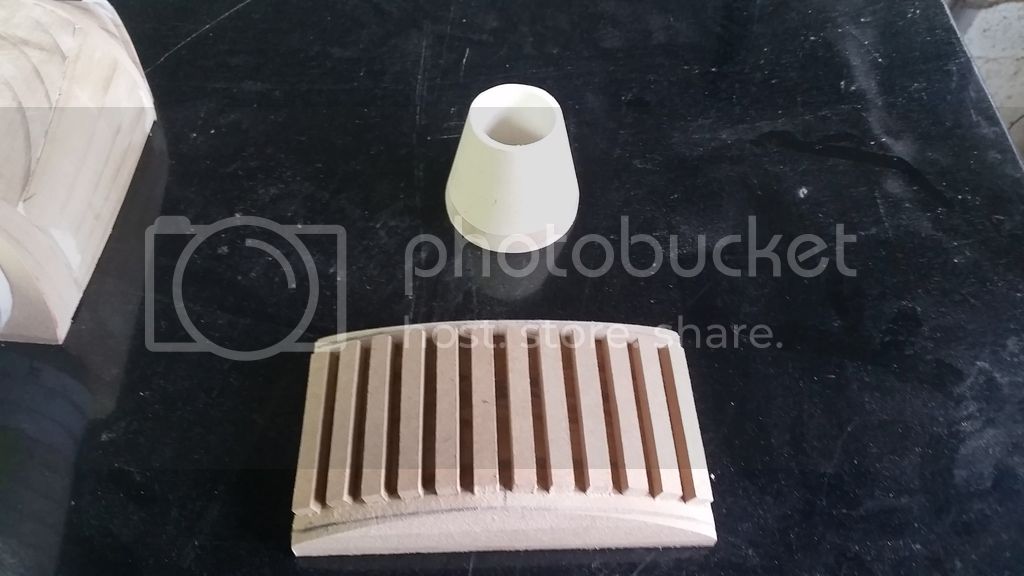

Hey all small up date. Here are pics of the shoulder strap (short clone style), Hand guards (kind of clone trooper like)......and....um..... the nipple.
Ok so it's not my favourite part of this build to be honest. Why the hell did they have to put nipples on the dark trooper? I understand the idea. Machines need lubrication, lots of them have nipples for grease or oil. Dark troopers obviously need this to so they can keep jumping around or whatever. But couldn't they have moved them up the chestplate a bit? Make them less.....nippley?

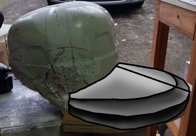

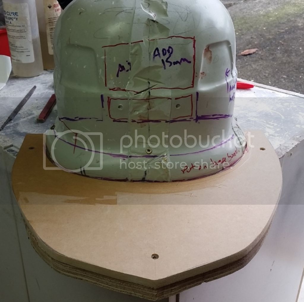

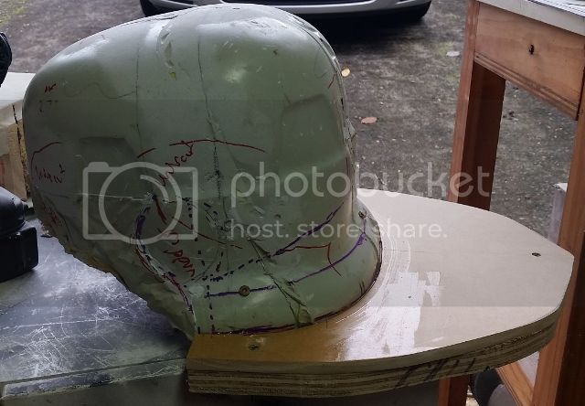

Ok I got a moment to do some preliminary work on the bucket. A while ago I had cut up one of my old tk buckets added some spacers tape it all up and cast some bog and resin into it with a view to using it as a base for the dark trooper. I pretty much guessed the width of the bucket and I am happy to say it matches the paper template I have really well.
So I've added a ply base board as a spacer for the vac former and then a piece of 9mm mdf the top of which will be the trimming edge of the bucket. It's looking pretty rough at this stage but most things are in the right place so I can start add in the curvature. I've got to add about 15 - 20mm of material to get the length of the helmet right and I think I'll re position the rear trapz. Wow this bucket is going to be huge. I reckon I'll have room for snacks and a beverage service up there :)
The height of the trapz is good as it the ear placement and the height of the bucket walls. I need to rework the curvature on the top a bit but it's not too far off just need tidying up
As much as I can I'll be keeping the features of the bucket as close to a tk as possible. So the trapz can stay the same size, the ear rounds can be the same, the curvature can stay pretty close etc

Haha! It is indeed a huge bucket. But it make fitting in electronics easier! :)
Looks like it's coming along well though.
I followed your guidelines and quickly drew this. This is going to be epic.
The long bit at the back reminds me of a roman helm.
