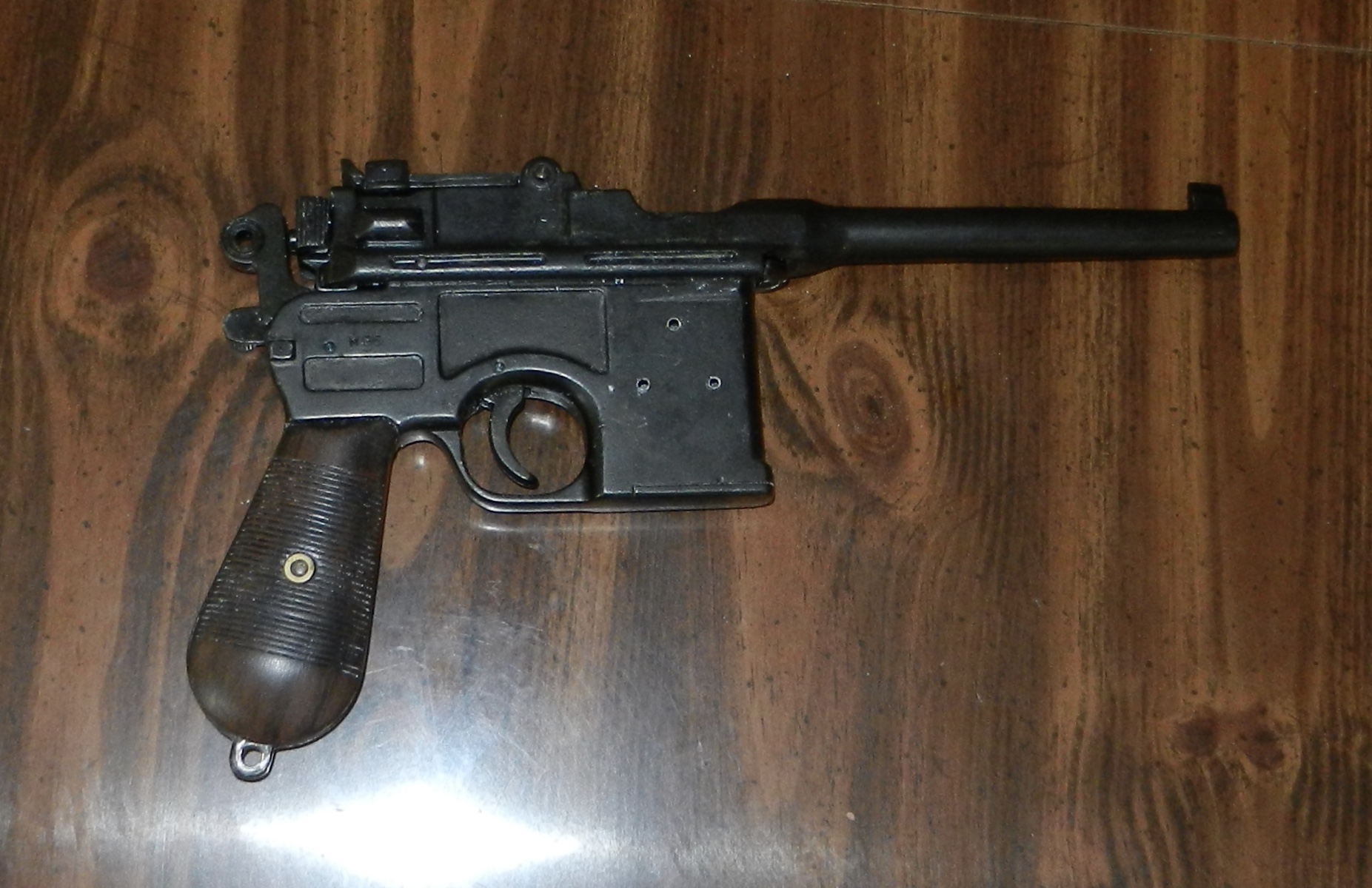

I got some Hoth parts early, and I'm using my own Denix. It's from a toy place on Ebay that seems to have small, wonderfully detailed Denix's that put most others to shame. You'll see how tight the upper rail hugs the lower. Also, I installed MGC grips (since the Hoth was an MGC) and only had to do inner adjustments....the frame nearly exactly matched the MGC grips. All I really had to do was hacksaw the tapped holes and drill out the center.

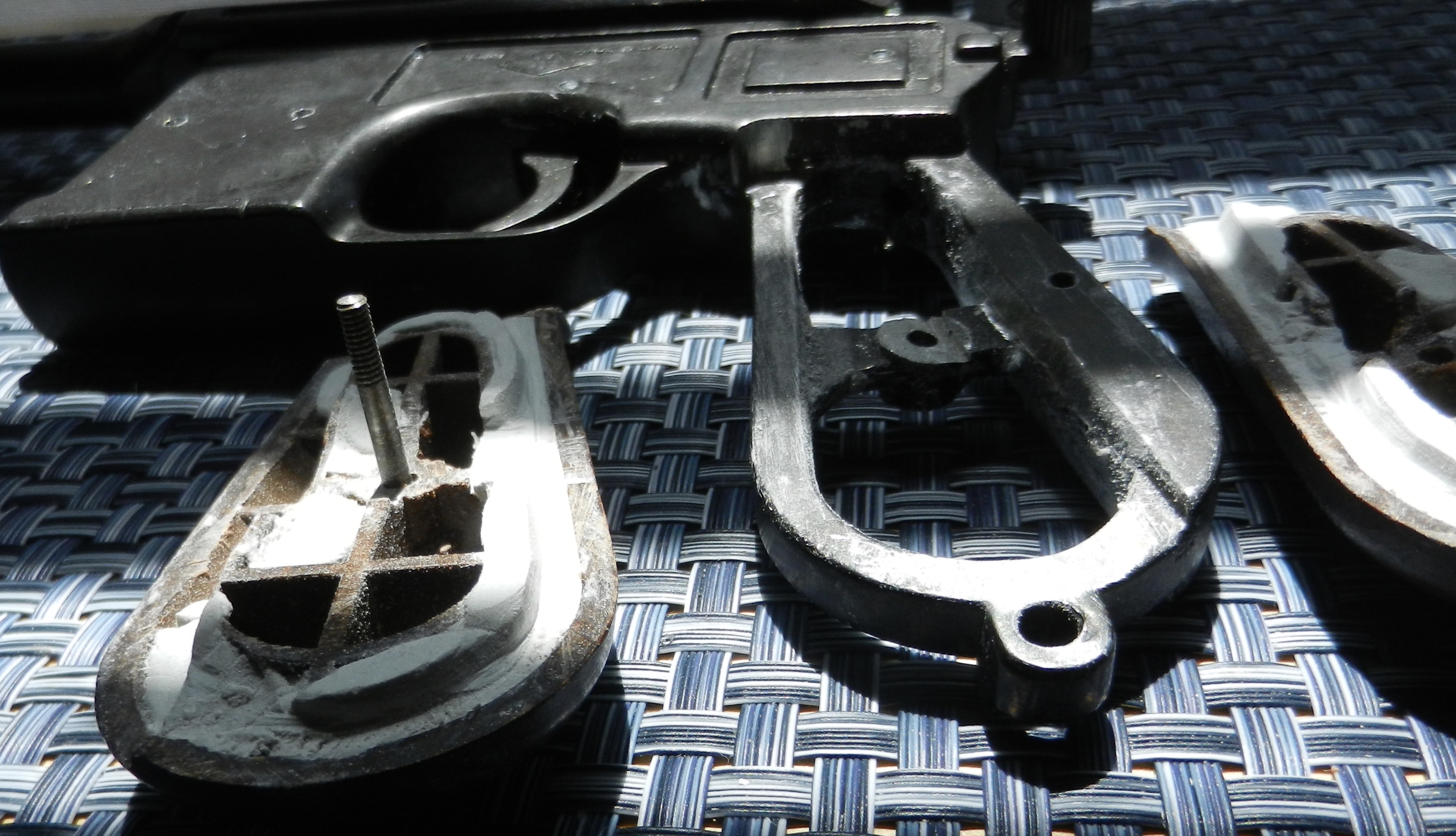

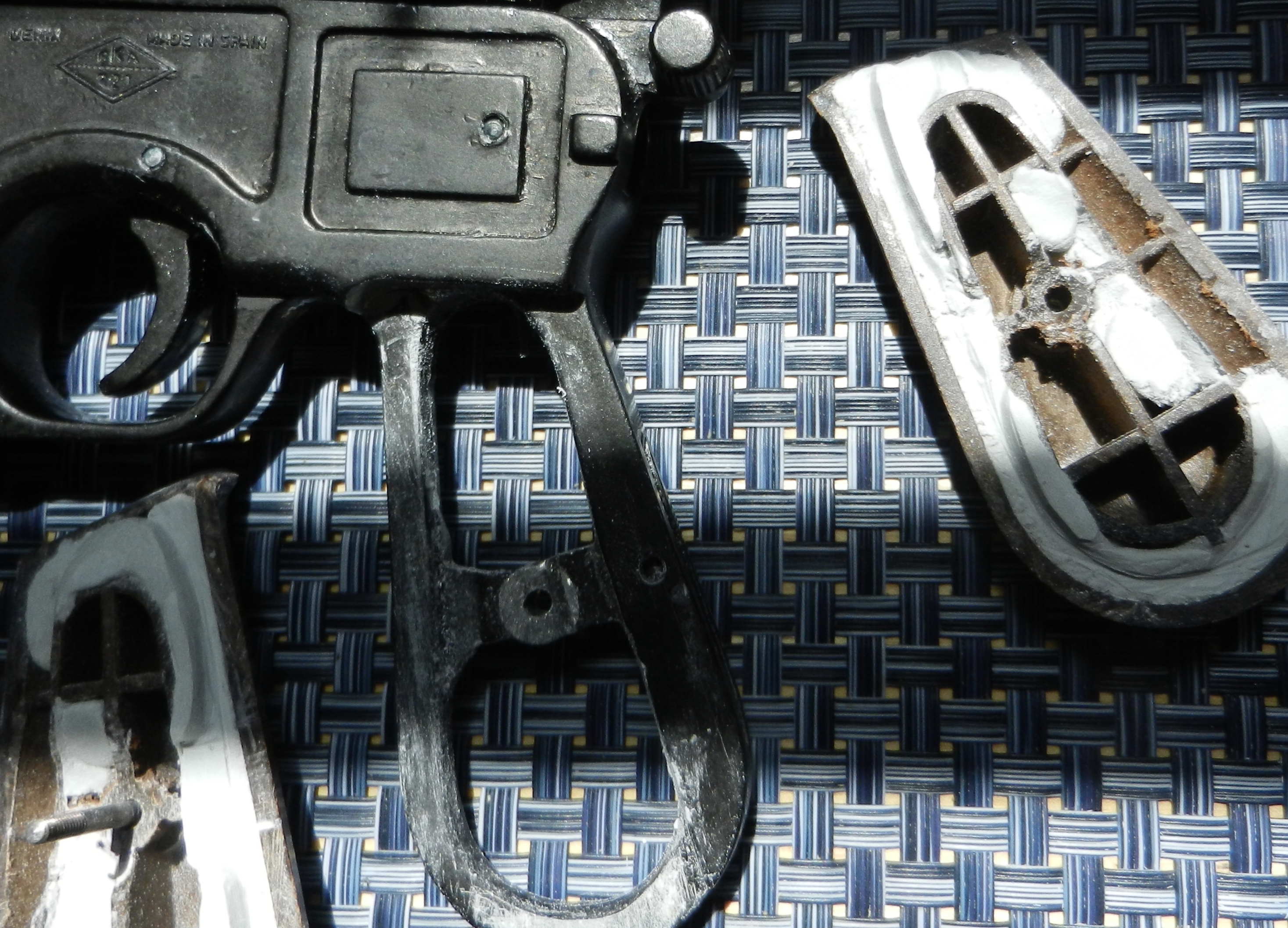

Here is the inside of the grips. I ground the rear of the gun's grip from the inside, but in fear of grinding through the stock recess, I did more to the grips themselves. I ended up filling the inside with putty and sculpting a tighter fit too - since the rear inner ridge of the MGC grips had to be nearly sanded away for it to sit without hanging over an edge.
fun fact - you can get a good shape by smushing the puttied grips into the frame to get a stamp of the grip, letting that dry and sanding it down to finish.

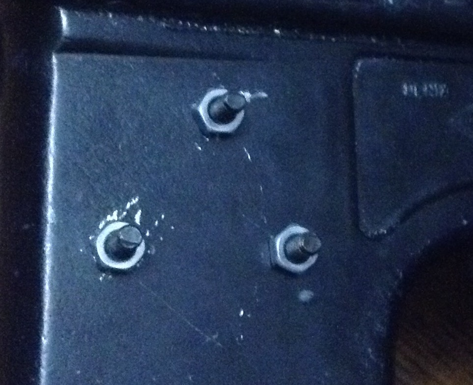

Also, I'm working a theory that the mystery nubs on either side of the Pistons are not screws.
ESB_hoth_real.jpg Image courtesy of Scottjua
I think they're nuts. Hex nuts. I think the pistons cover the upper nut and the bottom two are exposed. All three extend to the Thorens disc on the other side.

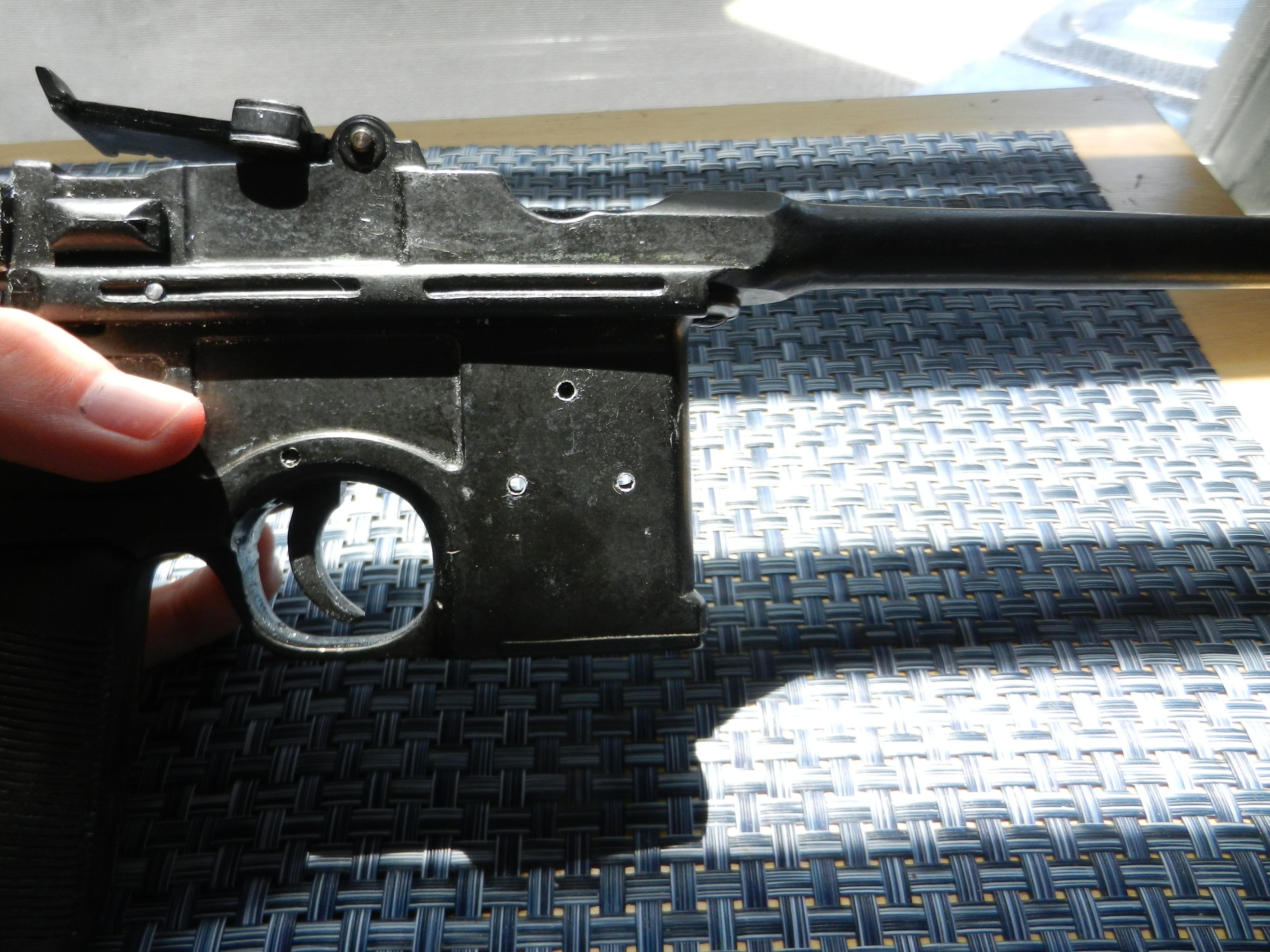

I'm not sure about an MGC body but on my Denix the mystery parts are only 1-2mm further apart than the adjacent M3 bolts. So, I adjusted.
After measuring seven times, including two types of resin pistons, real pistons, a thorens disc and Boba Debt mount...
I ran 1/16 drill bits all the way through the gun for pilot holes. I then flipped it over and expanded the holes so they were large enough for M3 bolts. I think one may be off but I have a bit of wiggle room. Right now, I have three holes for the disc and I only have two drilled completely through while I wait for 40mm bolts from China.

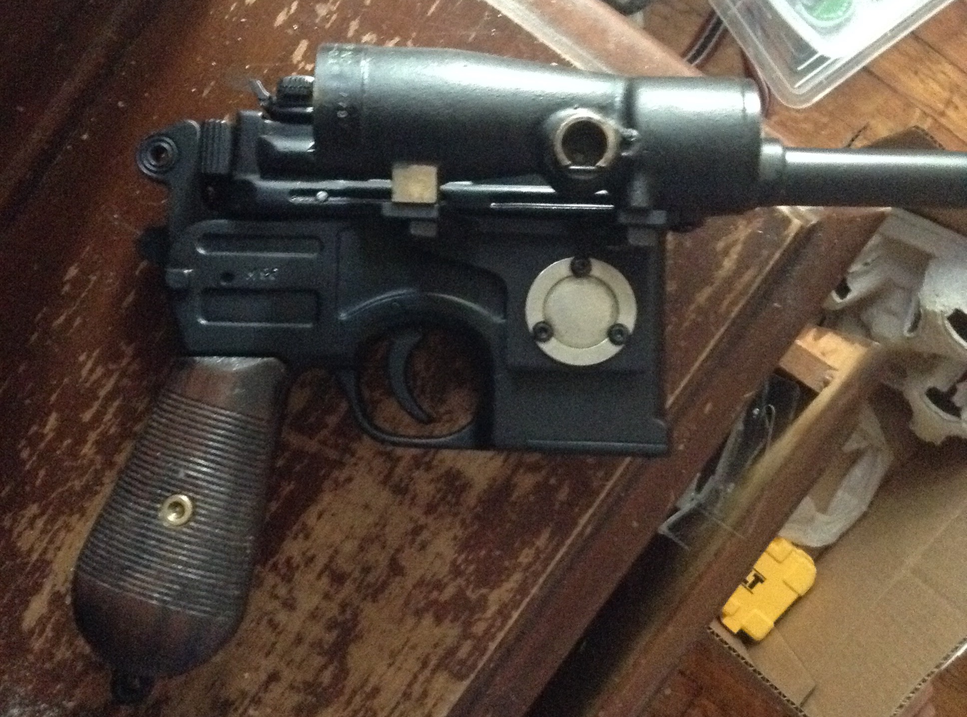

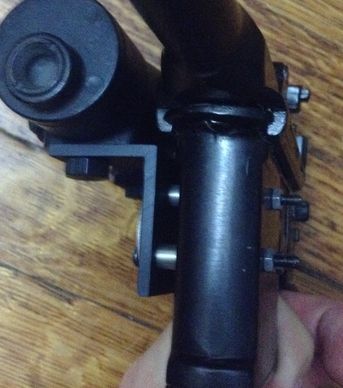

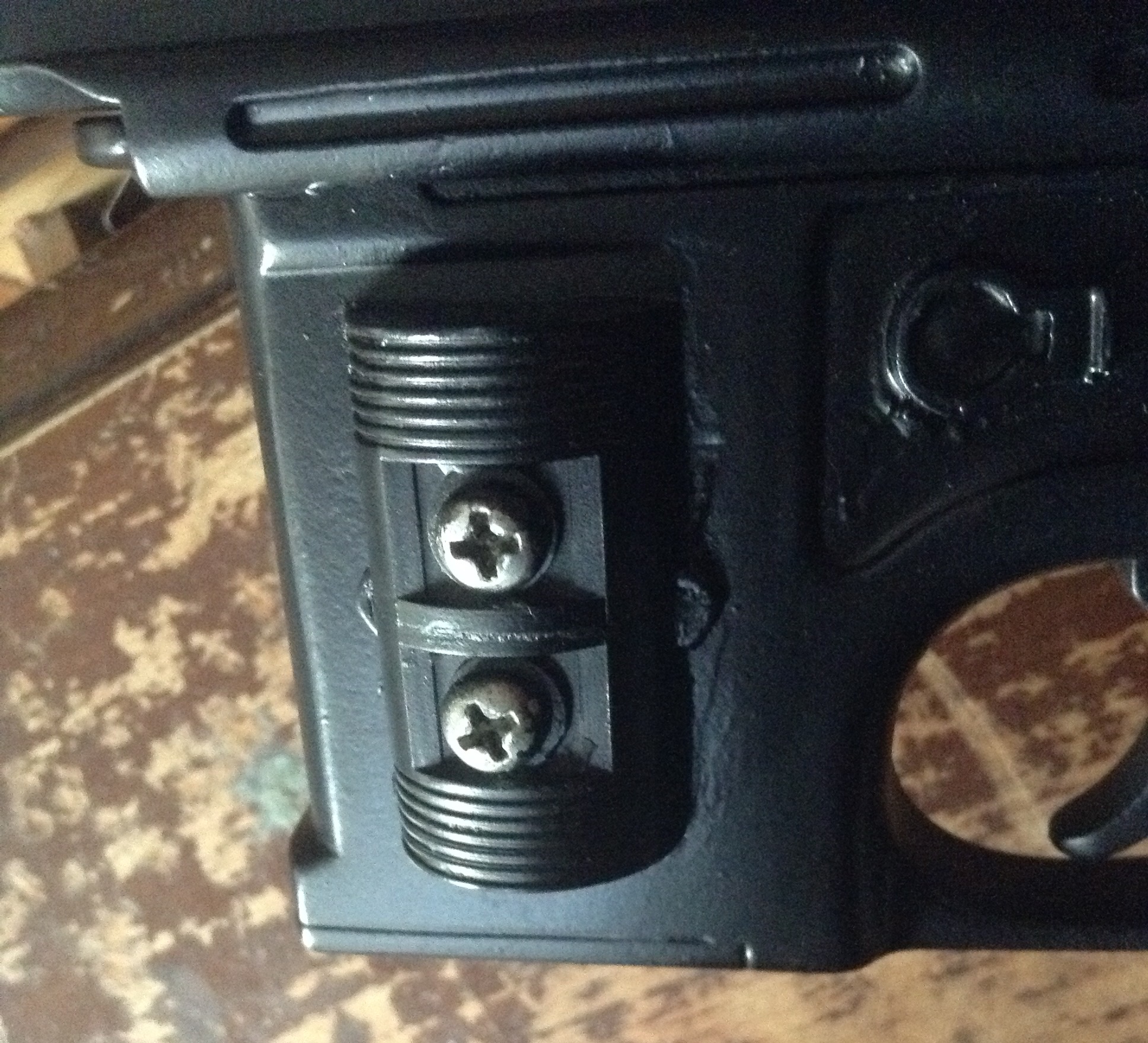

I drilled through all three Thorens holes and installed 40mm screws! Gotta dremel them down, but here's a plastic piston in a test spot, un trimmed. I like it :)

Somehow I was unable to line up the two lower screws of the Thorens disc with the V8 pistons on my build, that´s why I did not go that route...maybe my bracket is sitting to high/ low? :confused
Very nice! I think youre on to something here. Do you remember if they were M3 x 40? I have a bunch of Thorens caps but no screws
Couldn´t find any correctly sized domed hex-screws (head was too big) in the proper length myself, but yes...M3x40 sounds about right
Well done Tom. This is the way I have also been planning on doing it as have a few others I've discussed it with.
It's a shame the BD run just completely bypassed this detail which was a revalation as far as I'm concerned. With the incorporation of the thorens disc it was completely wasted on those newly invented 'piston discs'.
Looks perfect to me. I used to remove the excess threads on a screw with a short length of pipe that the inner diameter was just big enough to slide over. I would then rock the pipe back and forth to bend and break the excess off. It would usually break cleanly near the nut.
Thank you guys, Yes I used M3 x 40 mm screws, Basically, I got Boba Debts Hoth parts early and he used M3 screws (I think he nailed that) so I just ordered longer ones. I DID learn that the allen socket on top of the screw is not the same as the threading :lol

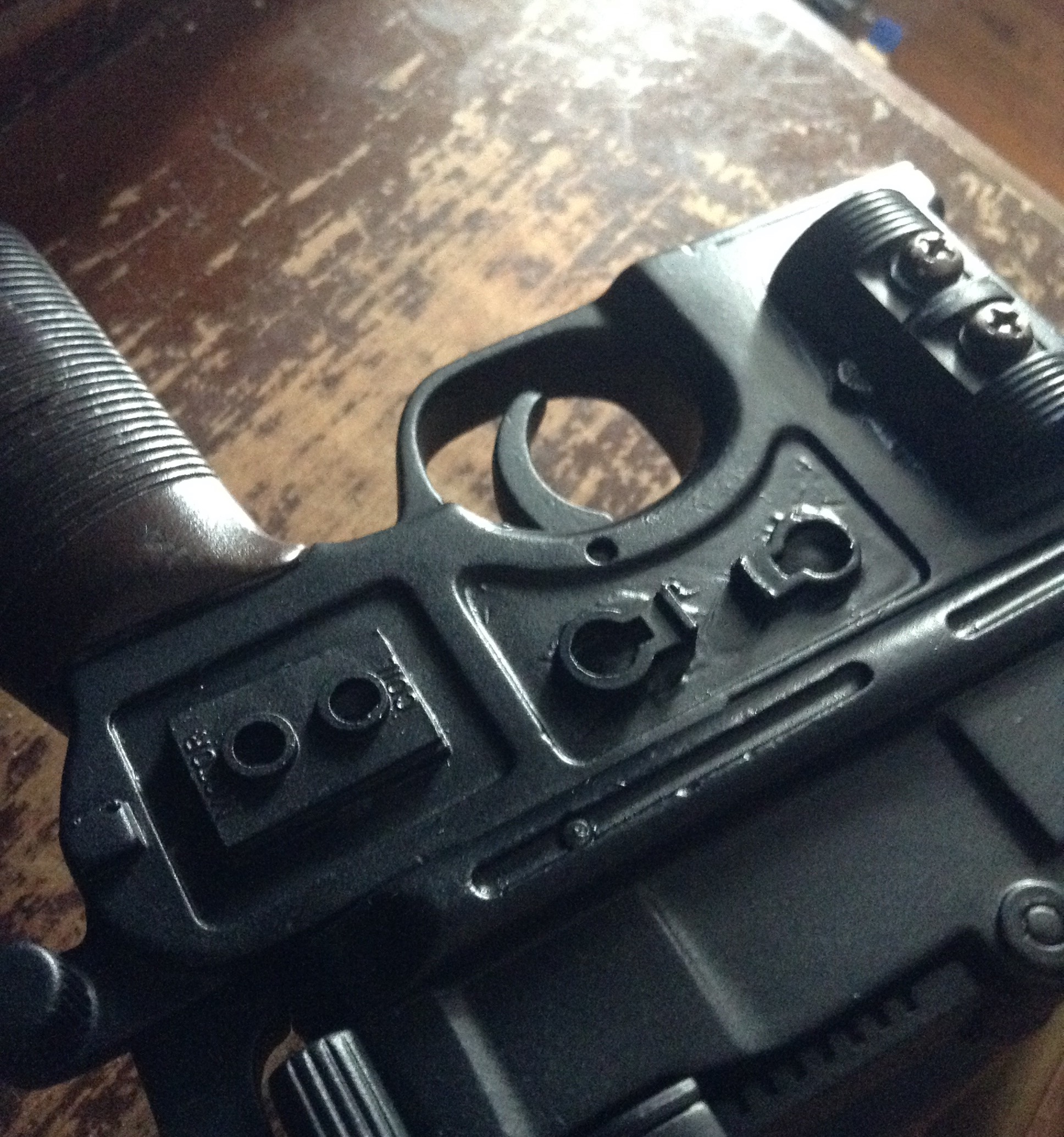

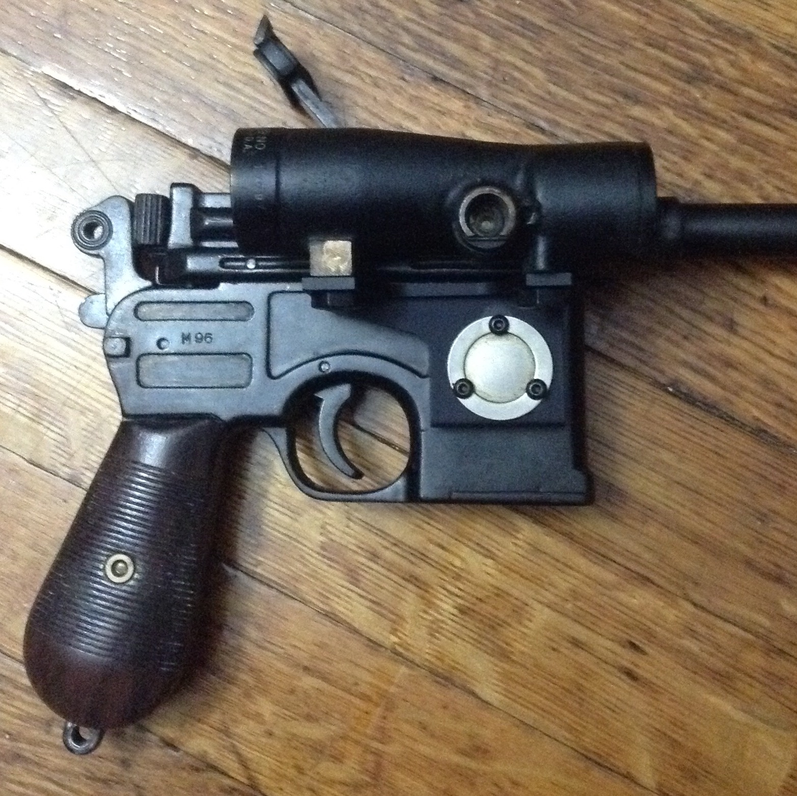

I have since finished the body of my blaster. I originally sculpted 3 or 4 pistons trying to get it right, then superglued two together by letting a drop of CA glue run down the inside, where the two join. Then, as a solid piece, I drilled two holes, filled the pistons with putty and screwed them into place.
I actually drilled one of the holes a little off, so I used the "other" half of the pistons, then part thats identical but with no hole, and drilled an off center hole myself. Now, you really can't tell :)
I also decided to use distributor rings. I kept cutting up motor coil plates and being dissatisfied, and then I realized I had 5 distributor ring castings that were beautiful and wanted to use them. That's what they were supposed to be right?
Here are some pics, notice the nuts, I accidentally got some glue/putty in them.

Did the same thing with my nuts. Filled them a little with some glue. Looks very convincing!
It's amazing how the hexagonal shape can easily be seen as circular.
