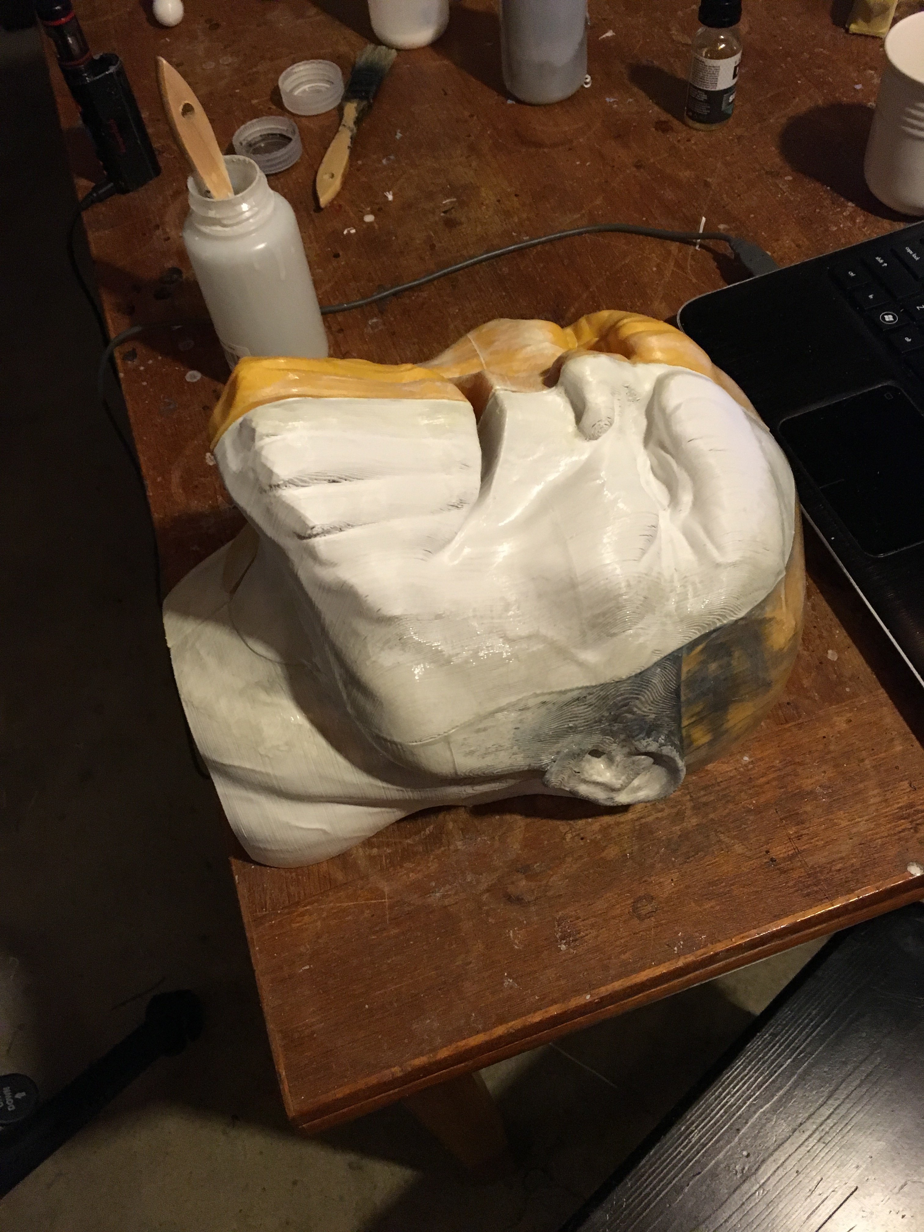

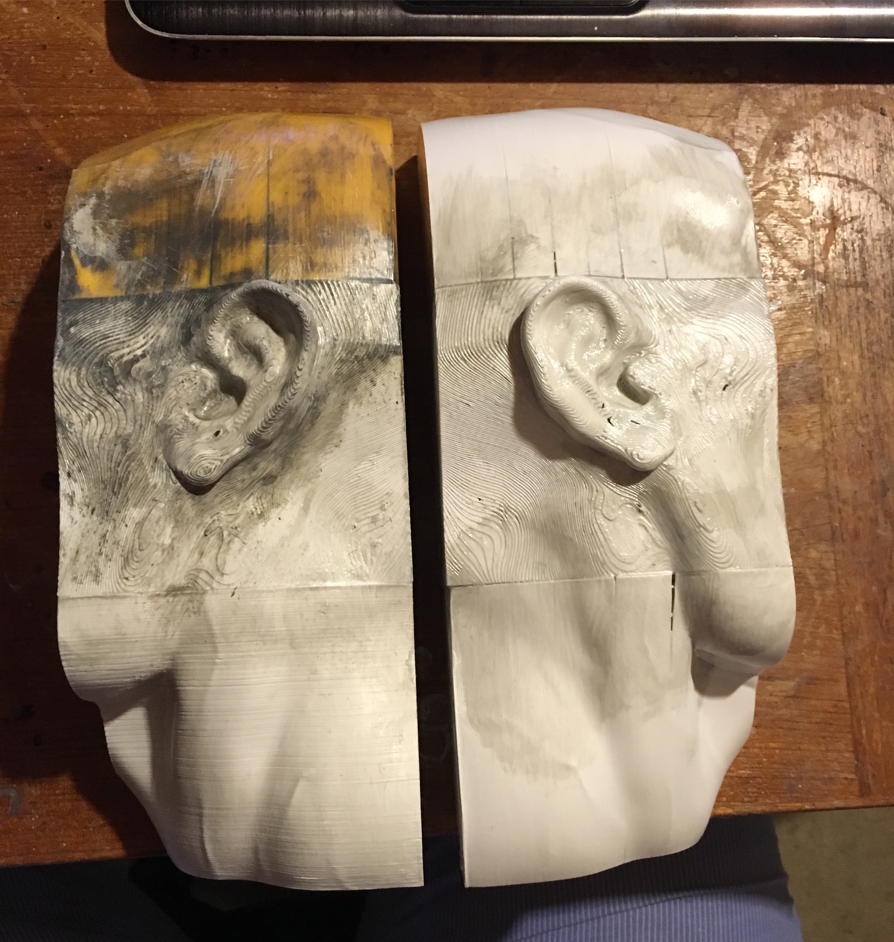

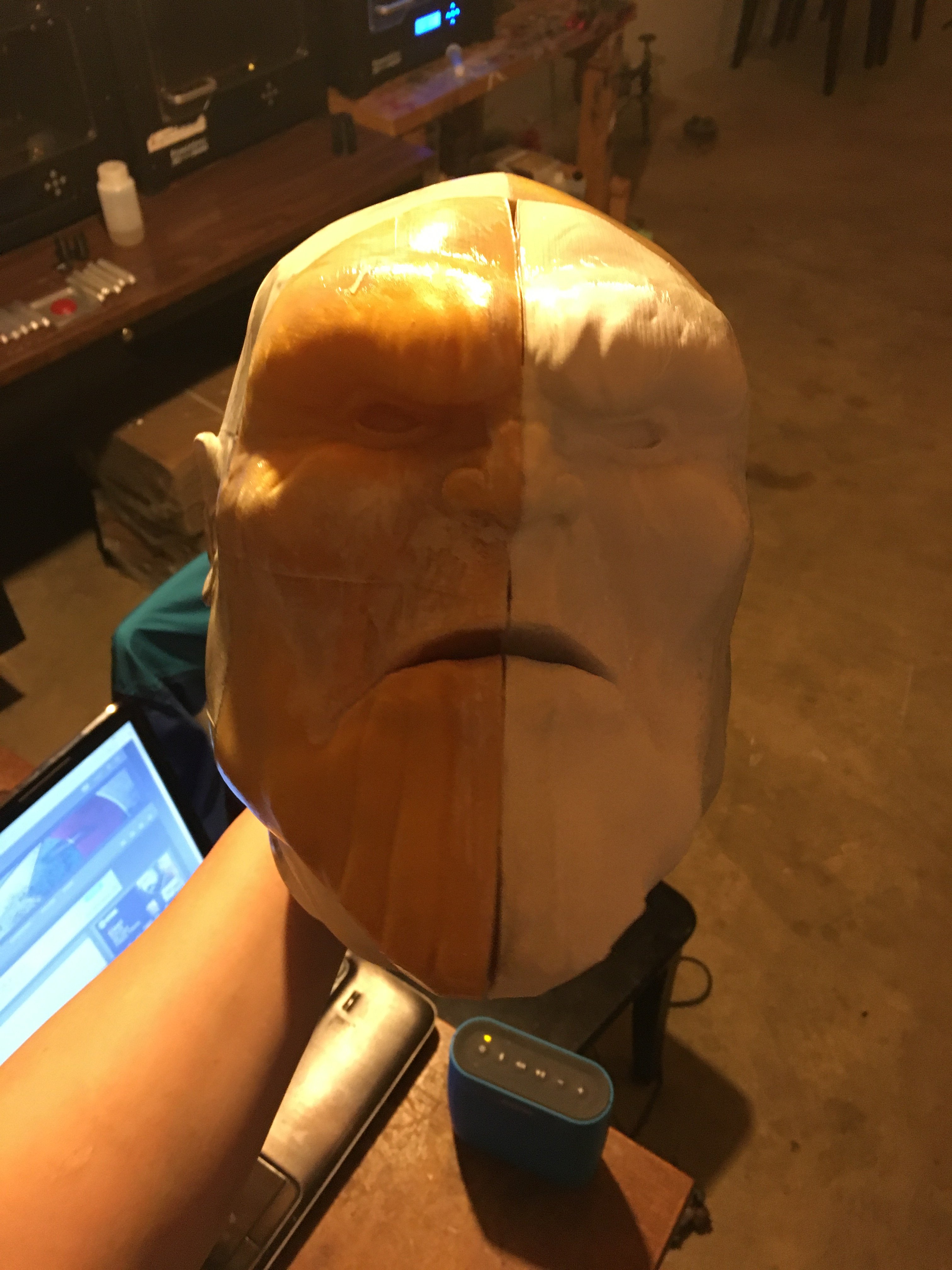

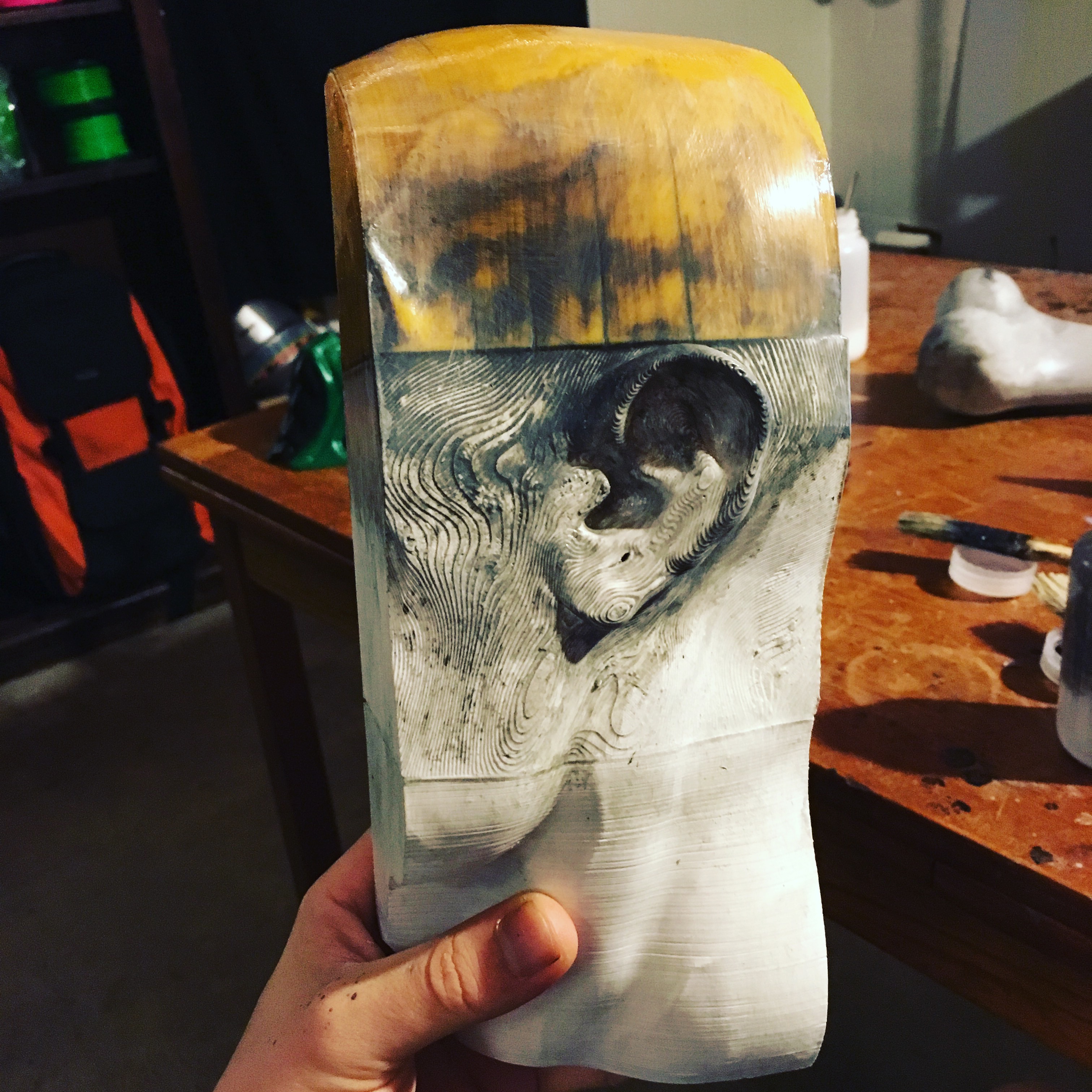

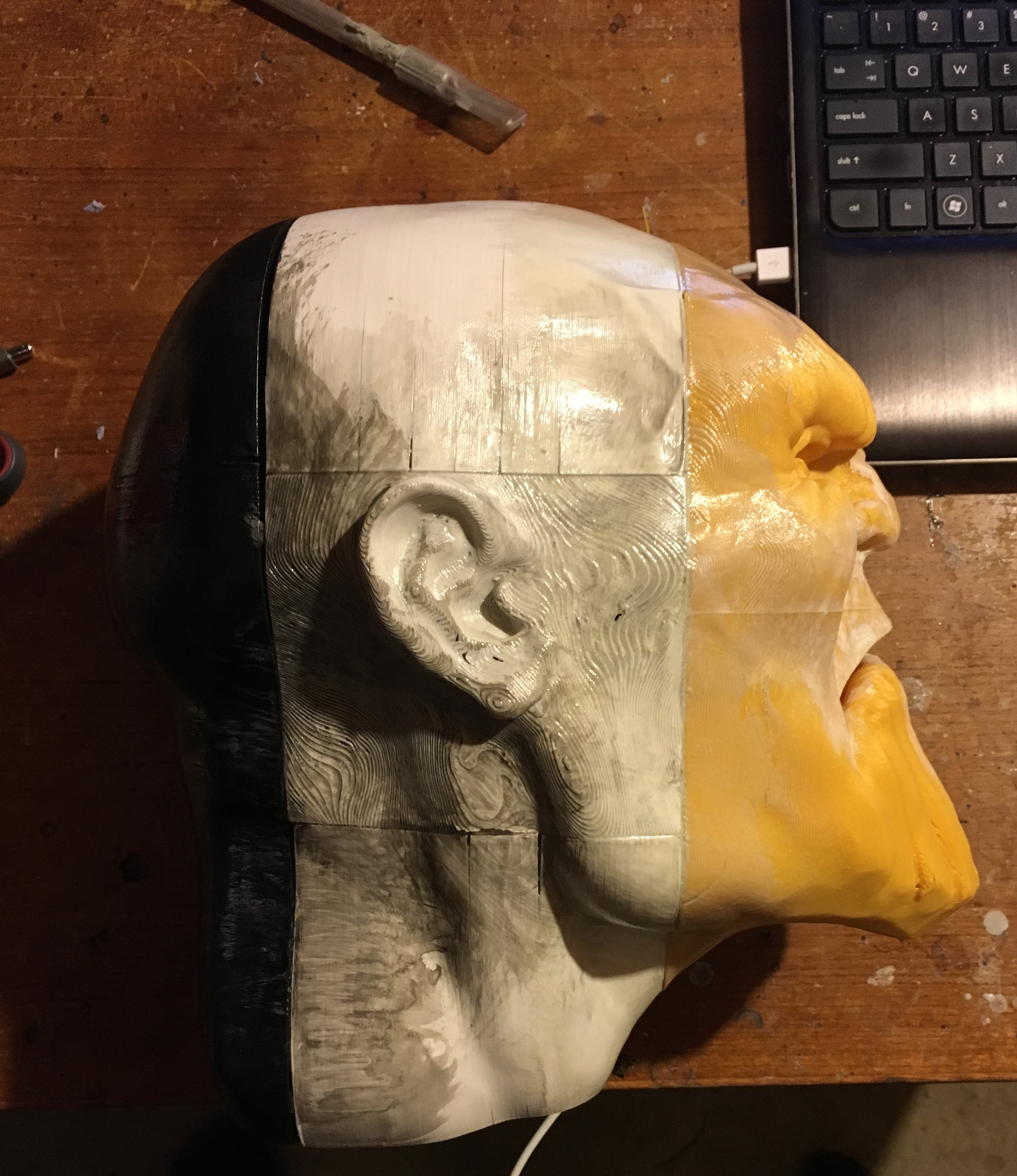

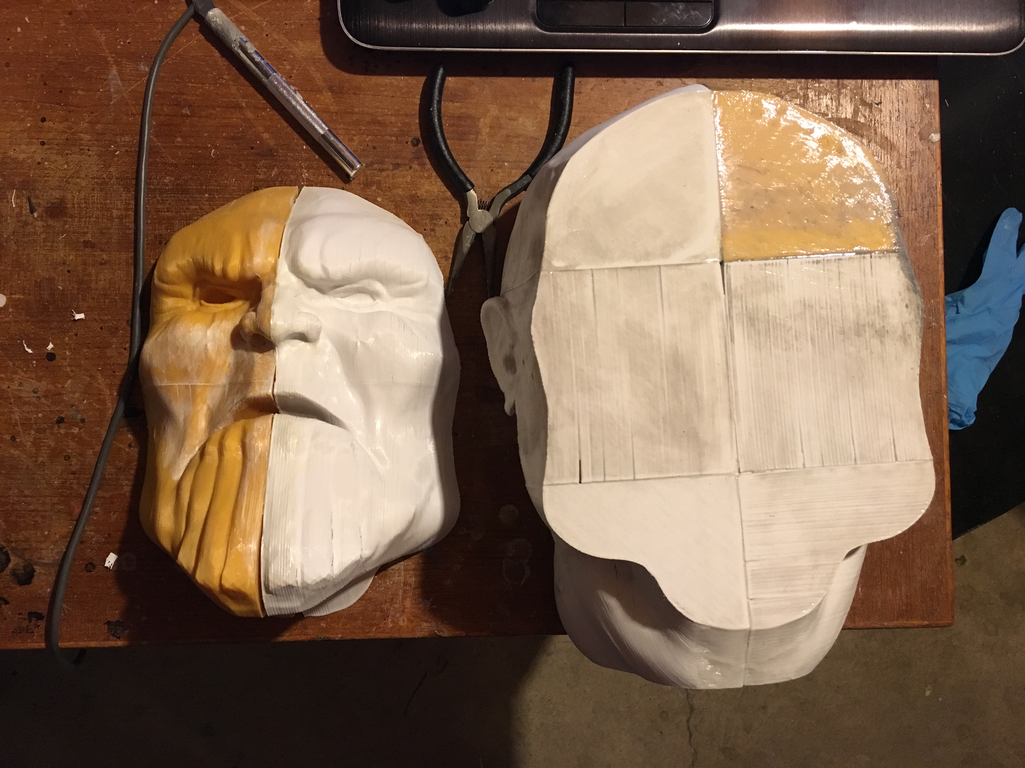

I bring you yet another project I'm currently working on, a life sized Thanos head! I found a great 3D model of Thanos's head and thought it would be fun to try and make a full sized print of it to go along with the Infinity Gauntlet I'm wrapping up. I had to slice this thing into a lot of pieces because of how big it was, and because I don't have any 3D printers with a print bed larger than 8.9 x 5.9 x 5.7 inches ... But I've finally finished printing and assembling everything tonight and wanted to share my progress with everyone here!
Now I have a lot of filling and sanding ahead of me! As you can tell there was some warping on the larger parts because of being printed in ABS, but I wanted to do everything in ABS because I could fuse all the parts together by using an acetone/ABS slurry mix. After I finish patching and sanding everything down I'll post some update photos for anyone that's interested!

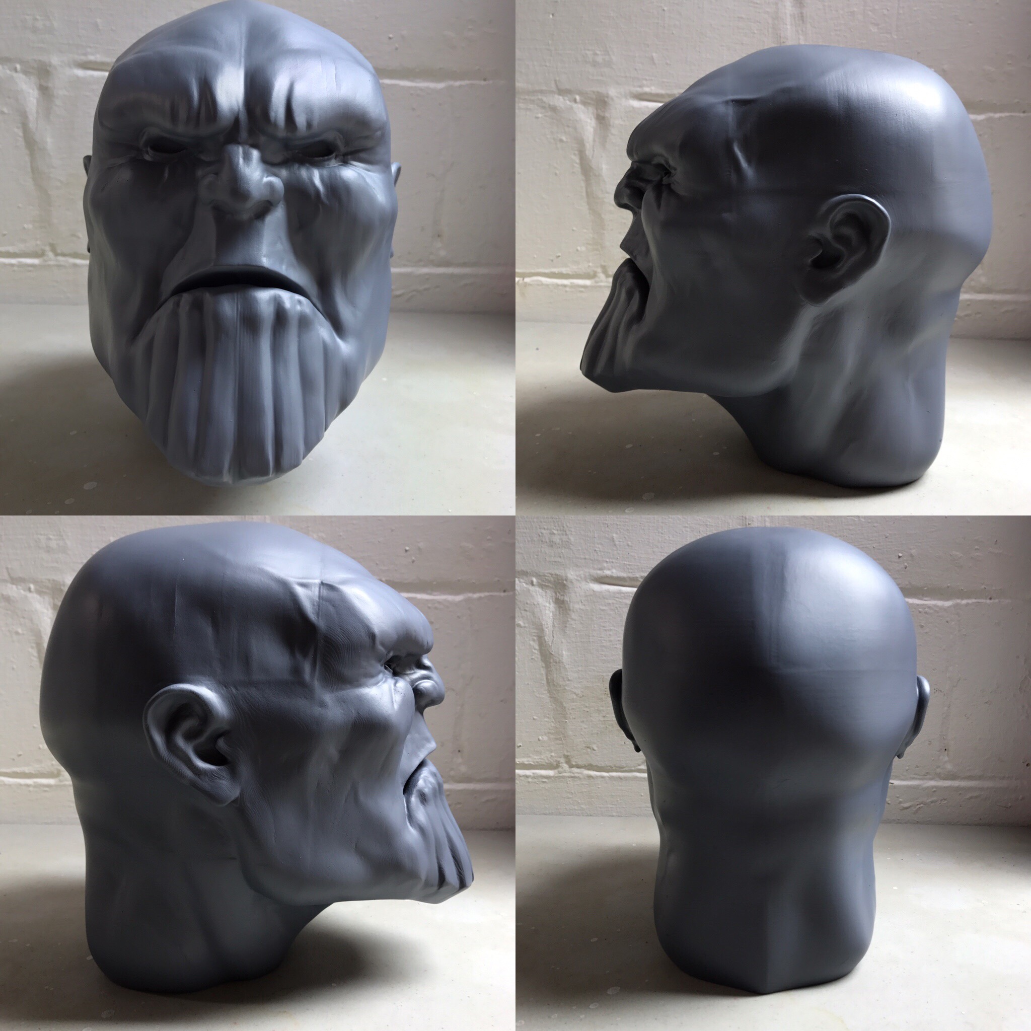

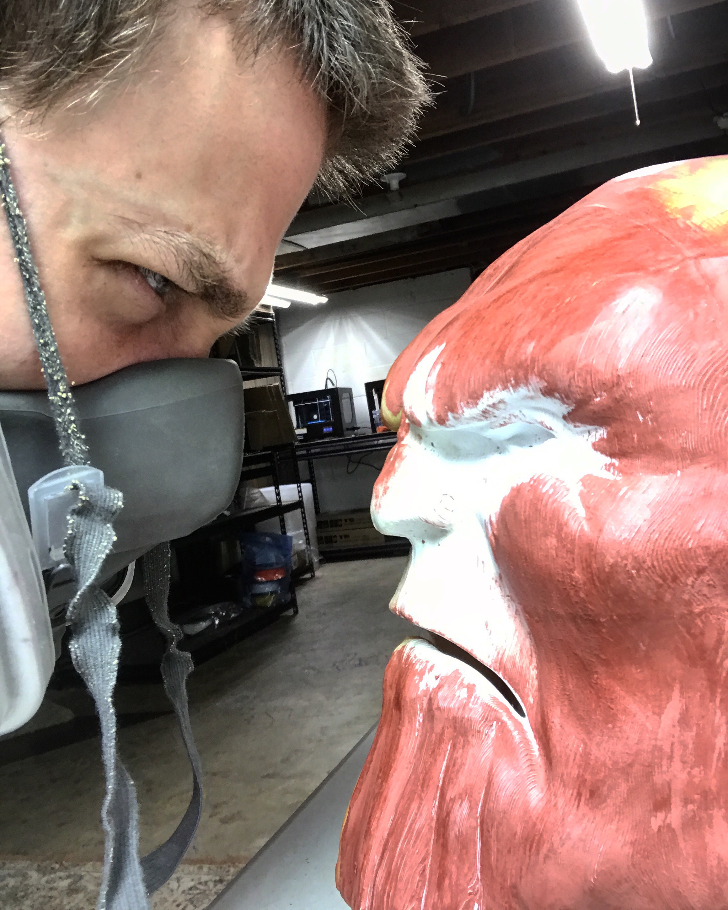

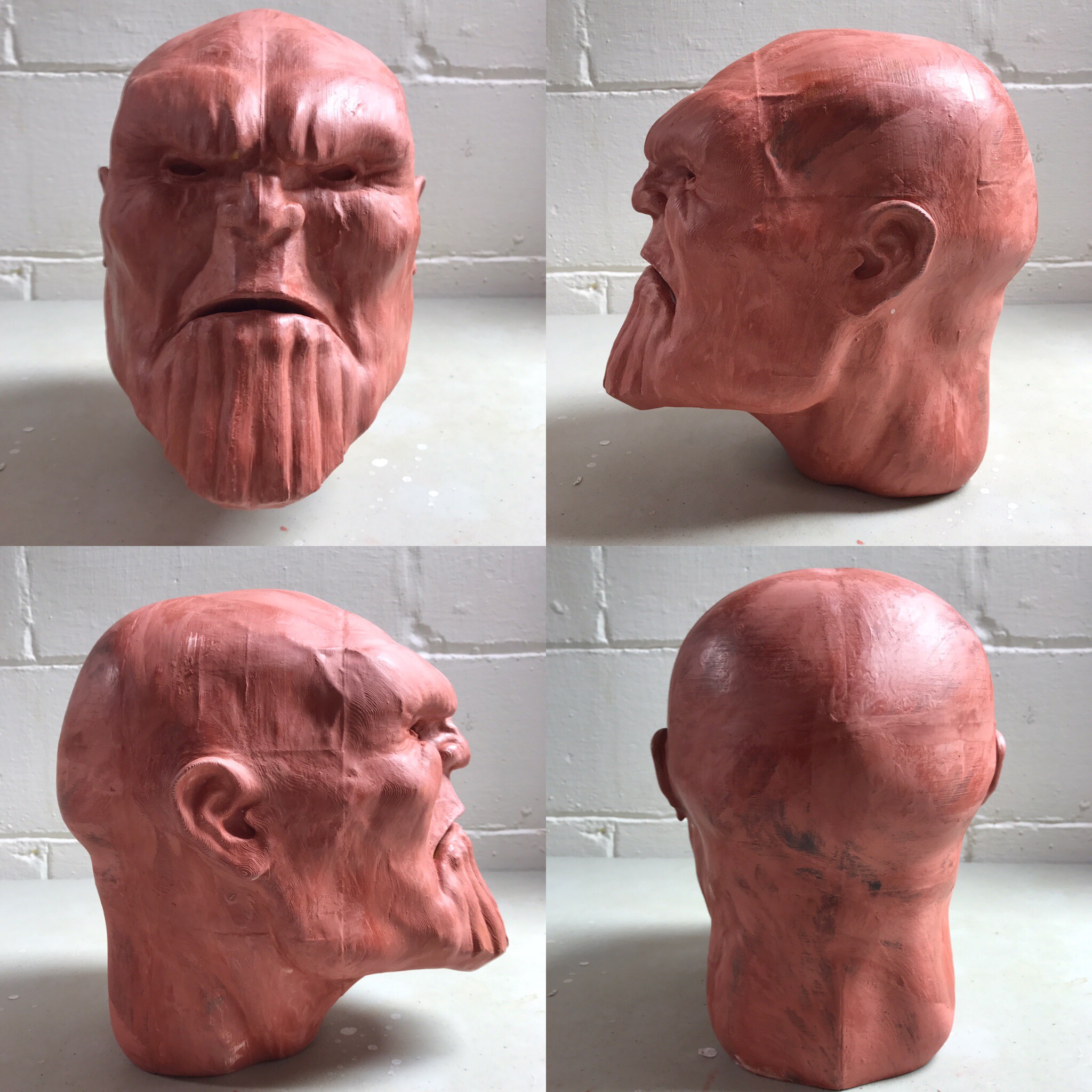

Bet you thought this project would never see the light of day... yeah me either :) Alas, PROGRESS!
IMG_3789.JPGDBC8BEF1-3324-4A78-993C-FFA15FF813CF.jpg369678FC-D054-43A4-B9BE-279EF65FF9B7.jpg
More to come! I've decided to incorporate this Thanos head into a cosplay I'm working on, so progress will be more regular now!
