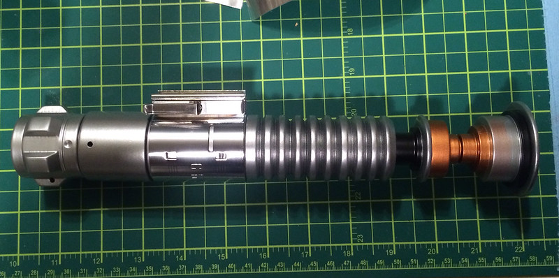

Little update here. Got the bulk of it painted - need to do the black on the grip section. That copper bleed on the emitter end will be covered by aluminum tape. Added some holes and a divot on the pommel end and need to do the same for the other end before adding the tape.
Just realized I mispainted the underside of the "windvane" part - should be black up to the largest diameter section of that part but i have it silver on the underside. Will be a quick thing to fix :)

That saber is looking great! I really dig the clamp. Excellent work!

Beautiful. It looks so smooth. Is your silver rattlecan or airbrush? What brand?

Wow, that looks AWESOME ! I'm 3D printerless, I've got to figure out where/how get one printed or hire someone to print it for me.
Thanks! It's all rattle can - the silver is Dupli-color BFM0226 Silver in thin coats over the Dupli-color black primer (just enough to where you can't clearly see the primer). I've used that combo on a number of props for a weathered aluminum look since it can be handled without dulling, though it wouldn't be mistaken for metal in person. It goes on very thin and smooth so you just have to make sure the base primer coat is sanded down well.
Initially I tried applying the silver over a gloss black Krylon, thinking it would help sell a metal look even more as with Alclad chrome, but that didn't work out either due to weather or lacquer over enamel (probably the latter). I had to sand it smooth and do a layer of Dupli-color black for a proper base.
The exposed black areas are Krylon semi-flat black -- enamel can go over lacquer easily, but the other way around is trickier.
