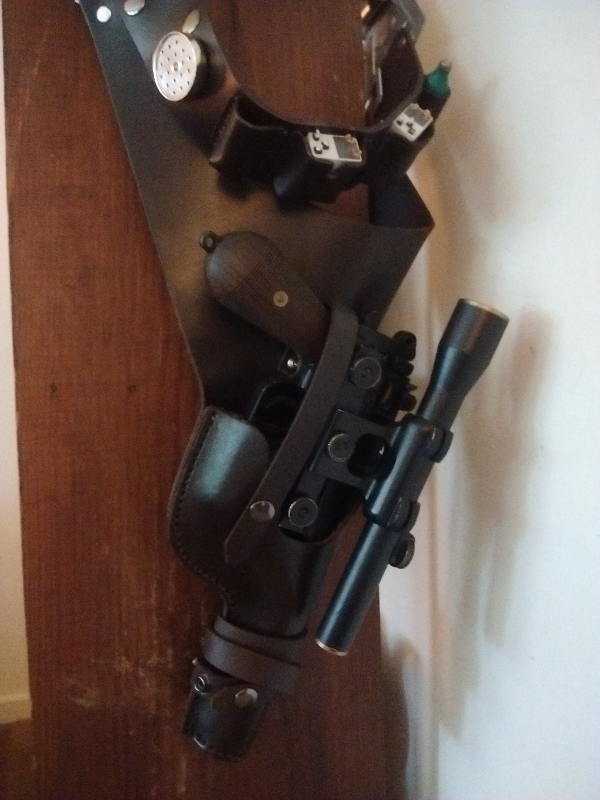

I make my props to be played with and weathered through use, so I display my DL-44 in a leather Costumebase holster:

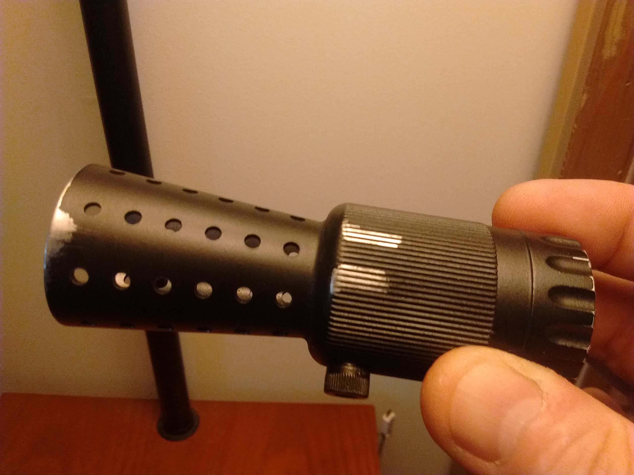

Originally, I painted the entire prop with 3 coats of matte black and 3 coats of polyurethane. The paint on the flash hider, however, rubbed off in certain places due to contact with the holster:
I feel this is another argument for parkerization on the FH because this would have happened to some degree to the blued finish of the original prop as well, though there is no evidence of it. Parkerization is an EXTREMELY tough coating and could shrug off holster-wear... no sweat.

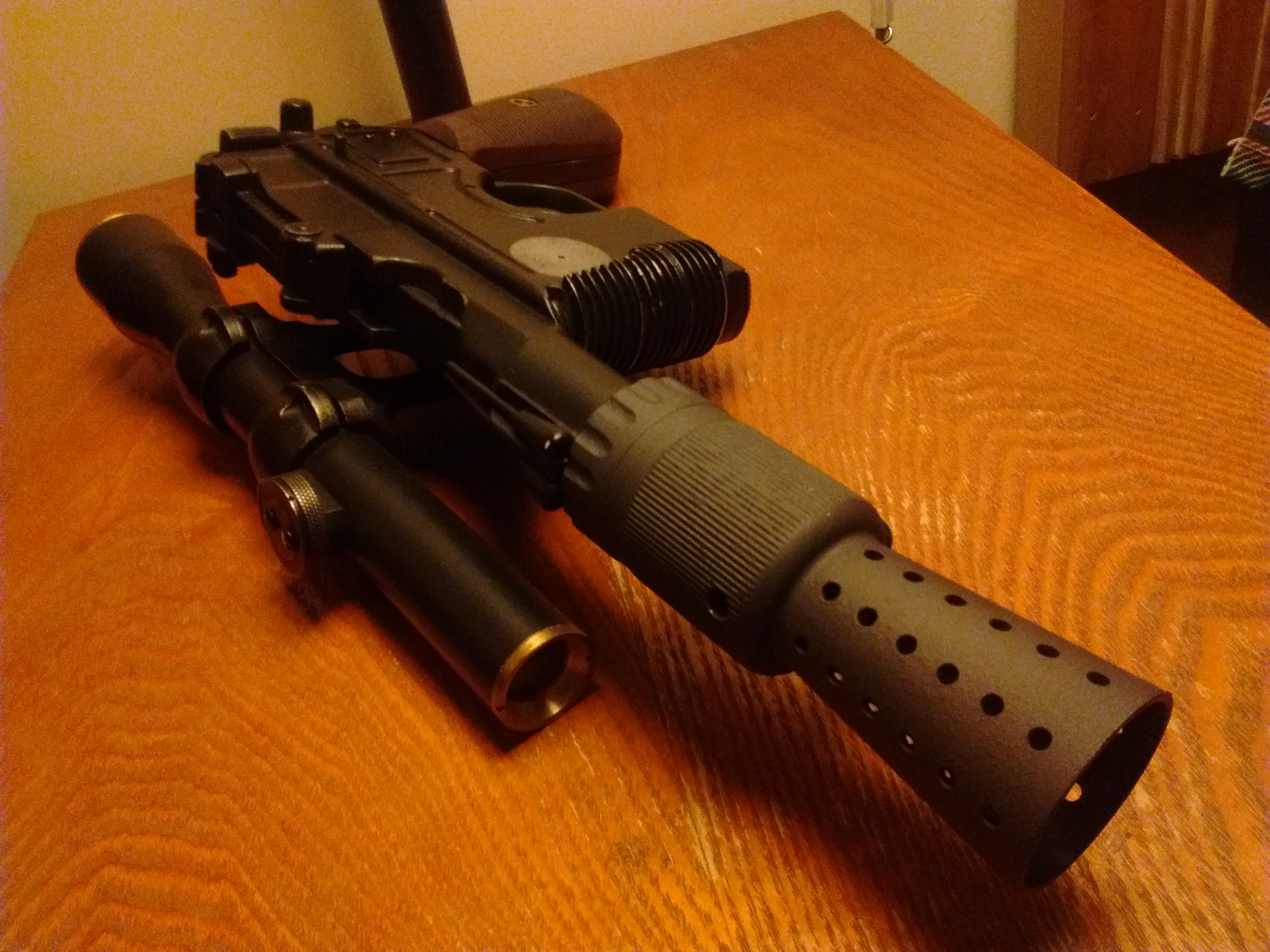

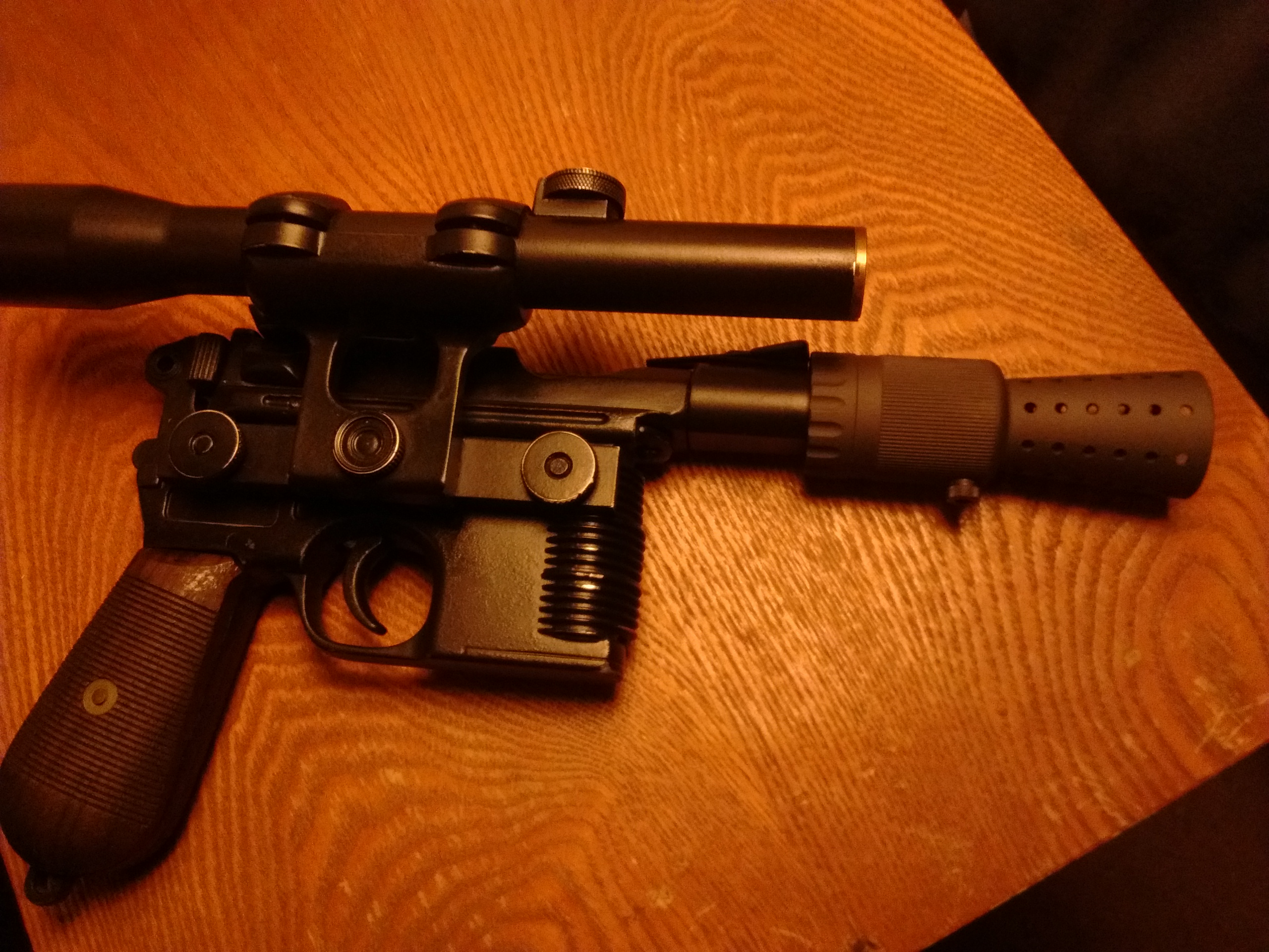

I decided to try out a baked-on parkerization-like coating on the flash hider to test my hypothesis. I chose the Brownells dark parkerizing gray baking enamel that I have had good results with in the past with real guns:
http://www.brownells.com/gunsmith-t...-parkerizing-gray-sku083046808-1143-4084.aspx

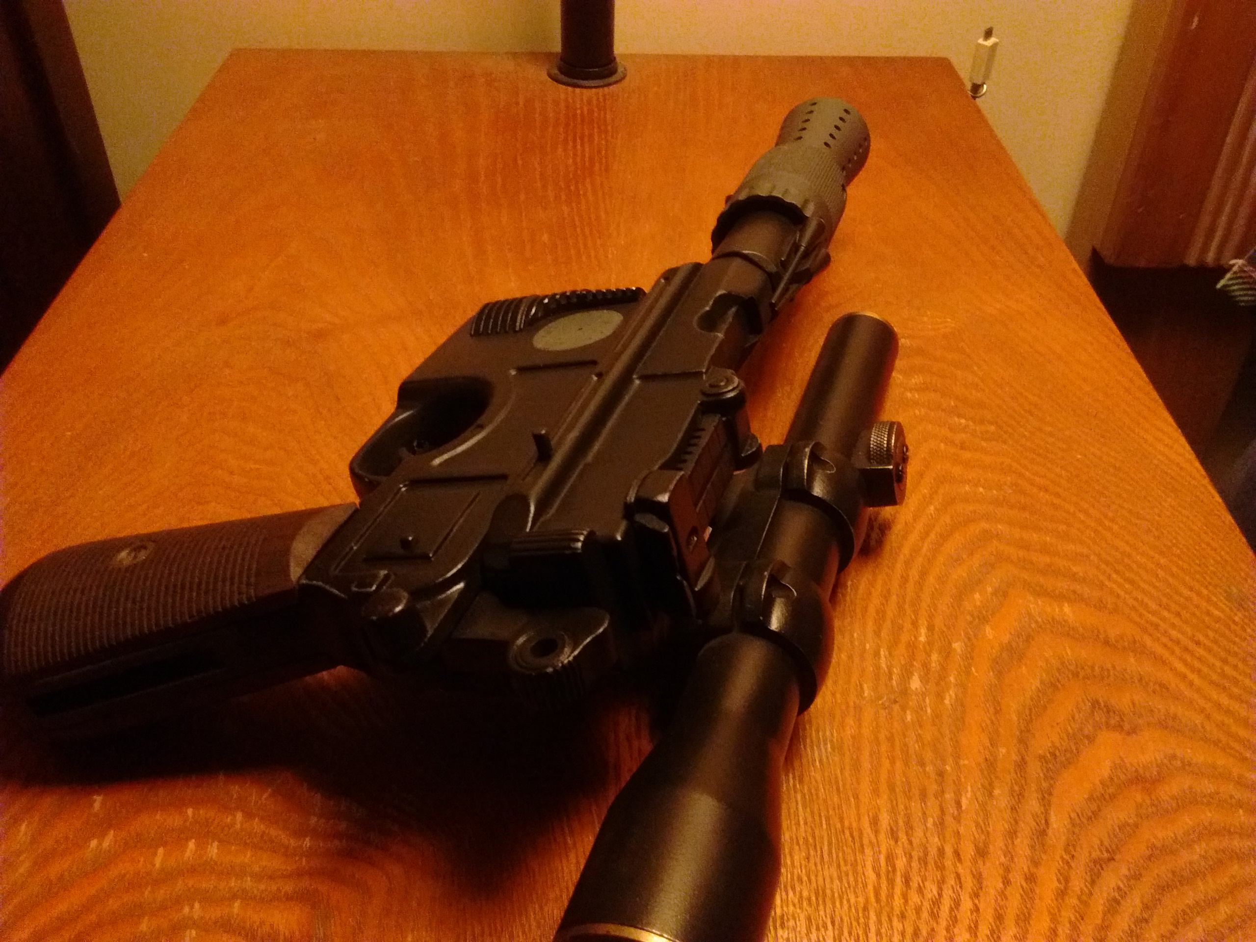

It was very easy to apply. Three light coats - 20 minutes apart:
And after baking for 30 minutes at 300 degrees...viola :)
Couldn't be more pleased with the results. I would recommend it for as-issued builds like mine. Not sure how or how easy it would be to weather. Mine will be weathered through playing with it like the giddy 8-year-old it makes me feel like :D

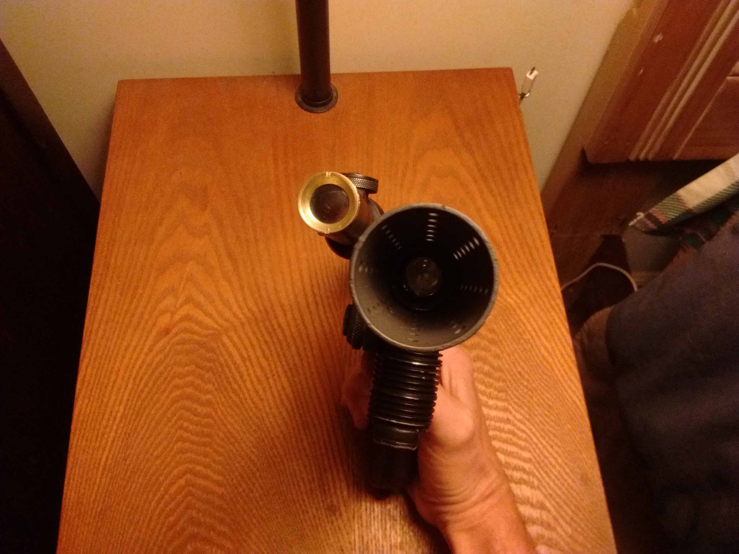

'Cause my blasters got's ta' have the "Pew, Pew" ;)... this one has a repurposed '15 Disney Rebel Blaster sound board and 10mm super-bright LED:

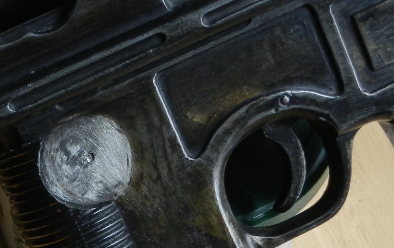

Do you think I should add a layer of paint over my blueing? I like the scope the way it is, but if the body on the prop was painted...
Edit: I'm an accuracy freak to a point. the Blast Tech grill I had on hand had a specific cut out so I made my "disc" to match, that's why its smaller :cool

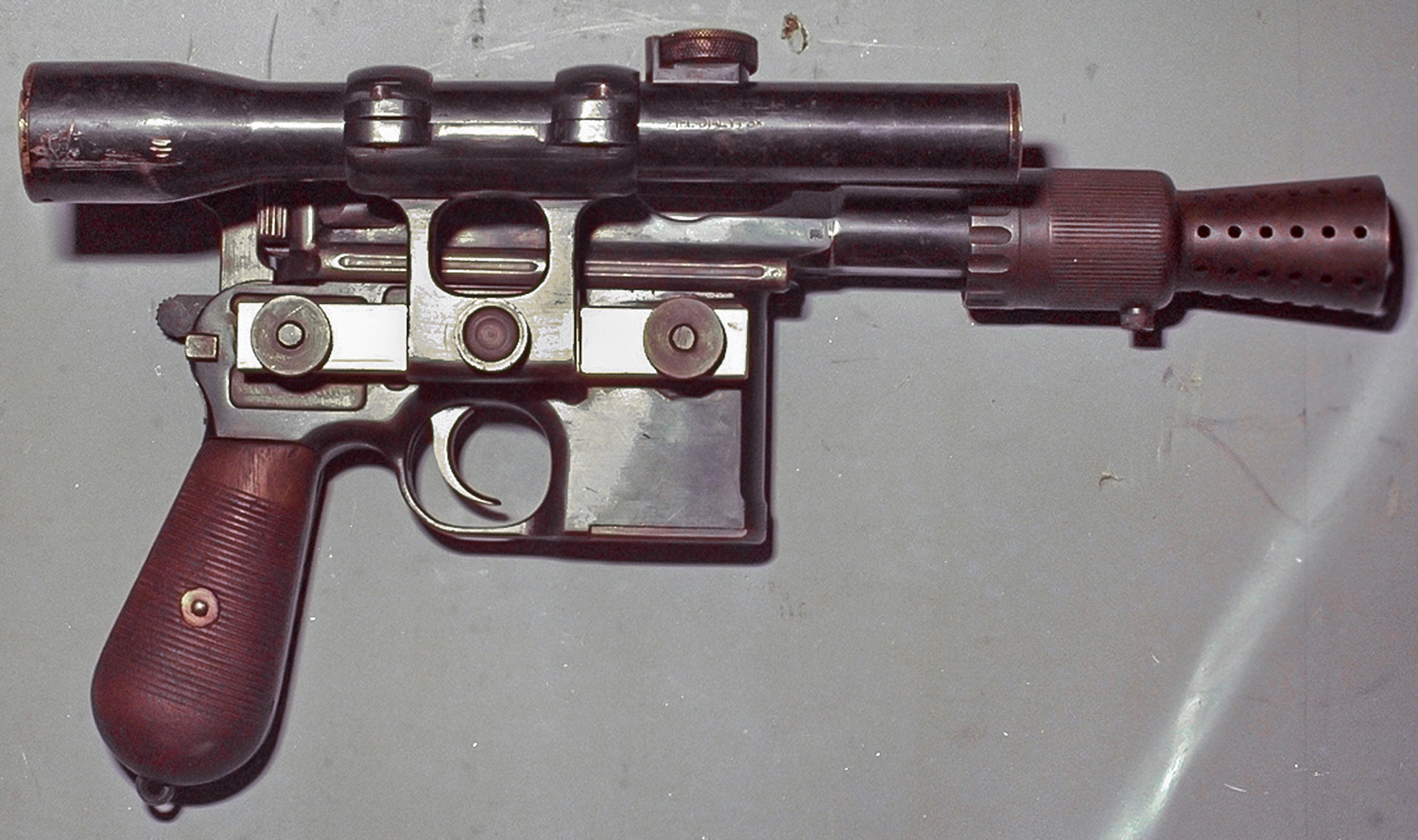

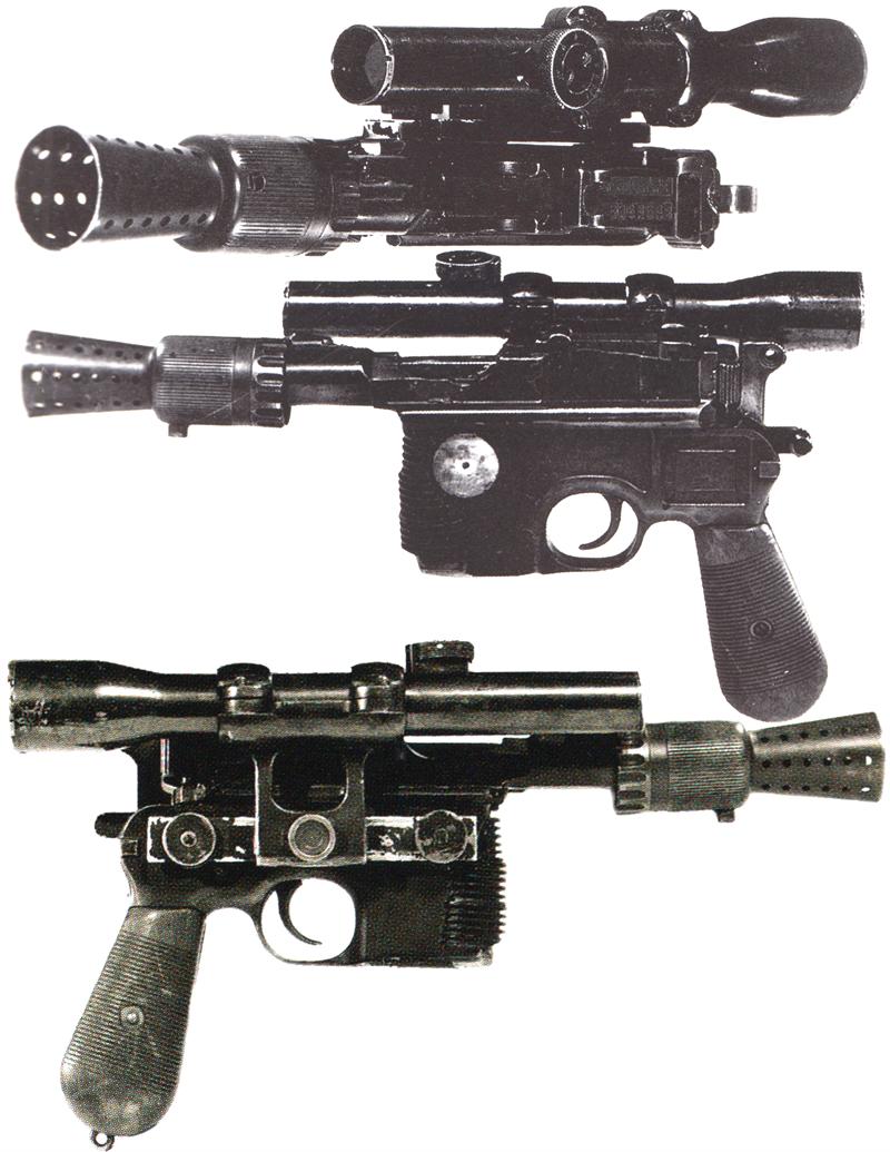

Here is the earliest known pre-production pic of the hero... even before any greeblies were attached but definitely blued:
...after adding the black plastic greeblies they decided to paint it so it would look more uniform:
So far there haven't been ANY documented Parkerized MG81 Flash hiders or Parts. I'm only aware of two types of finish... blued steel and painted steel.

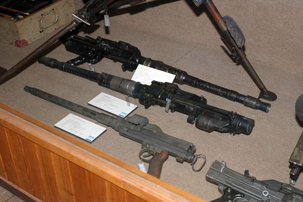

here is a pic I found while researching the possibility of it being parkerized
the bottom weapon there is the one I was looking at. Looks parkerized gray to me. Now whether that is the weapon's original finish or not I am not sure.

See, that pic there, after the greeblies attached; that's where I gotta split with you, man. I don't see how it could be painted especially when you can see the mottling of the color on the left hand side as well as where it fades where it's held, even in a high contrast, b/w photo.
with you, unless the black is being worn down and you can see the metallic worn blue/ bare metal below. impossible to tell.
