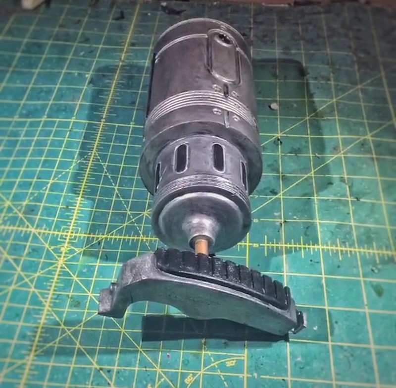

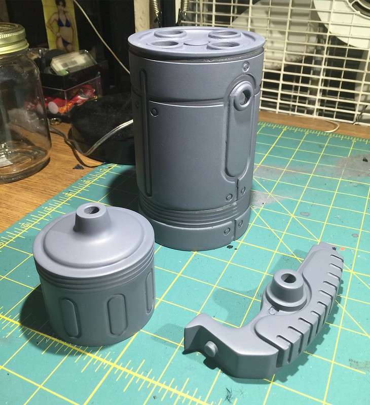

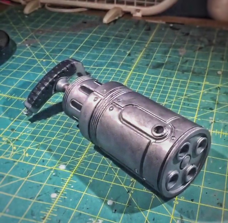

After 40+ hours of printing it's good to see this thing on its entirety. Still needs quite a bit of sanding before it's ready but doesn't look too shabby right off the print bed. I just need to print the darts next. :D

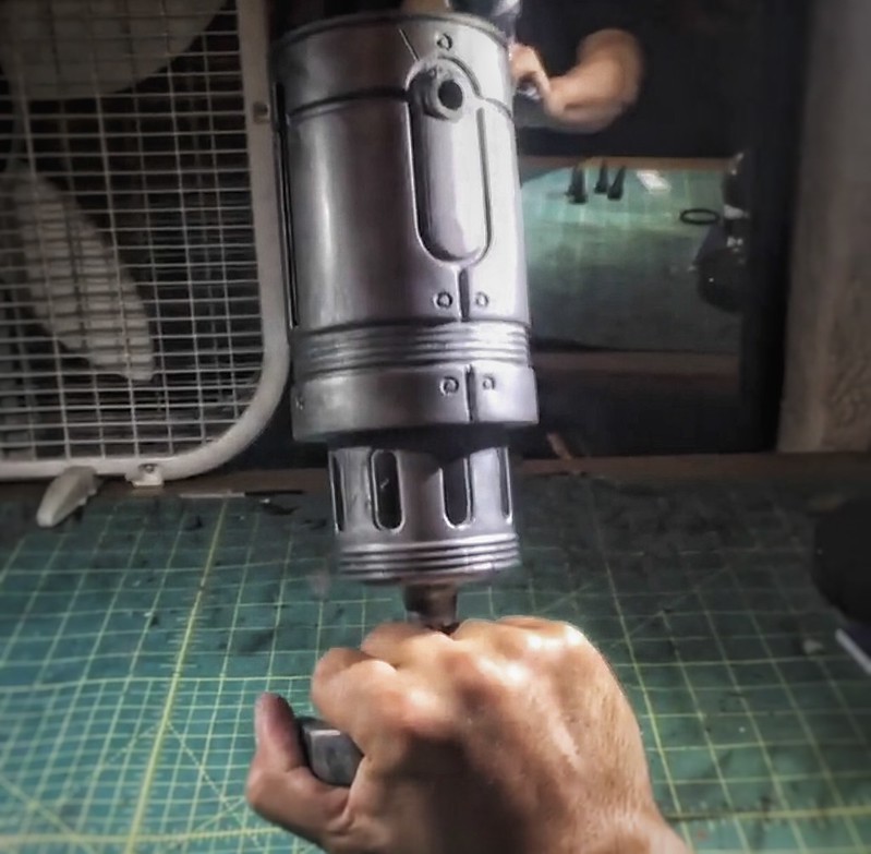

could you hold it in your hands to get a sense of scale?
Re: Reznor9's Gotham Knight Grapple Gun

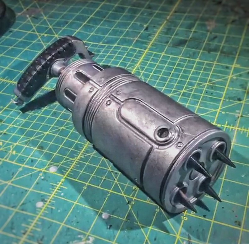

Its still not assembled so thats why Im holding it like that. But its a fairly large item. I finally printed up some darts which Ill show later tonight maybe in a short youtube video, but they look really cool.. makes me wish it would really shoot them out. lol

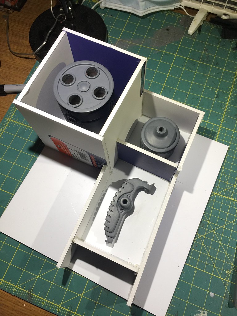

Right now Im breainstorming the best way to mold this... Im thinking three different 1 part molds as opposed to using two part molds.
Reason being is that if I can one part mold the large cylinder, I can at least stop a 3rd of the way through and fill the middle with some foam or something so that it uses less resin and saves on weight. Otherwise as a 2 part mold its going to be a solid piece of resin and as you would expect will be a bit on the heavy side.
If you mold it vertically, you can maybe still make a two part mold, I'd say about 90/10 for the ratio instead of 50/50, roto cast resin in the whole thing except the top of the mold, pour your foam in the shell you just made and make sure it fills up to just short of your resin shell, then finish by pouring resin through a hole in the top of the mold to completely encase the foam. That would be one way or doing it. Or a two part mold, a roto cast of the piece and you just drill a hole somewhere not visible, like where the handle connects, and you pour your foam through it. Or you can stop at the roto cast, if it's thick enough it should be strong enough while still saving a ton of resin !

Begun the processing and it's smoothing out well. Hopefully be mold ready by tomorrow or the next day.
