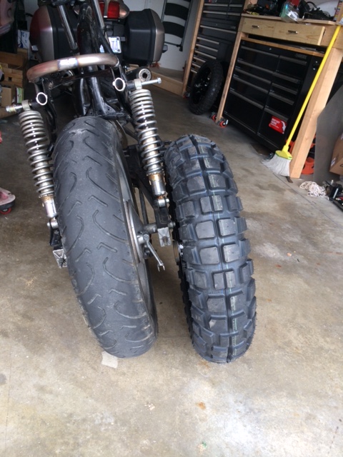

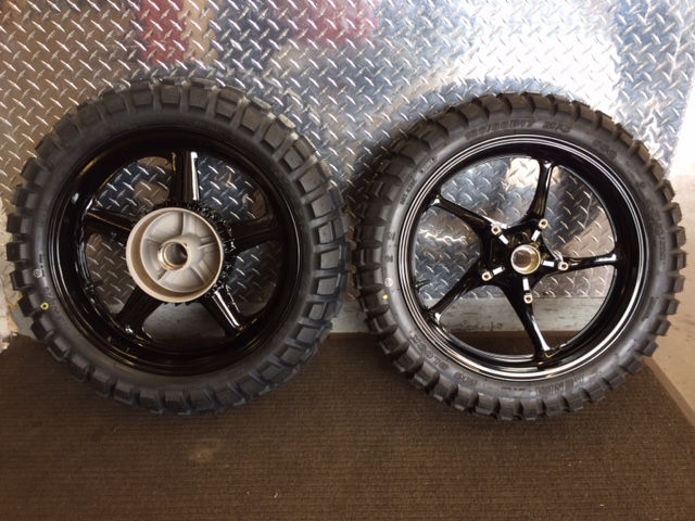

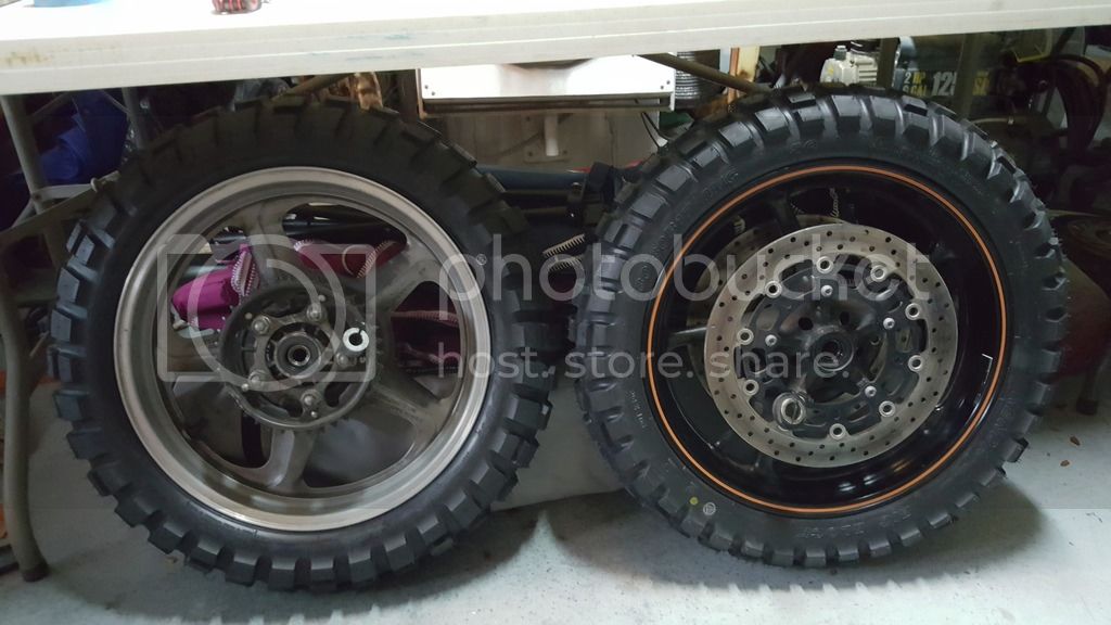

Got my wheels back today, damn I felt like an expectant father hoping they wouldn't get scratched with the rubber install!

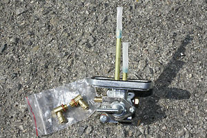

The pic that Mikesx has for a petcock doesn't look like it has the little brass plug sticking out the back, i'll look again.. found this one overseas but cant recall vendor.. i'll get them figured out and order the set this weekend, need hot work done first!

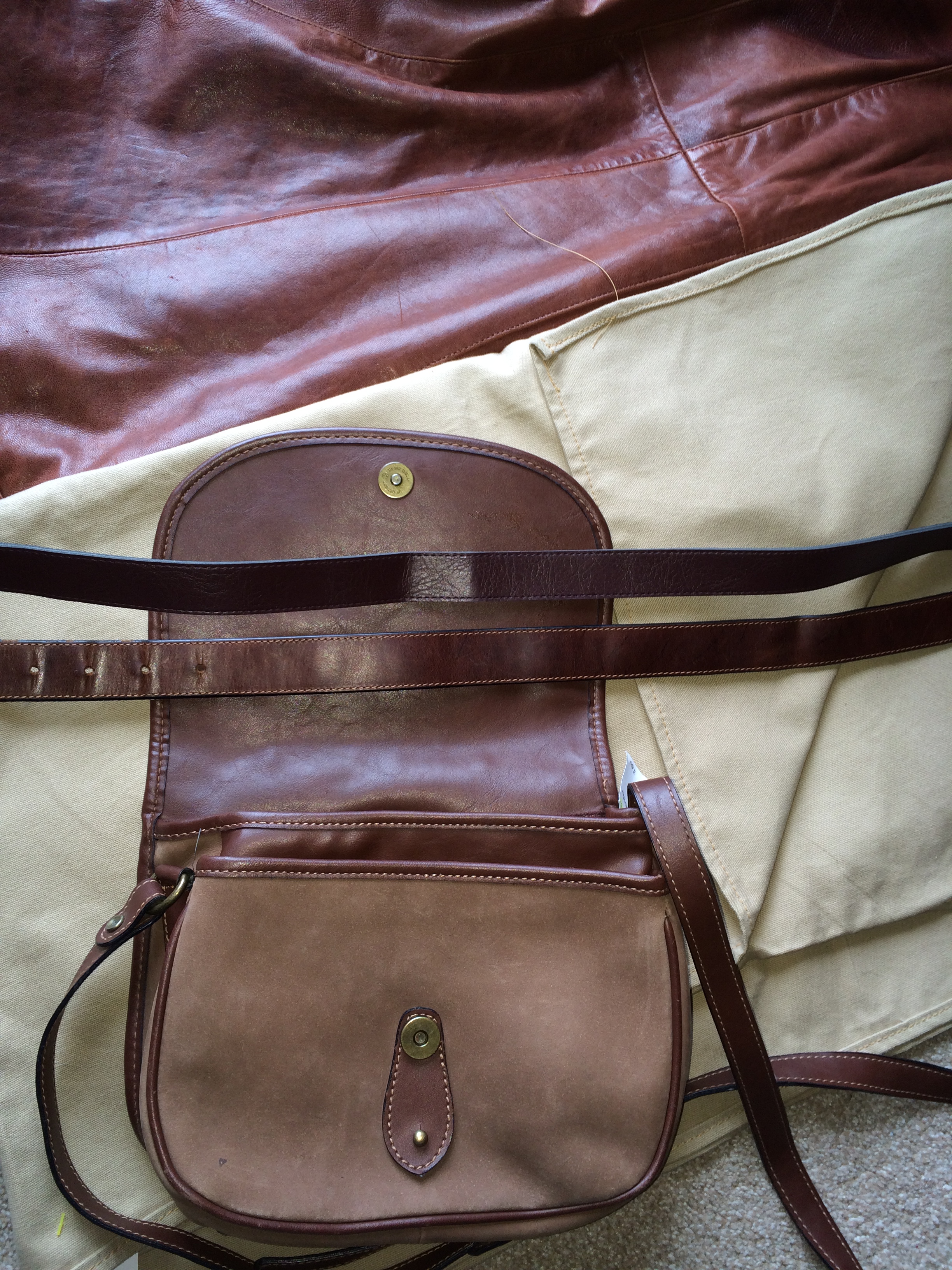

Totally scored today for the right color leather for the seat (not sure if they used leather or vinyl for the actual bikes but I'm doing leather),
and canvas for the mid bike bag (an offwhite tablecloth, it'll need some coloring but is heavy enough and I've got plenty of material to do it again. Only cheap stuff I've rant into thus far! lol

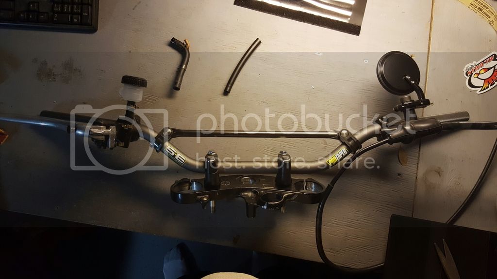

Any thoughts on the front master cylinder nipple relocating vice replacement? (can it be rotated?)
Tires look good man. Im probably taking mine in tomorrow to get mounted.
I found the petcocks, pricey ****ers at $83 each. Im currently trying to find a cheaper source. They will need to be modified as the little arm hits the frame while being turned, at least on the stock ones. Leaving them as stock will prevent you from shutting them off.
As for the seat, it was made out of leather by Mike Baird. The color is gonna be tough to nail down as it looks different shades in different lighting. Not bad ideas for sourcing the materials cheaply, I was planning on hitting up Tandy for the leather and Joanns for the canvas.
So I took a chance on the nipple and it can in fact be rotated to point up.
I mounted up one of my 970s....fits like a damn glove. If you havn't gotten yours yet, I HIGHLY recommend the eBay seller speedaddictcycles.

Your probably aware but if not i'll mention it, the early tanks had a 42.5mm center to center on the mounting holes, the later 78+ I think had a 46mm.. Let me know what Mike says cause i'll pick them up to if he has the early ones (my tank is a 74). I pinged the cat on ebay that had the later single side that appears to be right with the brass bolt head to see if he can give me his source for them.. The sudco is correct he mentioned that on the listing along with another MFG name that I can't recall)
Picked up another leather jacket for the seat, to me it looks spot on color wise, going to strip cut/sew it against the backer material and hopefully it will be good, tablecloth is for late model high back chair tables.. those tall ones with highback chairs.. it looks plenty heavy enough but will need some coloring or oiling.. the purse I got for the snaps and realized I maybe be able to use it for the pockets.. the belts just to have the extra choices to match the color.. all of that stuff at thrift store was 18 bucks! lol

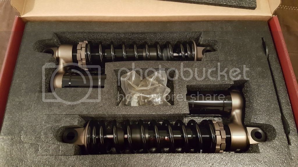

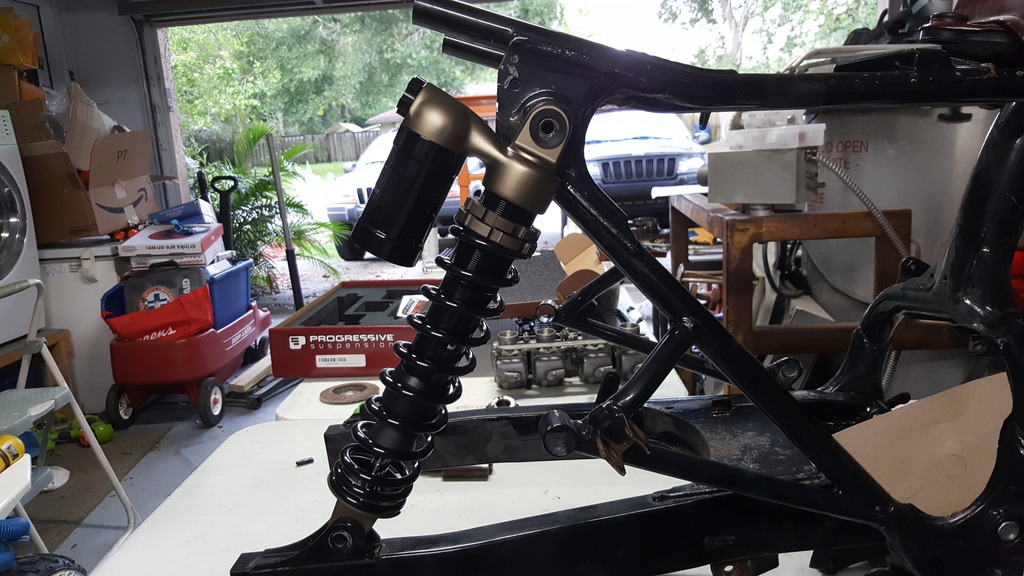

I haven't gotten the shocks yet so i'll get them from the cat you recommend, but your certain on the 13.6?
When I got home last night (work nights) I went out and was messing with the master cylinder but was afraid to really torque it.. didn't hear any snapping or anything when you did yours??

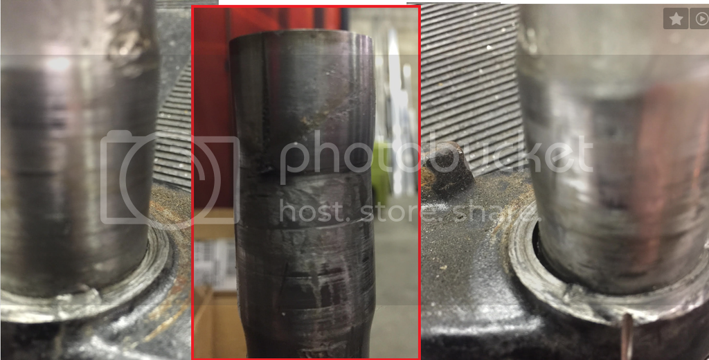

Well....****. Classified called me today about my tree swap. The Nighthawk stem I sent them was apparently too damaged to use. The extent of the damage wasn't seen until the stem itself was pressed out, but holy crap... So I ordered up another one on eBay and I am having it sent straight to them.

That sucks, texted John at Certified Moto to see if they had gotten my triple trees and said they were actually just pressing them together.. I have a spare lower if you need it to save some time.. I would like one when you find it though for the next bike (think I'm going to do a YS920 Virago).

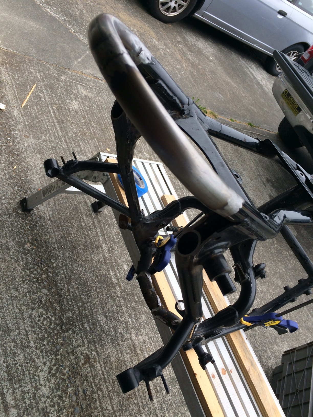

Im hoping to make some progress on the fabrication this weekend. I have the template cut for the kickstarter plate, I just need to find tubing for the spring shaft to mount in. That and I have to find a local supplier of the 1" tubing for the hoop.

I'm hoping the kickstart shaft comes in today otherwise i'll have to wait till Monday to drop the frame off.. I cant tell for sure but l am taking off all of the center stand mounting brackets and its a pain in the butt! Talked to the local law enforcement in regards to the plate so I'm mounting it a little forward and slightly tilted on the bracket towards the rear of the seat frame area. Have to figure out the correct shorai battery today to get the box built up for it, I'm going as high as I can and forward below the seat, going to put mounts on the outside of the frame for the relays and such.

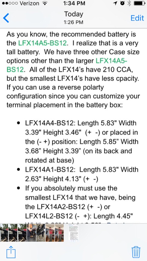

Have any idea which specific battery (smallest) will work for the required cranking amps? I'm going to call them now to see if I can get dimensions/digits of smallest battery with same specs as stock CB750

Did get some info from Shorai on the battery sizes.. Option 1 or 2 initially look to be the right answer, not to sure about dropping specs for size on that last option but will look at it closer later!
