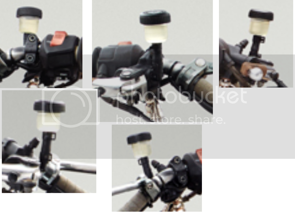

These are the shots i have of the resevior, can you post the one you have with the mounting tab?

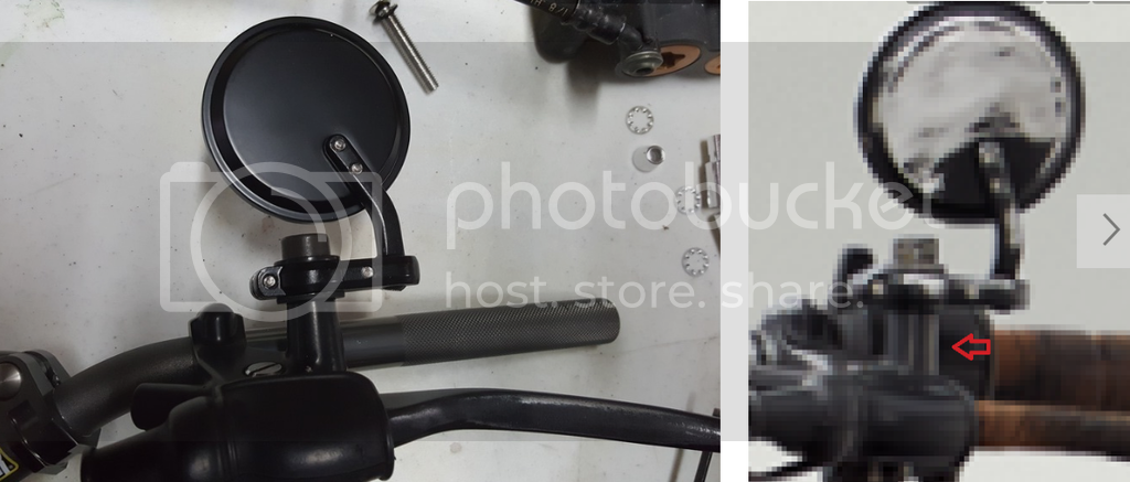

I think I just figured out the mirror mount....I'll have to dig through my bin to find a normal bolt though vs. the rounded one.

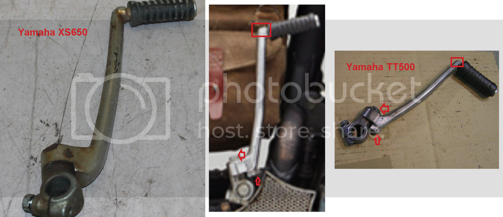

Kick starter is from a TT500. The XS650 is slightly off.

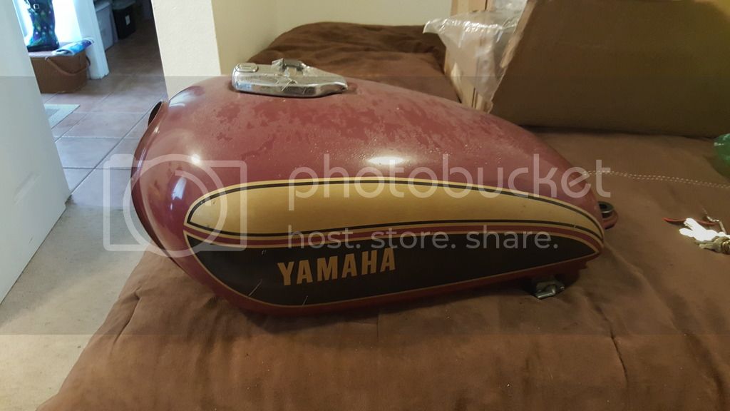

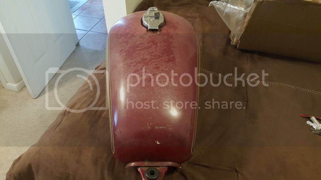

My tank just showed up!!
Nice tank! And thanks for all the info and time you've put in I love everything so far!!
So what piece did you use for the mirror mount? A hollow 7/8 with long 10mm nut?

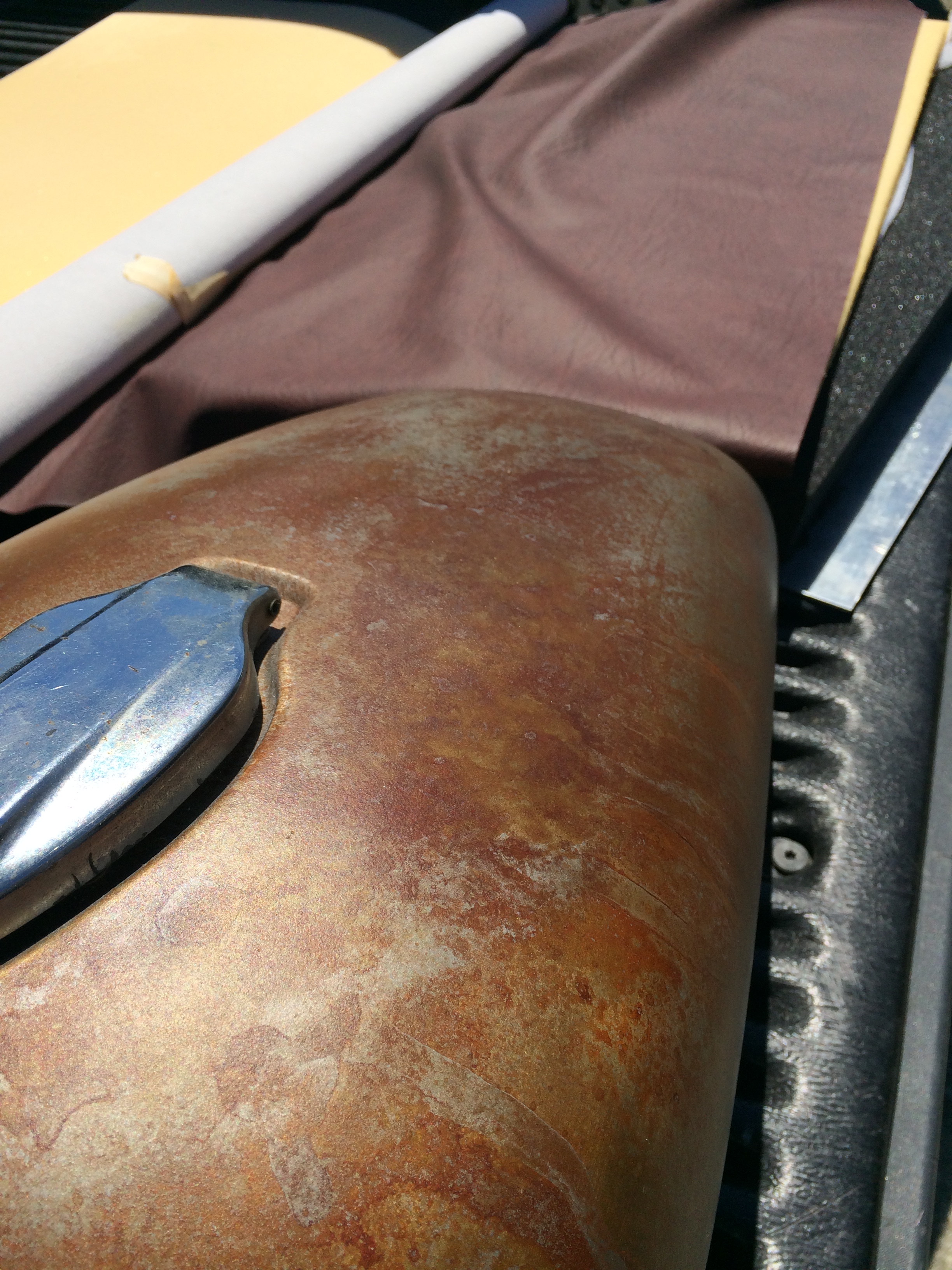

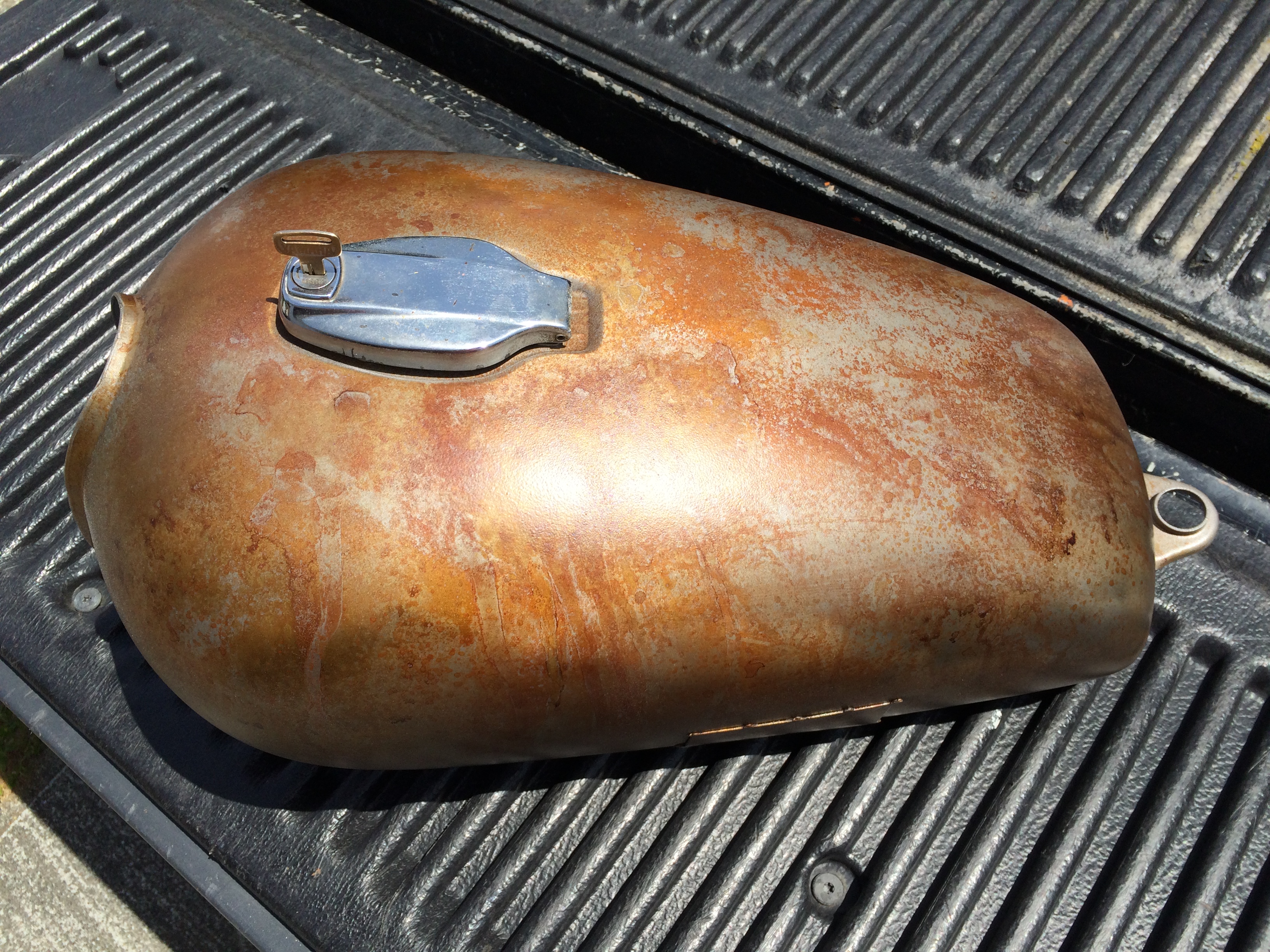

The artificial rusting is a piece of cake on the tank! A little vinegar, a lot of 3% hydrogen peroxide and a table spoon of salt in a squirt bottle, keep a heat gun handy to keep the solution in place and dry it in one spot for darker spots, works like a champ on a blasted tank!

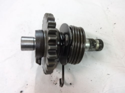

For the functional Jackshaft I bought the XS650 one but then noticed the RD350 unit appears to be the same spline and is much more compact, won't figure that out until I get both of them in my hands.
Here's the XS650 one:
Here is the RD350:

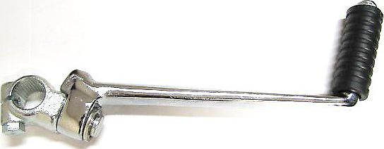

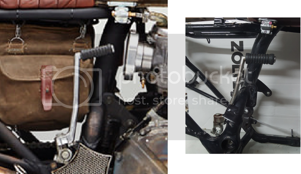

I'll look at the TT500 kickstart, on the XS650's there are three different physical variations, I believe the one they used is the one from Mike's.. t
his one the 70-73 version for XS650's? Hard to determine 100% due to pic angles.

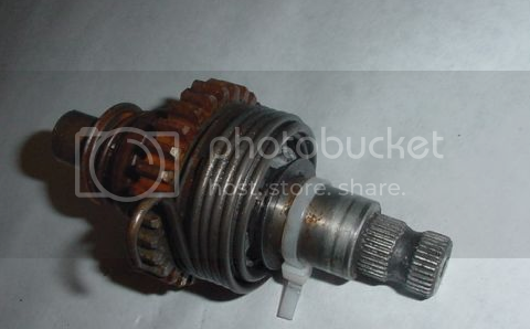

Sources for my parts are listed on the sheet i posted if you needed something. Both lights were obtained on eBay. I picked up the matching spring shaft for the TT500 a few days ago, its pretty compact as well. I mocked up the kick starter on the frame with the tank and it looks to be accurate. (the angle of the pic is a little off though) The XS650 one has a small nub on the bend that the reference pictures do not have. The part that sold me was the bottom part of the mount. Of course Yamaha could have cross used parts for a few years too. I'd venture to say when it comes down to it, aside from people like us, who is really gonna notice? There were a few parts used from Mikexs.com, so it would make sense.
Here is the springshaft from the TT500
Yeah, I'm being way too detail oriented on this one but it's what I do lol. On the master cylinder, do you have any idea if they nipple boss would simply rotate in the housing to point straight up?? I've read/seen that they are practically impossible to rebuild.. my alternative although not 100% correct was to simply flip the stock hose so it'd be a little offset but looks like it'd be straight up??
These are the two kickstarts I was looking at from Mikes: first is 70-73 XS650, second is the RD350 which is cheaper so I'm probably going that way..
Very hard to tell from the pic angles although your right, I don't think anyone would really notice!
Have decided to go ahead and put a second parallel contact switch on the kick start so that I can run it down and at the bottom it will engage the starter circuit.. depends on how much it delays me getting the hotwork done though, if I've got time its going on...

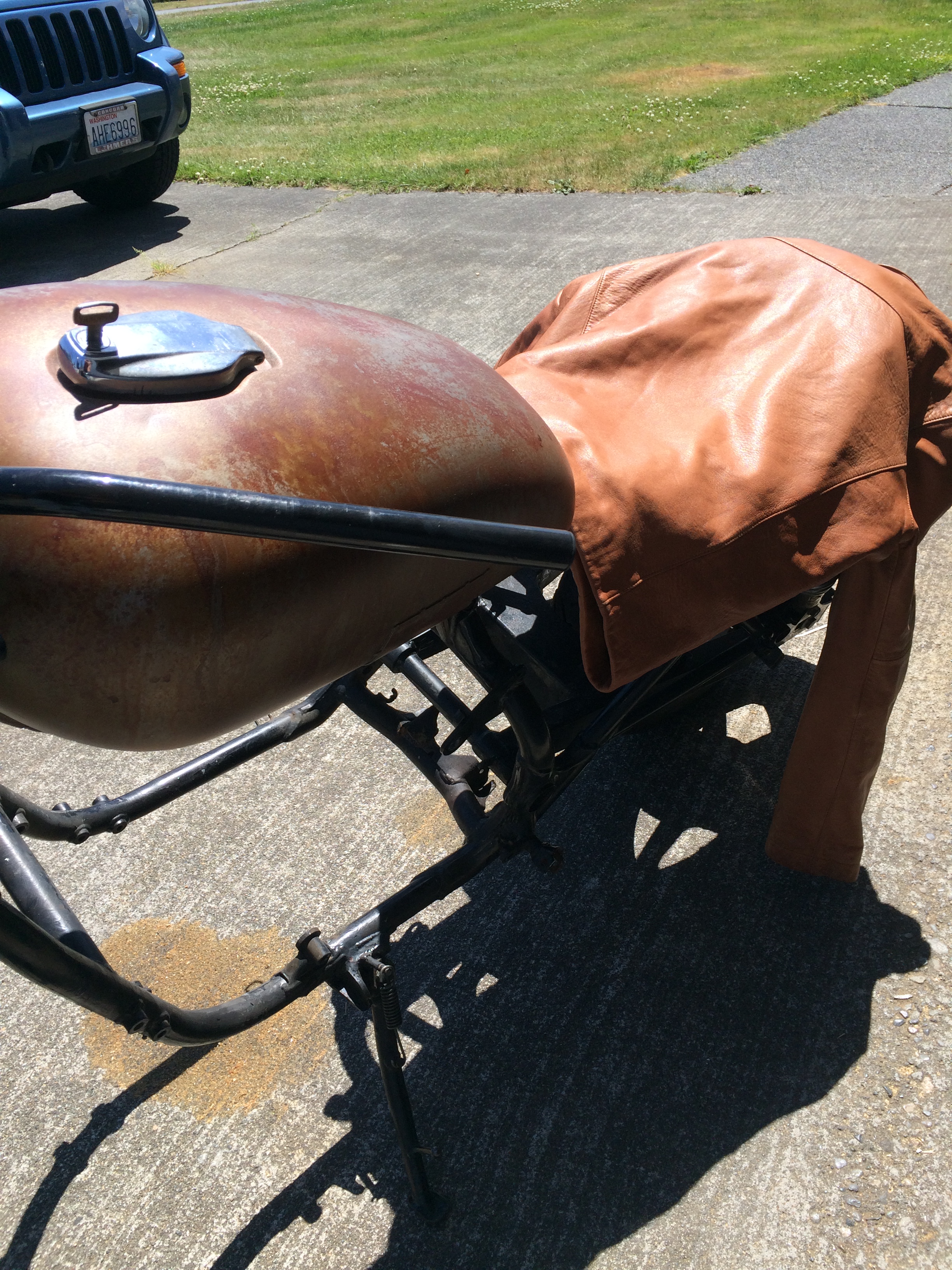

Here's the tank I did, I may blast it again and redo it to get more of the silver visible, speaking of that did you find a source for the specific reversed petcocks?

Haven't ironed out the canvas for the bag or the seat but working it!
