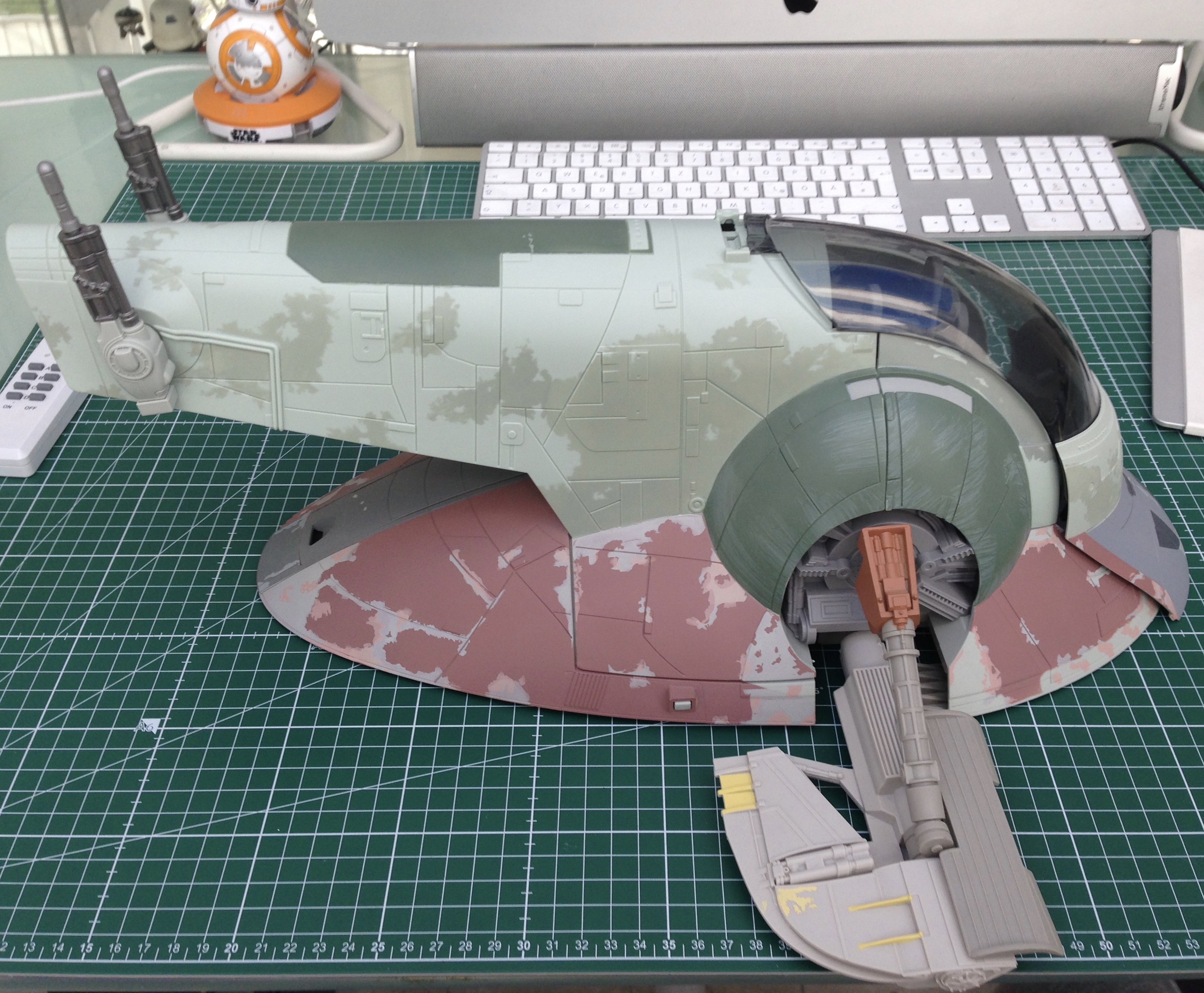

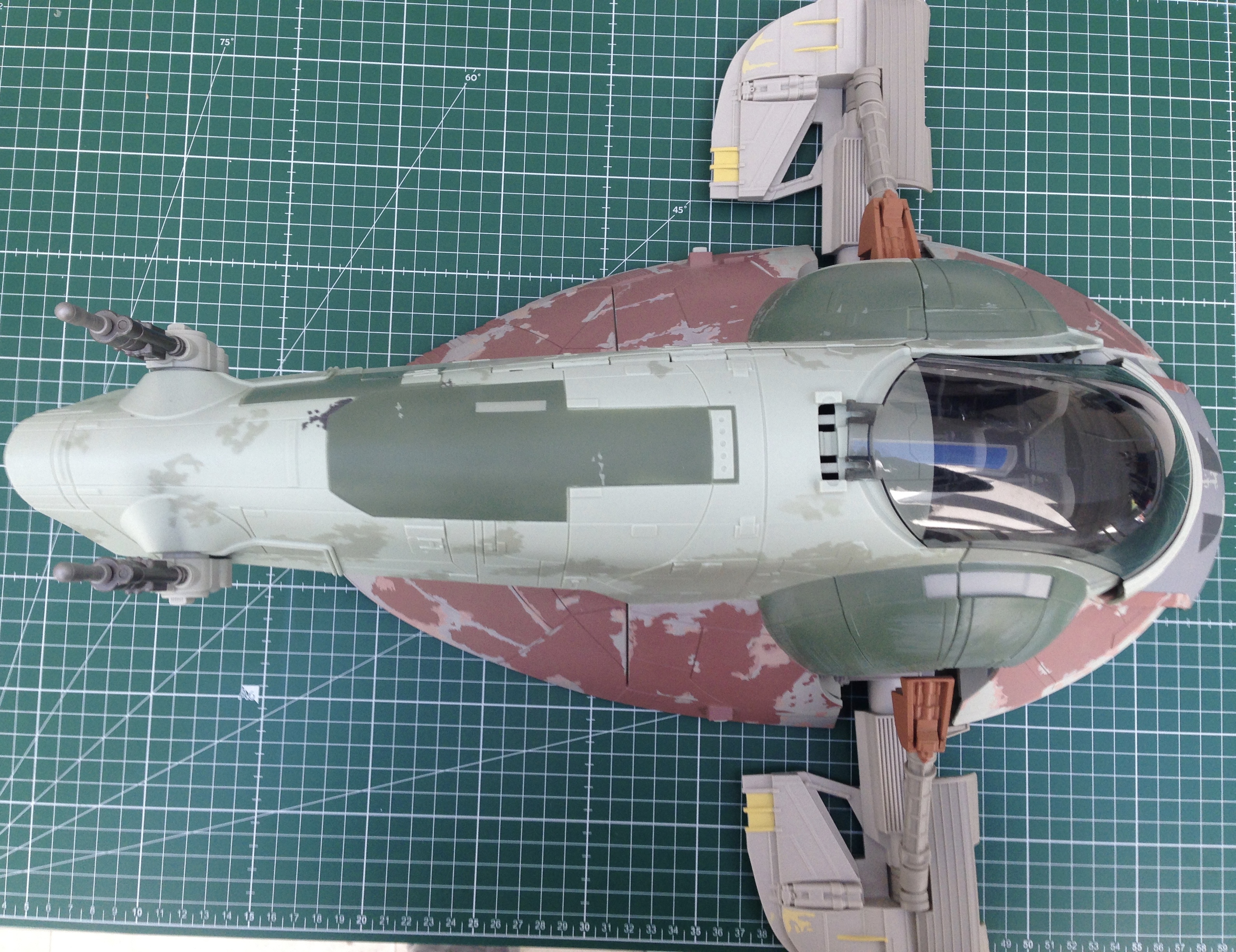

Bought a Hasbro Slave 1 on eBay like a year or so ago and its been sitting in the basement since then, I also got a FM Slave 1 kit that I saved for a rainy day but it will now come in handy as a reference.
The biggest challenge will be that paint job, but there is enough good builds out there that one can check out for tips and tricks (Fichtenfoo is one of them).
Out of the box
For a Toy the over all detail and quality aint bad at all.
I did a comparison measurement to the 1/72 Scale FM Slave 1 and it sorta boils down to 1/46 or 1/45 Scale

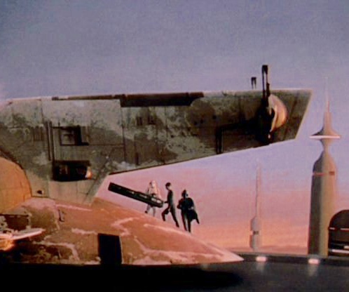

Comparing it to some reference pics out of the SW Chronicles the Hasbro is not to far away. Needs some detailing and add ons but I think
the final result will be ok.
Same thing...needs a bit of detailing and bondo to close some of the hatch opening lines original designed for the Action figures when using it as a Toy.

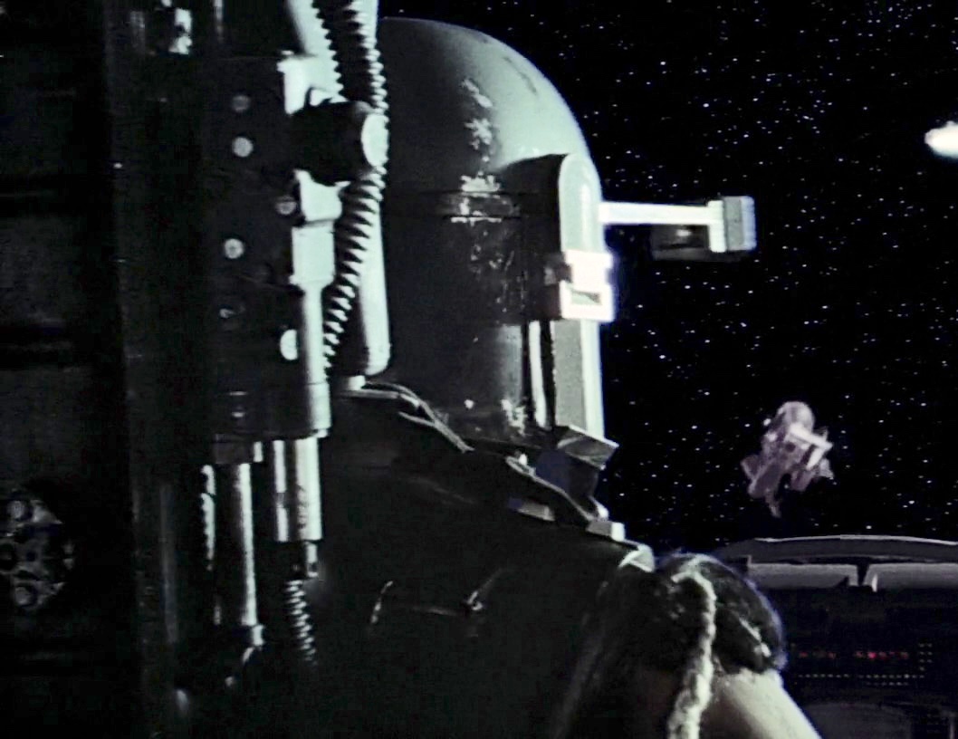

Talking about Seat, I got a Resin Martin Baker Mk IV Ejection Seat and looking at this screen cap
it would not surprise me if thats what they used for this "only scene" of the Slave's Cockpit in ESB.
I mean the Martin Baker was also used in the Falcon so...anyhow it looks cool :)

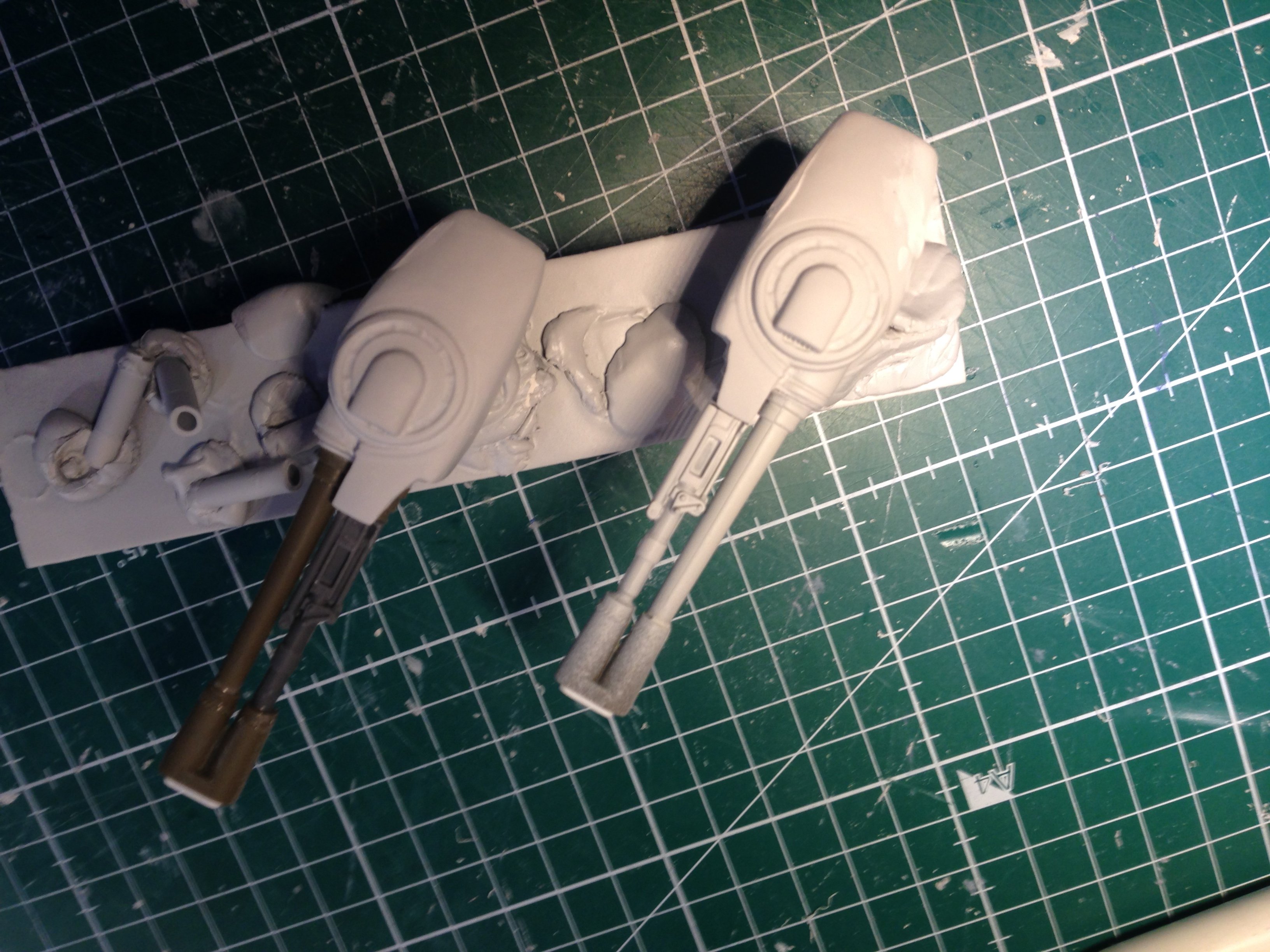

Also started on the Main Guns...not to bad BUT!!! I read in a thread here at The RPF that the main Kitbash Parts came from
Guns: Tamiya 1/35 Duster + Tamiya 1/35 Flakvierling
Cover (Wheel): Tamiya 1/20 Porsche 935 Turbo (not 100%, but they look pretty close)
Cover: Tamiya 1/20 JPS - it's the seat
Cover intake thingie: Tamiya 1/20 JPS - brake intakes
So I ordered those kits after checking some pic of Sprues online and the Duster and Flakvierling is a 100% hit.
I am still not sure about the Seat from the JPS...will see when I get the kits.
Ofcourse the Studio Model is a bit Bigger then the Hasbro Slave but I will for sure replace the Gun Barrels in the pic to the Duster ones those are spot on.

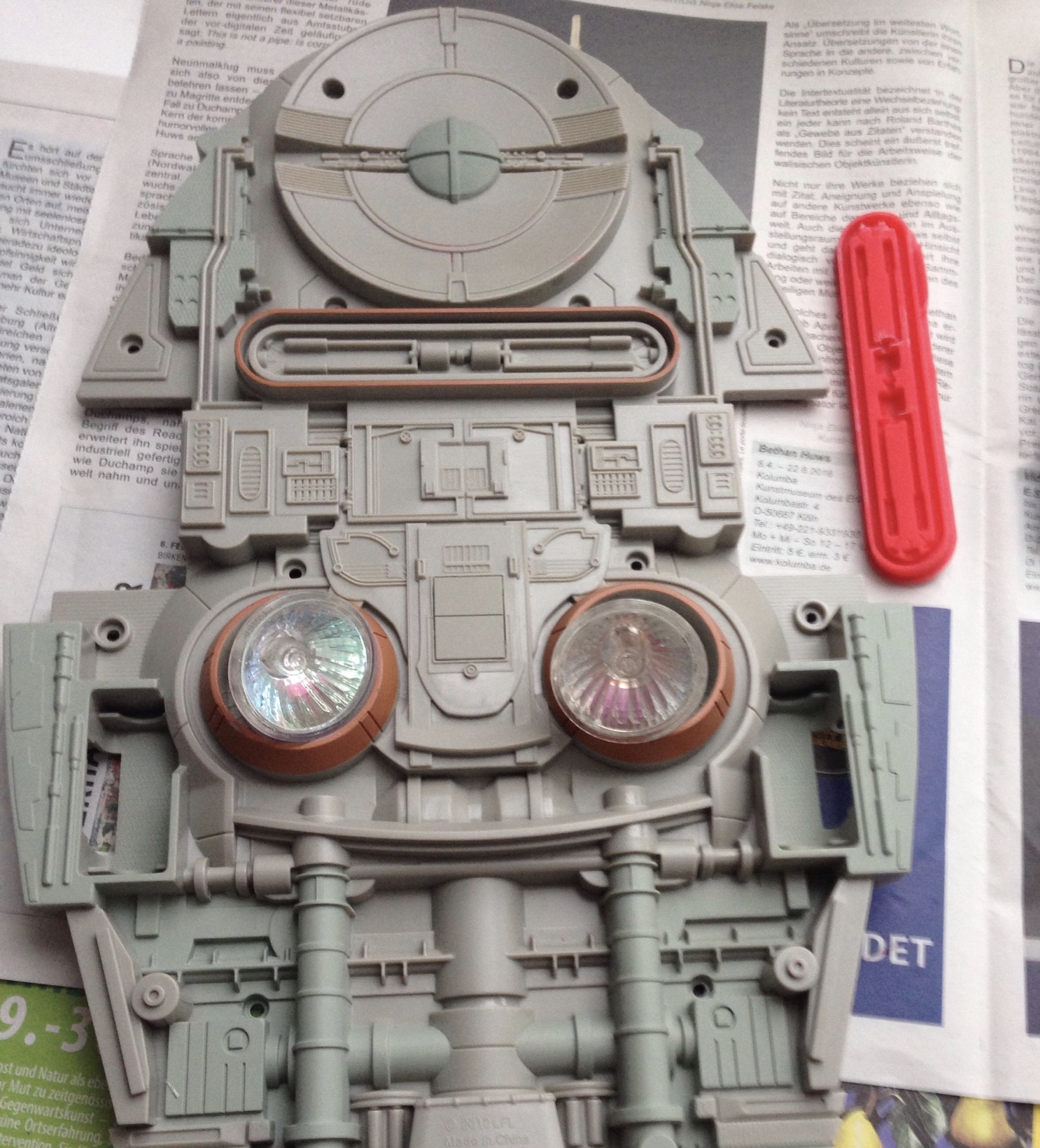

Also got me a Pair of Reflectors that are pretty close to the Engines from the Studio Model...one problem is that they are incapsulated in Glas...Not sure how I will get it off.
Might go gently with the Dremel to at least cut of the back part that holds the Halogen Lamps and replace them with LEDs later.

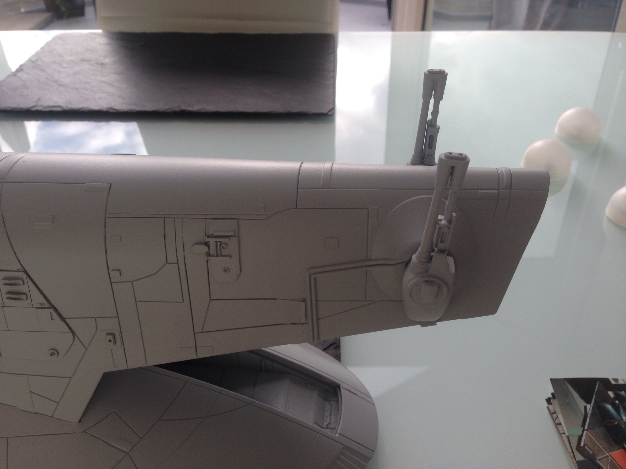

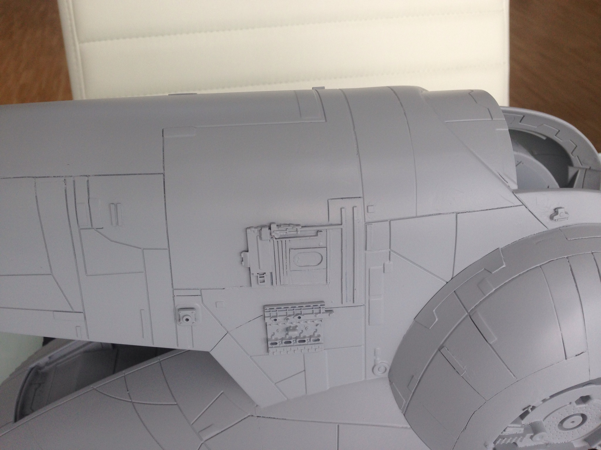

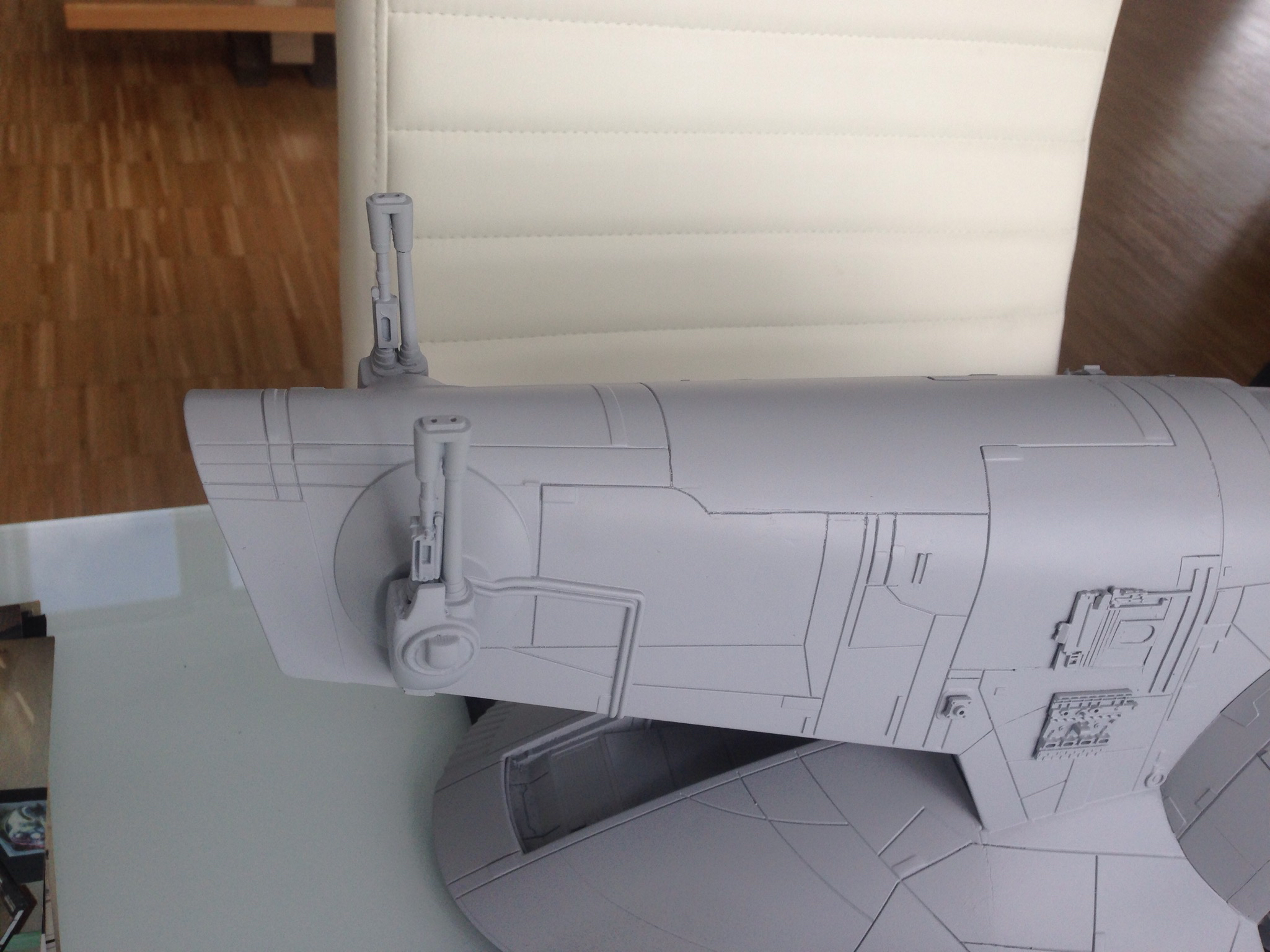

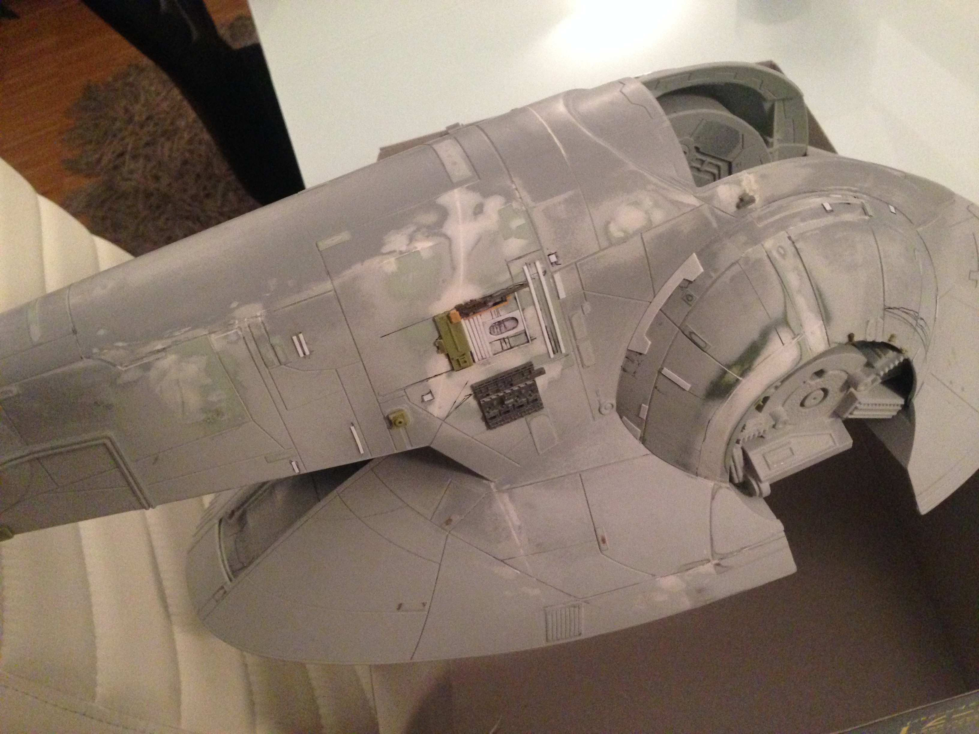

Had a hard run the last two weeks, As the two sides of the main body are mirrored (Starboard side is sort of ok) wich means that if one wants to make a model that sorta looks like the original Studio Model one will have to do ALOT of SANDING! and BONDO work :)
Also spent a lot of time checking ref pics and glueing greebles and Styrene strips.
Closing Panel Lines with Bondo and cuting new ones...fing up and doing it again :p
Modified the Main Guns using parts from the Tamiya 1/35 M42 Duster and Flak Vierling, looks pretty cool I think.
After a light 2nd coat of Primer/Filler its starting to look sorta like the Original Studio Model...not 100% but I am pretty happy with the result so far.
Still need correct some panel lines that are wonky, hard to see that when you are working on a Patchy model with flecks of bondo, primer and original plastic color shining through, so the 2nd primer coat makes all those small mistakes visible. Oh well I guess I will sand and bondo some more ;)
On the Port side I had to use some Artistic License as I could not find any Ref material...only pics of the mysterious Green Rectangle.
I was sure I had a pic from some older Star Wars Exhibitions...been sifting trough all my Ref Material but couldn't find it...maybe I dreamt it :)
I really want to start working on the Engine Back Part soon as it will also need some scratch build parts and a fair amount of Greebles.
Cant wait to start the main challenge...PAINTING IT! Hell Yea!
Cheers Guys.

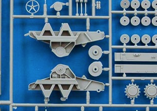

Hi Guys
Got a question...does anyone here know from what kit this part comes?
Been looking all over and I can't ID it.

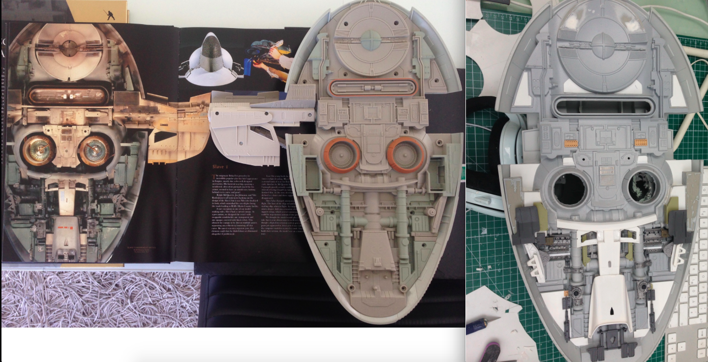

Comparison to the Original ILM-Hasbro-where I am at the Moment.
As the Scale of the Hasbro Slave is about 1/48 I can't really use the original kit parts as they are to big, like the F5 Tiger II Under Fuselage 1/48 Monogram/Revell Kit(Scratch built it) and the Ferrari 312 Nose Tamiya 1/12, same thing. I have to use parts that looks sort a similar that are to the right scale of the Hasbro, so it will not be spot on but "look" like the Original...thats the Theory anyway :)
I tried to build those side greebles but I am not happy with the quality...I might give it another go but if some one knows from what kit they come it would help me a lot.
Cheers Guys
Re: CAPTAINCOX Slave 1 Hasbro Mod
Part is from Hasegawa Morser Karl 1/72. Get that and the Leopold, lots of parts for SW models!!
SWEET!!! cheers man, found one on eBay for 25€ and ordered it just now. Again thanks man!
Cheers Guys
CC, have you calculated the size differential between the original ILM model and the Hasbro? Perhaps it is such that we'll get lucky & it will fall on standard (but smaller) kit scales, such.
R/ Robert
Sort of...
I am not 100% sure what Scale the original ILM Model is...I measured the Hasbro to the FM 1/72 Slave 1 to 1/48-46...tricky but that is sorta right.
As you can see in the Pic above ILM used the 1/48 F5 (99% sure they did) and thats to big...I got the Italieri 1/72 and thats almost ok but a tick to small (only my opinion)...so lets say ILM used a part thats in 1/48 scale then the Hasbro would then need a part that is like 1/60-65 or something...again tricky. I think if you want to build a model that "Resembles" the Original ILM model you have to improvise...basically using parts that sort a looks like the Original or Scratch build them...only my 5 cents.
Lets see how that "Mörser Karl" part turns out, it will be to big to the Hasbro Scale but it might look ok after all...it will for sure save some time trying to scratch build something thats pretty complicated...can be done but :p
Cheers Guys.

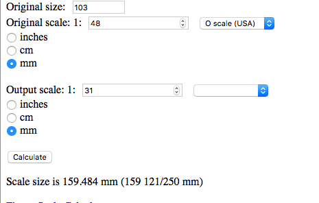

My Scratch built F5 measures 70mm
Revell F5 1/48 Scale measures 90mm
So lets see if I can sorta calculate the actual scale of the ILM Model based on this :p
This will not be 100% scientific but still sort a fun.
Did a quick measurement in Photoshop using the original ILM Photo as a base (could be slightly off but thats what I have) scaled the pic using the 90mm from the Revel F5 as a base and got 160mm measuring from center to the outer body shell.
Measured the Hasbro in sort of the same spot as I did in the ILM Photo and got 103mm
Sooo....presuming that the Hasbro is 1/48 scale (almost 100% sure) the Original Slave 1 from ILM is 1/31 scale what a weird scale :)
Maybe thorst have a more exact measurement, pretty sure he has as he did the photogrammetry from the REAL Slave 1.
